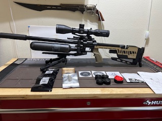

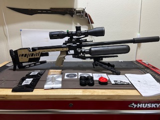

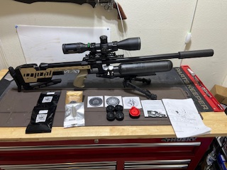

WTS P-rod pistol with carbine stock. Comes with all the Hill Airgun internals, matched valve, hammer, hammer spring, peek valve, Donny FL 1/2 - 20 adapter, Hill moderator, 4 magazines, Captain O-ring kit x2, wide trigger shoe, single shot tray, RAI adapter for an AR stock, original manual and paperwork. It’s tuned by Tim Hill to shoot Hades at 590 FPS for a barn hunting gun. Holds air as it should, recently tuned and newly sealed by Tim Hill. Single digit spread and SD. This gun shoots as consistently as a regulated gun. I’m not sure how Tim does it but this thing is amazing, especially for a close quarters pesting rig. Over $1000 invested and only asking $435 shipped in lower 48. PayPal F&F or money order. I’ve bought and sold lots of stuff here, all with 100% positive feedback so buy with confidence.
