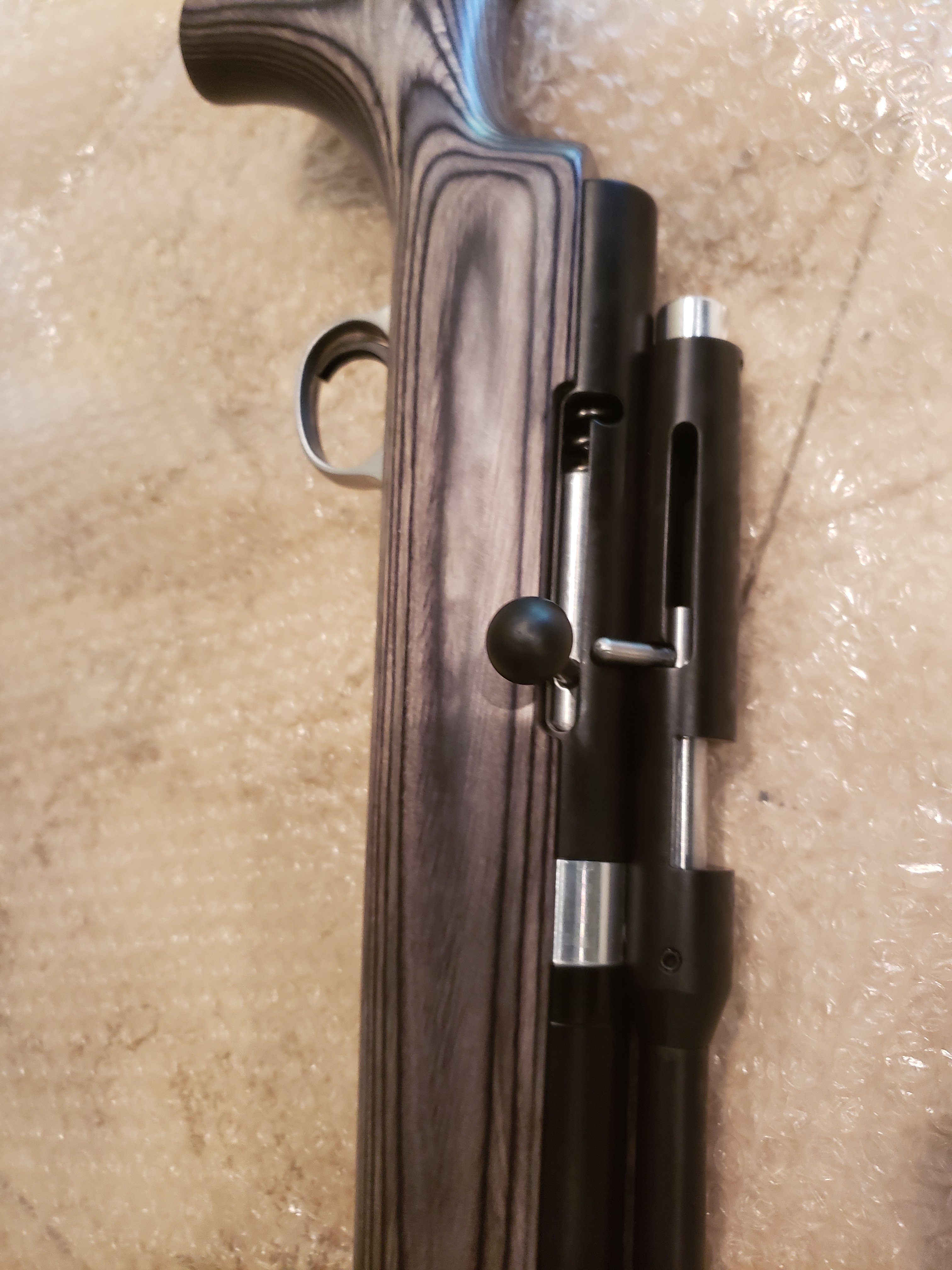

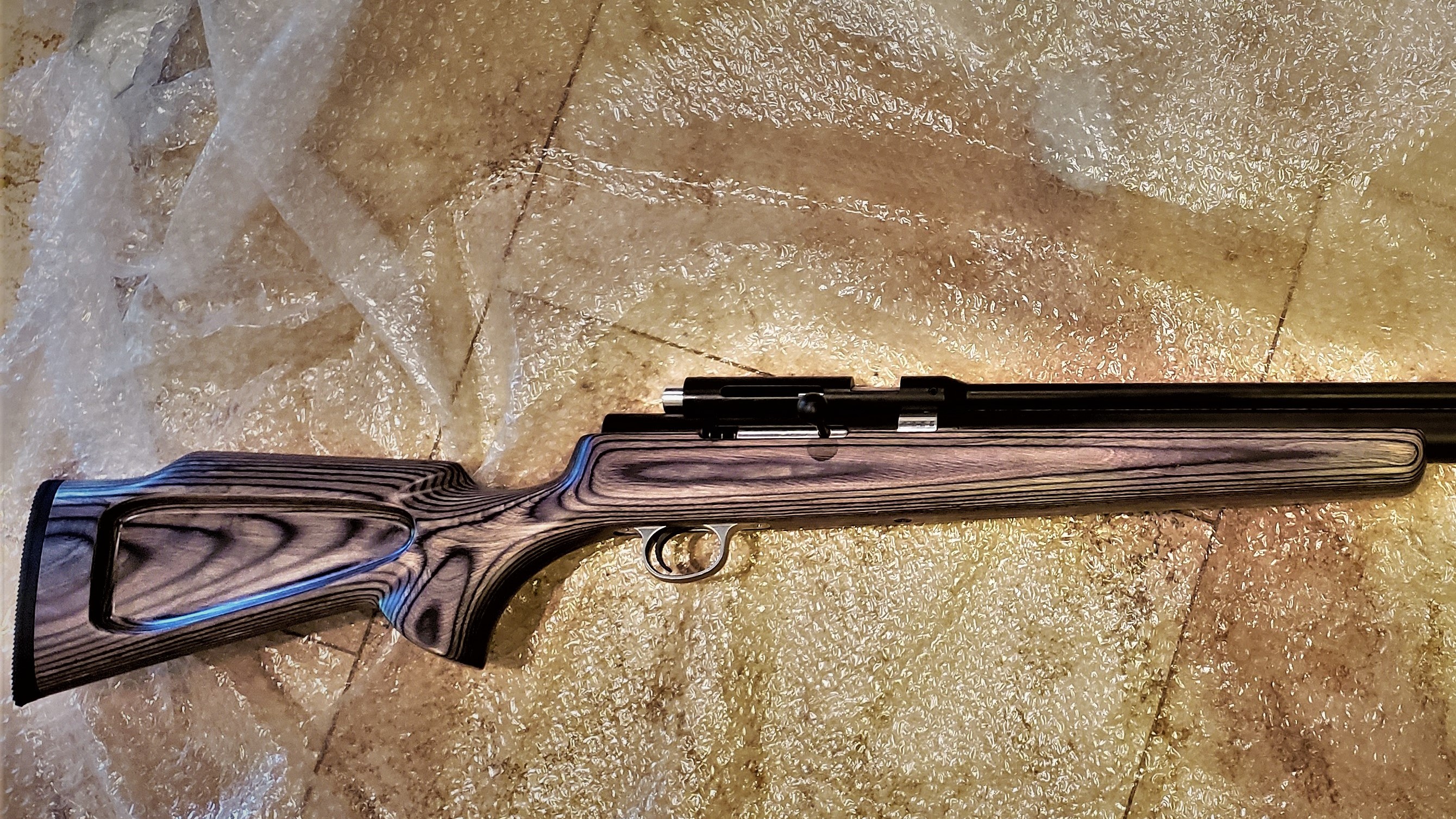

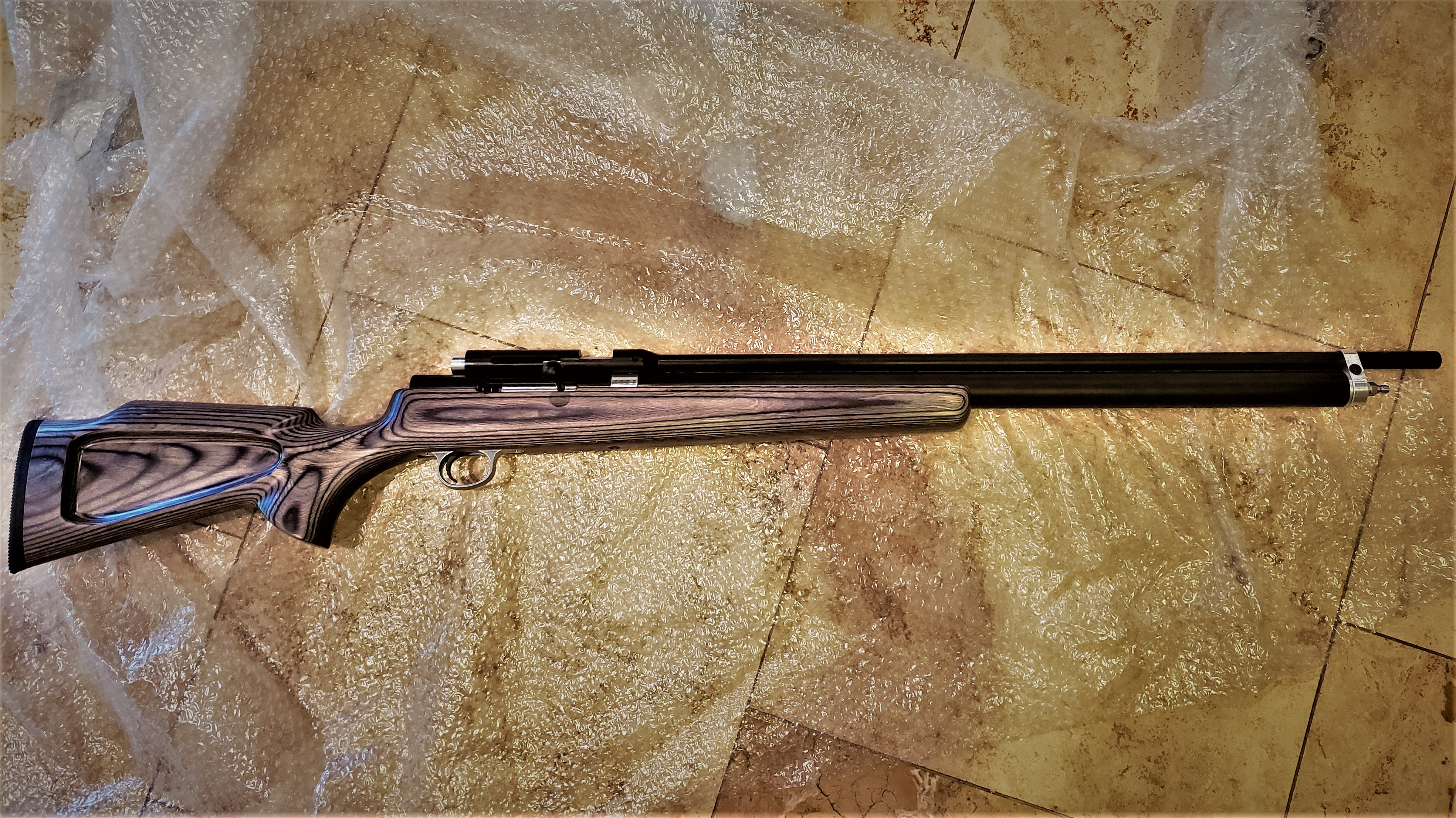

PCP Rifle  SOLD Extreme Big Bore .457 - made by Brent Hoag - never fired
I originally bought the gun to take to Costa Rica when I moved there in 2017 (bought early 2018) and was not able to import it. The gun has never been filled with air/helium, never been fired. It is in cherry, completely new, condition. I paid 1500 for it - it was handmade by Brent Hoag before he sold the company to the Texas company and was made to tolerances that allow using helium if you want more power. I do not want trades - I'm looking to get some discretionary cash together for the purchase of something unrelated. I'll entertain serious offers.

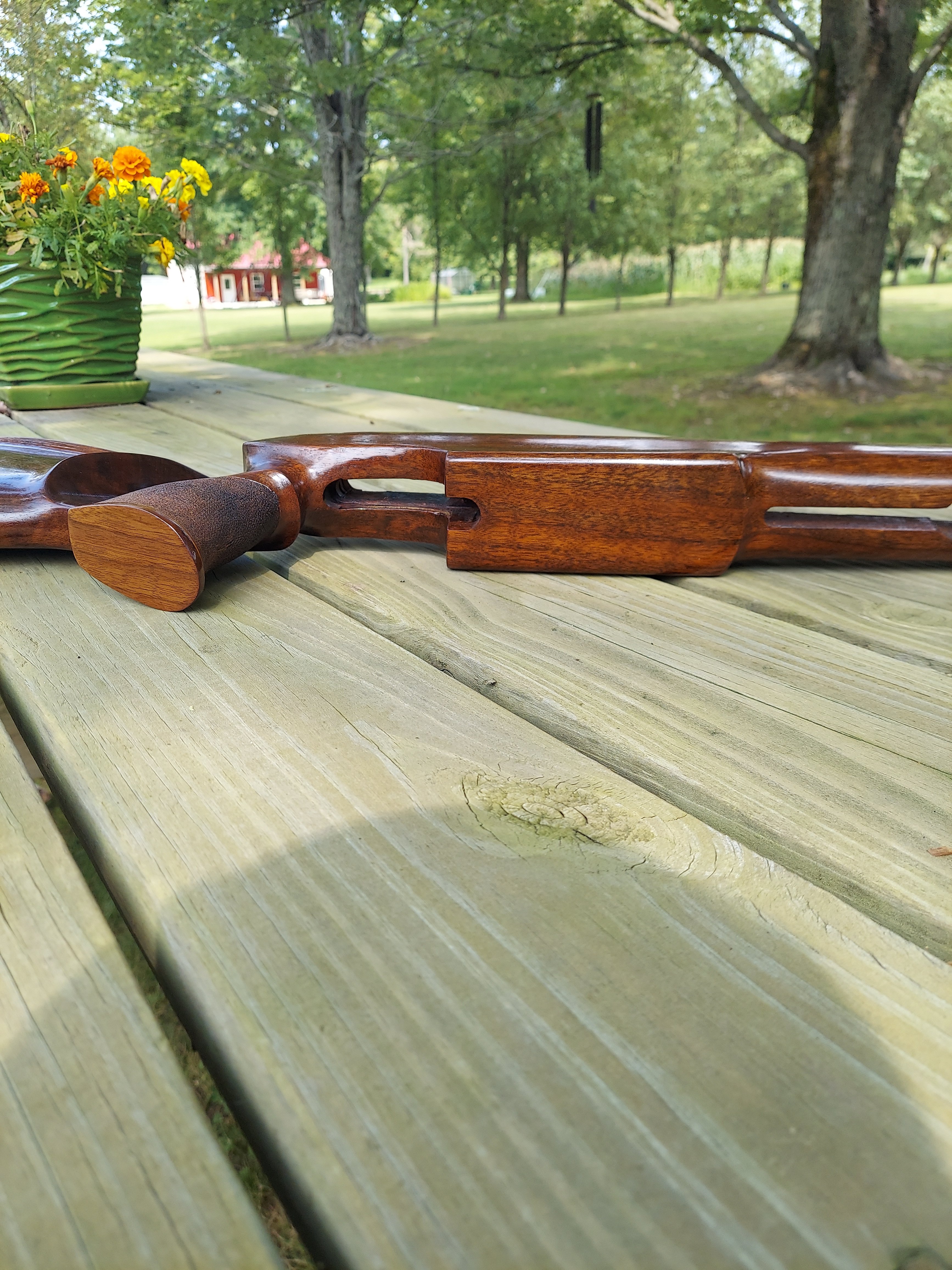

Traditional Rifle  SOLD SOLD Walnut Abernathy Stock
SOLD. SOLD. SOLD. Selling my walnut Abernathy Stock for the TX200 (rt. hand). I bought it a few years ago from another member here with a few minor issues. I repaired those, stripped it down, and refinished it with multiple coats of Tru-Oil. It came out amazing, and I have been enjoying it since. It has an adjustable butt-pad (possibly Rowan engineering ?) and is such a solid platform ! I simply decided to go back to my factory walnut stock. Price is $325 SHIPPED anywhere in the cont. USA. No PayPal. I do accept Zelle, Bank Check, or U.S. Postal Money Order., shipping same day they clear. My feedback on here will speak for itself. Thanks for looking.

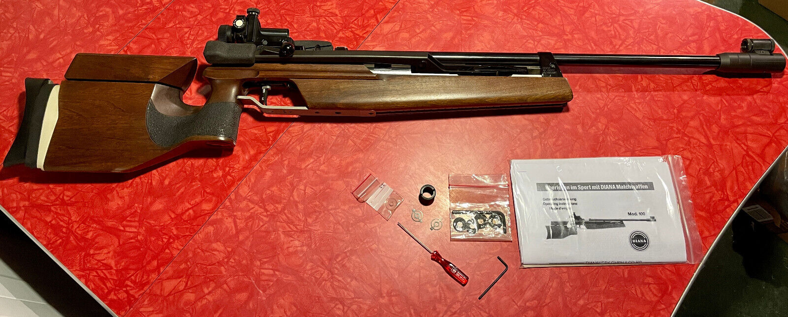

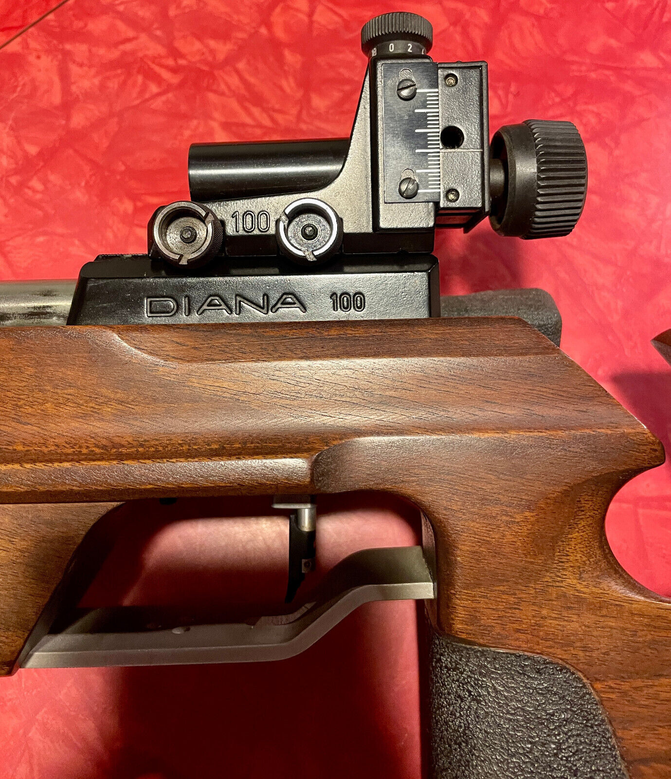

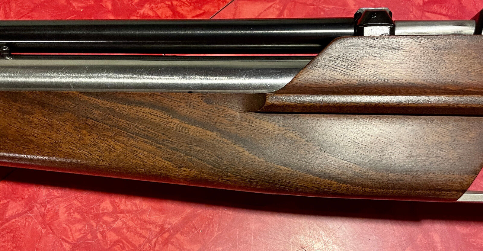

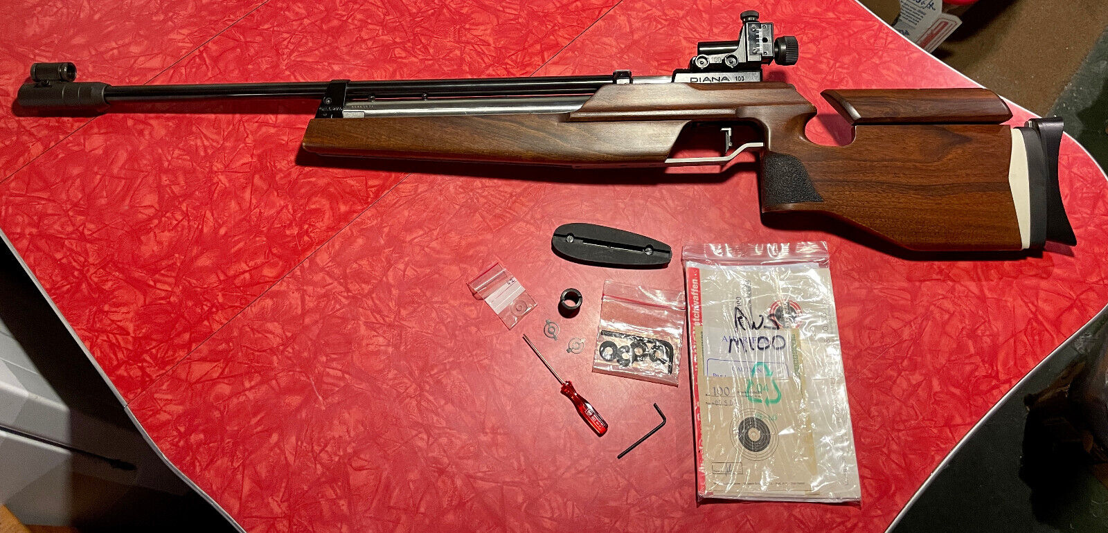

Traditional Rifle  SOLD Beautiful RWS Diana 100 SSP 10m Match Rifle With All Accessories - Resealed 8/21
Last Price Drop on this incredible SSP. $700 plus actual shipping and insurance. You will not find a better price on a beautiful Diana RWS model 100. She was resealed last year, and comes with extra seals. My husband coming home Tuesday or Wednesday, and I really don't want it here for him to see one more thing he can't do anymore.
This is an incredible deal. You wont find a cleaner Diana model 100 anywhere, especially at this price. $700, plus actual shipping and insurance. First I'll take it, gets it.

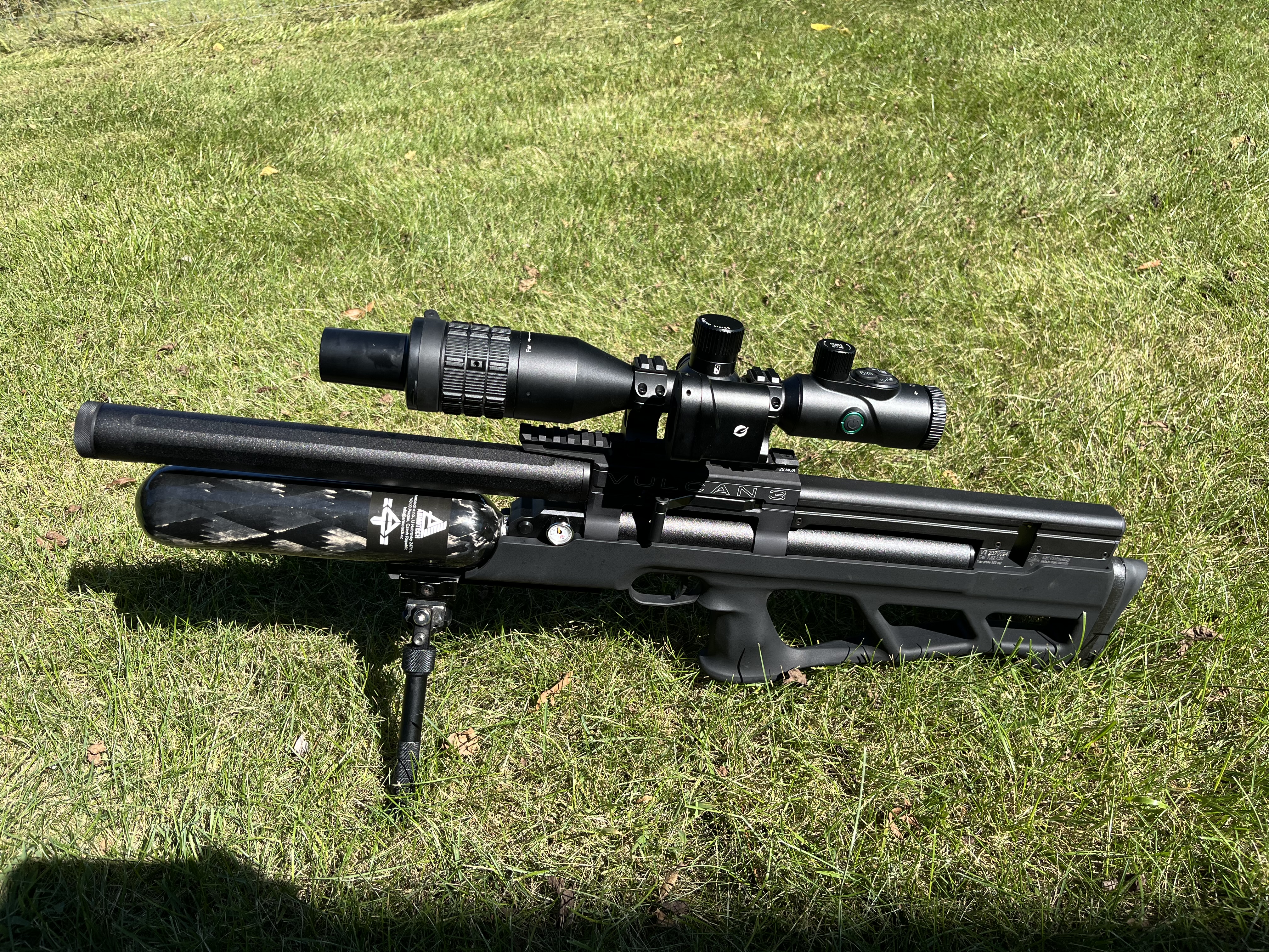

Airgun Technologies  Vulcan 3 back to basics…
Not a fan so far of the digital scope. Would be pretty mad at myself had I spent 700 but wow the gun. Straight out of the box mid 880 - 900 with 44.75 and perfect accuracy. Will make a great woods walker especially when I throw my Blackhound on it. .30 cal 500 mm. Two 51 yard 5 shot groups with a crappy digital scope. If you want a simple gun you don’t have to tinker with the Vulcan is the ticket.

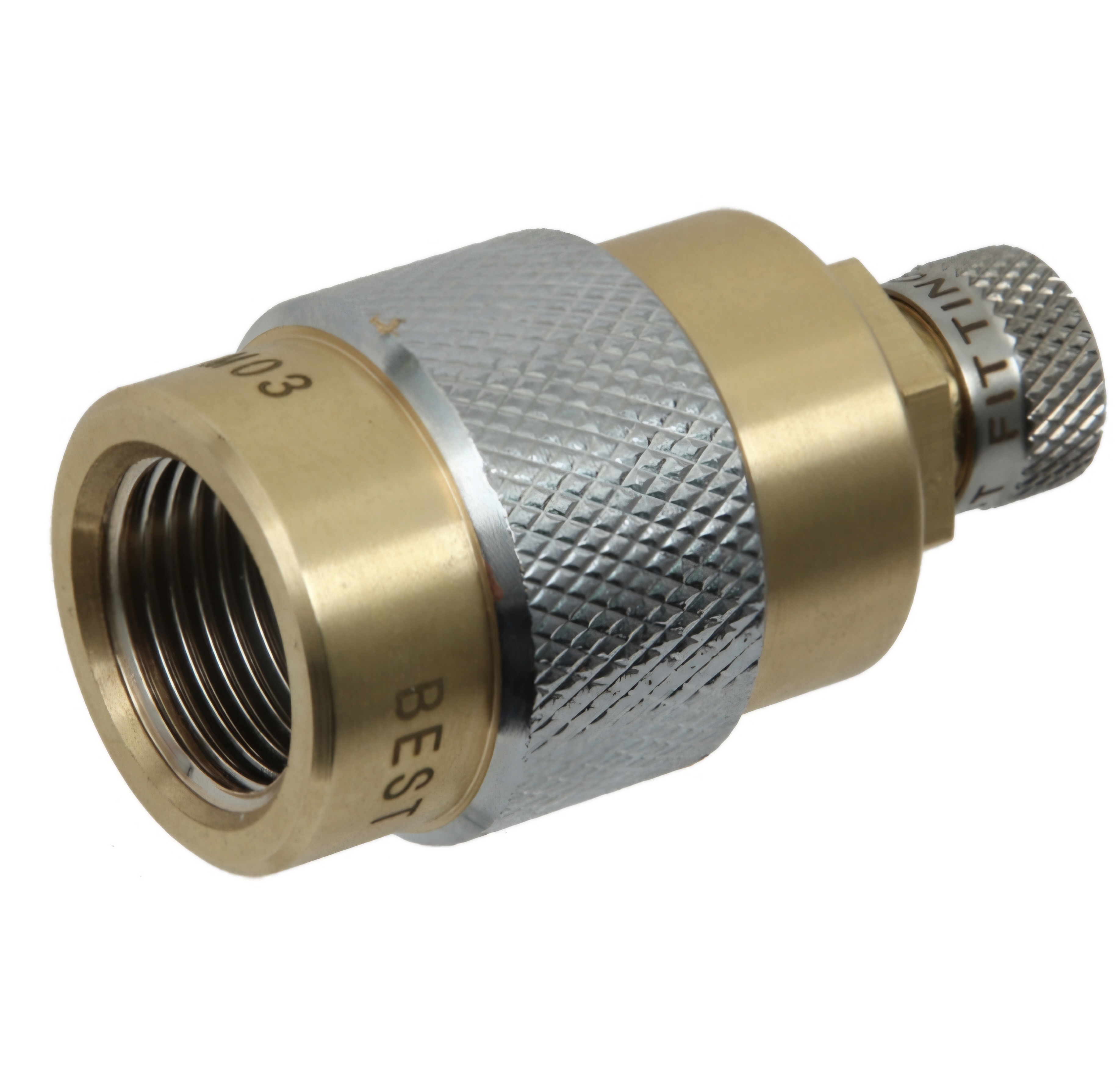

FX  What type of seal do Dreamline Classics use on cylinder air gauge?
According to the parts list I have, it's a small plastic washer. However, I contacted Utah Airguns, and they said the washer was switched out for an x-ring. I picked up some x-rings, and while they create a good seal, they make the gauge stick out a bit too far. This, in turn, causes the dust cover to sit out too far. Was there a miscommunication between me and Utah Airguns, or did FX make the switch and I just need to crank down on the gauge to get it seated right?
Thanks.

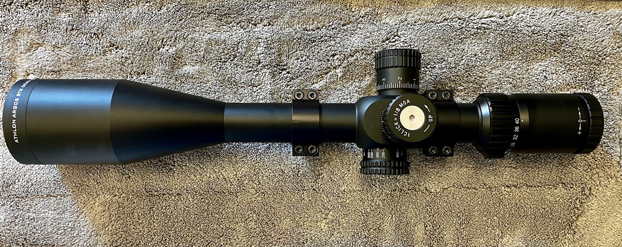

Optics  SOLD Sold:"Athlon Scope, ARGOS BTR GEN2 10-40×56, free shipping!
1 ea. SKU: 214071, excellent condition with "No limit" scope mounts! Free Shipping!!
ARGOS BTR GEN2 10-40×56 BLR, SFP, MOA list price,$479.00. ($399.99 plus $80.00 mounts), selling for $350.00!!
Sold gun. Excellent condition, no issues. Scope data in pictures below.

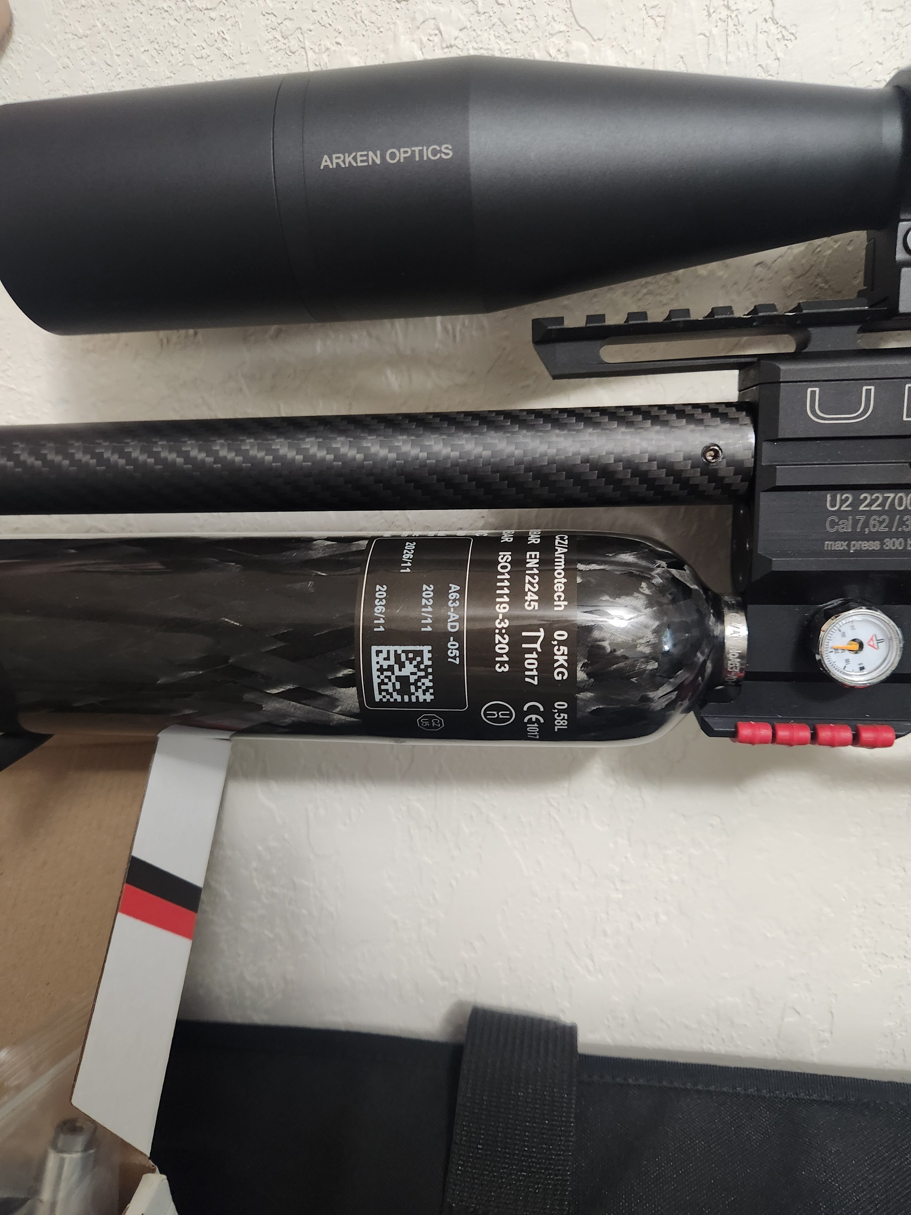

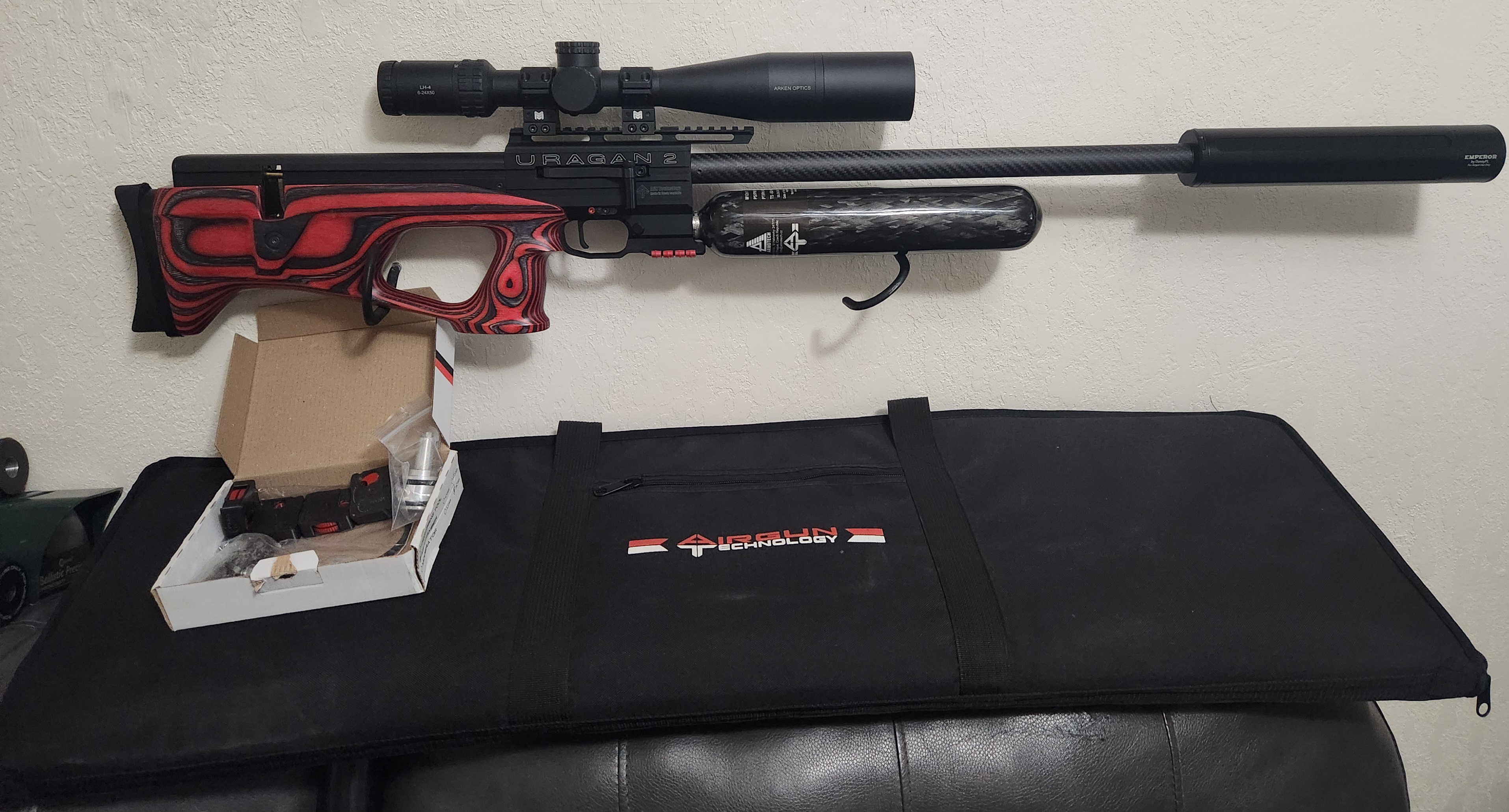

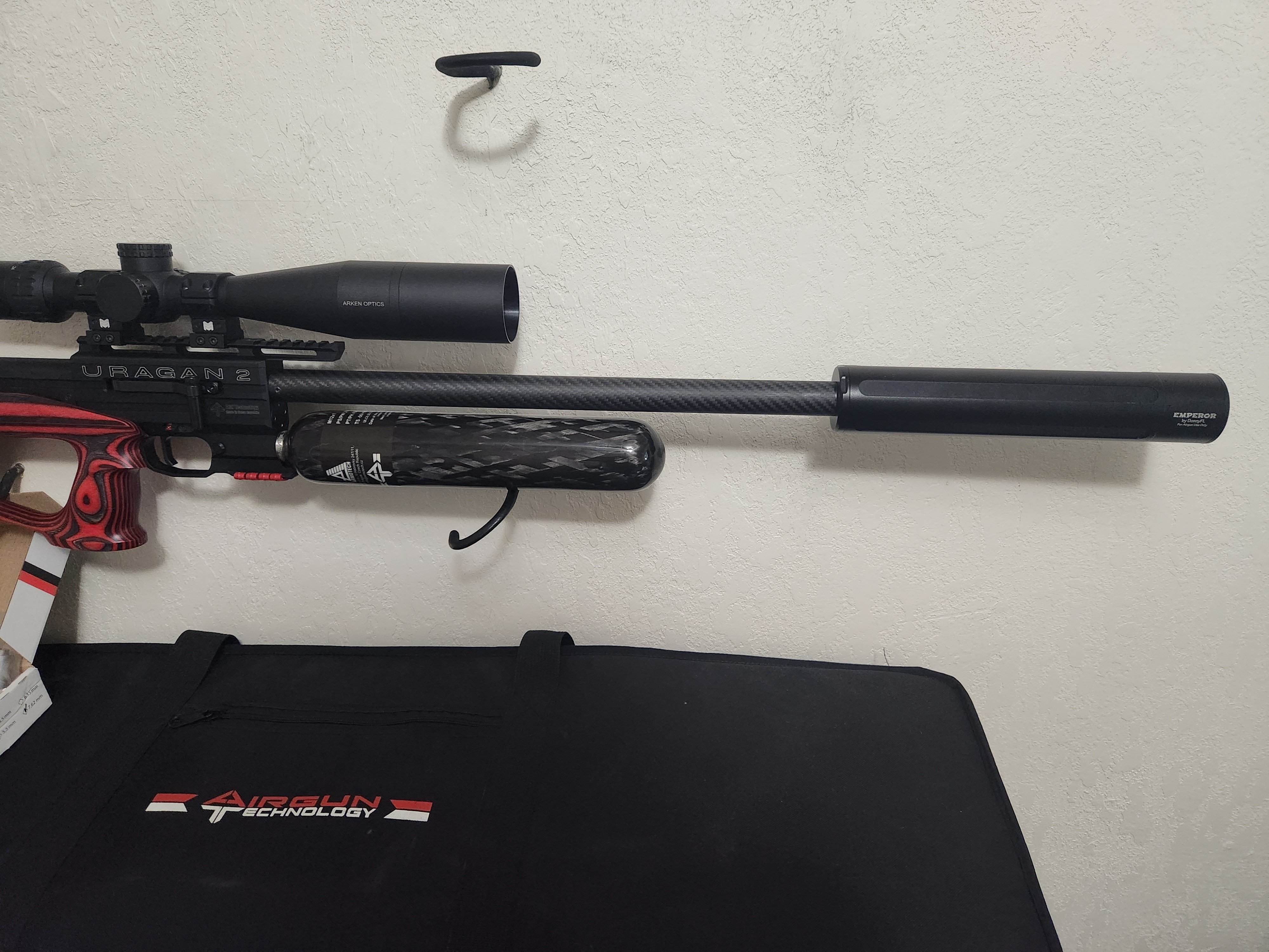

PCP Rifle  SOLD AGT Uagan 2 700mm .30 cal

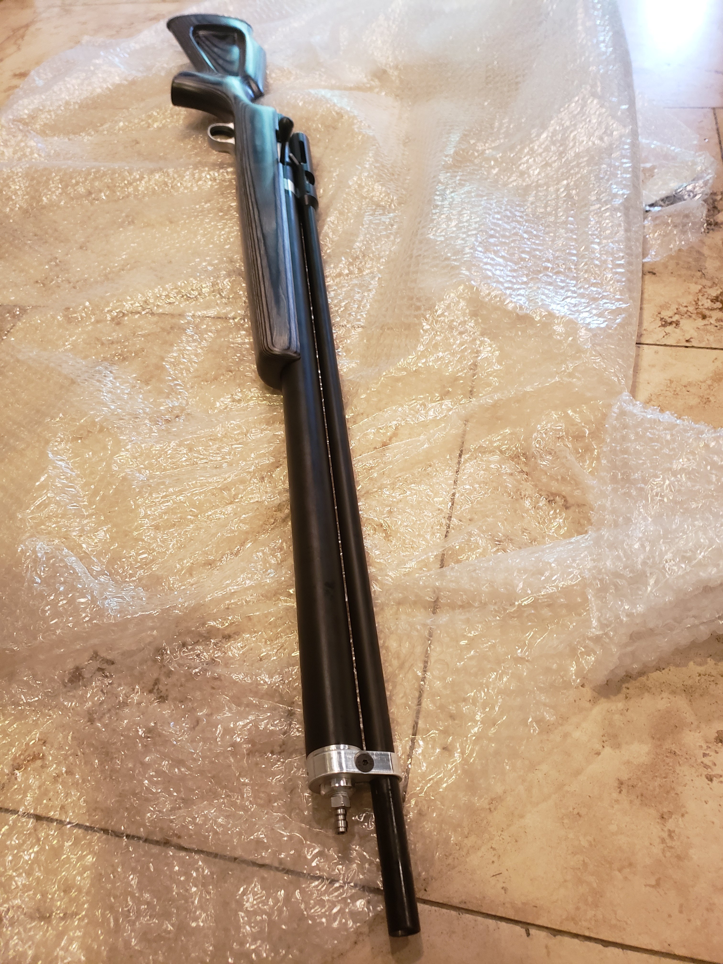

I have AGT Uragan 2 700mm .30cal, new balanced valve version 2. Has several upgrades:
-African Air Ordance power kit(heavy hammer, heavy spring)
-Huma regulator, stock reg included
-Larger factory AGT 580cc carbon fiber tank
-Carbon sleeved tension barrel
-Custom carbon fiber shroud with m18×1 threads for donnyfl
-Original AGT soft case and all original parts included fill probe, fill probe plug
- 4 magazines total
-Upgraded red laminate stock
Shoots heavy 50grn jsb pellets and heavy slugs very accurate. Loves NSA 62 grn and AVS 60 grn .3063 slugs and is truly a shooter. I have several had several AGT's vulcan and uragan's over the years. They are built high quality and very accurate. This one has several custom parts that you won't find on any other Uragan 2. Barrel tensioner system is threaded and vented. Tensioner increases ridgity and reduced barrel harmonics. I had the carbon fiber shroud made, Its lightweight and it's extremely quiet with Donnyfl.
Asking $1350 shipped (scope not included)
