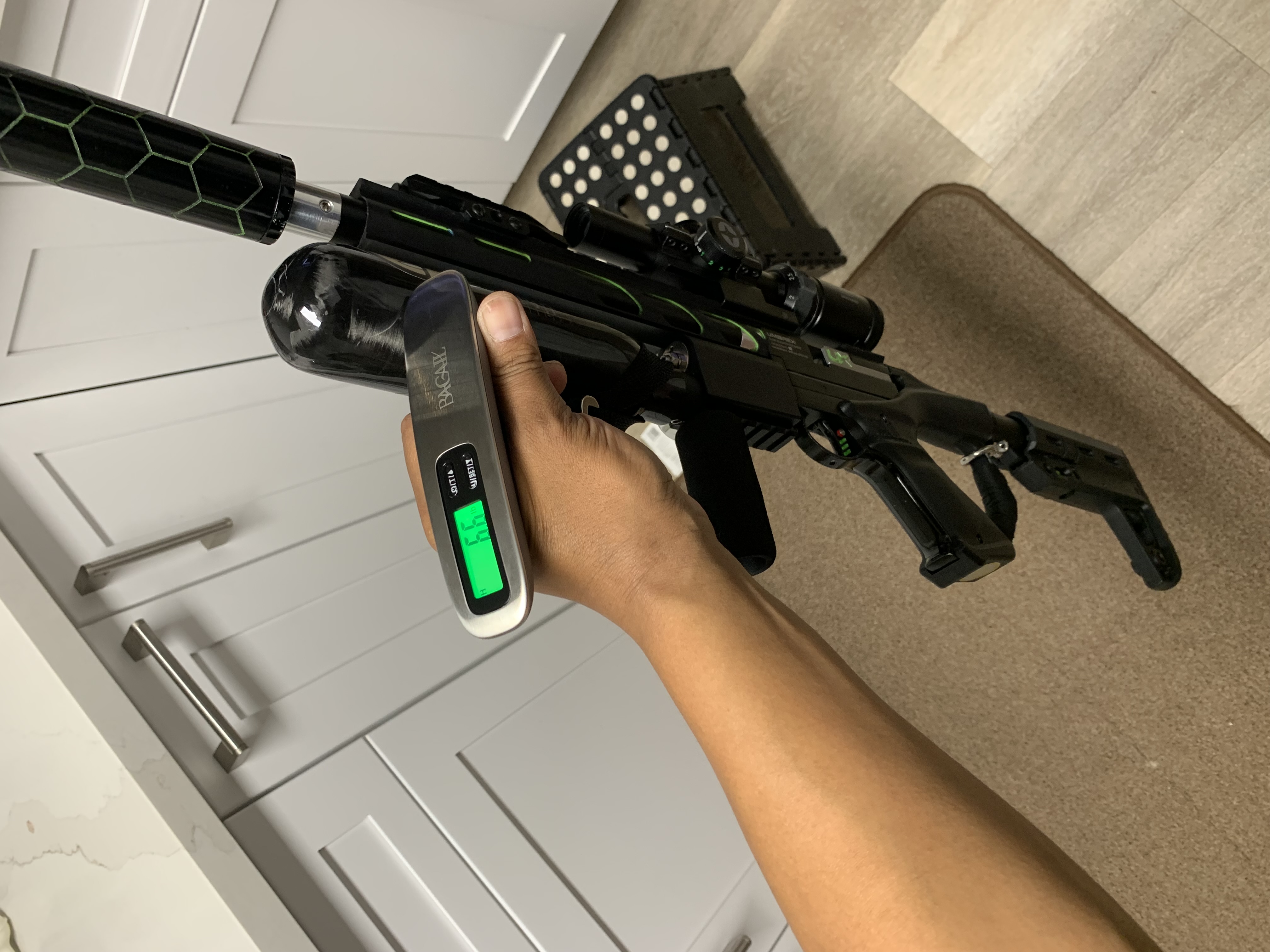

let’s do weigh-ins!
Just as the title says, let’s see the weight of your most used guns! lightweights, middleweights, or heavyweights.. all are welcome, no pressure. we all know big girls get love too 😂 you player pimps are welcome to share more than one if you want.
this is a good opportunity for the community to see what kind of weight to expect from guns they may be interested in getting in the future.
i’ll start..
notos with a heavy moderator 6.6lbs

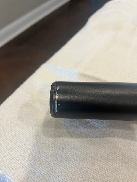

Airgun Technologies  Vulcan 3 burrs near the crown
Hi all,
I have Vulcan 3 since March but I shot it only couple of times testing various pellets and slugs with mixed results, mostly bad.
Since I've put through it probably 10 or more different pellets and slugs from few different manufacturers, I thought it could benefit from a good barrel cleaning.
Unfortunately I've noticed burrs some 1/2" from the crown, probably tool marks when they made the crown.
Most of those I'll probably be able to polish out. I have VFG bore cleaning compound and it's quite a good stuff.
But, two are a bit bigger and those will not polish out with any paste,
What could I use to get out those bigger burrs?
They are not something unspeakable off but non the less, they are burrs which catch on pallets/slugs just before they exit the barrel and I believe that removing those would significantly improve on groups.

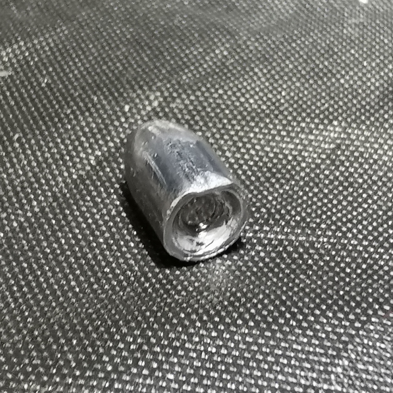

RTI  Mora .357 issues
I recently received an RTI Mora .357 sniper that I had ordered. First impressions, it’s a beautiful gun, feels great in the hands, very light and smooth cocking and great trigger, also very quiet. Out of the box from Talon Tunes it was shooting 100gr zan slugs at around 215 fpe.
Issues I am having: pellets and slugs are clipping inside of the air stripper in the shroud, throwing accuracy way off. I have tried 3 different weighted Zan slugs, 2 different weights of NSA slugs, some home cast slugs and JSB pellets. I opened up the air stripper a little which helped accuracy without the provided hush 50 silencer attached, but now clips with the silencer attached. I’ve spent some time shooting without the silencer. When I go to air up the gun and then return to shooting, the point of impact changes and I have to zero it again, this happens everytime. During one of my shooting sessions, the shroud base that clamps to the barrel blew back and I got blasted with air. Now the trigger is slowly moving further and further back into the handle. Currently have about 400 rounds shot through it. The gun did not come with the cheek rest or a user manual which I have read others complain about as well. Not exactly what I expected from a gun in this price range, but they are a new release and I guess there will be bugs to work out. Currently working with Talon Tunes to see what we do from here.
Just wanted to share my findings and see what others might be experiencing.

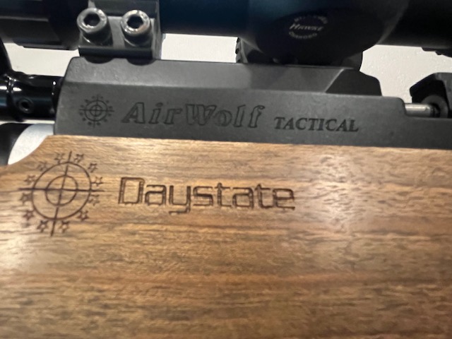

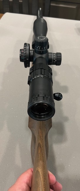

PCP Rifle  SOLD Daystate Air Wolf .25
Daystate Air Wolf Tactical .25
Has 2 magazines and a single shot tray.
Carbon bottle.
Huggett moderator and shroud.
New battery.
Orings less than 1 year old.
New LCD screen.

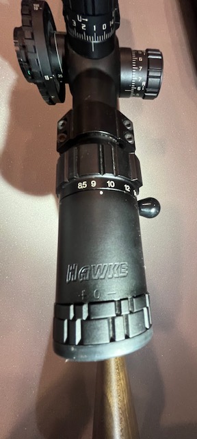

Scope is Hawke (Sidewinder, I think) 8.5x25x42 Half mil-dot. Illuminated
Compensator has a scratch on the end of it. (pic included)
When I switched to a carbon bottle, the oring started leaking so they all got replaced. I THOUGHT the battery was dying so i replaced it only to learn that the screen was failing. My mistake means new parts for you.
Can ship within the ConUS
Located near San Antonio Texas
$1400
Reactions: Richeick

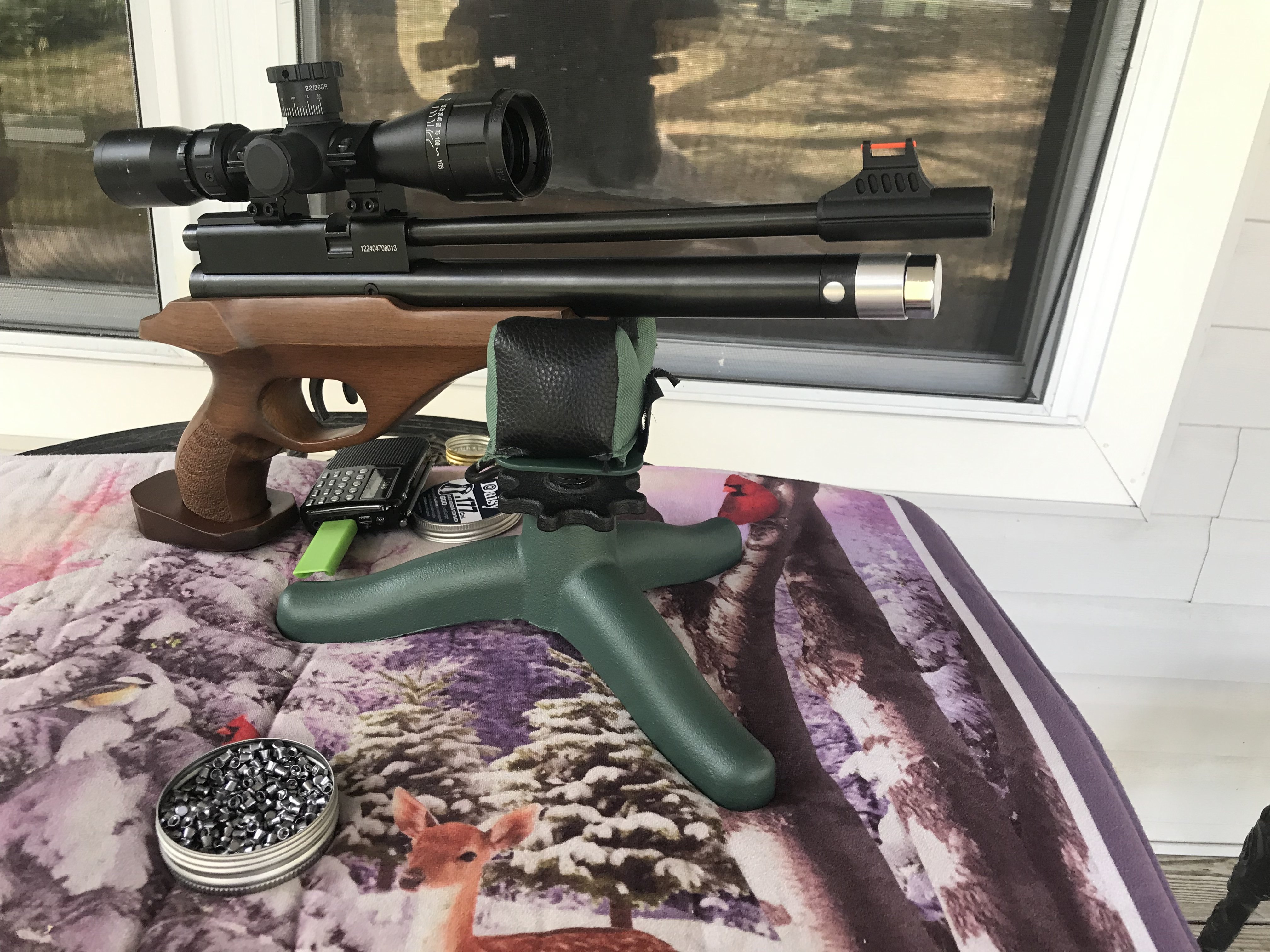

I just can’t express it well enough, however I’m super excited about just how great a $150. Pcp pistol can be enjoyed! I have 2 each of the Beeman 2027 and 2028 and two will be Buck Railed into carbines. If you are interested in a fun gun try one of these! Don’t think you will be disappointed! Charles

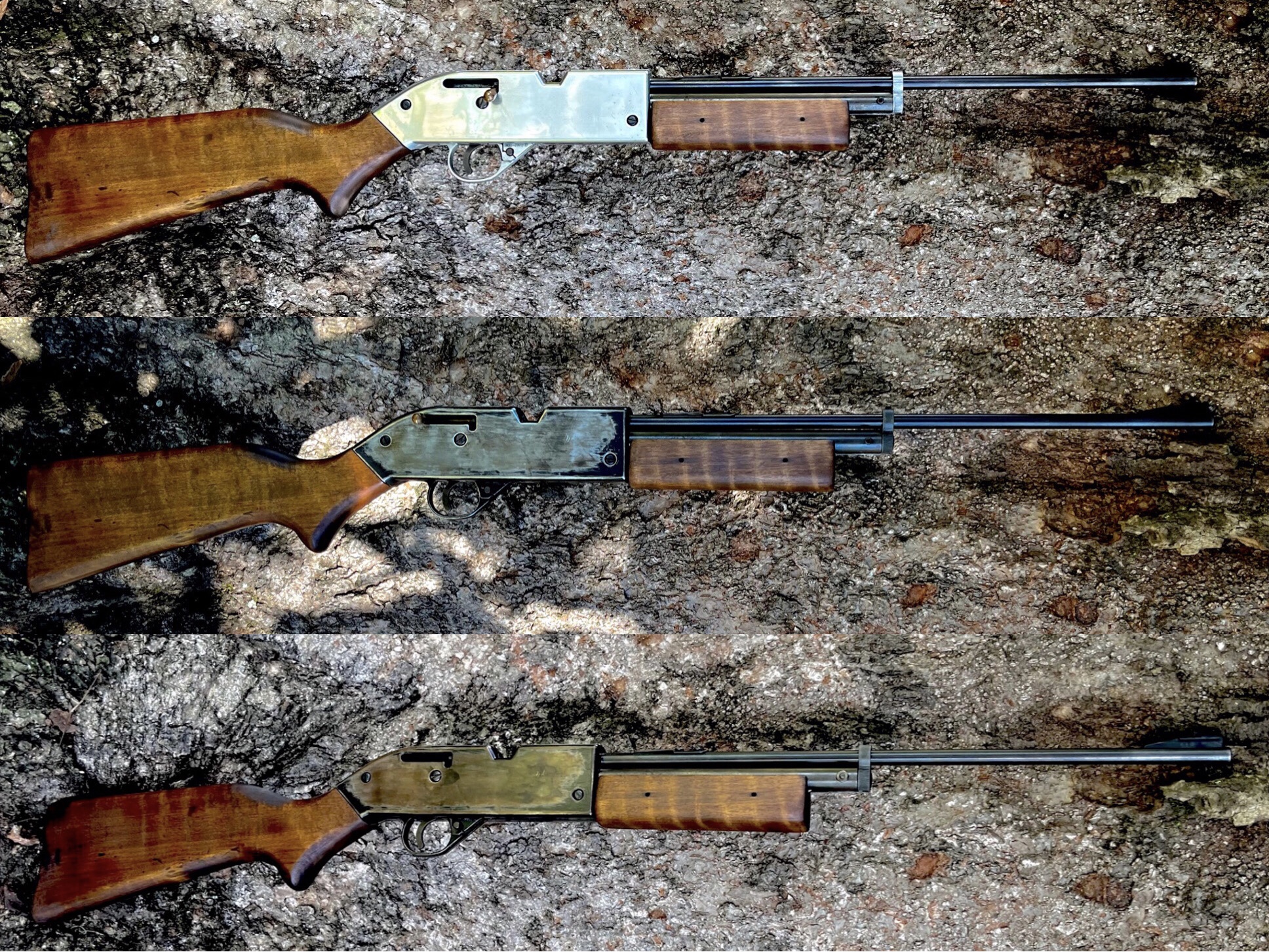

N/A  Pawn Shop Find - $15
Picked up this “Revelation” model, made by Crosman for Western Auto Supply Co. It’s a rebranded Crosman 760. First three numbers are 576, so I think it’s a 1976. I didn’t take an initial picture but it was very rough. Non functional. Rusty, nasty looking wood. A $15 special. It’s a smooth bore. I decided to embrace its rustic character. I had this old Williams scope lying around forever. Still waiting on a pump cup, so the picture is a mock with no internals. I’m still trying to decide which receiver finish I like the best. The first one is just polished. The middle one is distressed. The bottom one is fully colored. Opinions welcome.

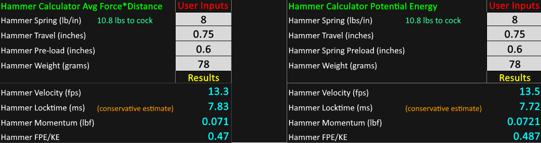

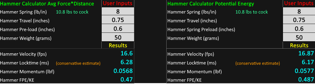

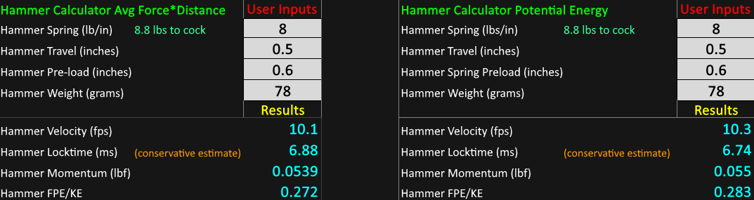

Shown below is a relatively stock looking .25 cal Marauder. Lock time is roughly 7.8 ms, force to cock the gun is 10.8 lbs.

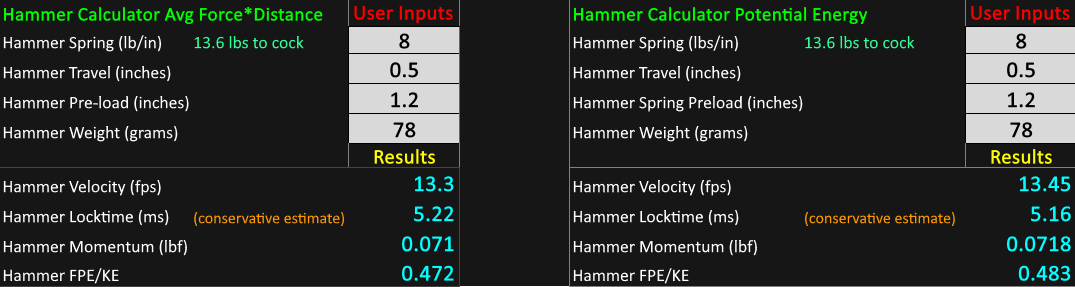

Now, what happens if we simply reduce the Travel from .75" to .5", using the adjustments allowed on the gun by increasing the distance the striker protrudes from the hammer...
The velocity is reduced as well as lock time from 7.8 to 6.8 ms, but at a great expense of reduced momentum and kinetic energy transferred from hammer to valve stem, which will result in much less lift and dwell being produced, if the hammer can even knock the valve off its seat. What would be needed to restore the momentum and energy transferred? More spring and/or hammer weight, but adjustment within the gun only allows spring, so you'd have to crank down on the preload a LOT to restore power back to the original settings, or fabricate a new hammer.
Shown here, is an increase of .6" of preload which restores the energy needed to operate the valve, which knocked down lock time even more, down to 5.2 ms, however, now the gun is much more difficult to cock, at 13.6 lbs. For a bolt action that is a bit much for most users, however for a side lever gun, no big deal.

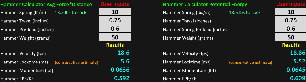

What if we want to change hammer weight, and leave the stock travel alone? Lets reduce the hammer from 78grams to 50 grams.
Now we've lost quite a bit of momentum, which will result in less dwell, so we will have to hit the valve harder with more spring be it preload or a higher rated spring, producing more lift, to restore the necessary dwell we once had, which will result in, again, a harder to cock gun. This simple calculator won't tell you the exact amount, but below is an example of what probably would restore the gun to original power...
Shown is simply an increase from 8 lb spring to 10 lb spring...thus the gun is harder to cock than stock (from 10.8 lbs up to 13.5 lbs), however, the lock time is now 4.4ms and we exchanged momentum for more kinetic energy, which is favorable for mitigating hammer bounce.
As you add lift to a valve (primarily determined by KE/FPE), you add dwell as it takes the poppet longer to return to the valve seat, however, if you were to add dwell with a heavier hammer, you won't add lift. Once lift exceeds roughly 1/4 of the valve throats porting equivalent (after considering the cross sectional surface area of the stem within it), your valve's mass air flow rate does not increase, this is commonly referred to as the valves flow curtain, in effect, this means once the curtains height is exceeded, you're creating more dwell, and not adding more flow rate. An example would be a .23" ported gun, once lift exceeds roughly .0575", the flow rate does not increase, only the duration of max flow rate the valve can achieve. Heavier hammers allow more dwell by remaining in contact with the stem for a longer period due to conservation of momentum. Momentum decays much slower than Kinetic Energy, akin to comparing stopping a train going 15 mph versus stopping a drag car going 100 mph, which is why heavier hammers are more prone to hammer bounce, as their momentum conservation is greater than that of a lighter hammer, while kinetic energy decays rapidly in inelastic conditions, which is what we experience in our PCPs, and is more favorable for managing hammer bounce, as well as producing quicker hammer lock times.
One may ask, why doesn't hammer weight greatly effect kinetic energy by itself? The answer to that is, the kinetic energy is stored in the hammer springs tension once compressed, adding weight to the hammer results in less hammer velocity, resulting in near equal energy output upon decompression of the spring, given optimal conditions.
What is Hammer Gap? Commonly referred to as free flight, it is a distance where the hammer is traveling without the assistance of compression from the spring, this in essence, basically kills two birds with one stone. The distance that the hammer has to travel is the gap distance twice prior to returning to the valve stem, so a .03" gap forces the hammer to travel .06" prior to secondary strikes. This distance allows time for the poppet to return to its seat and fully compress, making it more difficult to re-open, as well as a distance that assists in the decay of both momentum and kinetic energy that is transferred by the closing force of a valve, that's right, the valve closes often so violently, that it sends the hammer flying back, and without gap or a short stiff spring or the like in place, what happens is re-compression of the hammer spring, which in many conditions, produces enough of both momentum and kinetic energy to strike the valve again with enough power, before the poppet returns to the seat, producing a secondary blast of air that doesn't contribute to projectile velocity. Only caveat to hammer gap is, the more you add, the more you have to compensate the 'free flight' with added spring pre-load, or hammer travel. Nominal gap is generally 1mm-1.2mm or .04"-.047", however bigger bores with heavier springs likely benefit from a bit more.
Attached is a basic spreadsheet that will calculate all of the above data. It may be useful to someone so, I thought I'd share a stand-alone of these calculations, available as XLSX.
Keep in mind this is a simple spread sheet meant to represent the relationship between hammer travel, hammer spring pre-load, hammer weight. No losses are calculated in the sheet currently, such as gravity, friction, angle of shot, and air resistance.
*edit* modified the spreadsheet thanks to @caliusoptimus for pointing out a flaw in a calculation, spreadsheet now uses both Average force * distance method and a Potential energy method provided by caliusoptimus.
-Matt
View attachment Hammer_Data_Calculations.xlsx

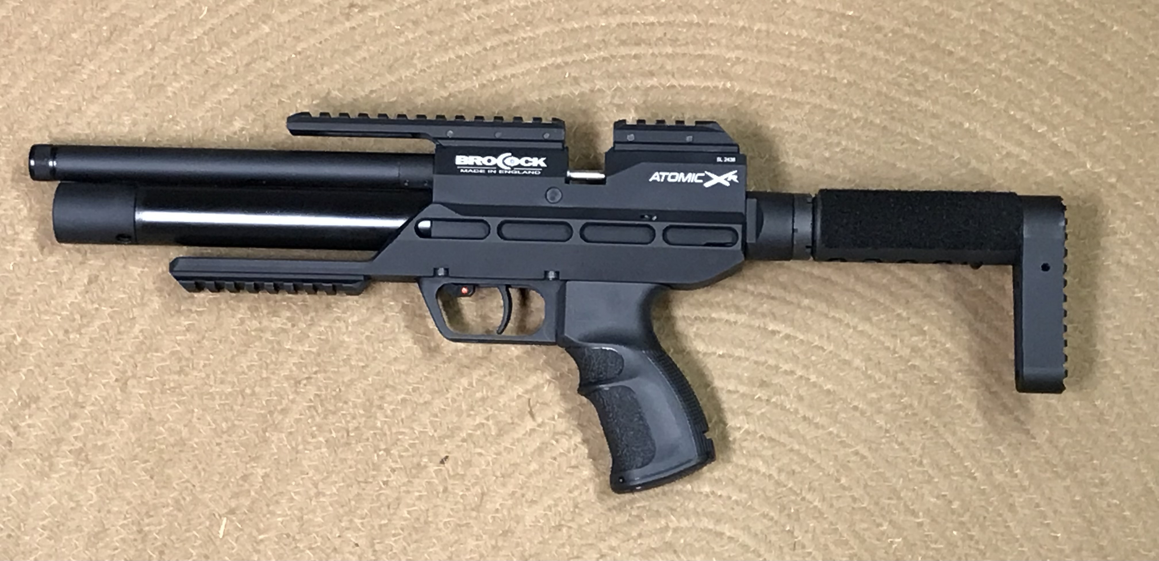

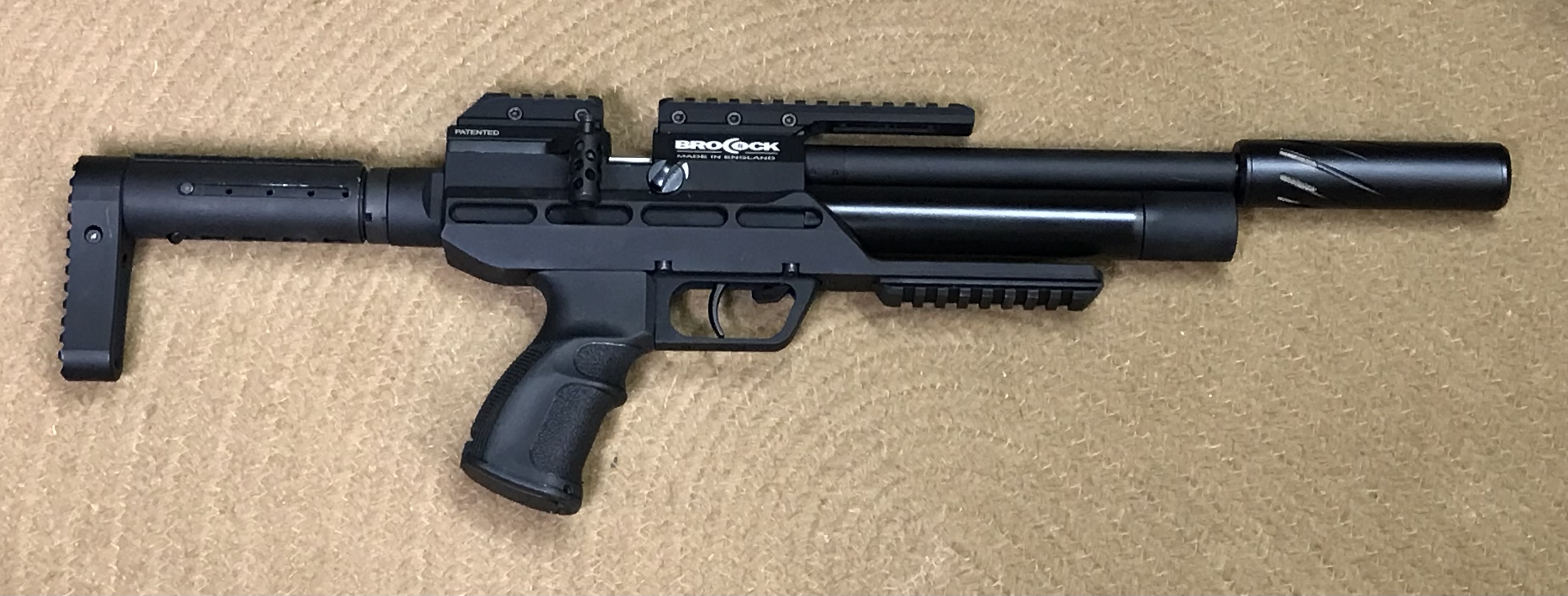

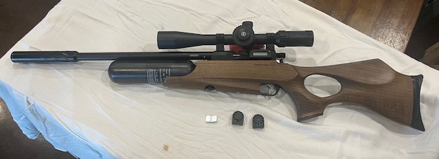

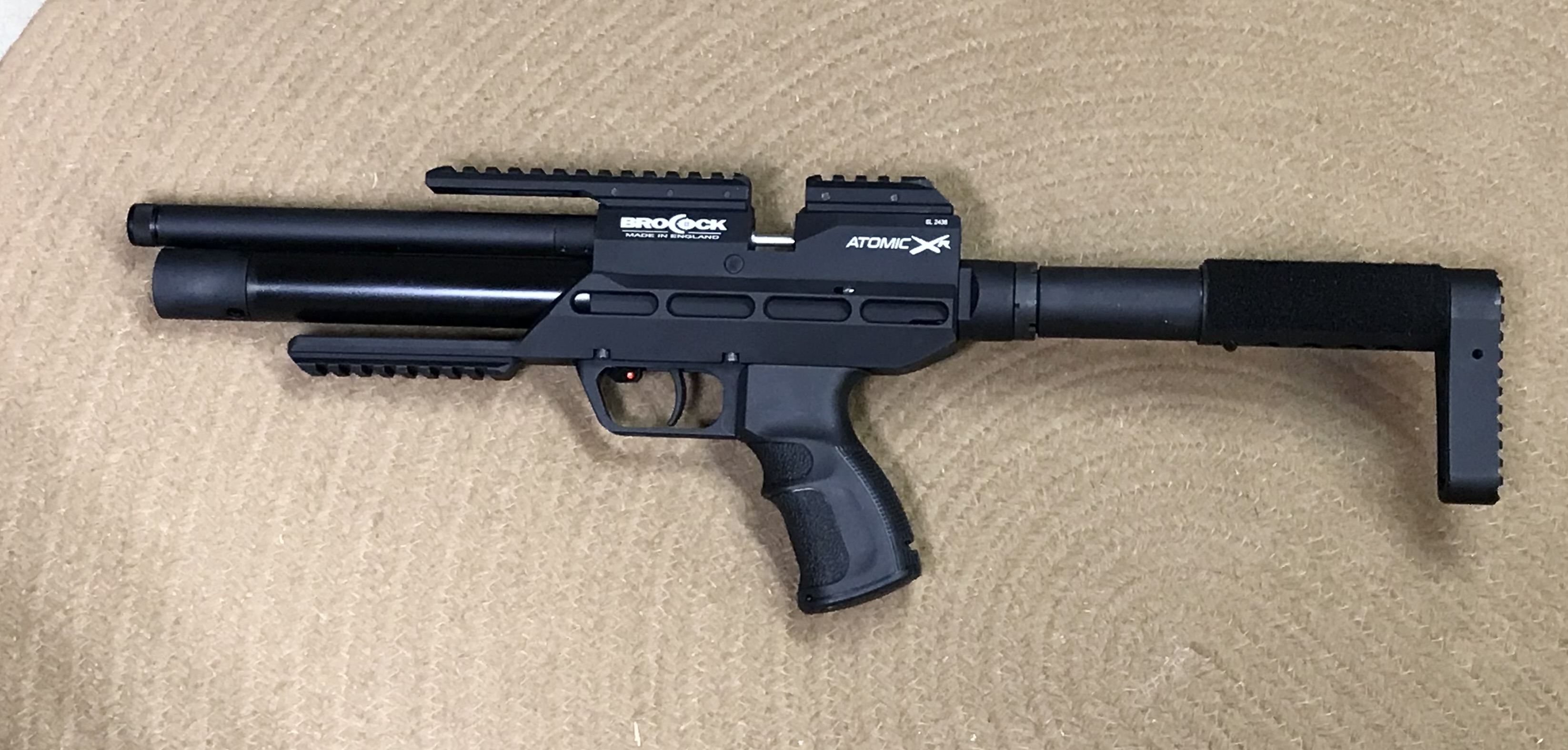

PCP Rifle  SOLD Brocock .22 Atomic.
Here we have a lightly used Brocock atomic in .22 caliber. Small rub mark on air tube shown in photo. Adjustable stock and a 0db moderator. Includes one factory flip down magazine, fill probe and double top rail. Last photo shows stock extended. $925.00 shipped OBRO to the lower 48 only. Prefer PPFF but regular PP is ok too.

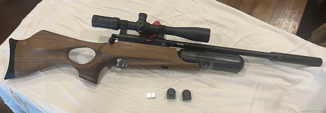

PCP Rifle  SOLD Daystate Huntsman Revere .177 Regulated
Selling my beautiful Revere because I don’t have time to shoot HFT. No damage. I’ve had since new. Gun shoots the 10.34 at about 870. Comes with one magazine, fill probe and a single shot tray. No leaks. No issues. No scope. Asking $1400 shipped will ship CONUS. UPS GROUND AND ADULT SIGNATURE REQUIRED
