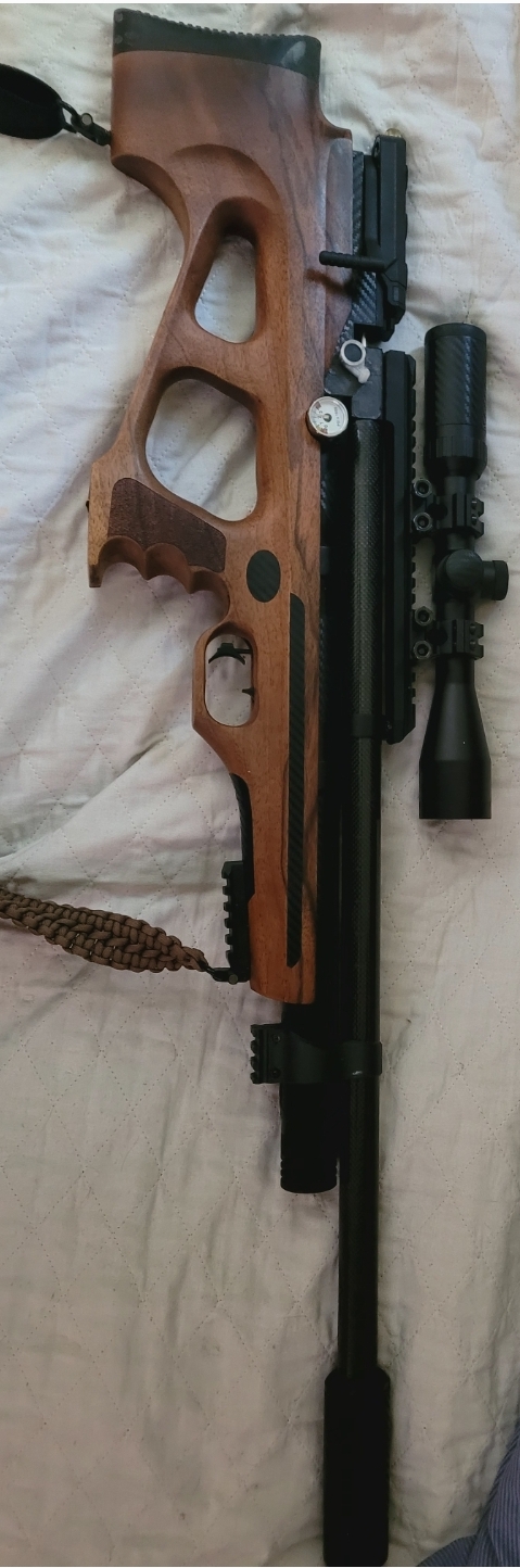

PCP Rifle  SOLD SOLD...Chalenger Pro FS/FT...SOLD

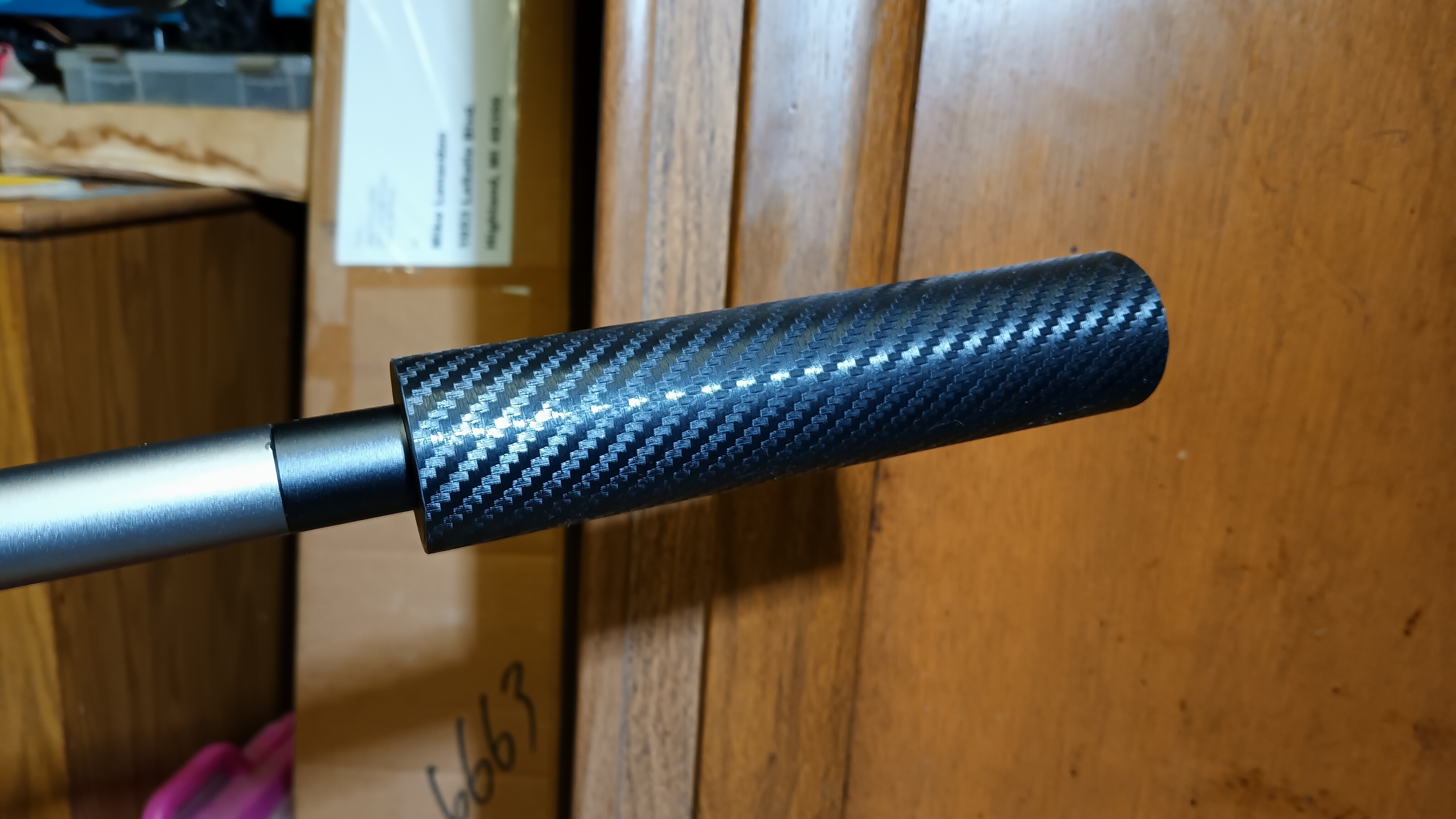

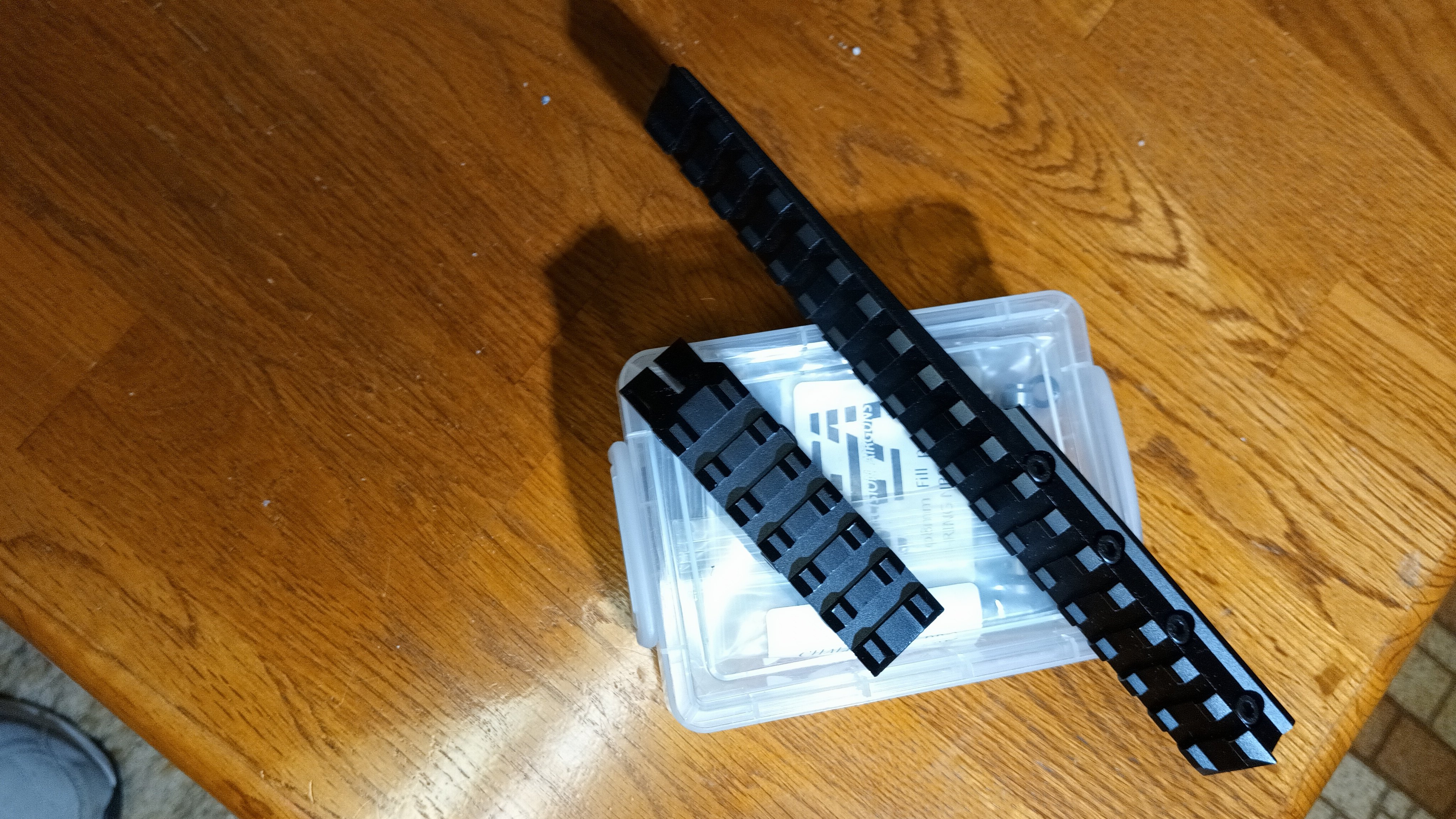

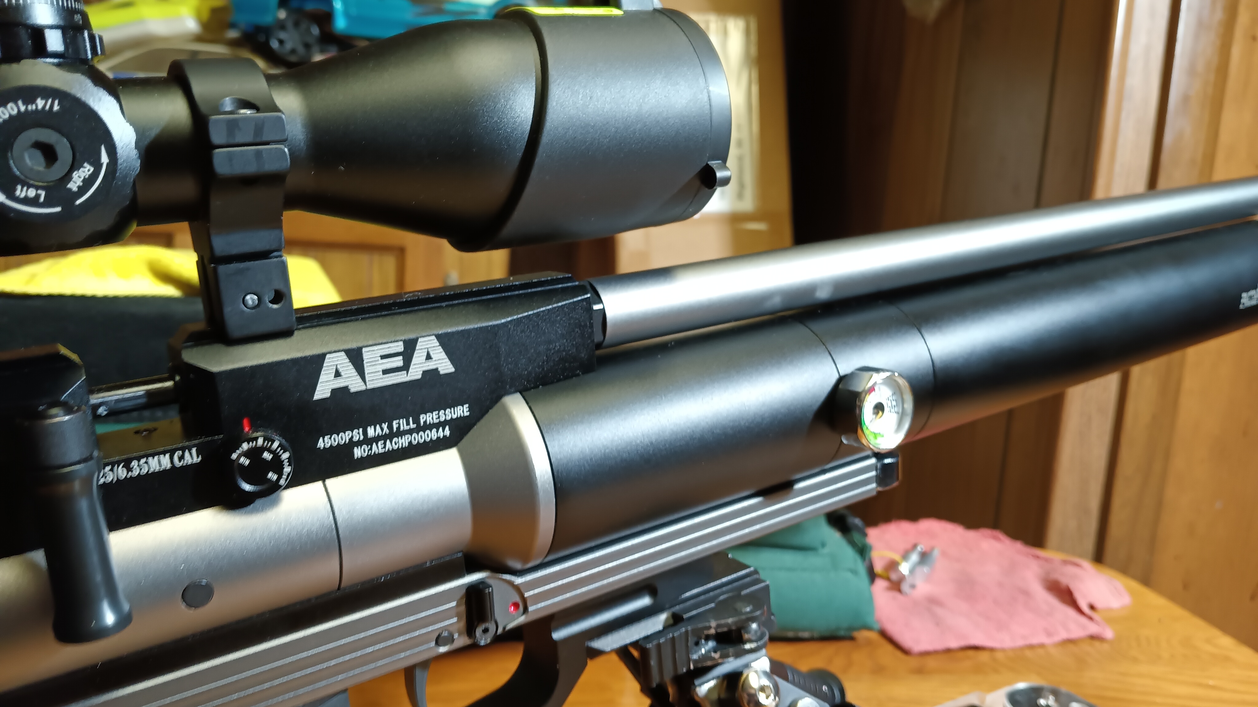

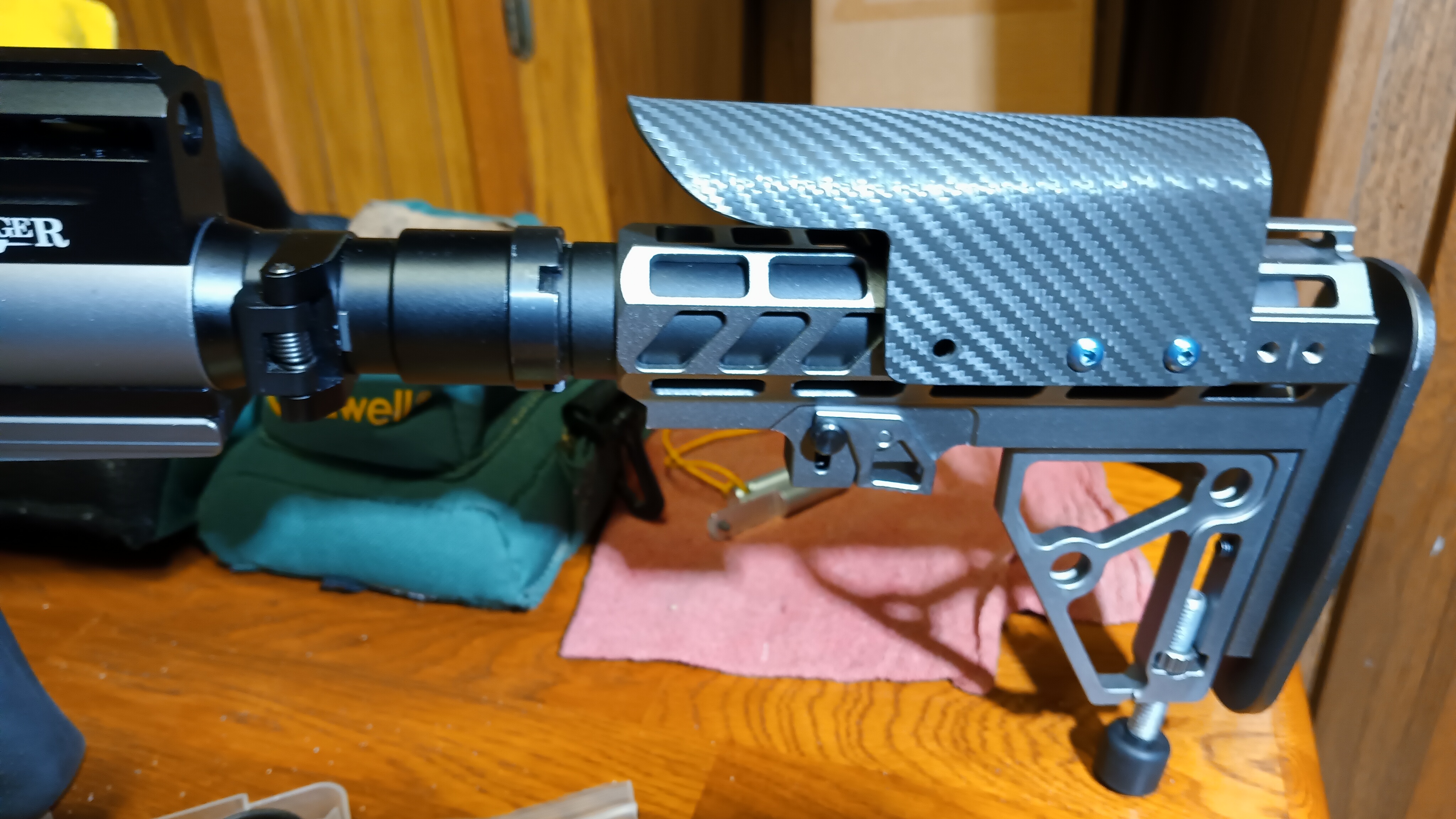

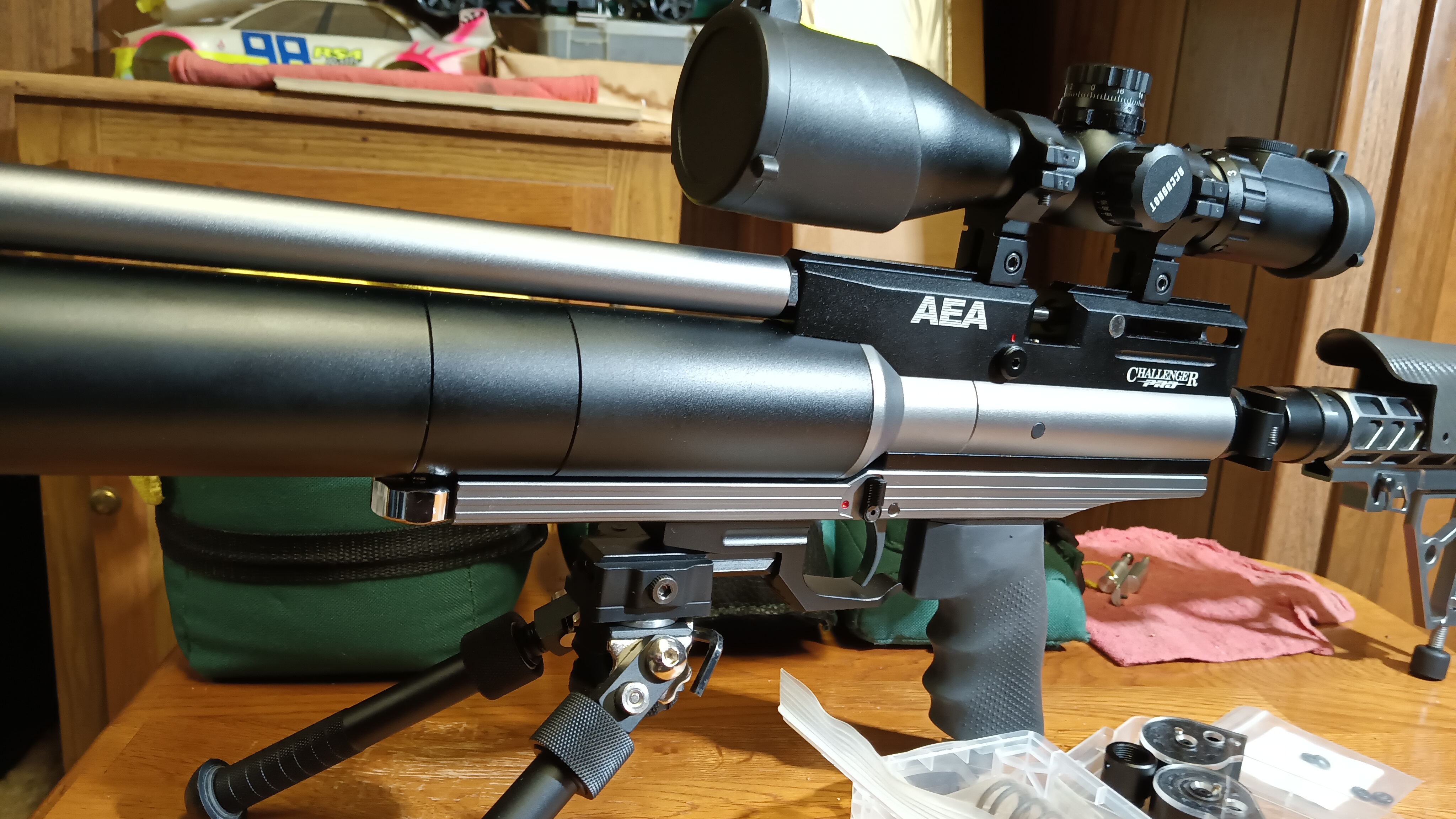

.25 cal, shoots fine, holds air functions as it is suppose to. Reg is set to 125 bar, power knob is half way between min and max power. H&H Baracudas at 930 fps. Includes Buck Rail can that I turned the texture off and wrapped in fake carbon fiber along with the cheek rest. Donny FL adapter, fill probe, extra orings, heavy and light spring, the two dove tail to pic rails, two mags, single shot tray, folding stock . Scope, bipod and rings not included.
It's been super dependable, it's in pretty good shape except for the 2 scratches shown. I shimmed the stock where it folds to tighten it up and added a set screw to the stock where it adjust the LOP to tighten it up also.
Purchased from a member here
Would like to get 450 (OBO) or trade for who knows what.

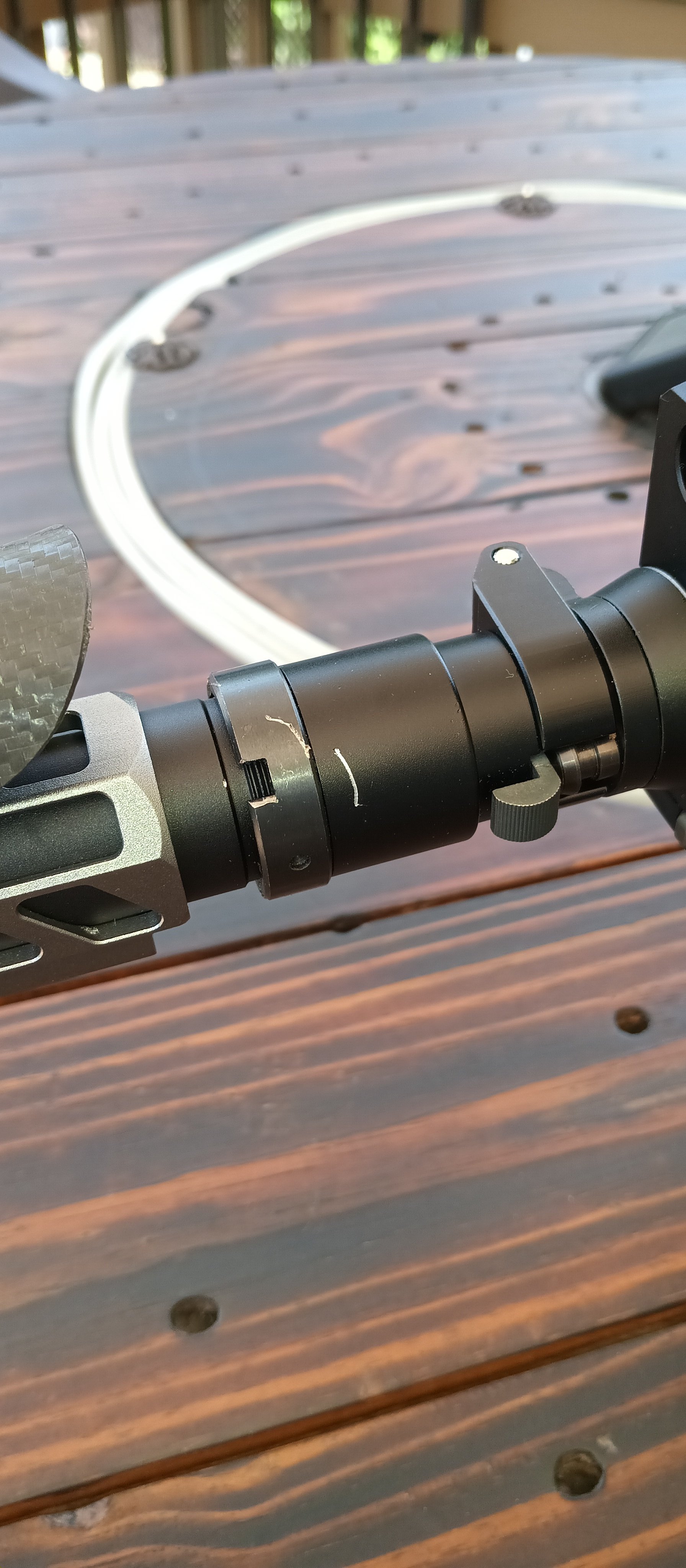

What is this thing underneath the scope bottom?
All my scopes have a flag bottom. Then this new scope I order came in and it have this thing on the bottom of the scope at an angle. Not sure what it is but I used a pliers and turn it counter clockwise and it came loose. I kept turning it and there is a spring inside that pushed the whole thing out. I was like wtf lol. I tried to screw it back but the spring was so hard. You have to really push it down and twist it back. Took me awhile but I was able to screw it back. So what the hell is this thing for? Why most scope don't have it and then there is this scope that have it.

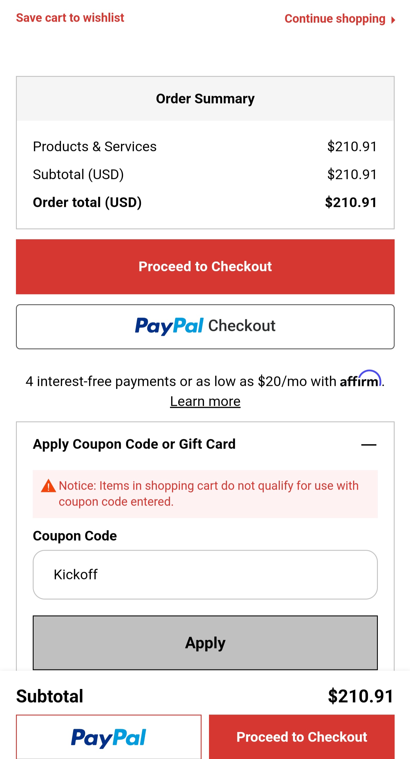

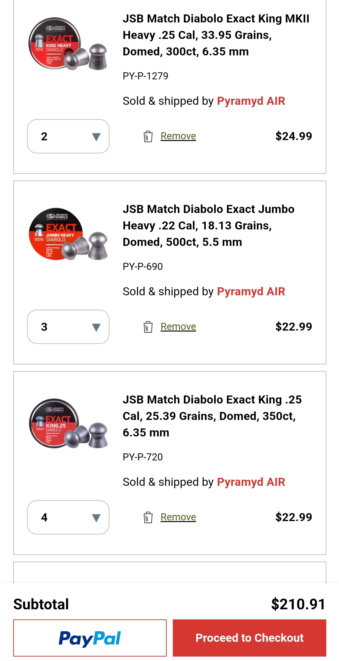

Got too excited over prymaidair 20% off code.
So yall probably all saw that prymaidair is having a 20% off code for the holiday. Usually their coupon codes are 10%-15% only. I think this was the first time I've seen a 20% off code. So what did I do? I went to their site and put a bunch of jsb pellets .22 and .25 cal. I put 12 tins in the cart and total was $210.91. I enter the 20% off code and guess what happen? It didn't work. Wtf. Then I read the fine print, Benjamin and umarex products only. Lmao. Guess I won't be ordering more ammo anytime soon. Deleted all items off cart. 😞 moral of story is, don't get too excited when you see something 20% off.

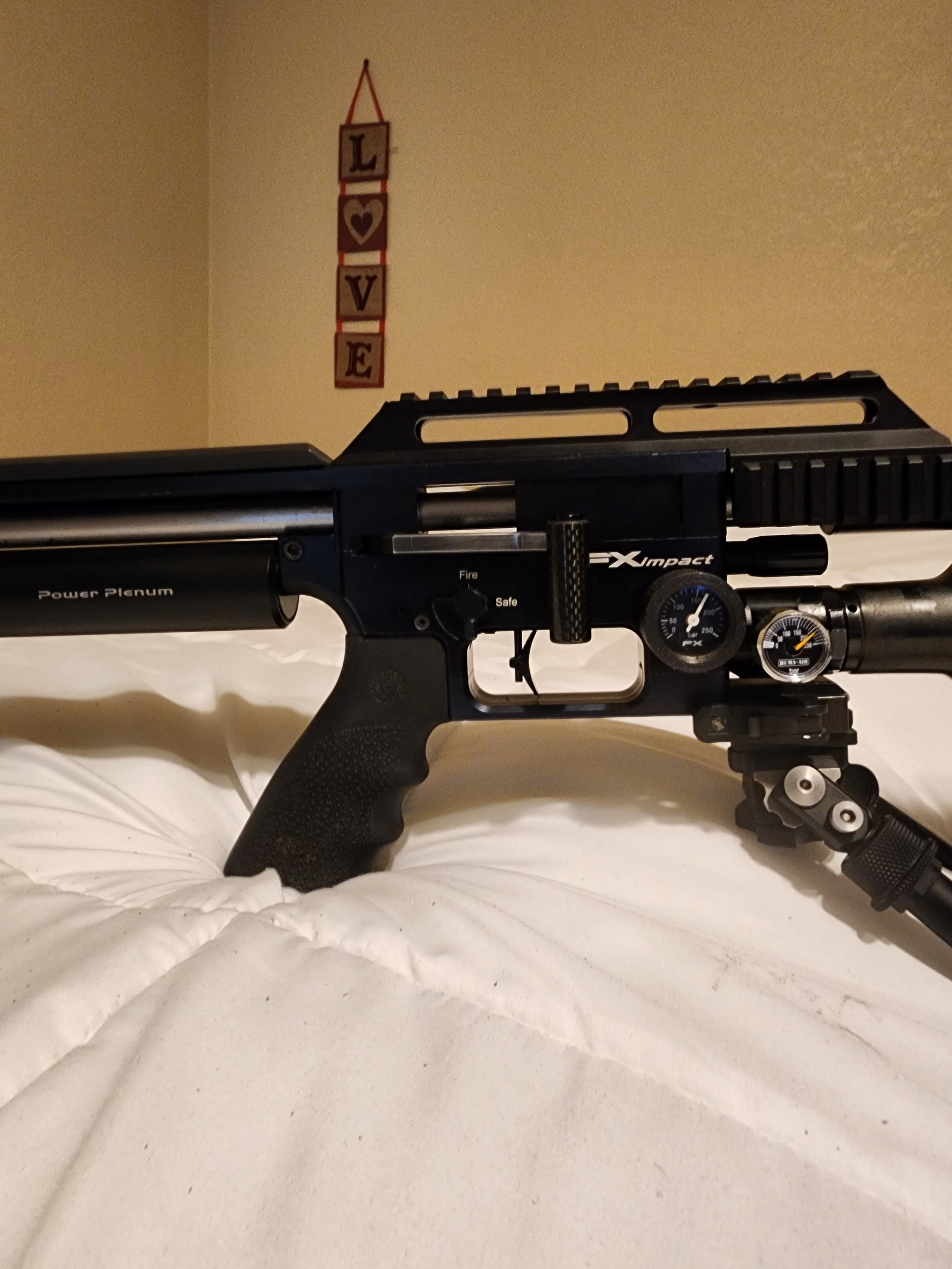

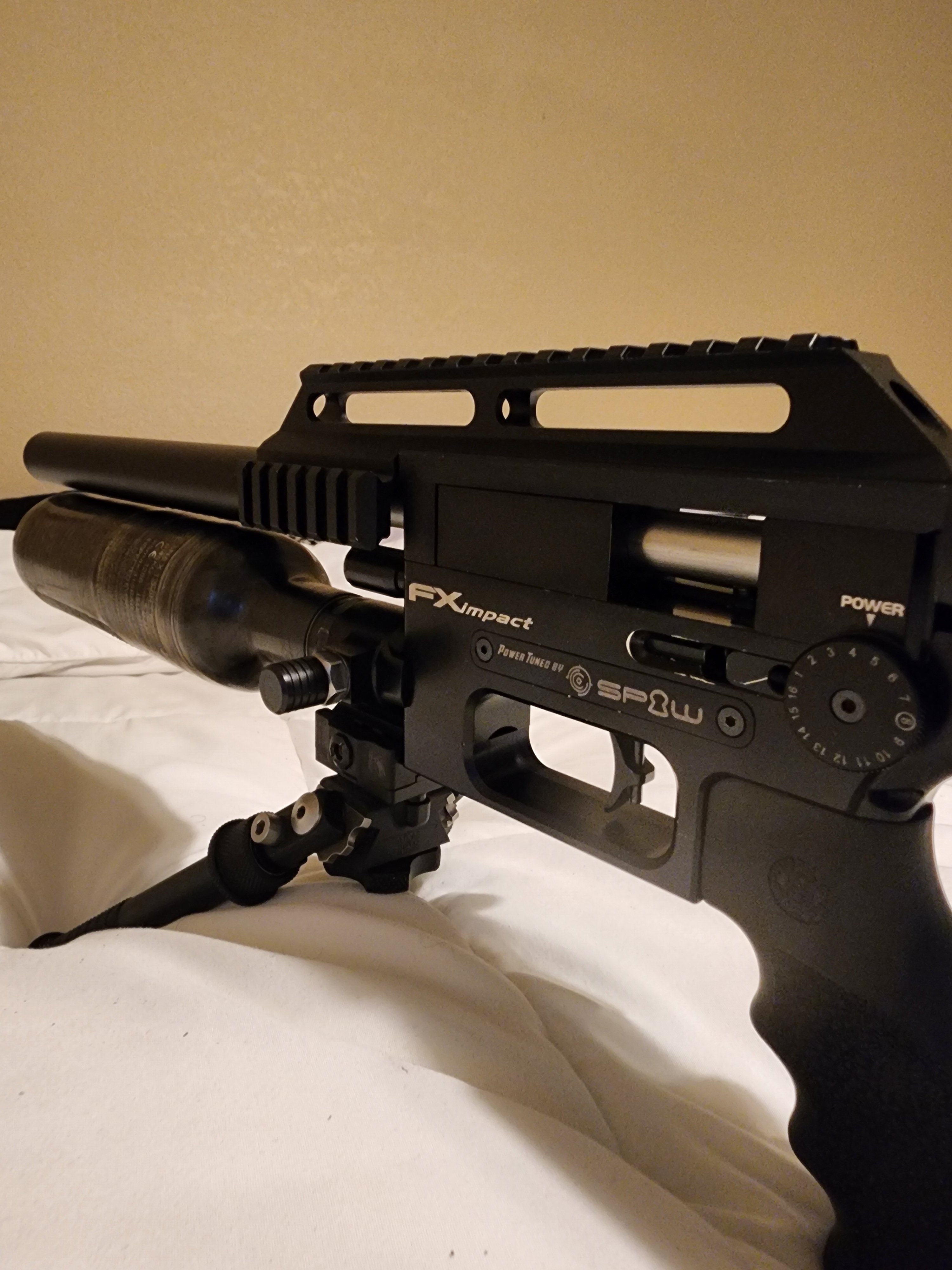

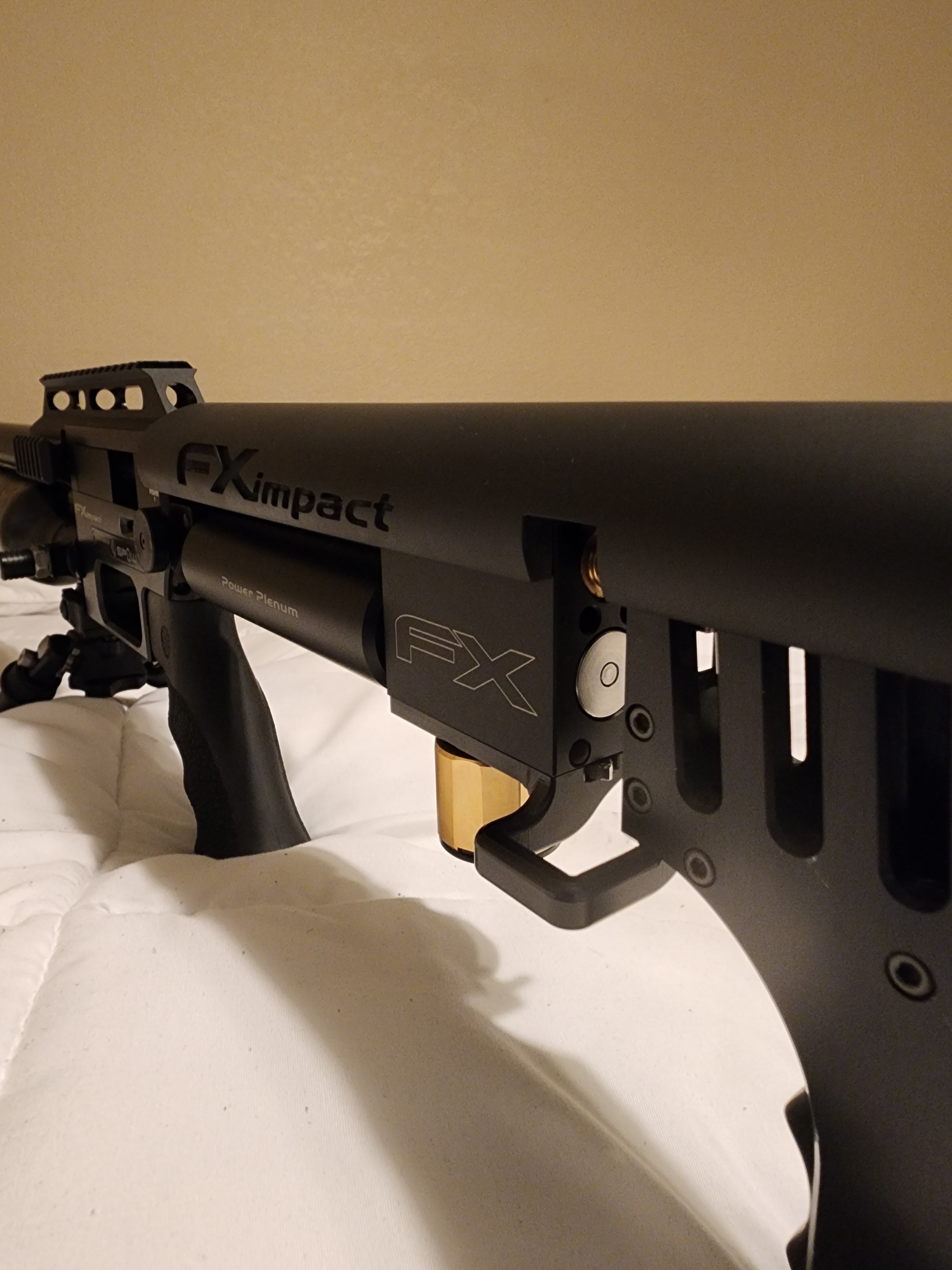

PCP Rifle  NLA FX Impact M3 with power block .22 cal 700 mm barrel with pellet & slug liners
1800.00 OBO shipped TYD

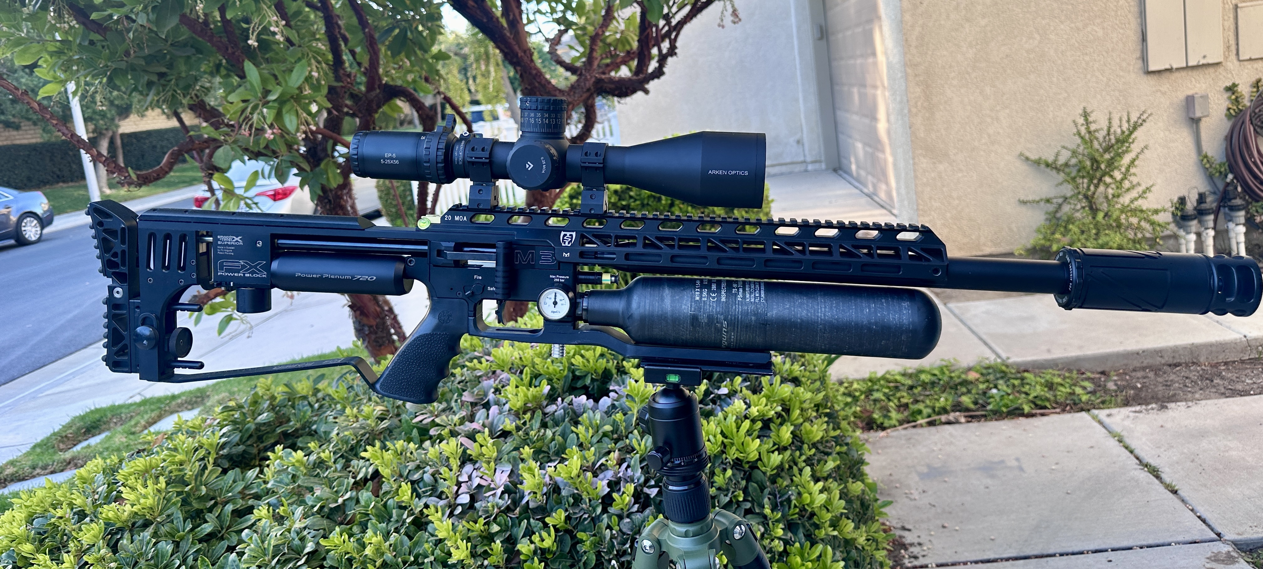

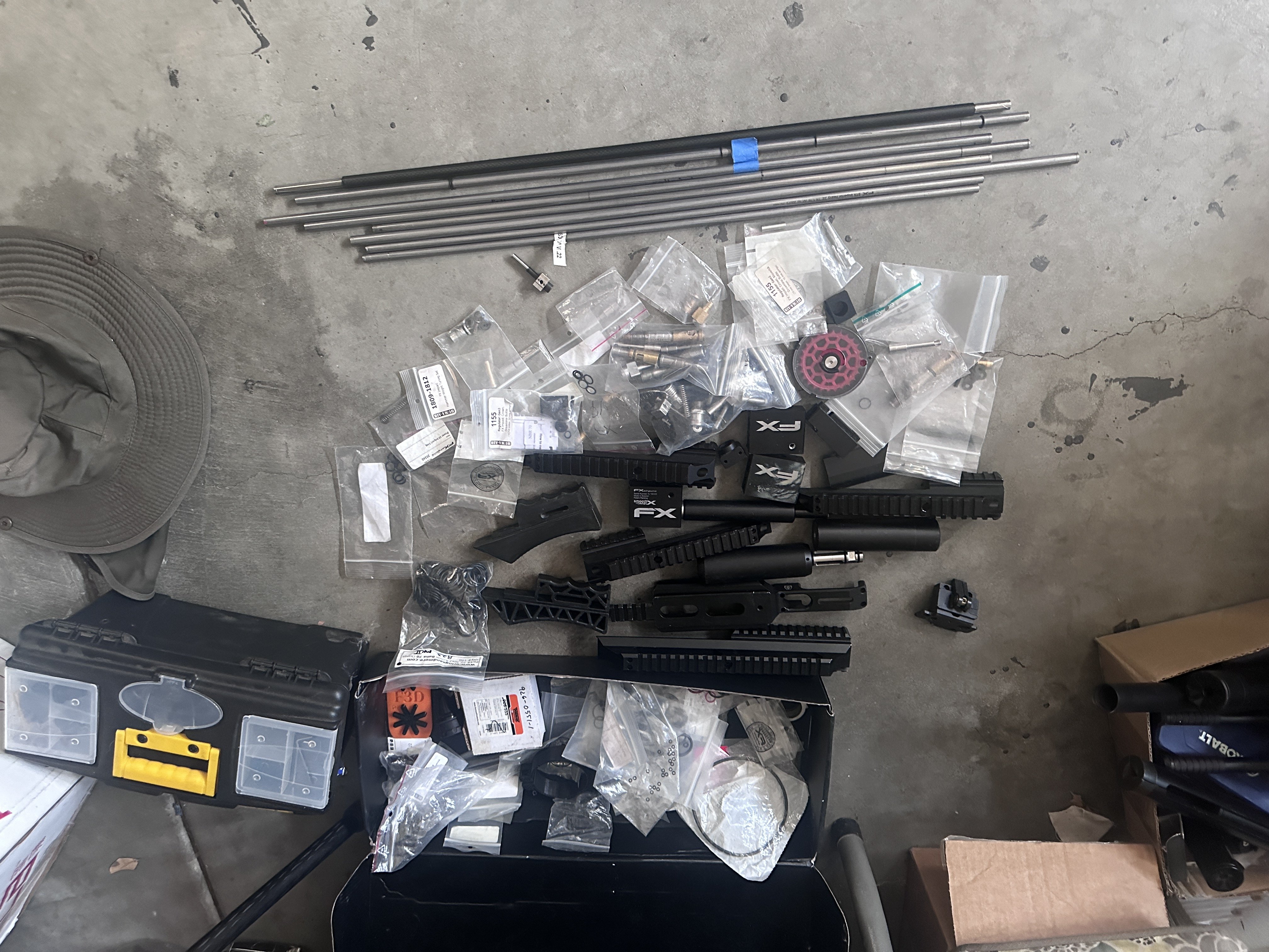

FX Impact M3 w power block .22 cal 700 mm barrel with pellet & slug liners completely tricked out
Saber tactical top rail, bottom rail & cheek piece and it comes with the eagle vision 22 caliber magazine. I do not have the stock one.
The Scope and bipod are not included

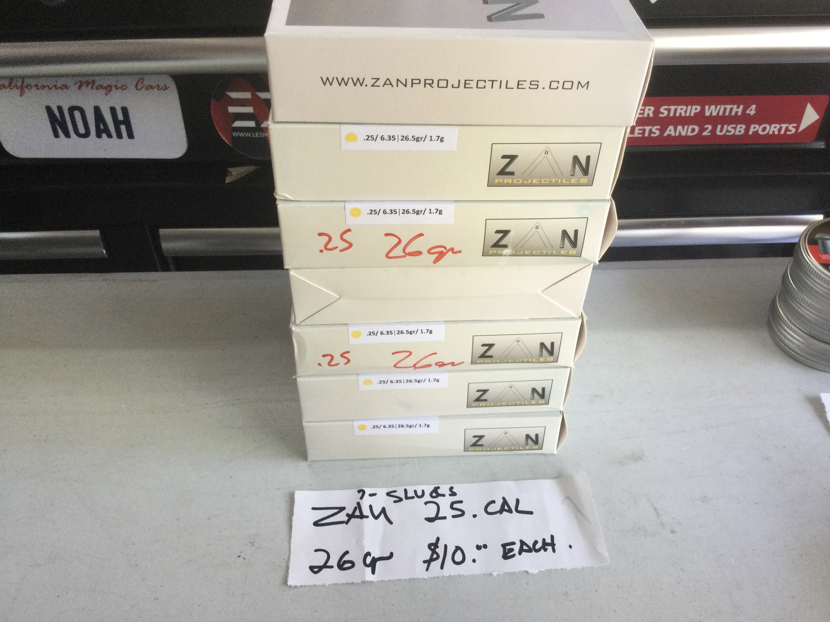

Projectiles  NLA Pellets and Slugs for sale cal. 25
I got for sale ZAN , NSA ammo , it’s just been seating inside my storage , if anyone is interested PM me.
ZAN slugs 25cal. 26.6gr 200 pcs $10.00 each .
NSA I got 3 boxes , 3 different weights 43.5-38.9-34.9= all in 25 Cal.
I’ll take PayPal FF , no trades please .
Note) not all the items are sealed.
Thank you very much and be safe
PLUS SHIPPING.

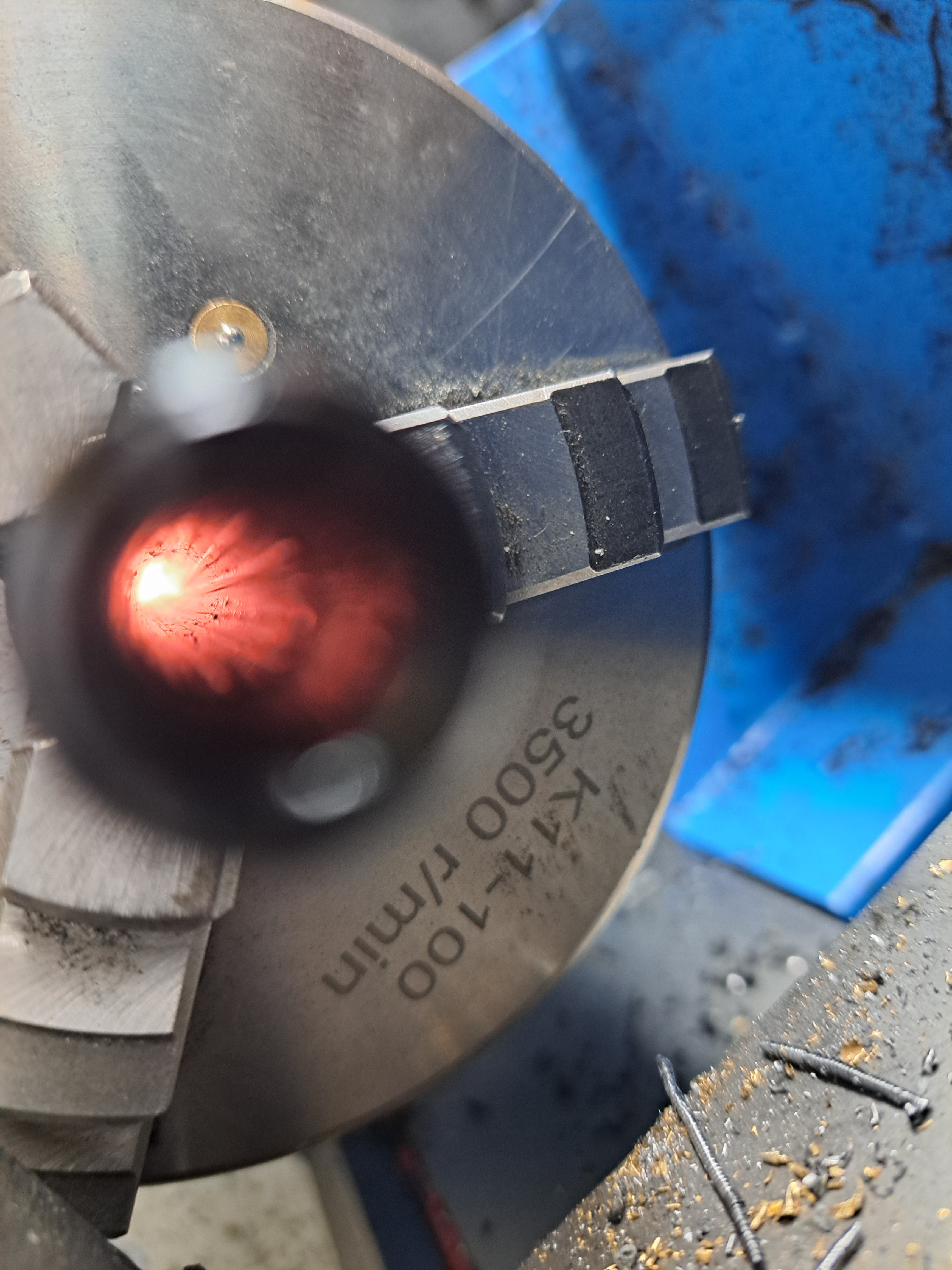

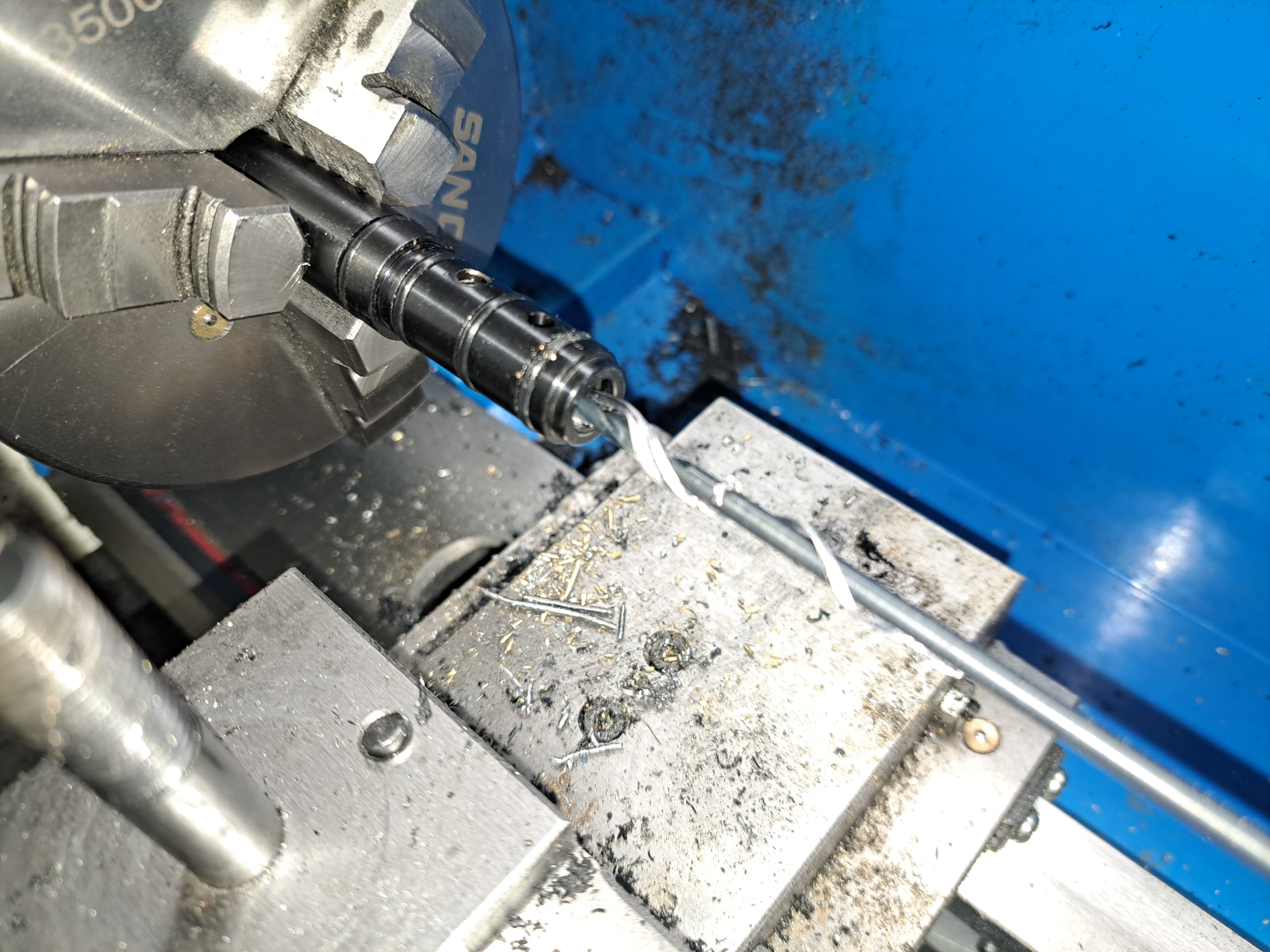

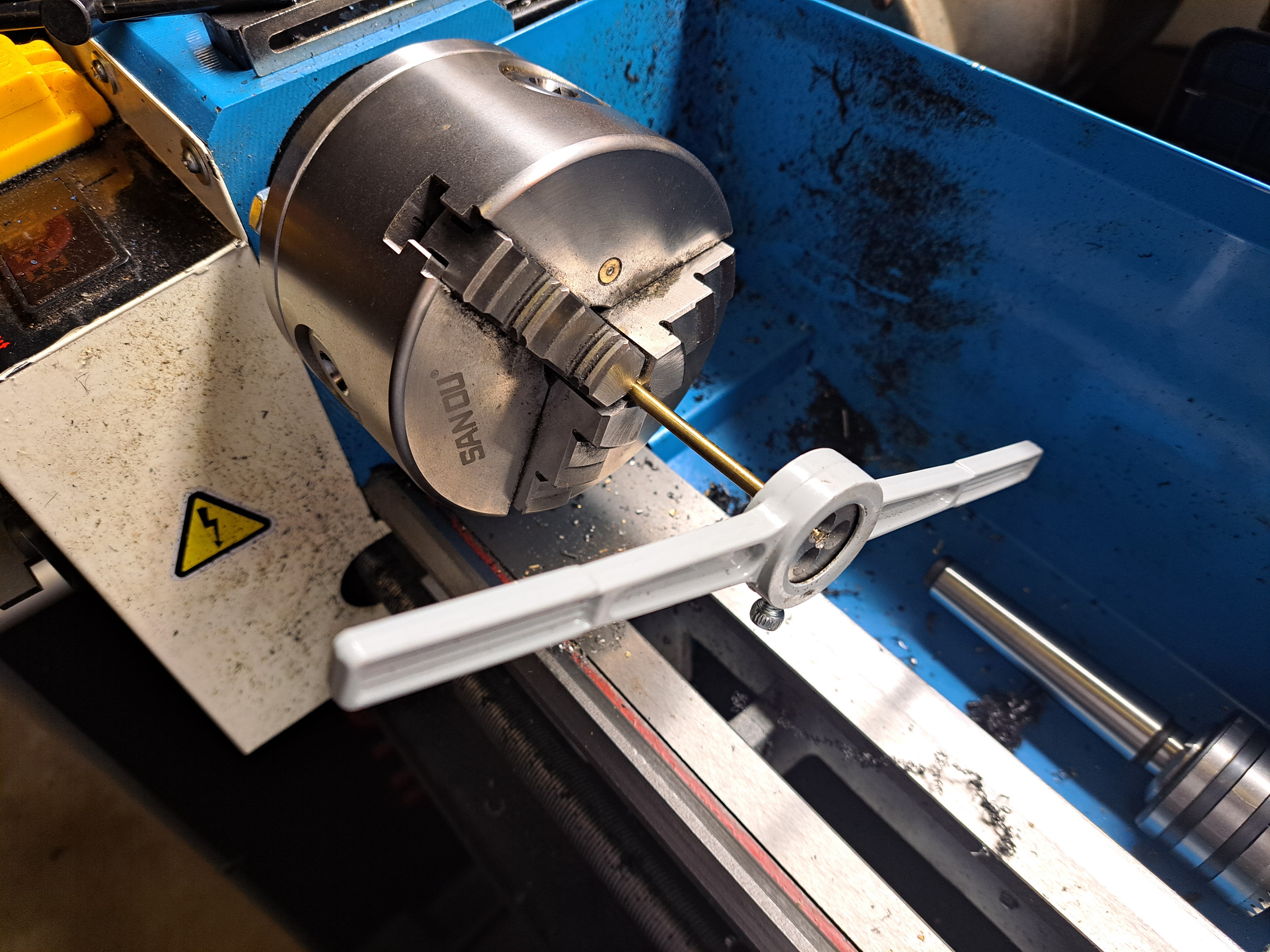

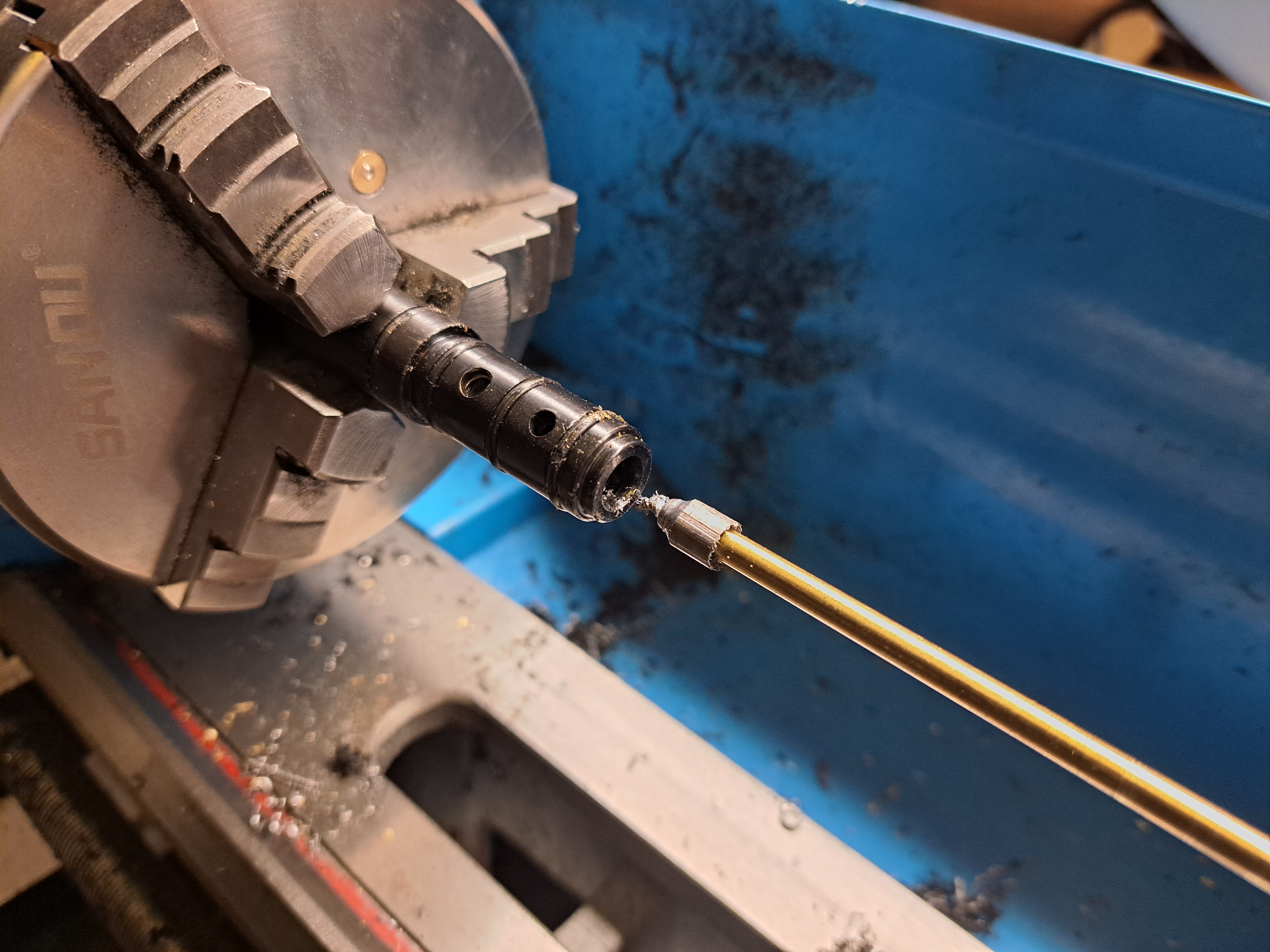

Other  $100 pcp, Pellets Jamed in barrel

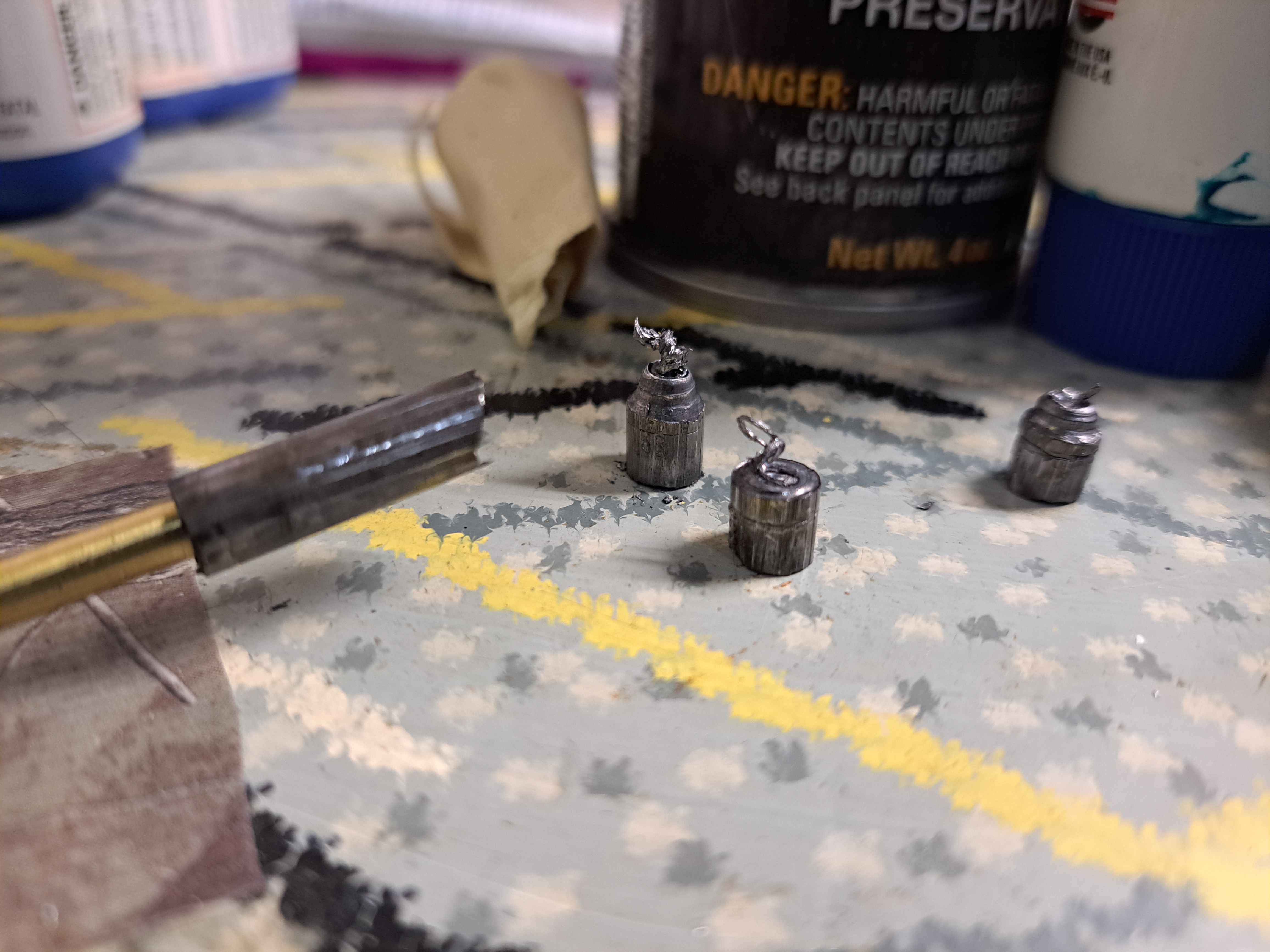

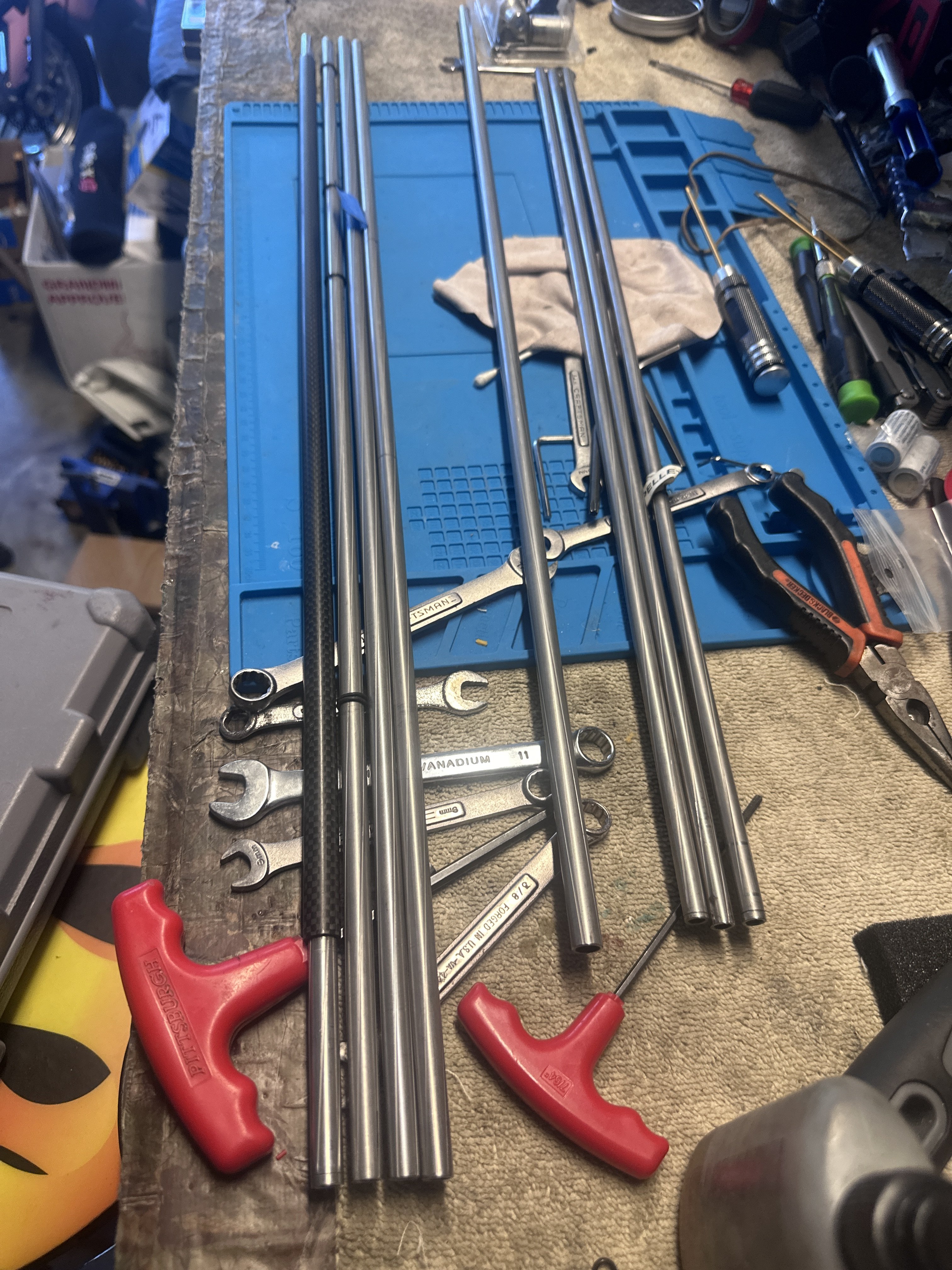

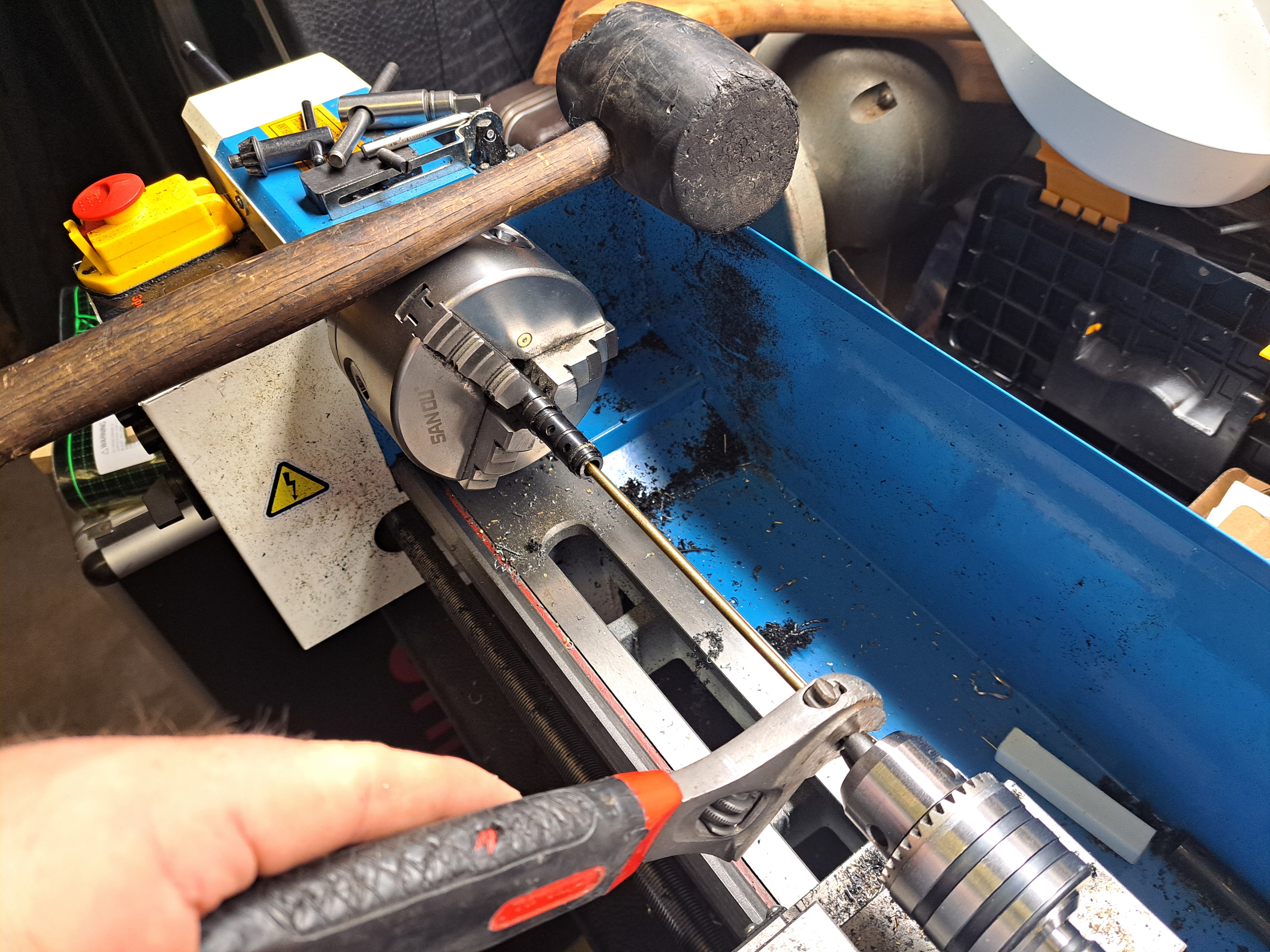

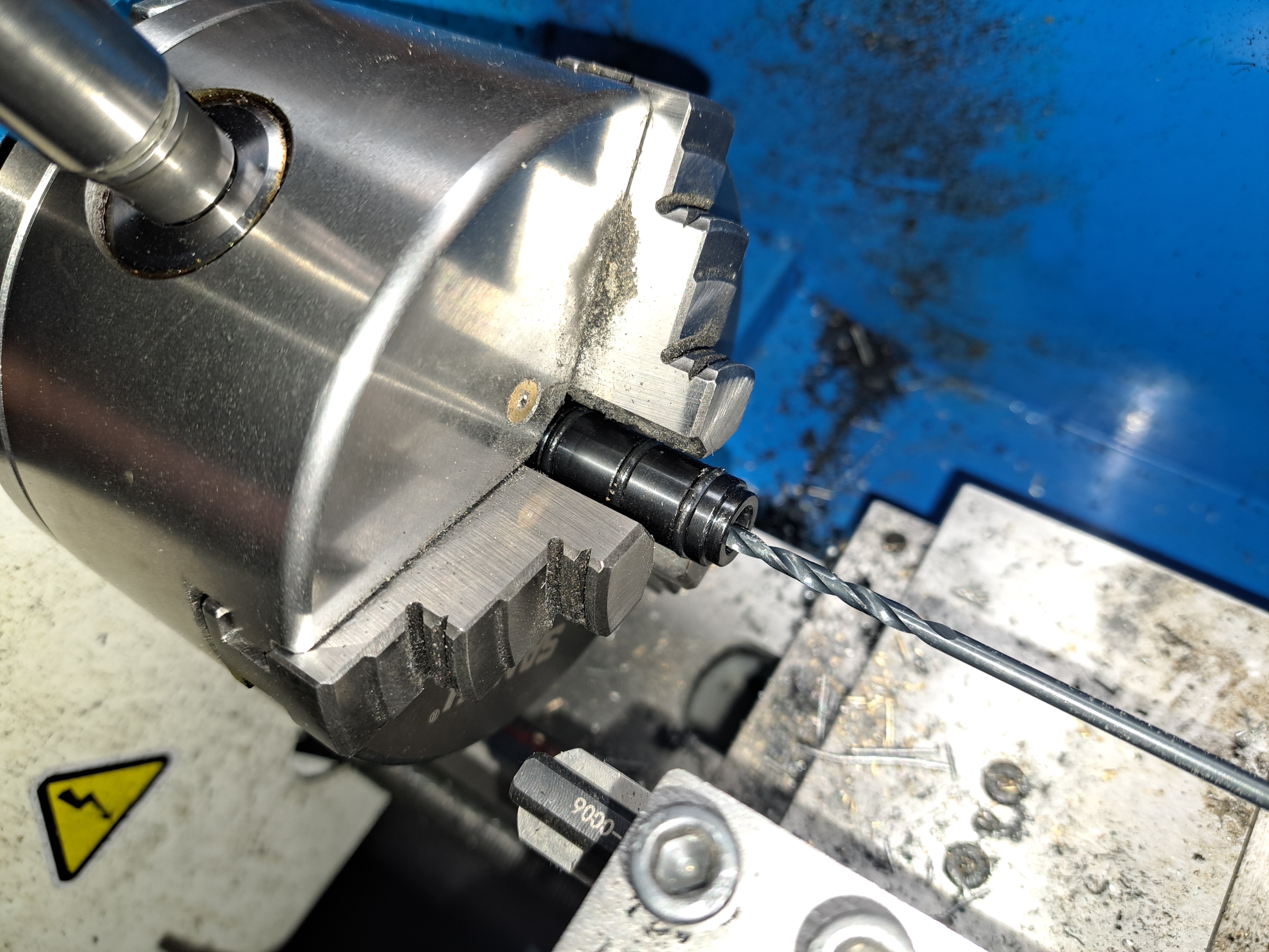

So, I purchased a beeman raider in .25 as I wanted a cheep .25 pcp to mess with. It was posted as leaking pcp on the online auctions for $100. Low and behold when it arrived I noticed the breech oring was on the bolt probe. A pellet fell out of the barrel and I knew that a pellet was jammed in the barrel. After making some caveman attempts to remove it I put my mind and tools to work.
First I removed all the air (this was done before the caveman work) from the pcp and disassembled it.
Than measured the depth of the pellet and found a suitable drill bit and placed it in my laithe. Drilled out the Pellets learning that it was more than one.
I grabbed a brass rod and used a die to thread one end and used my laithe to drive it into the pellet from the barrel inlet side.
I used a crescent wrench and a mallet to lightly tap the rod and pellet out like a slide hammer. Did this until there was no Pellets in the bore and ran a few patches until it was clean.
Now to go and remove Pellets from a 140 barrel. Now I have confidence to by used pellet guns that have Pellets stuck in the barrel. This is possible without a laithe however, I would not choose to do it without one.

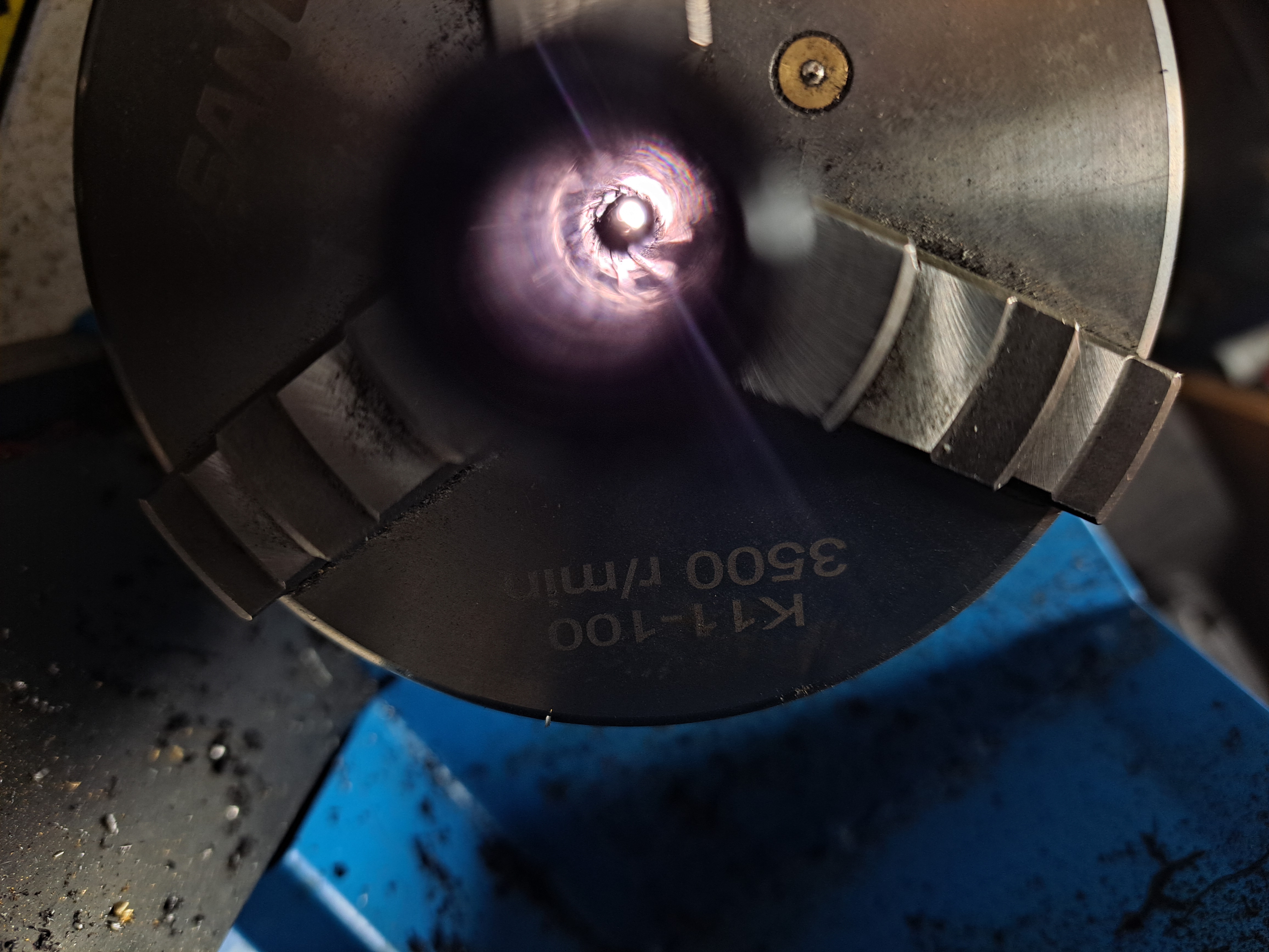

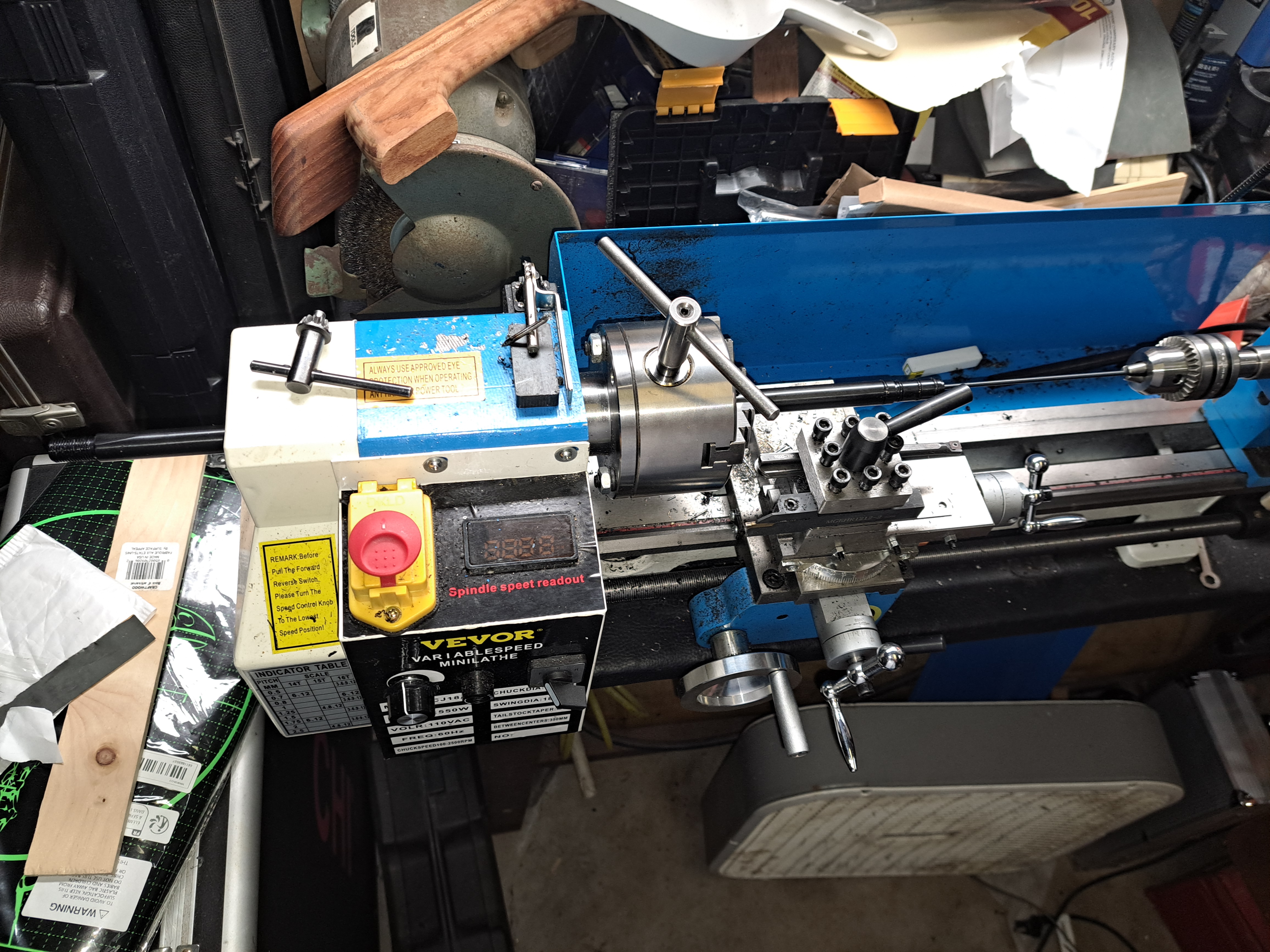

Bent my Alpha Wolf barrel 🥺/ UPDATED 😁
I had my Alphe Wolf on a cleaning stand on my table, I was moving gun cases and stuff around and backed around the table and my side pushed against the barrel that was sticking off the table. It pushed it right off the stand onto the floor, I turned to watch it nose dive onto my basement floor, the floor has carpet squares with rubbet backing on it. Picked up the rifle and it looked like the barrel wad now slightly bent upward.
The next morning I took it to the range and it was shooting 11+ inches high at 25 yards and 2 inches left.
Pulled off the barrel and checked it my lathe to see how bad it was. Here is before and after videos. I'm hoping it will shoot OK again.

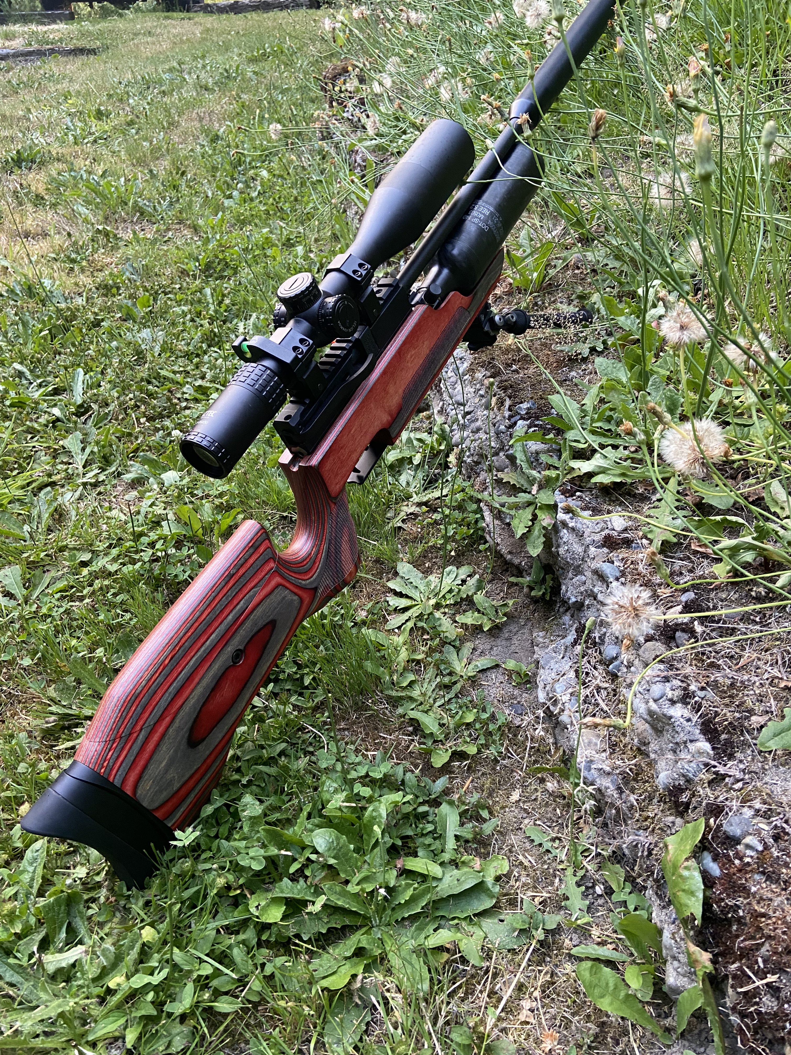

Taipan Veteran 1 Compact .25
Brand new.
Last of the originals with CZ Barrels
Anti Double Feed
Weight 6.9 lbs
OAL 23.75
Short Sale 1195.00
Also 5% off all sales at checkout.
Sale 1095.00
