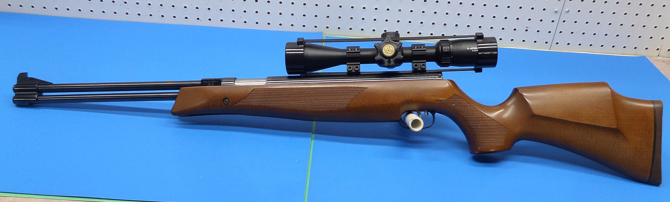

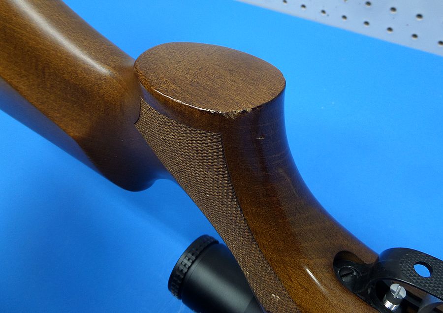

Other  Chinese air rifles today
I shot two of my Chinese rifles today. I have two or three more that are under levers. One of these is a break barrel and the other is a side lever. Both shoot well and can shoot 2" groups at 25 feet offhand. I like the side lever best. I'm amazed at how well these cheap guns perform.
One thing I don't like is loading a pellet with the action open, danger of losing a finger or two.
