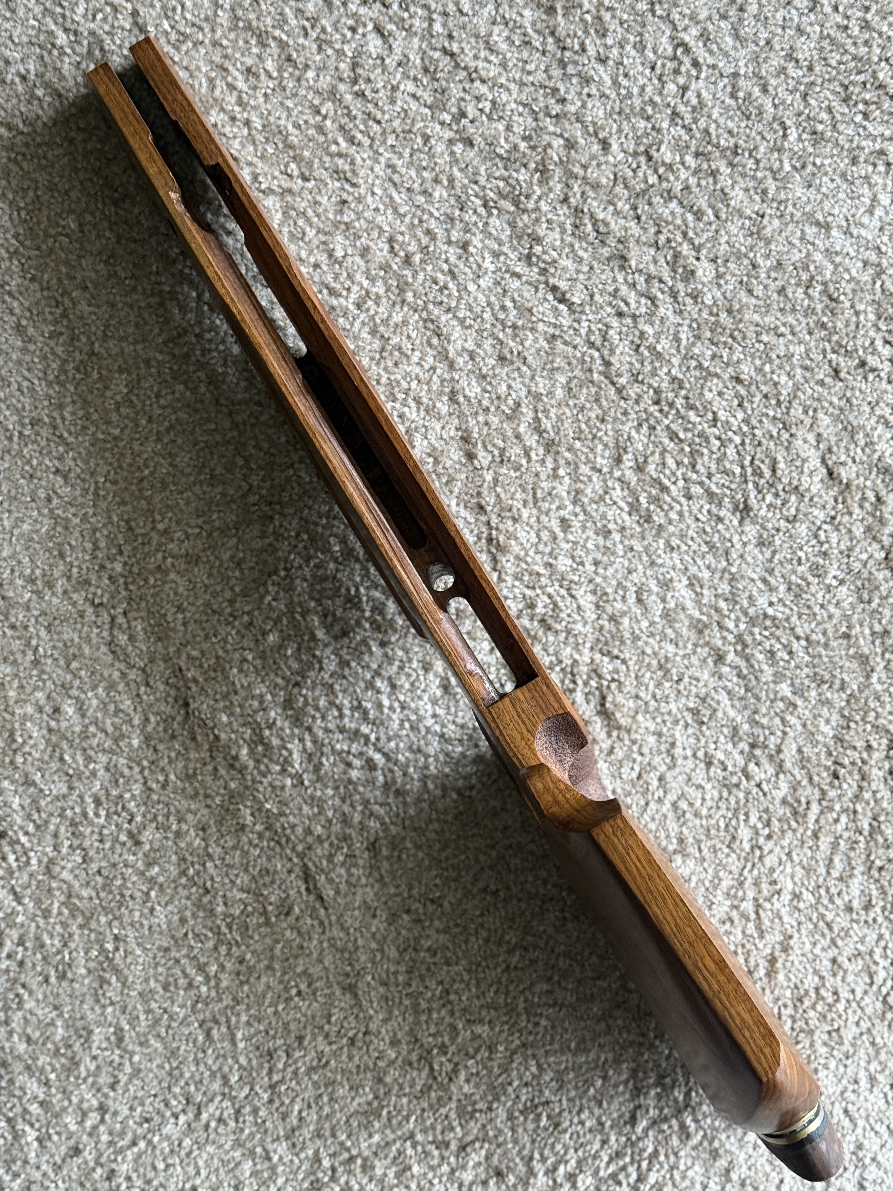

Daisy  Who Made Daisy’s Stocks?

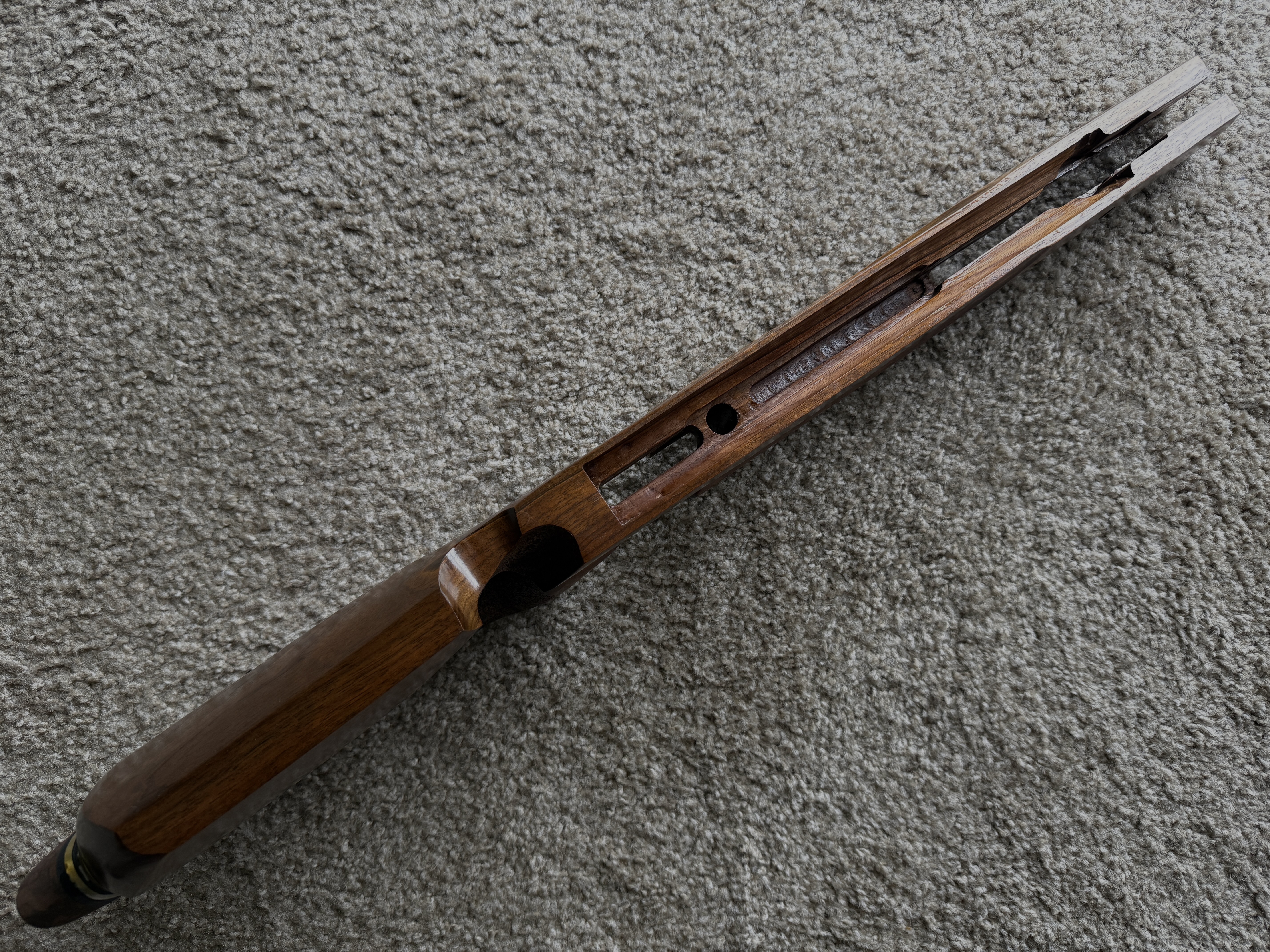

Here are three Daisy rifles. Two 753’s and one 853. The 853 stock is made of Elm. One of the 753’s is of Tiger Maple. The other is “I believe” made of Honey Locust. It’s a wood I am unfamiliar with. Heavy, bright in color, oily, and has a different grain pattern. Check out the end grain. (last picture in the center) Also, It appears to me that all three of these stocks came from different manufacturers. All machining is quite different. The Elm stock is by far the thickest. Followed by the Tiger Maple stock. Then the Honey Locust. Different in every way. Checkout the pictures. Any other opinions on the Honey Locust? I’m not settled on it yet.

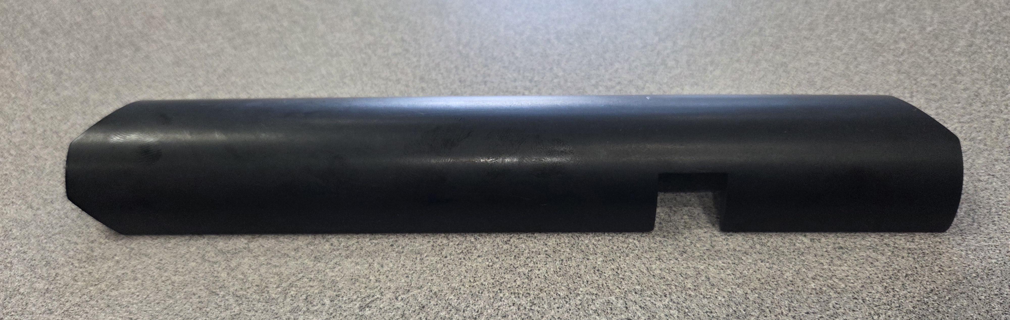

AEA  3D printed pellets in a sub 12fpe HP max
Because our laws restrict power to 12/6 fpe for rifles/pistols it means that 77grn .357 pellets go somewhere between 180-250fps. I 3d printed some pellets that then have a .22 pellet pushed into a recess in the front and these weigh about 19grn and travel at between 360-500fpe which is a vast improvement. Has anyone else tried this?

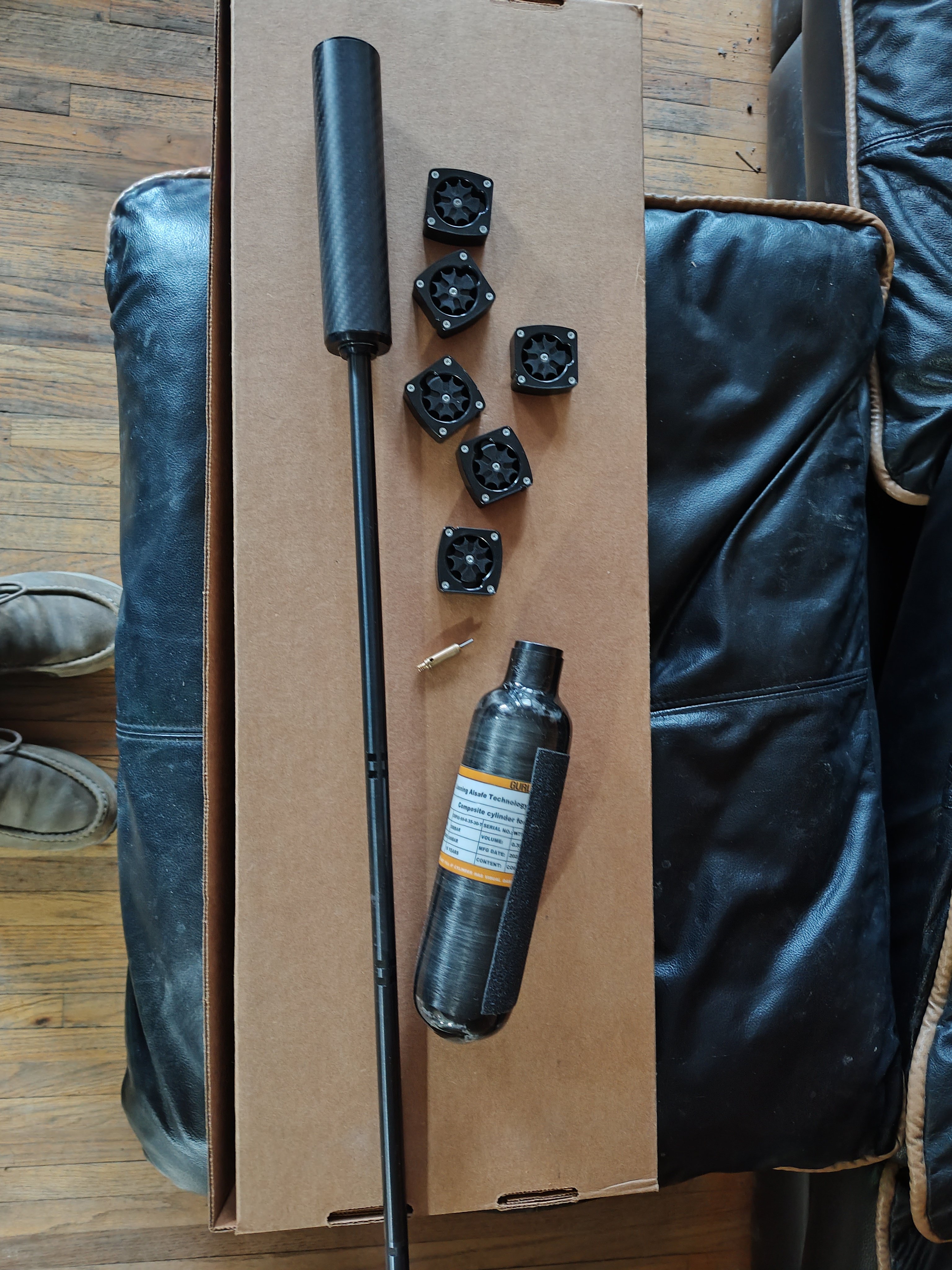

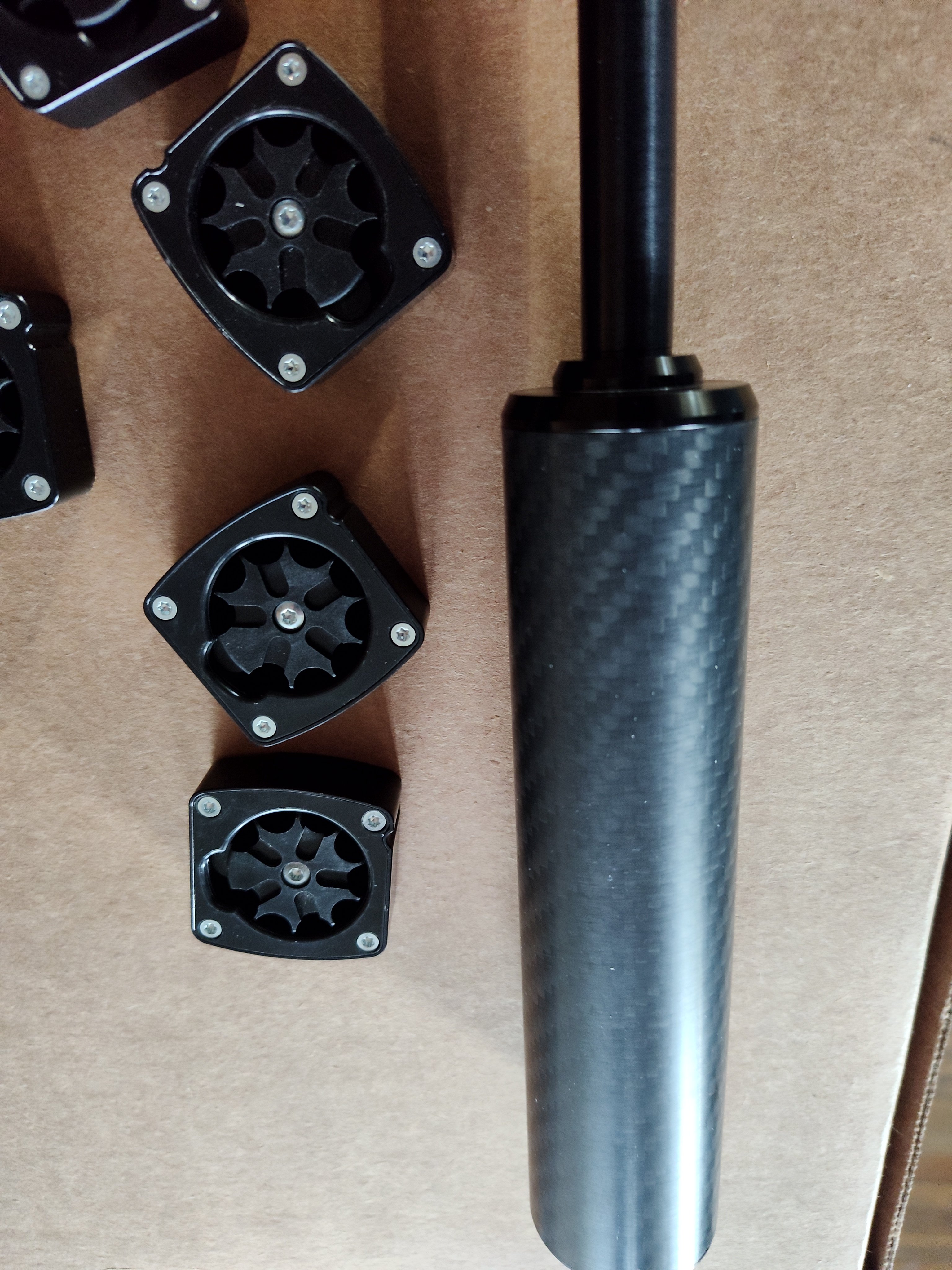

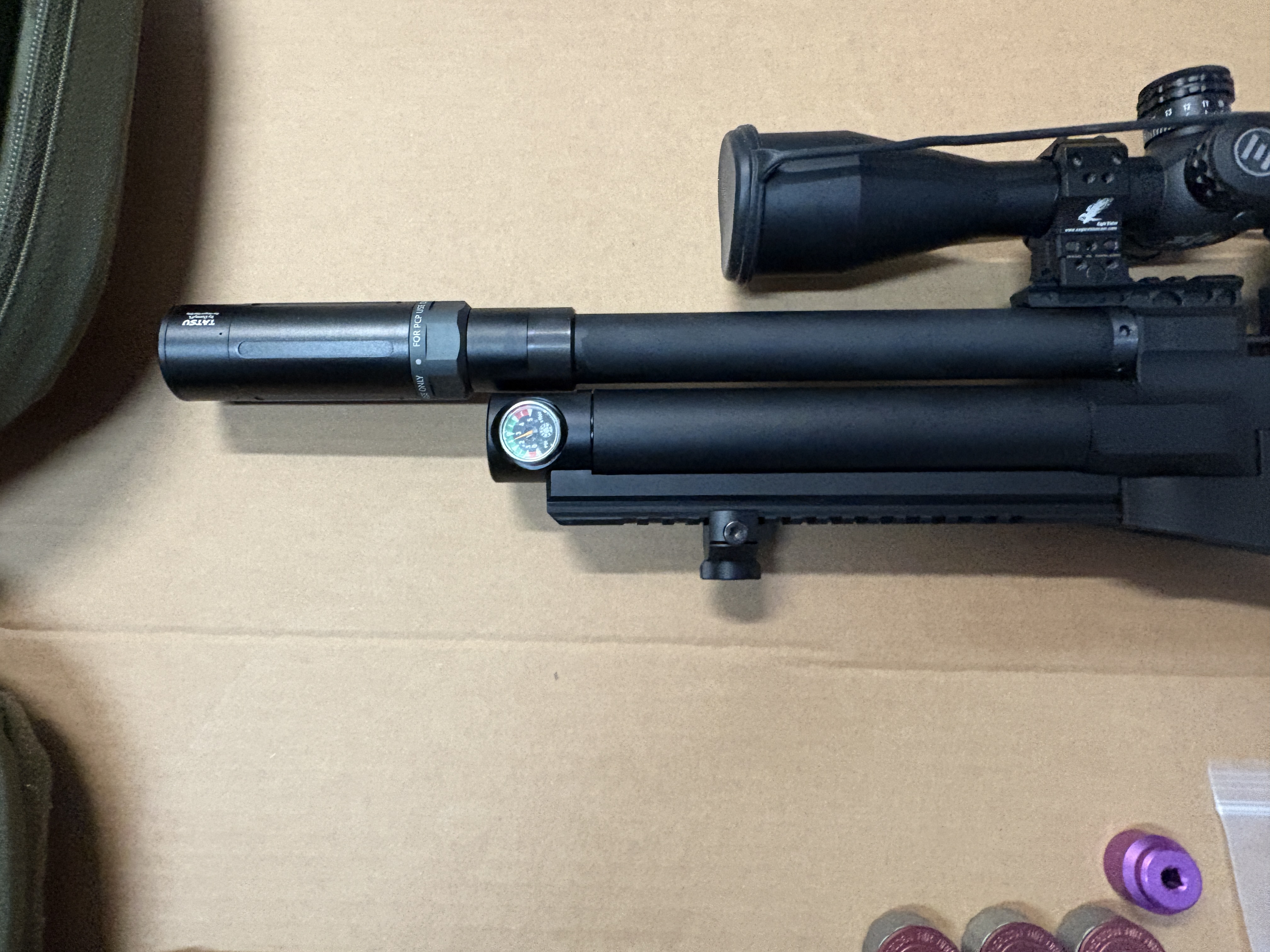

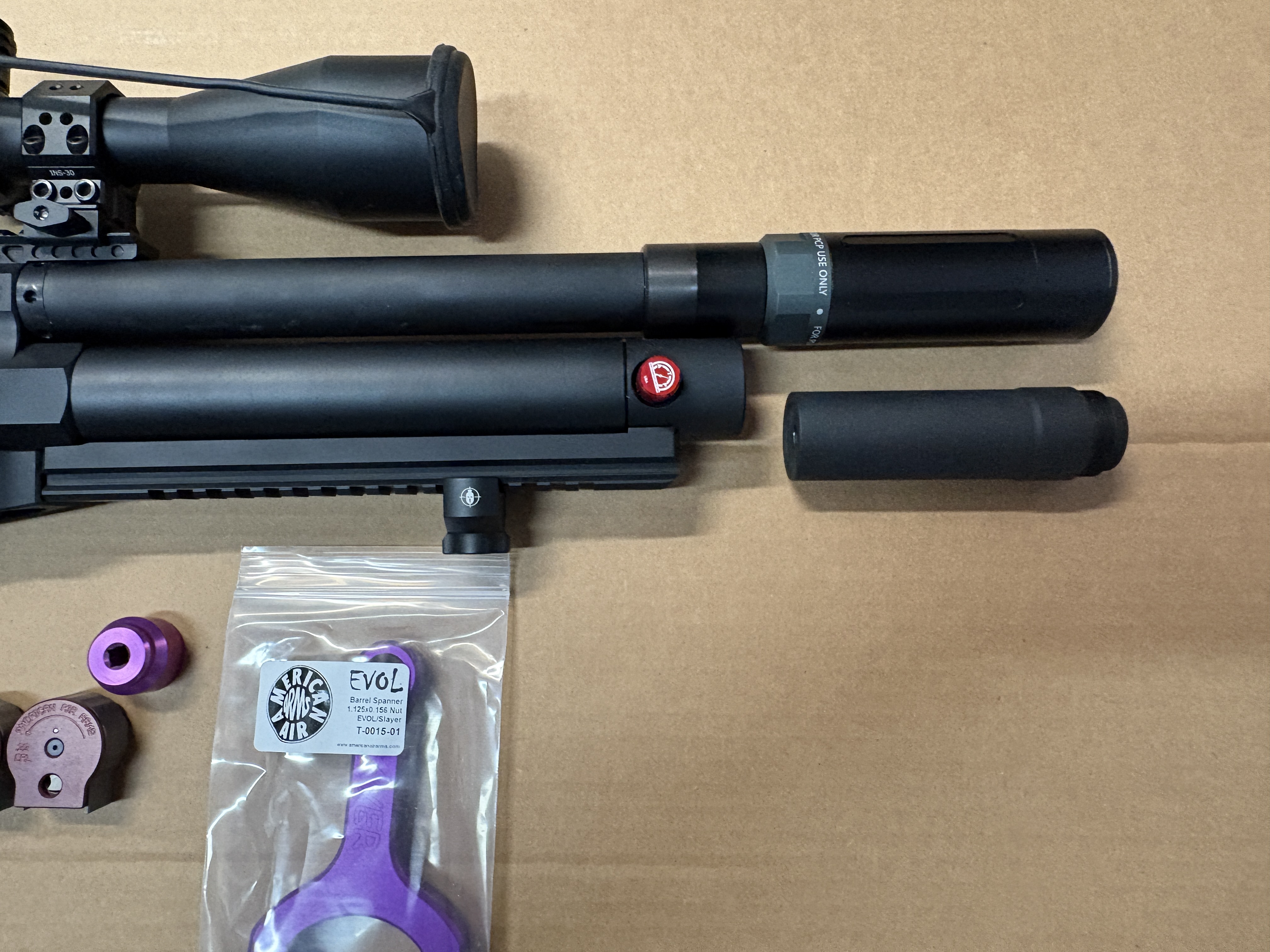

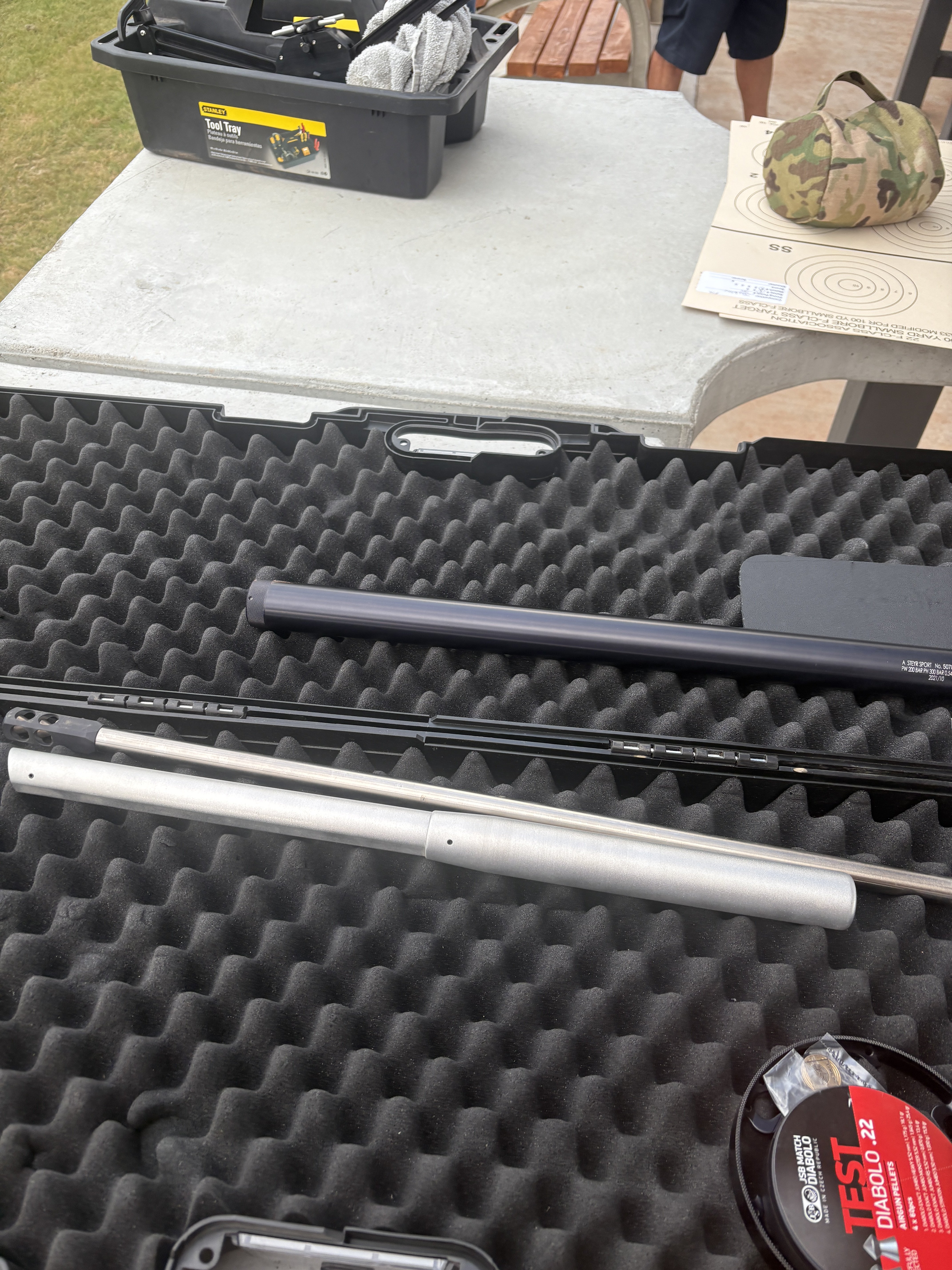

Barrels  WTS FX Impact 700mm barrel 22
Includes
Superior twist liner 700mm
Heavy twist liner 700mm
Factory LDC
Factory Gen 4 mag
FX carbon fiber liner sleeve
I have 3 times of 33 grain air marksman slugs I can also add
$350 shipped

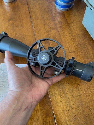

Just want to share my vector continental 6-48x56 and vector sentinel x pro 10-40x50 scopes. For me the best bench rest scopes because of its fine reticles, and very small floating dot. Suitable for our br25m target paper here in the philippines with only 0.5mm center target. The 1/8 moa click value adds a huge advantage over others that offers 1/4 moa. Plus the glass clarity of vector scopes provides a really clear picture of the targets and less mirage on long range shooting. The vector continental has better glass over the sentinel though. But with sentinels low price the glass clarity is more than acceptable. Couldnt go wrong with these scopes specially when it comes to bench rest shooting. Here are the links incase anyone is interested.

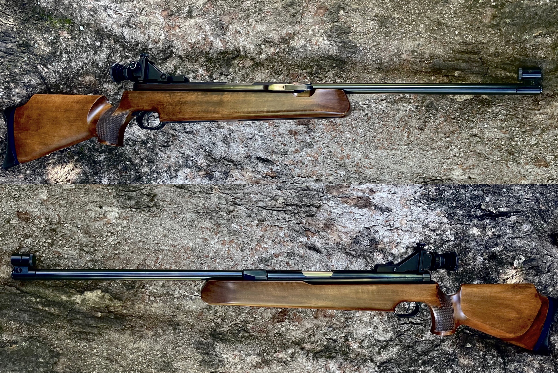

HW/Weihrauch  Weihrauchs for history nerds
I haven't bored you guys with any old-fart collector trivia in a while. So...here ya go: a Weihrauch brochure from the late 1950's:
1. Note the "Received" stamp on the front cover. HP White Laboratories did the very first published airgun velocity data for WHB Smith's landmark 1957 book, Gas, Air, and Spring Guns of the World. (HP White is still around...and still doing specialized velocity testing.)
2. HW's range in those days was only three models--the HW 35, 50, and 55, though there are multiple variations of each. All the guns shown here have the "long block" threaded rear section, thus dating the previous "short block" HW rifles to before 1959. The 55 and 35 variants all have Rekord triggers, but not yet the 50. In other words, the long-block action predates the modular Rekord Perfekt.
3. The HW 35 page describes the classic trio of plain, Luxus, and Export finger-groove stock options that were used for many years.
4. The HW 55 TF version - a modified HW 50 action with no locking lever - is illustrated on this page. The other 55 versions listed include the S with plain beech stock, MM, and MF. Also note a detail in transition--the 55 T on the front cover has a finger-groove fore end, while the 55 TF is shown with checkering. It seems odd that no "F" version of the least expensive HW 55 S is listed.
5. There are four versions of the model 50: base; M with adjustable trigger; S adding a fully adjustable rear sight; and SD with both open and diopter rear sight. Note the bottom line on this sheet, describing an optional deluxe stock with checkered grip and buttplate.
6. The detailed technical desriptions and drawings are outstanding. The trigger designs, the HW 55's tilting breech adjustment, and various other details are clearly shown.
7. This sheet also shows a variety of sights and accessories, including some items in transition. The 35 and 50 target versions have an older type front sight with milled posts Inserts. The HW 55 had previously used this sight, but now has a modern tunnel sight with flat metal inserts. Both sights have the same element shapes - bead, straight post, tapered post, and aperture.
8. The older solid steel "turret" style diopter sight ("Mikrometerdiopter") is optional for the 35 and 50. Again the HW 55 has moved on, to an improved "square" pattern diopter ("Mikro-Prazisions-Diopter!"). The optional Siebert adjustable magnifying iris eyepiece fits both sights.

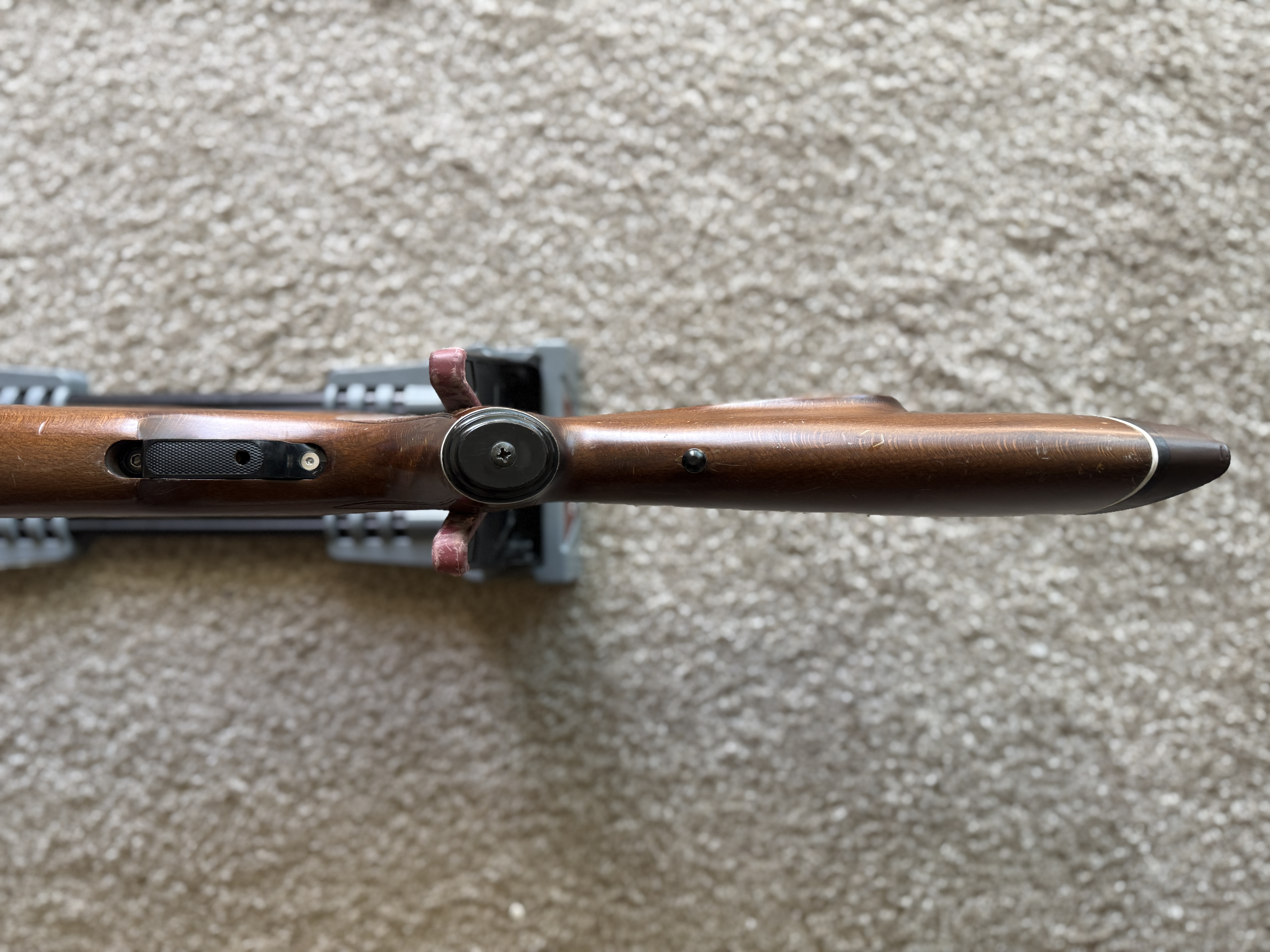

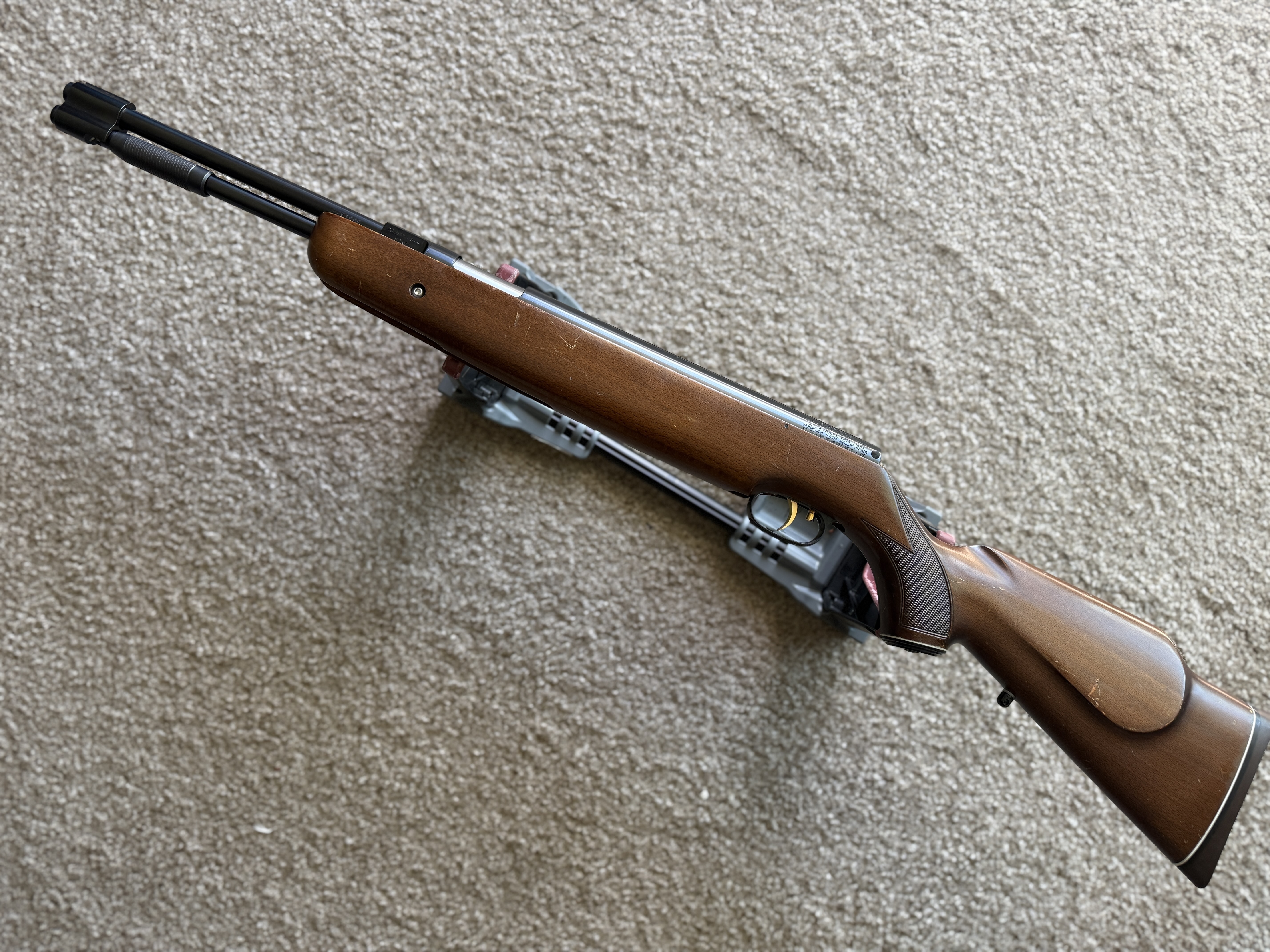

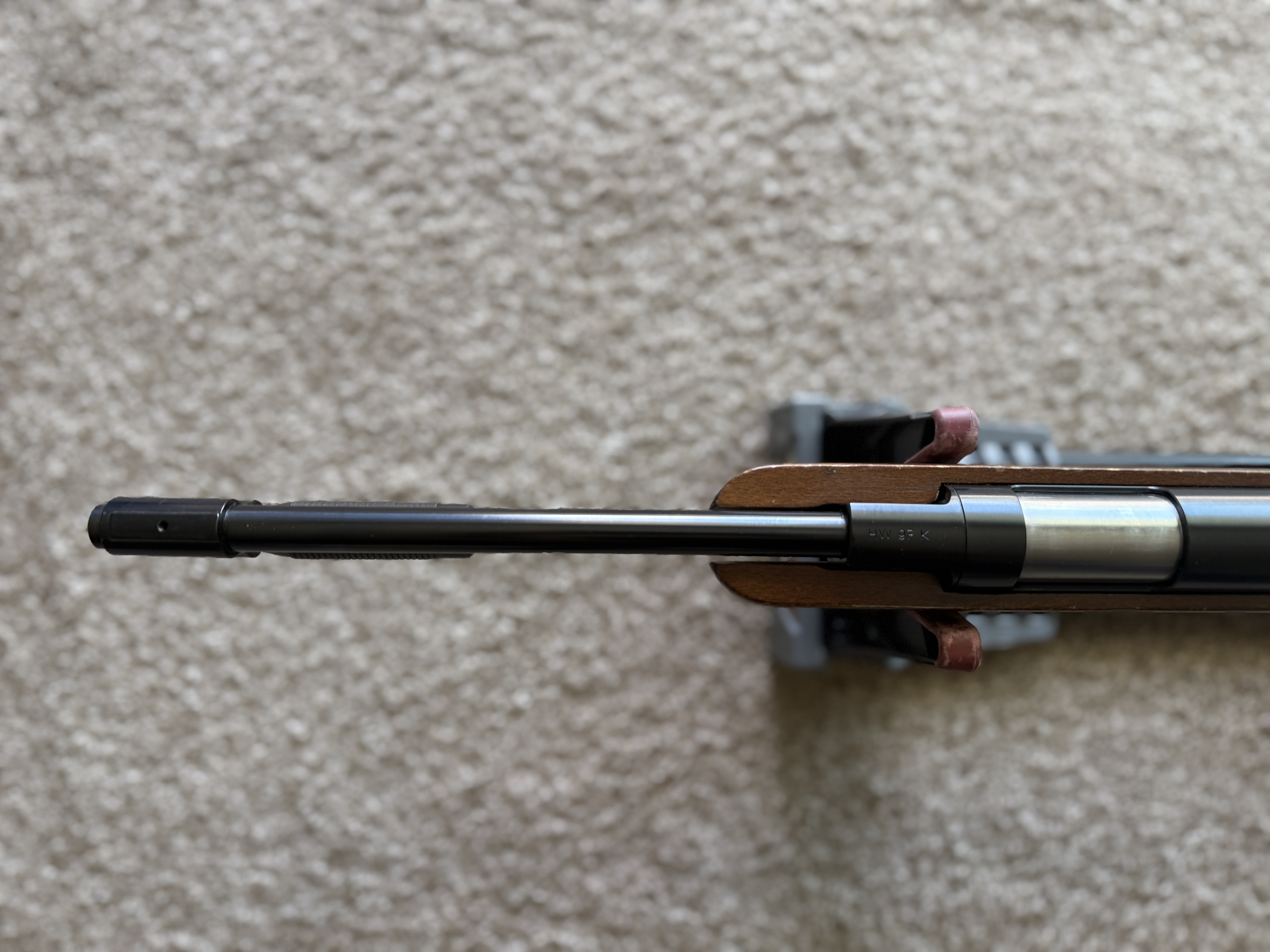

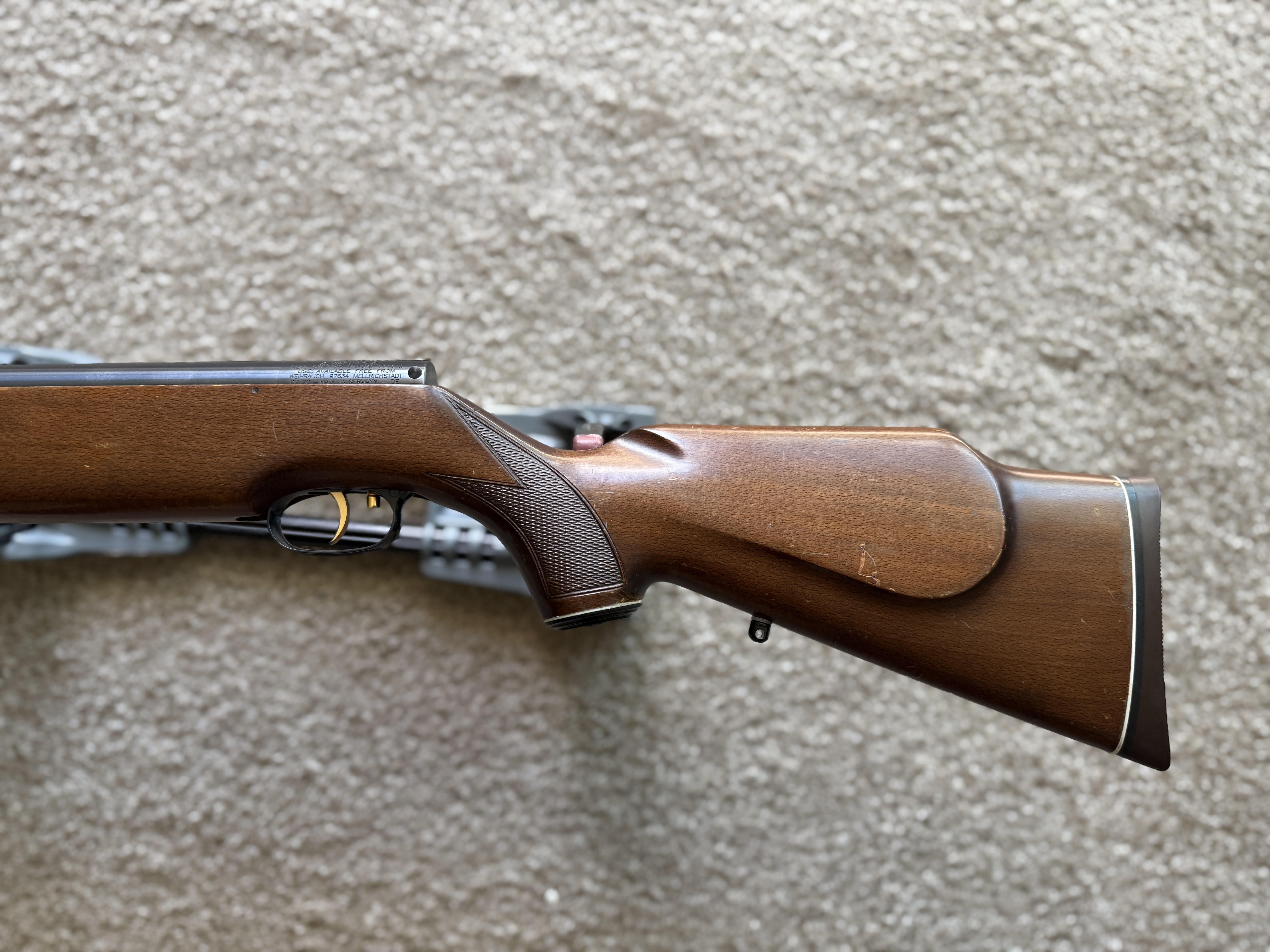

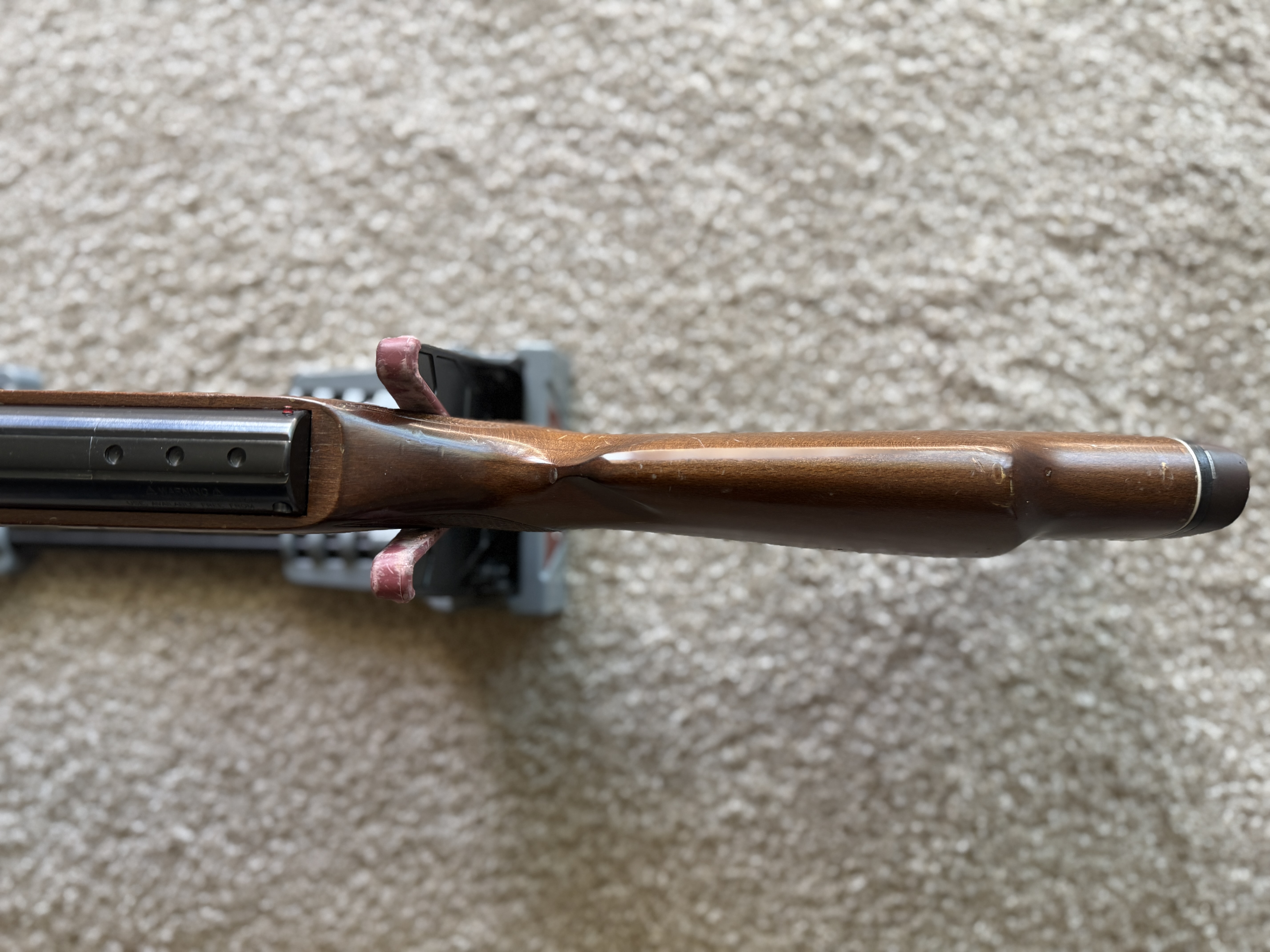

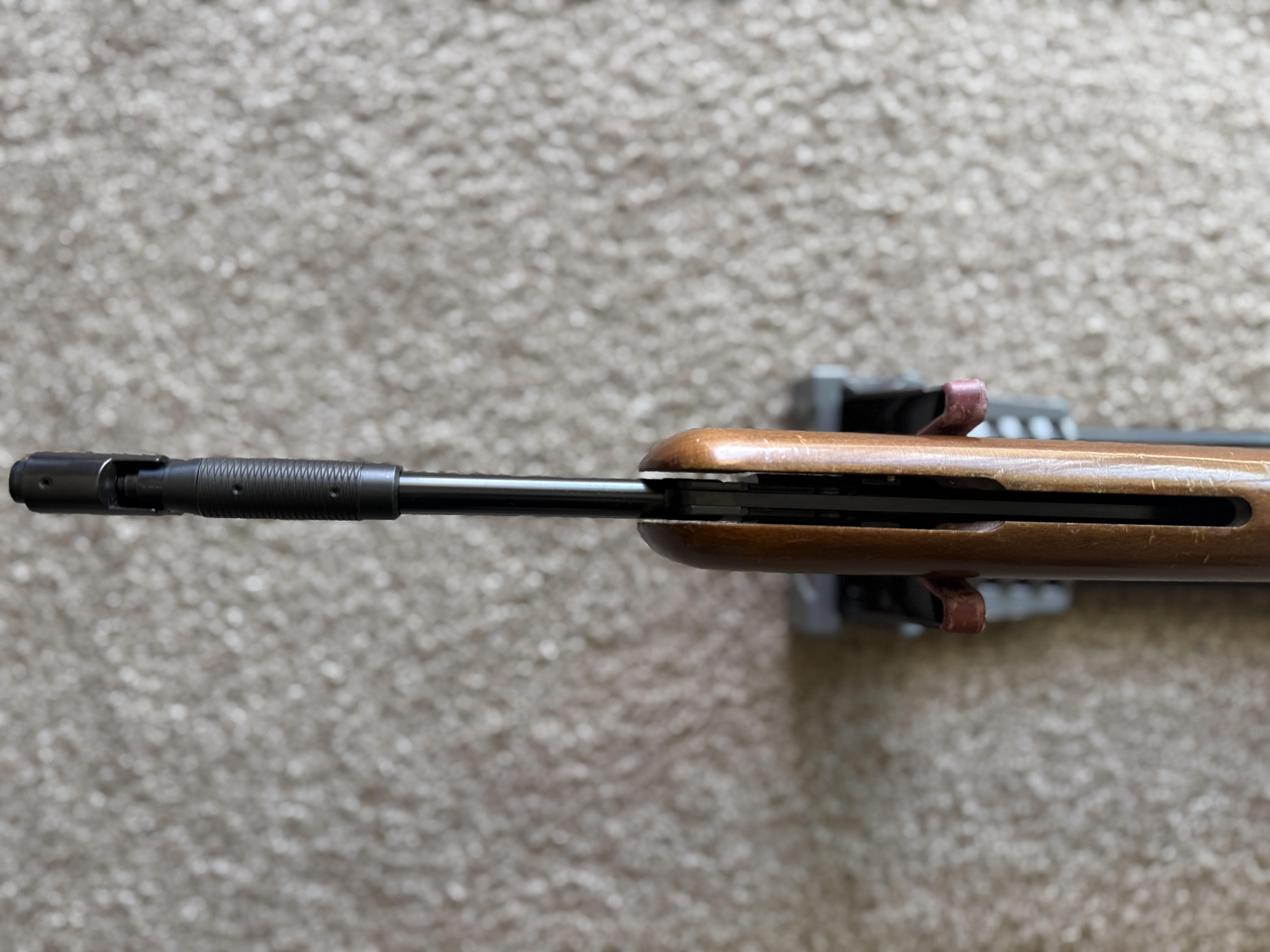

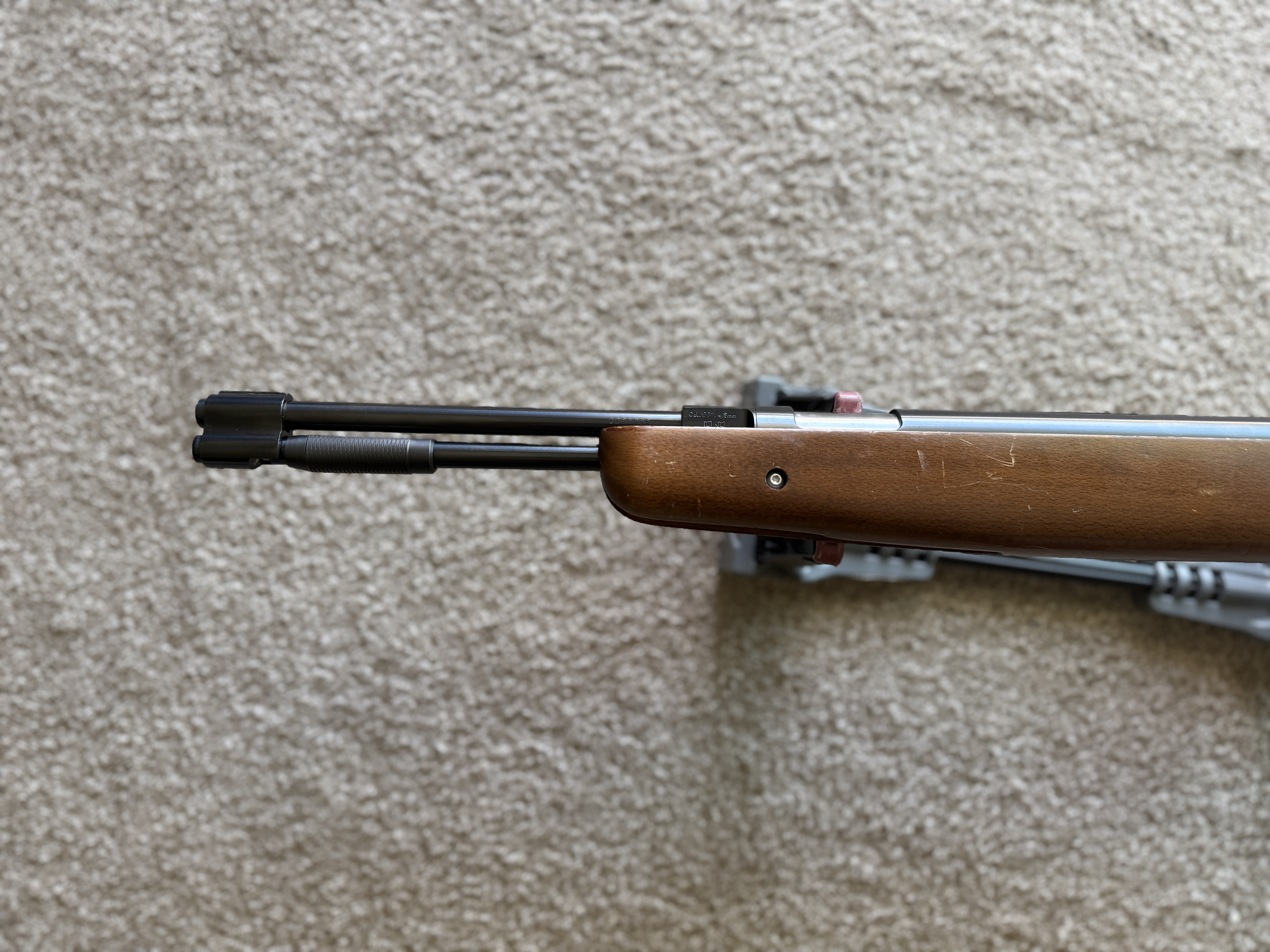

HW/Weihrauch  HW50S - Out of Box

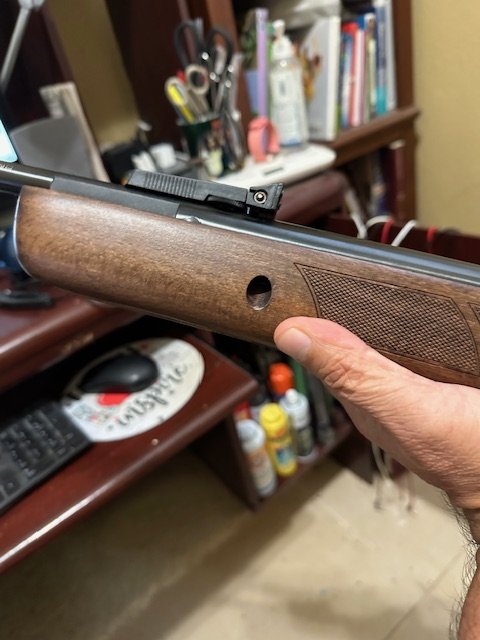

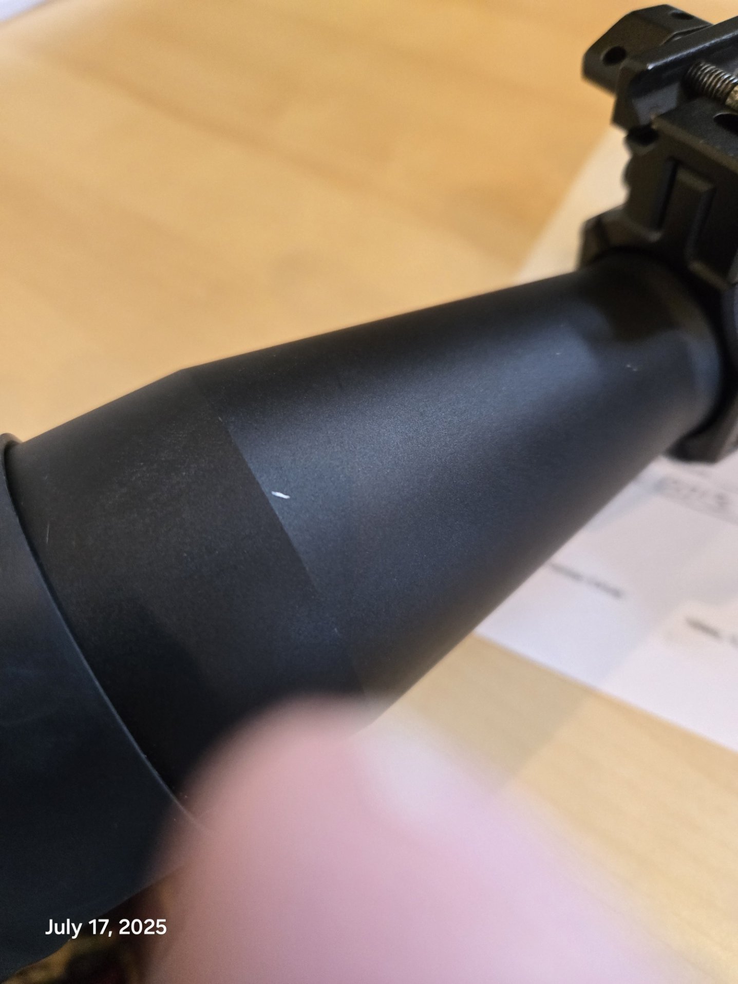

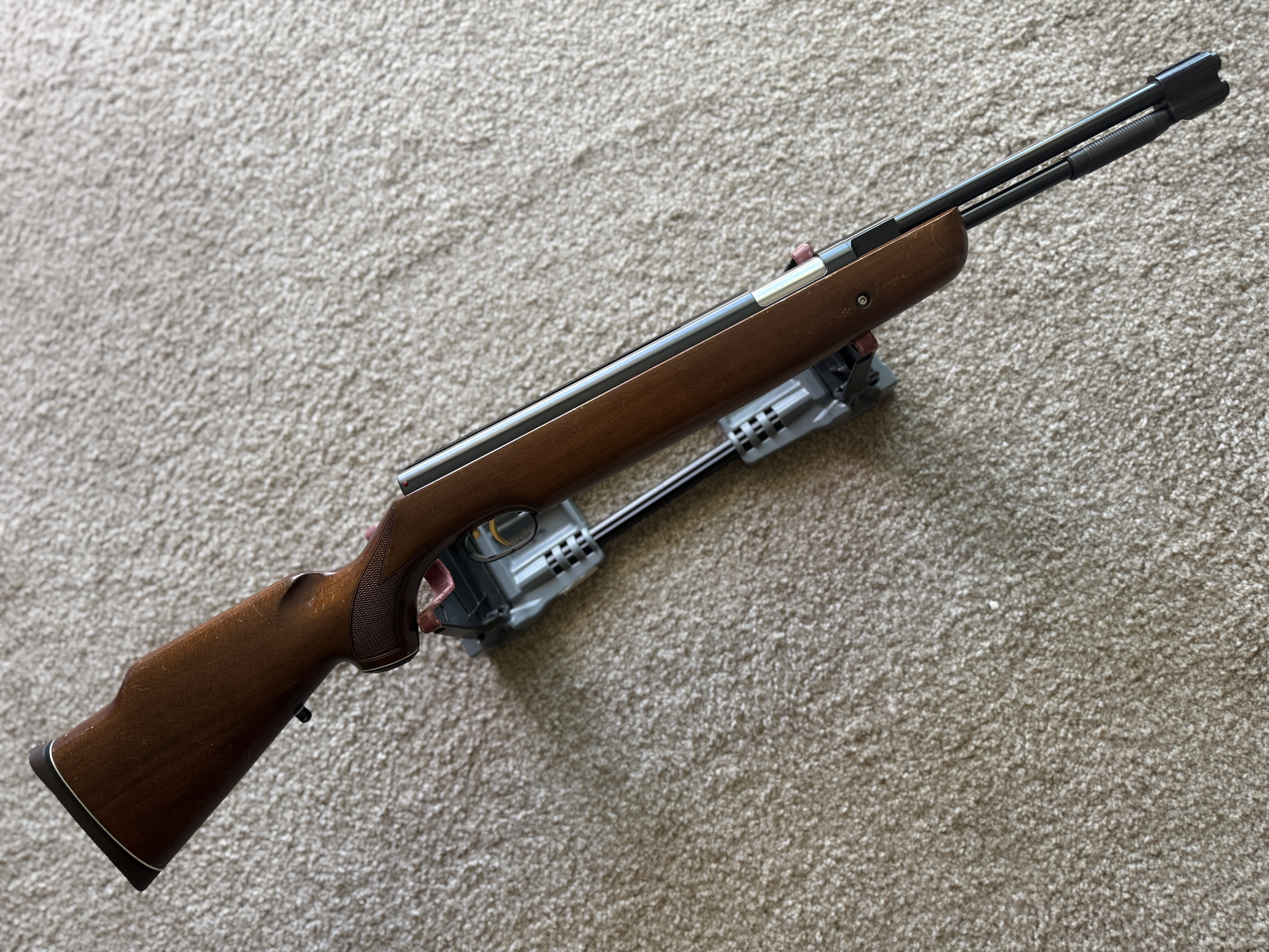

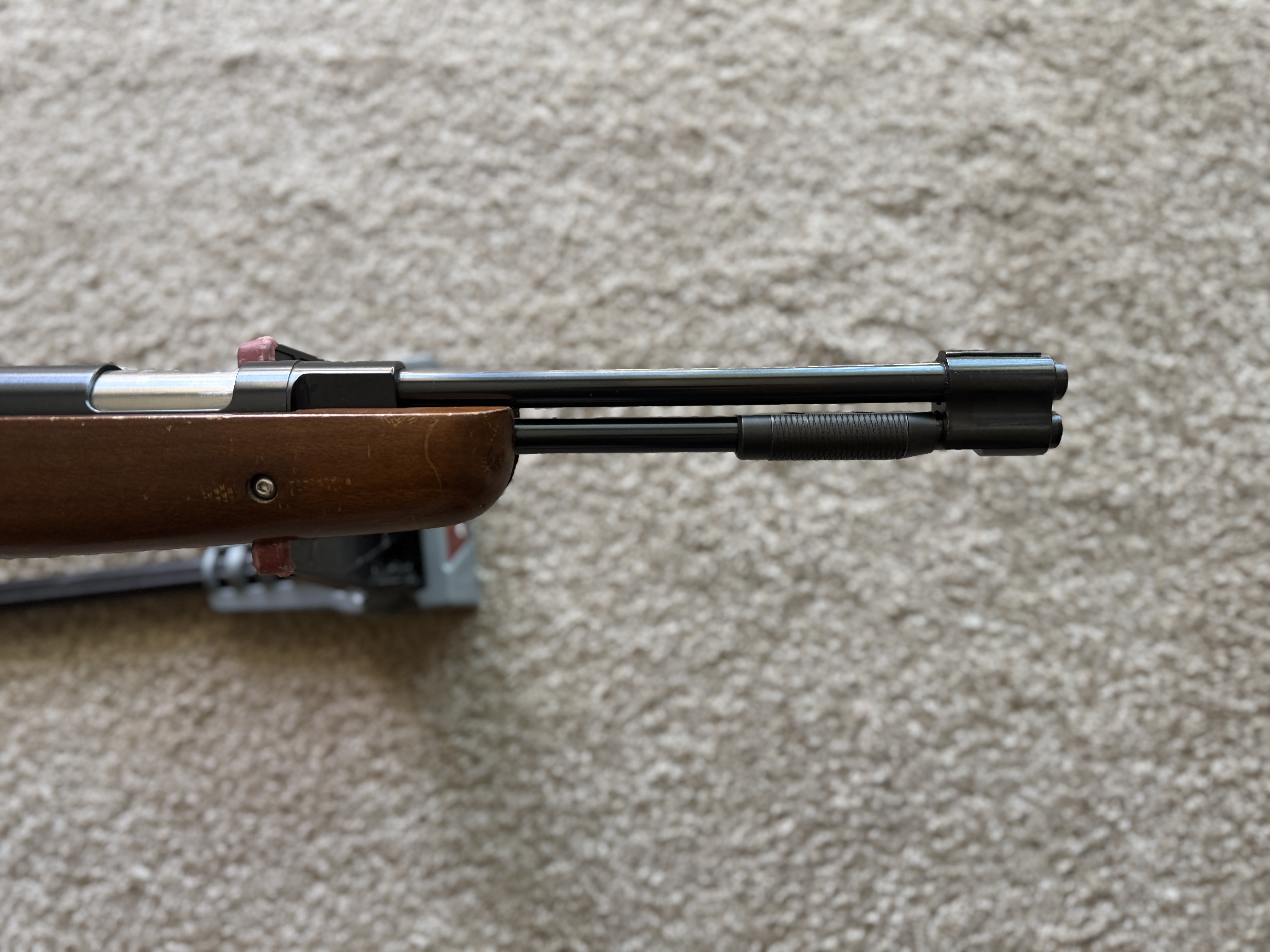

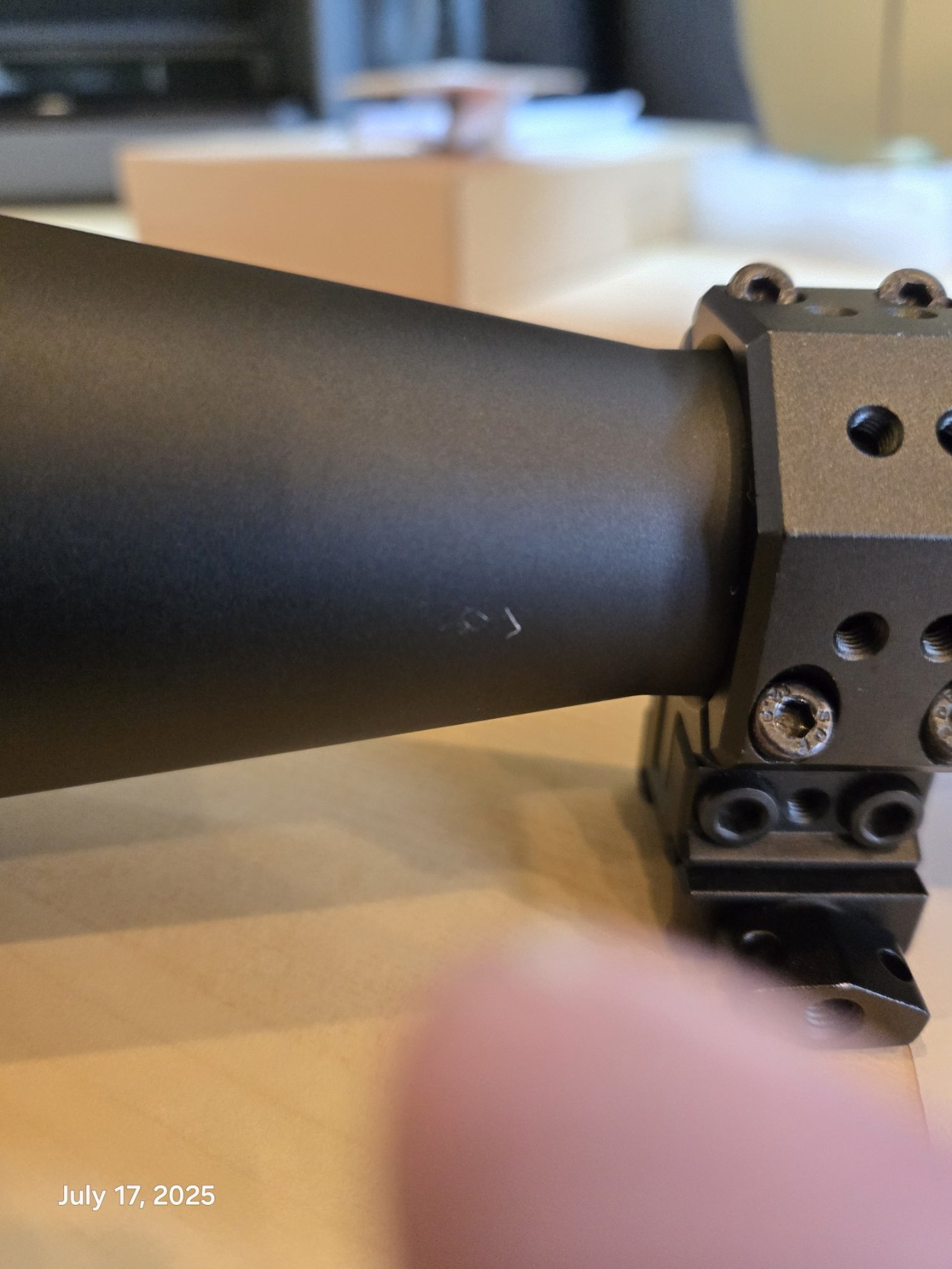

Just received my HW50S from AirgunDepot. After unboxing I noticed this line going around the action area. Almost looks like a tooling mark.
The only other Weihrauch I have is an HW98 and it is immaculate. Curious if this is normal for the HW50S? Thoughts?
I’m probably being a bit critical it’s just going to be a squirrel gun! But still… 😔

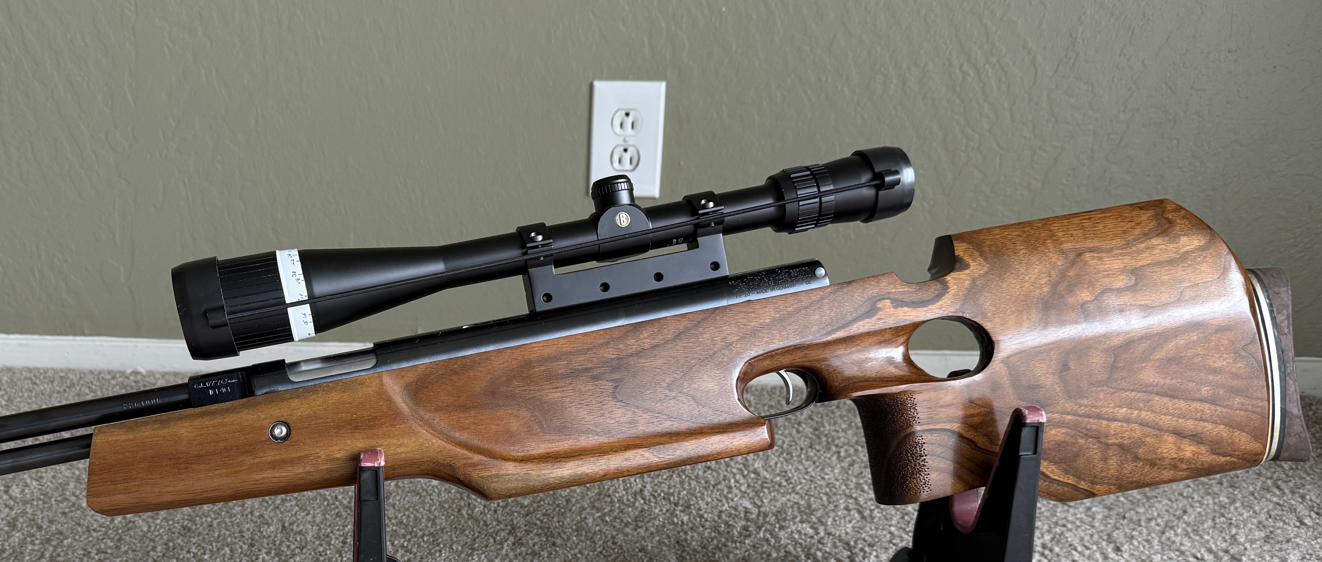

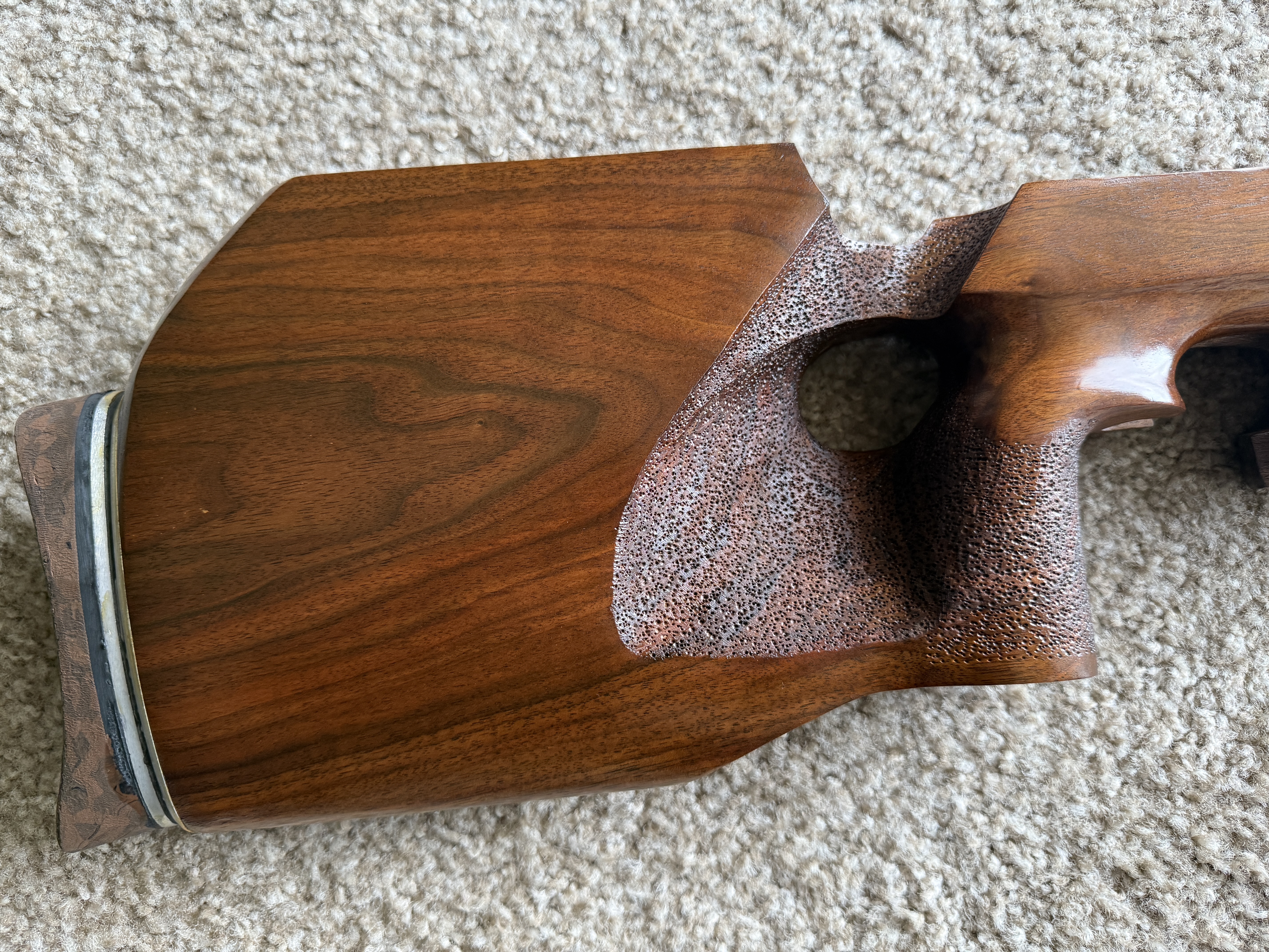

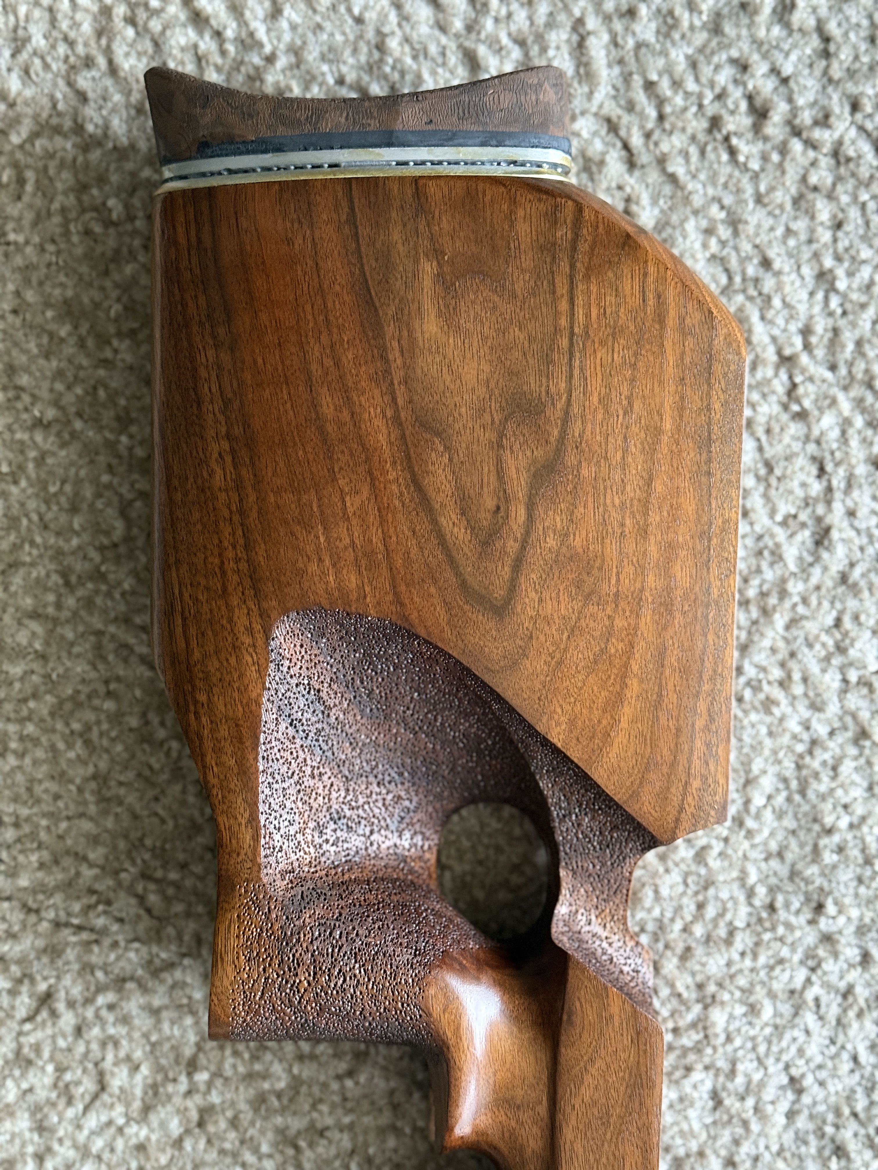

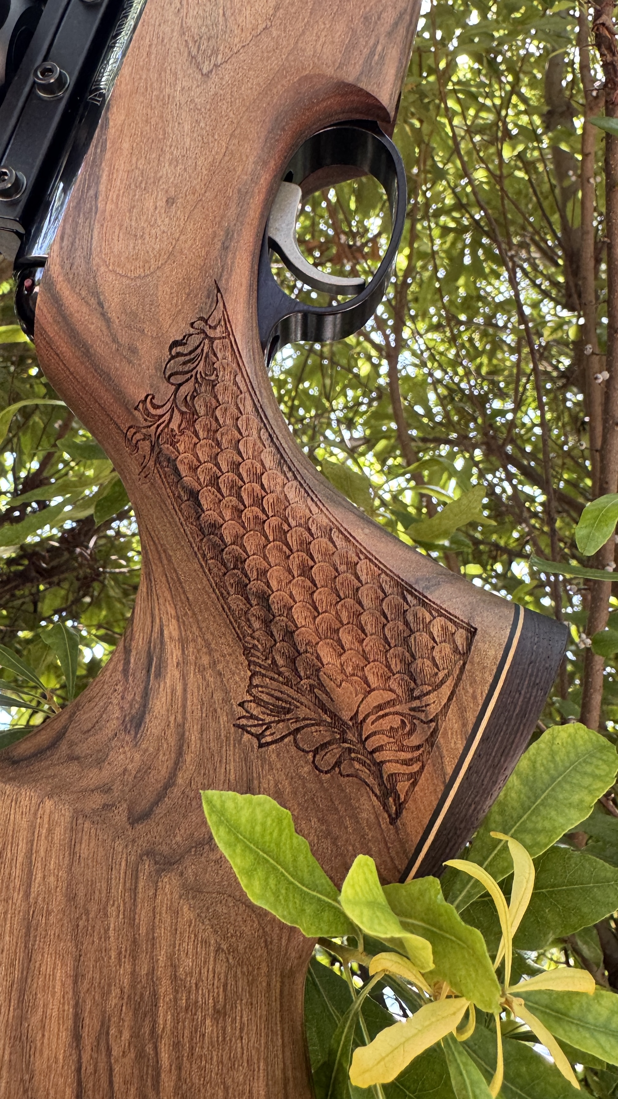

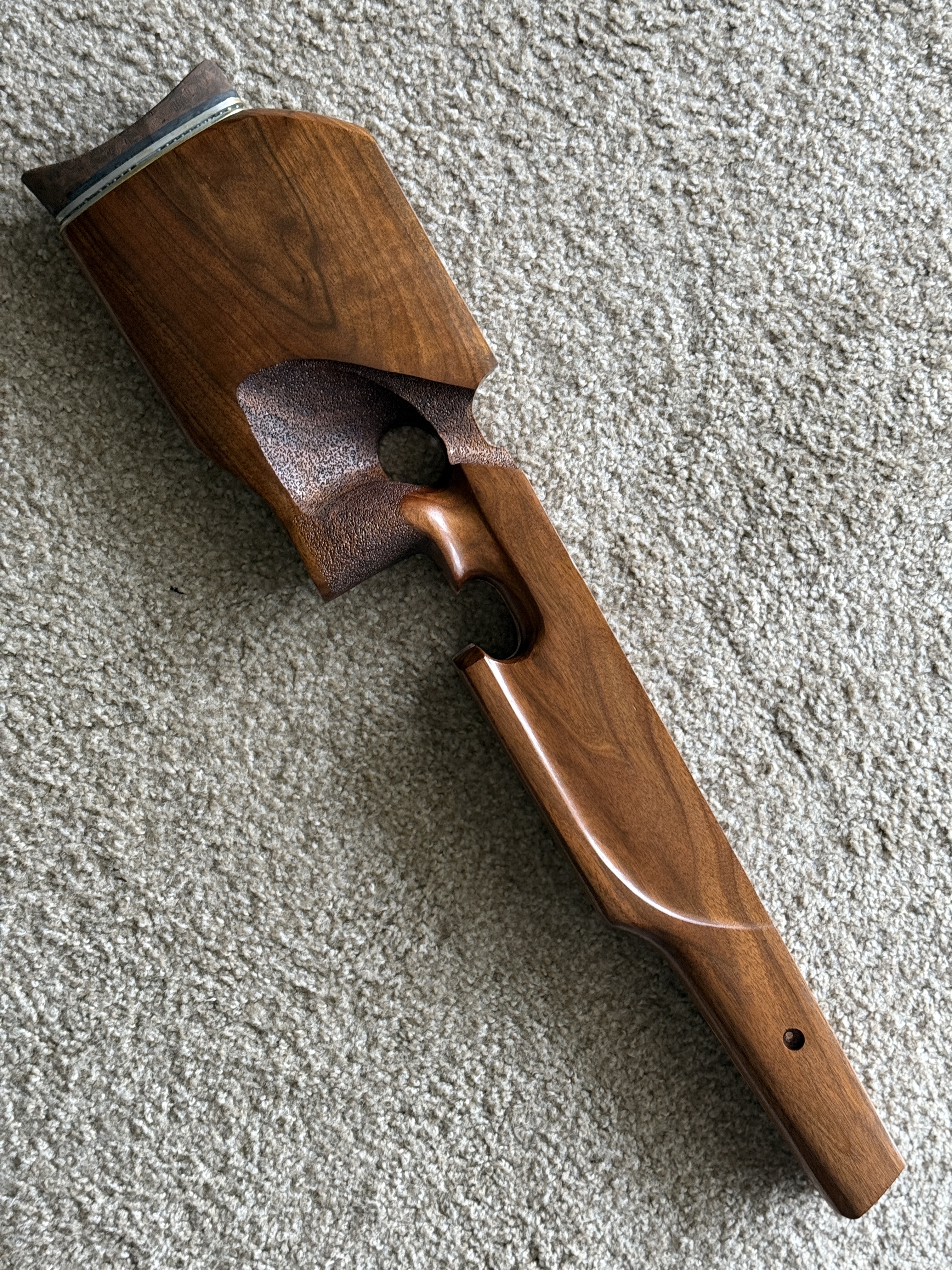

HW/Weihrauch  New stock for my HW97

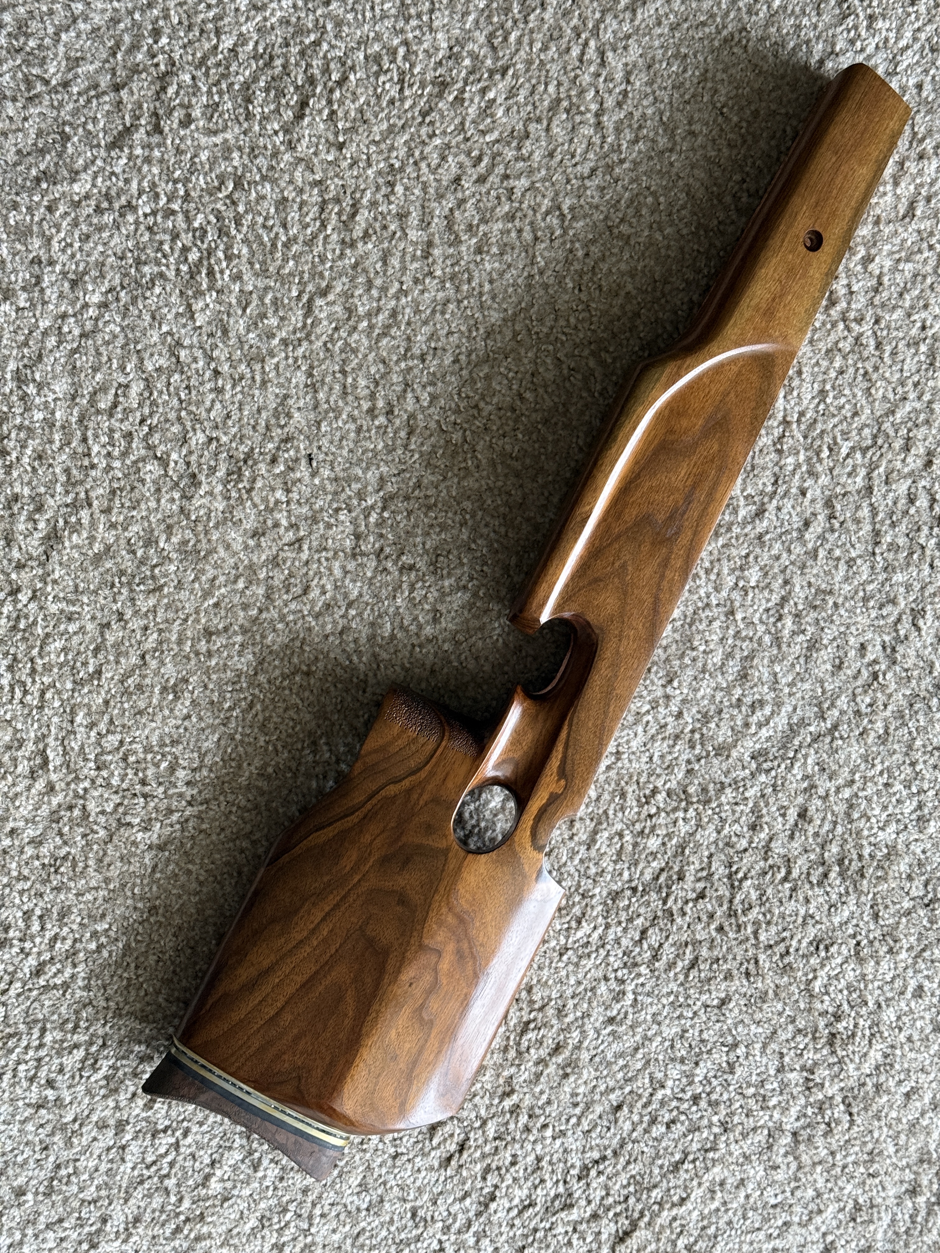

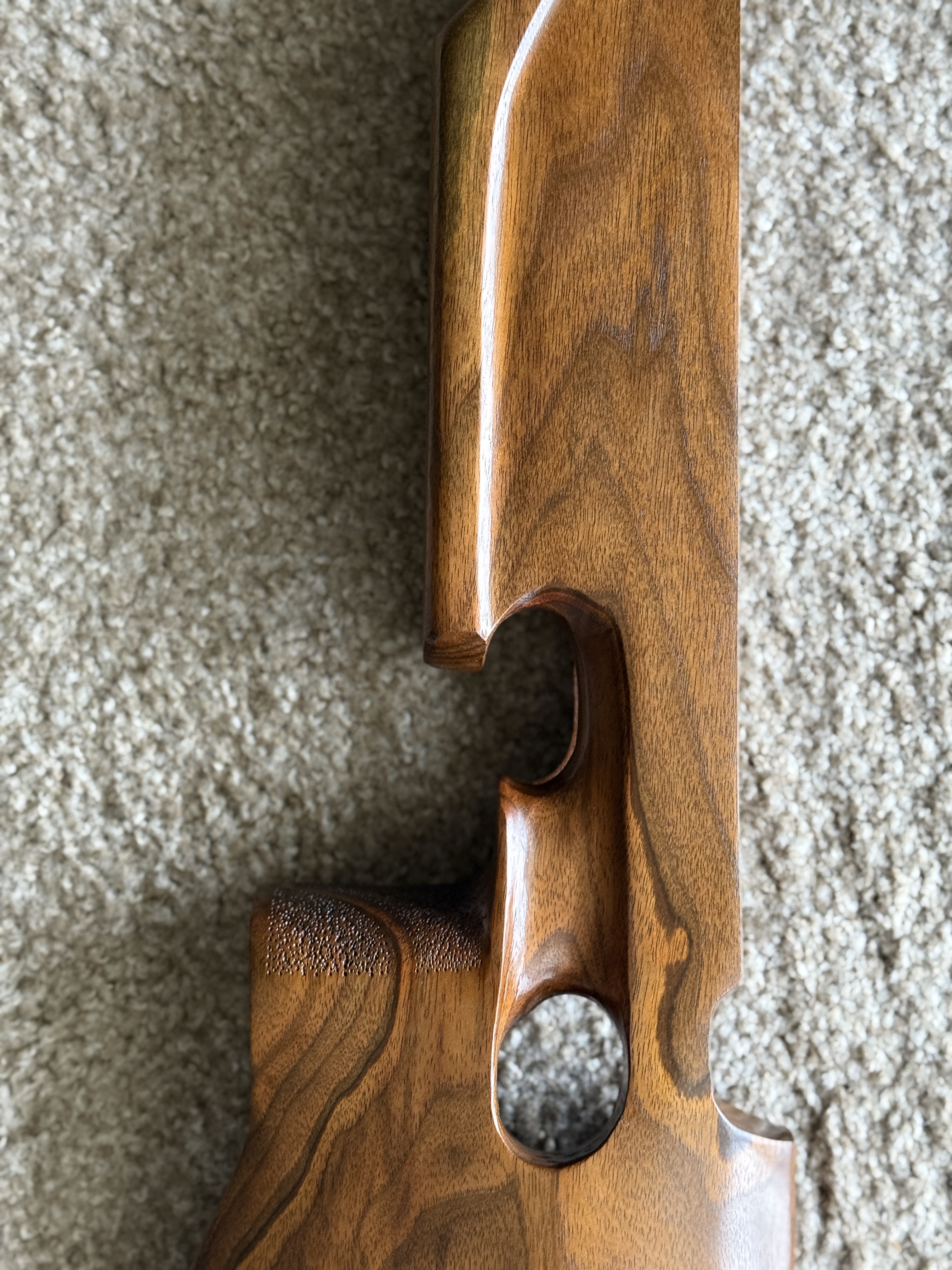

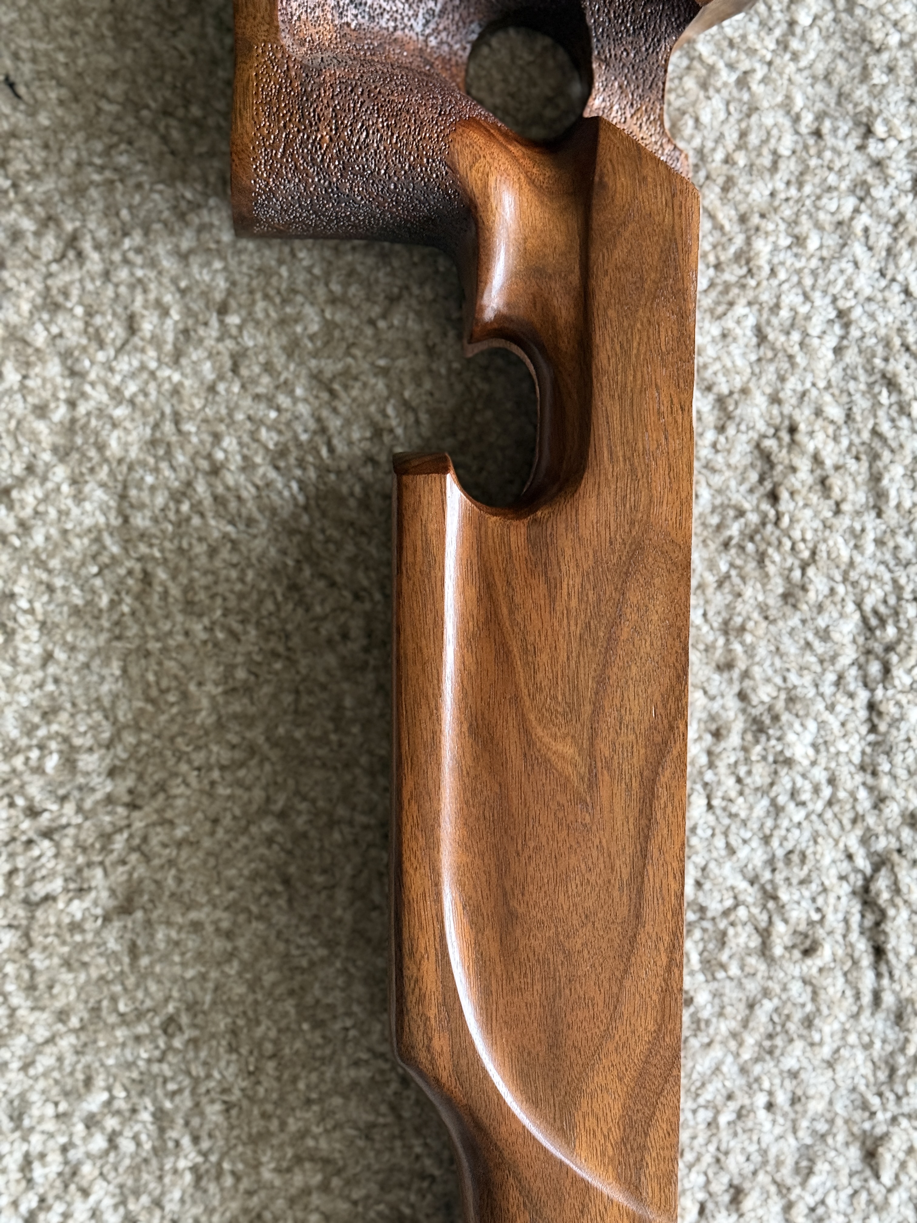

Hey guys, just thought Id post a few picks of my new mountain camo stock for my HW97 from Craftsman vit custom stocks , pictures don't really do It justice looks awesome against the silver anodized action . Fit and finish are top-notch can't wait to try It out ( when It stops raining ) .
