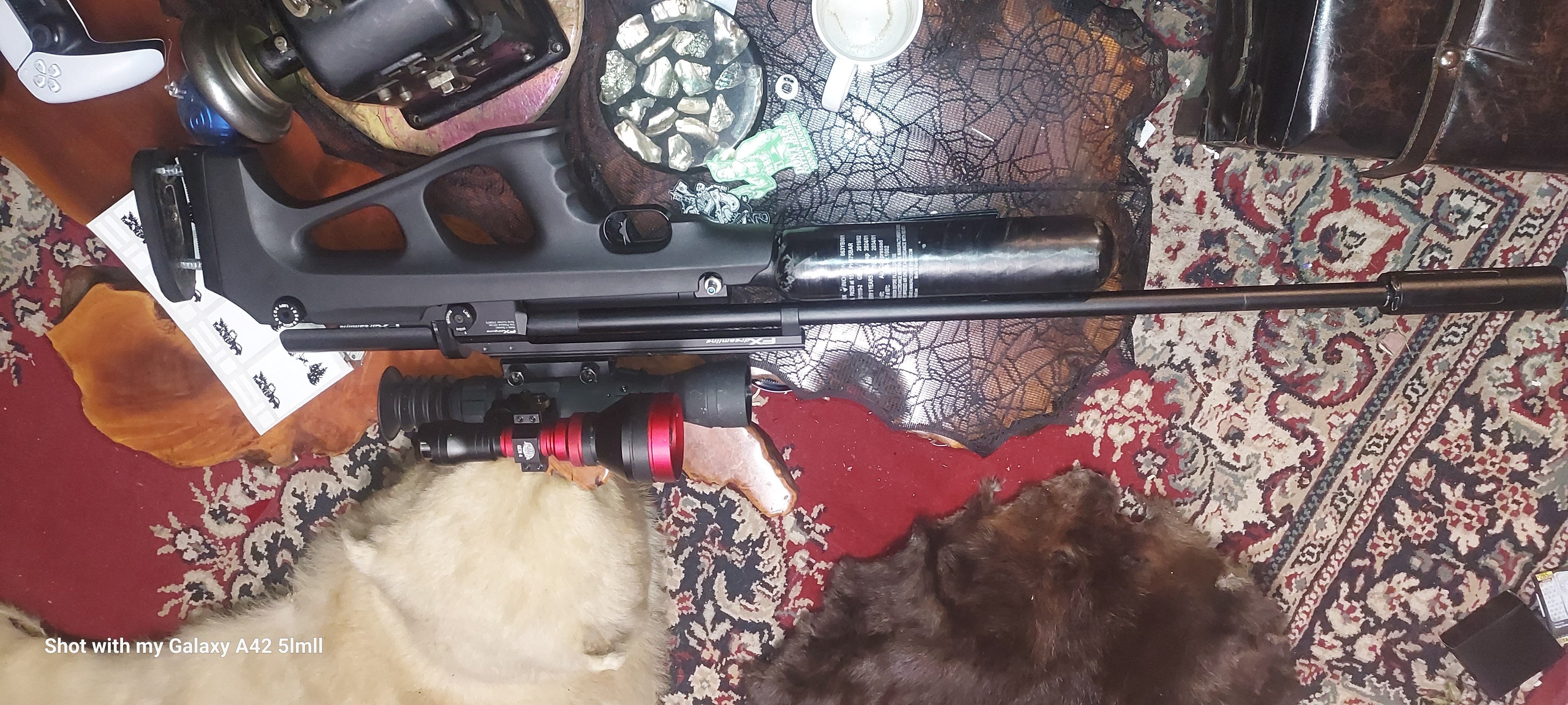

Basically im trying to replace my .25 700mm barrel with a impossible to find .30 700mm on my fx dreamline powerpup, the entire rifle is stock, from what ive read the crown and dreamline have the same barrel.I never said that. It happens quite often that individuals ask questions and give little information or partial information . They also fail to provide pictures which are always very helpful in trying to help others figure out there questions, problems or help assist them with their endeavors lol . There are several iterations of the fx barrels out there and some will work some will not .
