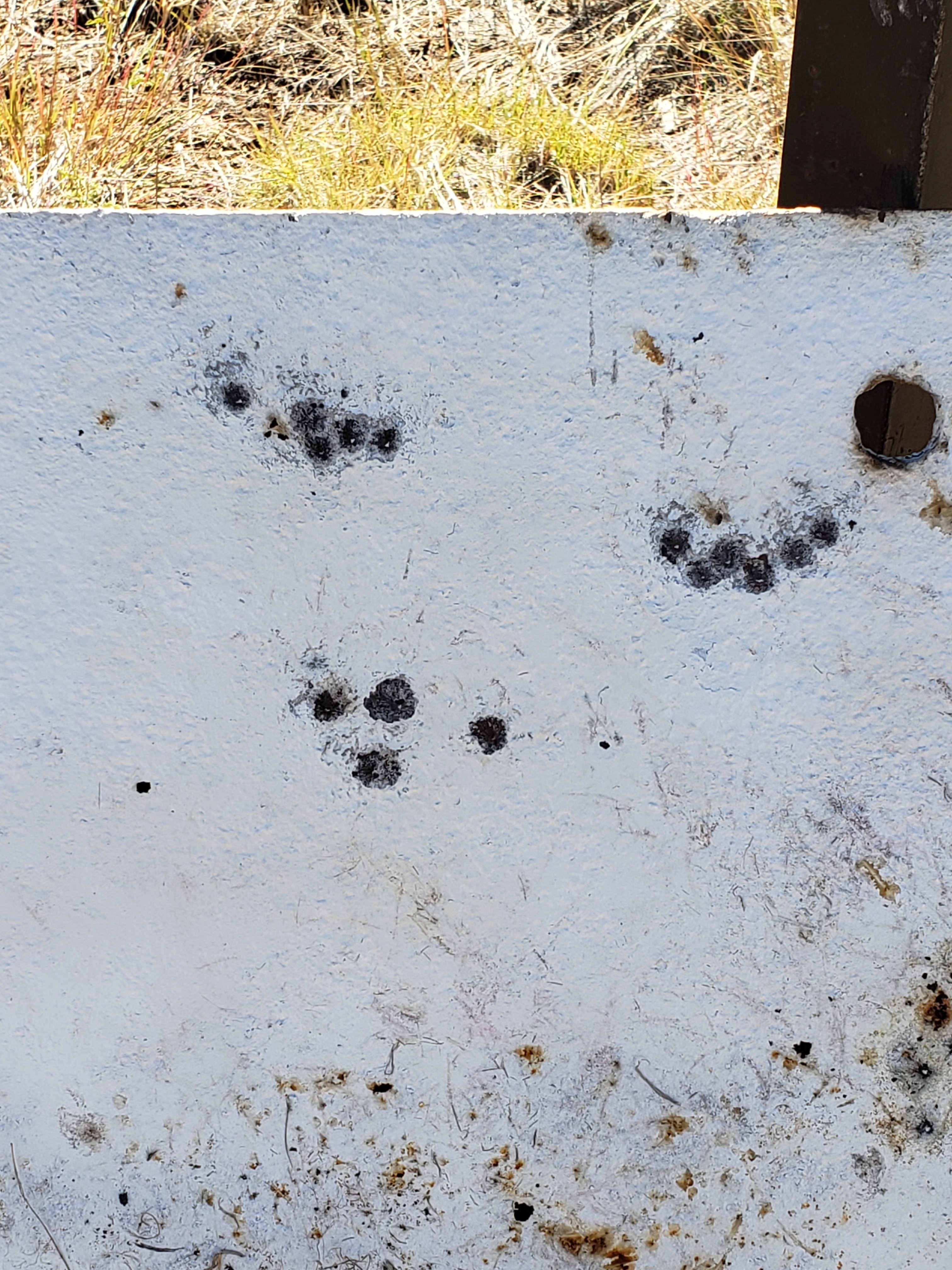

Derrick tuned my V3 which I'm very happy with. Currently my favorite slug is Altaros Queen 60gr at 862 fps/99 fpe. Been impressed with it from the start and a while back got a 12 shot group a little over a foot in size on steel at 421Y and it was far from calm out because I was holding off 3 mils.
Seems to shoot a hair over an inch at 100Y but honestly I haven't even given it a serious test yet.
On a 250Y fox sized steel its - ding, ding, ding, ding, and almost boringly so and that's in the wind too.
At this power level, plus the LOP being about 3/4" too long for me, its not an easy gun for me to shoot precisely. Shooting from bucket and sticks I have to have a near perfect NPO and follow through, OR ELSE! Pisses me off but that's not the guns fault.
It's been keeping a pretty consistent zero as well which means a LOT to me. BTW POI shifts are my #1 enemy when it comes to airguns which makes me like the V3 all the more.
This was off bucket and sticks last week and in 3-7 mph full value winds at 100Y. Keep in mind I'm a wobbly old guy. That hole is more or less .9" but the vertical is good and averaging well less than an inch.
