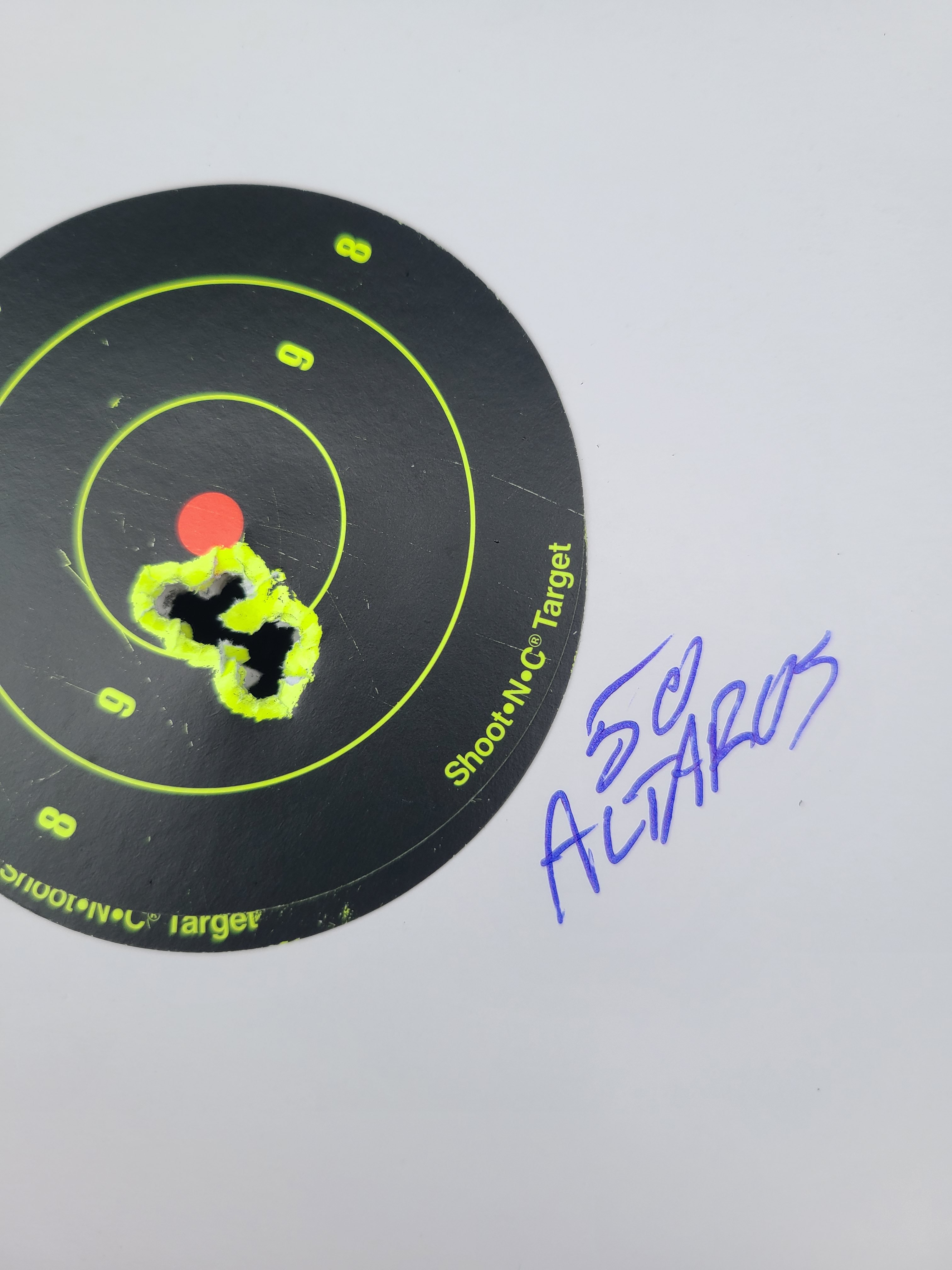

I would like some good velocities for my Uragan 2 for 38 grain slugs and 50 grain Altaros. I am currently getting 960 fps for the 38 grain and 850 for the Altaros. Good groups but not great. My 25/700 Panthera likes 920 for the Altaros. When I got the Uragan it shot the 38 grain slugs excellent but I have been adjusting the regulator and now cannot find anything super satisfactory. I did not bother to check the 38 grain velocities before messing with it, bummer. Should have left it alone.

Do you know what your regulator is set to right now? Your gun is shooting definitely putting out good power, sadly with the U2 it's not a matter of adjusting here and there due to the balanced valve. Do you know where your regulator is set that right now? Also, how many turns in do you have on the hammer spring?
Not sure where the reg is set. I understand that the Huma regulator has numbers but this has nothing. I also understand that with a balance valve there is little effect if the hammer spring is changed
Yes and no, so the reg should be set to 150b from factory, a 1/4 turn is about 30b up or down. Adjusting the hammer spring won't do a lot to change the velocity but the hammer spring is set pretty high from factory.
