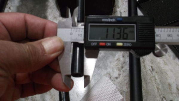

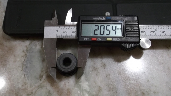

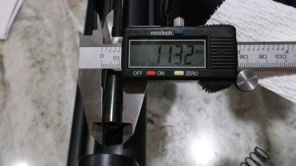

Hey Michael - I left the tank shroud because I honestly like the look. The tank cover on my Gauntlet is not fitting well but others are not having any issues. I will adjust the tabs and make it fit properly. The barrel is very close in size see below, but the shrouds aren't. I am not sure who makes these barrels I need to find out though.
GAUNTLET BARREL O.D 11.36 ----- MROD BARREL O.D. 11.32
GAUNTLET SHROUD END CAP 19.83. -- MROD SHROUD END CAP 20.54

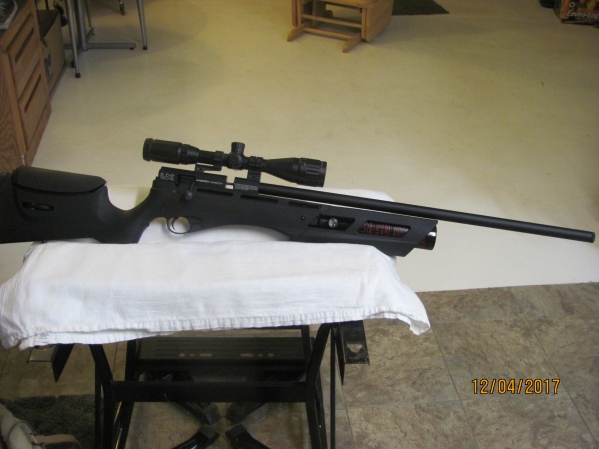

 I have mine, traded used and do like it. I've had a QB78 HPA for seven years ( thanks to a friend), excelent FT rig.
And even though it was custom built to the highest standards I naturally could'nt help peeking & tinkering with regs & such. 850spi, 1,150, TP, hammer weight, sprung weights & such
The Gauntlet is a screaming value that really needs little more than a trigger adjustment for most but has design improvments over a QB that will allow all types of modding. I am just waiting for a chrony ( and fitting a QB barrel which may be some effort but I already have it) then I'll have all sorts of fun seeing what both cal. can do.

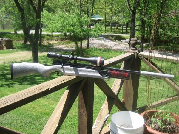

I have some more Guantlet pictures here:
http://www.airgunnation.com/topic/received-my-used-guantlet-today/
edit: and I'll keep adding pictures & numbers & such down the road.
Our Gauntlet ( which looks like all the rst eh?)

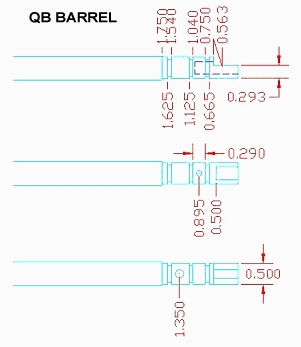

I was thinking " 11mm" barrel ( gosh close but???) so an 11mm LW would be an easy fit ?
Havent pulled my barrel yet, it has no cut " steps" like a QB?
QB barrel machininbg

Thanks for the maraduer comparison pictures! I didnt realize they were that close.
