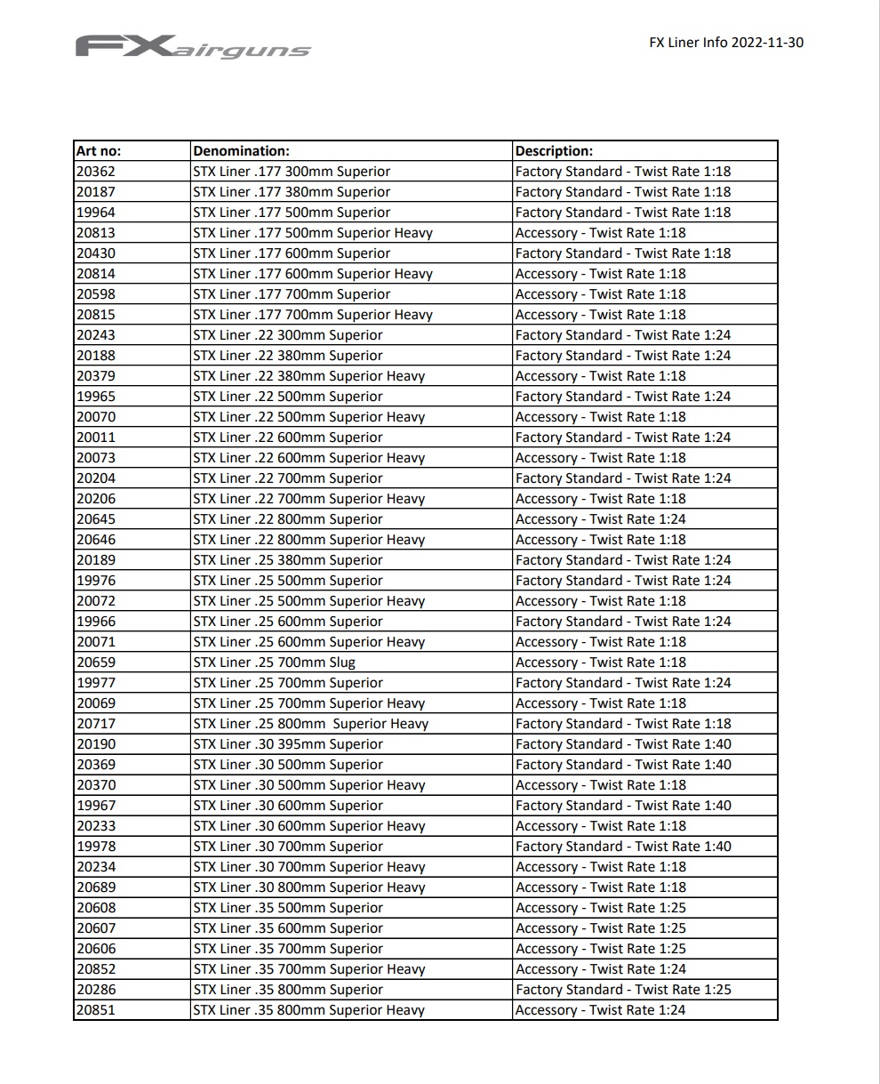

can we PLEASE get a 177 heavy liner with TR of 1:12? Or at minimum 1:14. PLEASE?
Or at least remove the heavy liner as it is just a regular liner, at least in regard to TR which i assume is the main factor in regard to accuracy.
I will rethink my situation in the coming weekend as i very much doubt i can do the 1.5 hour long drive to the shop to pick up my Maverick tomorrow.
I will also take a talk with Krale tomorrow in regard to my options, CUZ on the face of it i am tempted to try the new barrel, but from a technical point of view why even bother when it is the same as the 700 mm barrel i already have ( STX superior )
