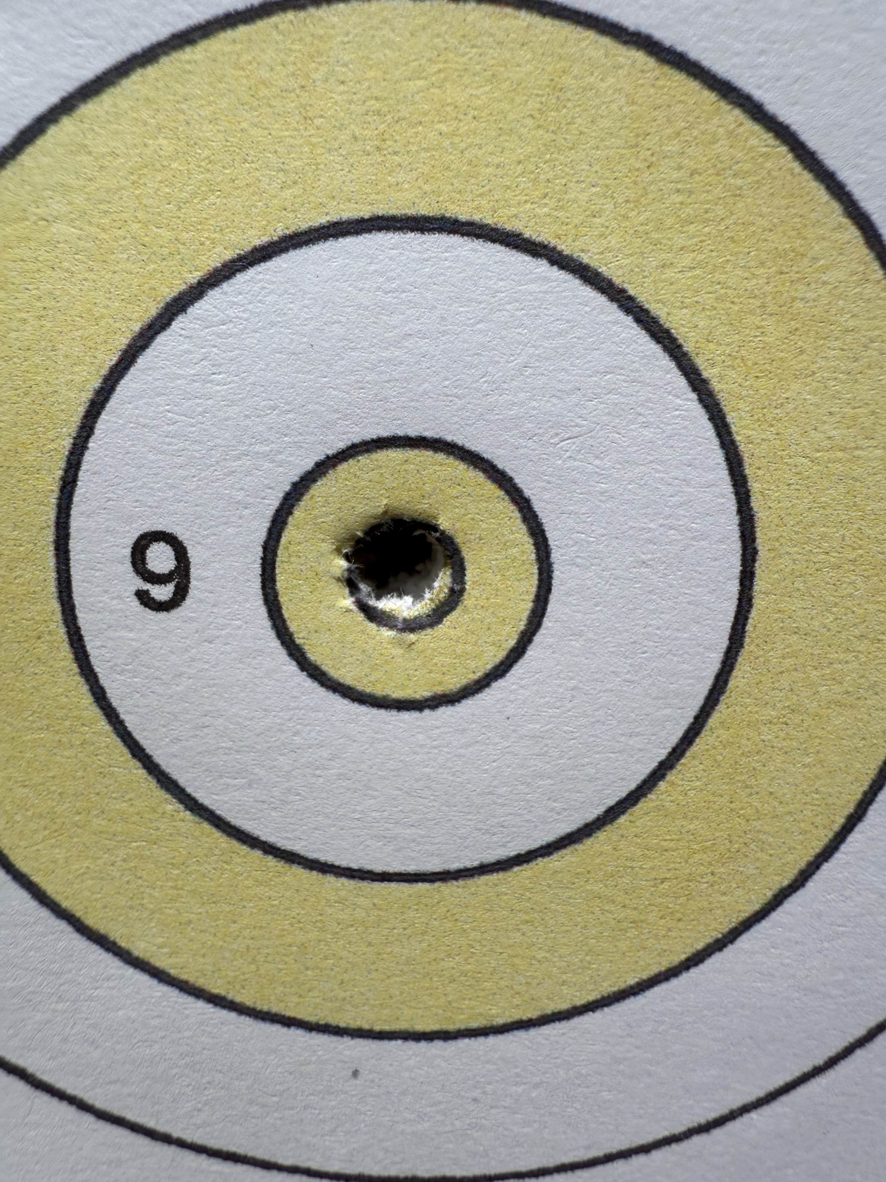

Then I shot the Altaros King 40 grain at the same distance. Accuracy was slightly better than the ACE, with the majority of shots in the 10 ring and one or two in the 9 ring (SubMOA). Same speed as the ACE, and got a BC of 0.209 RA4.

Altaros .22 caliber 40 grain King at 104 yards breezy switchy conditions.
