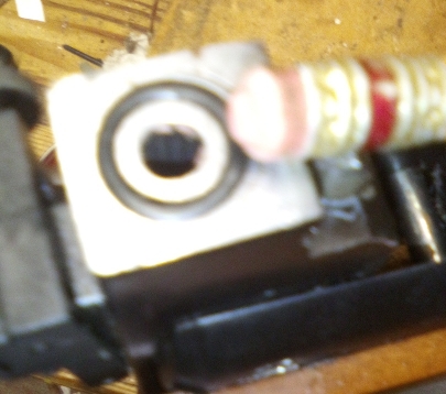

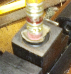

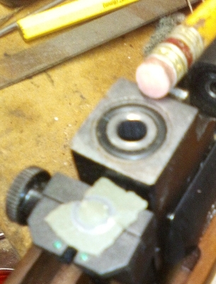

Also being a hatsan the leade holes of mine were cut sharp and i did think it scared the pellet heads when loading. So like the crown job i did a leade hole job shaping a pencle eraser and spinning it like hand valve grinding
View attachment 353026View attachment 353024View attachment 353025
Thanks. I checked the leade - looks OK to me, but I'll get me a pencil and polish it. I have some 400, 600 and 1000 emery paper that I can work on it with.
