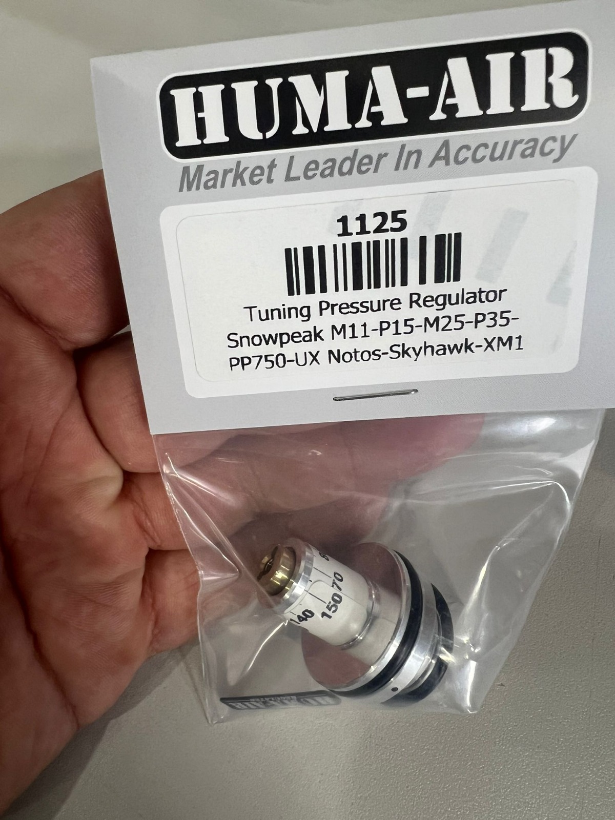

Remember, the hammer spring tension needs to be strong enough to open the poppet valve. The higher the reg setting the more tension is needed. It's a balance.
Upvote 0

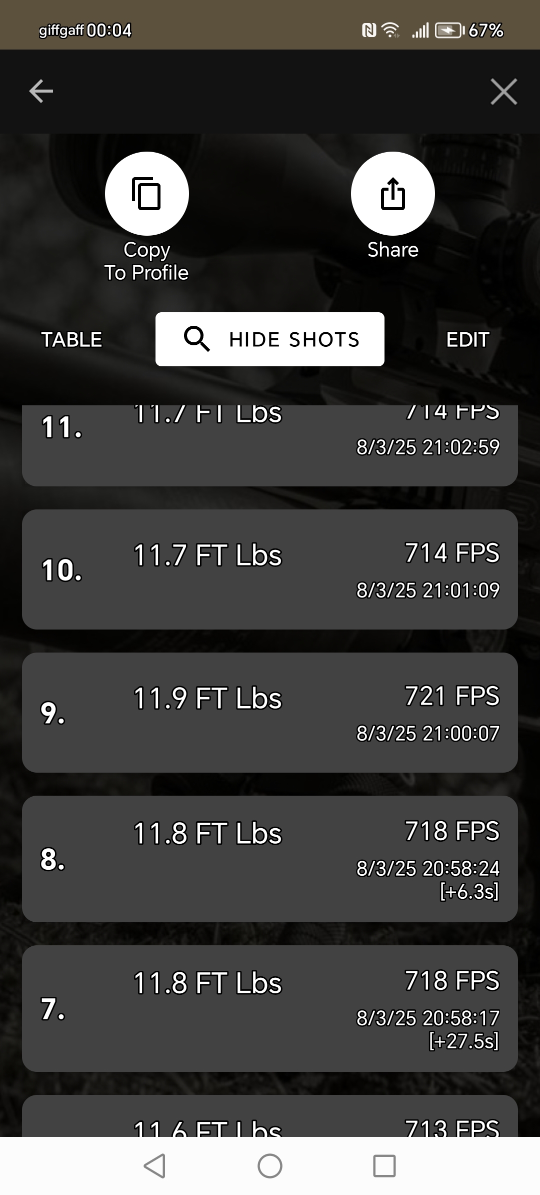

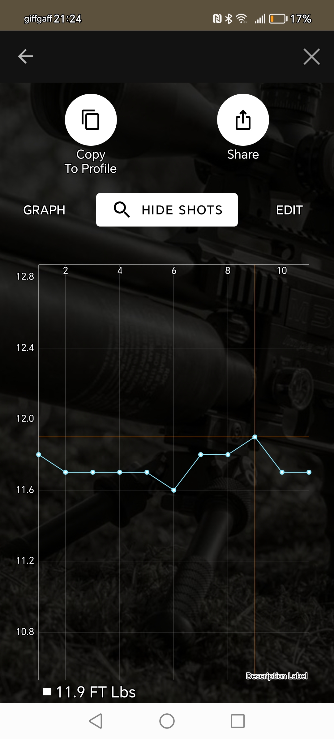

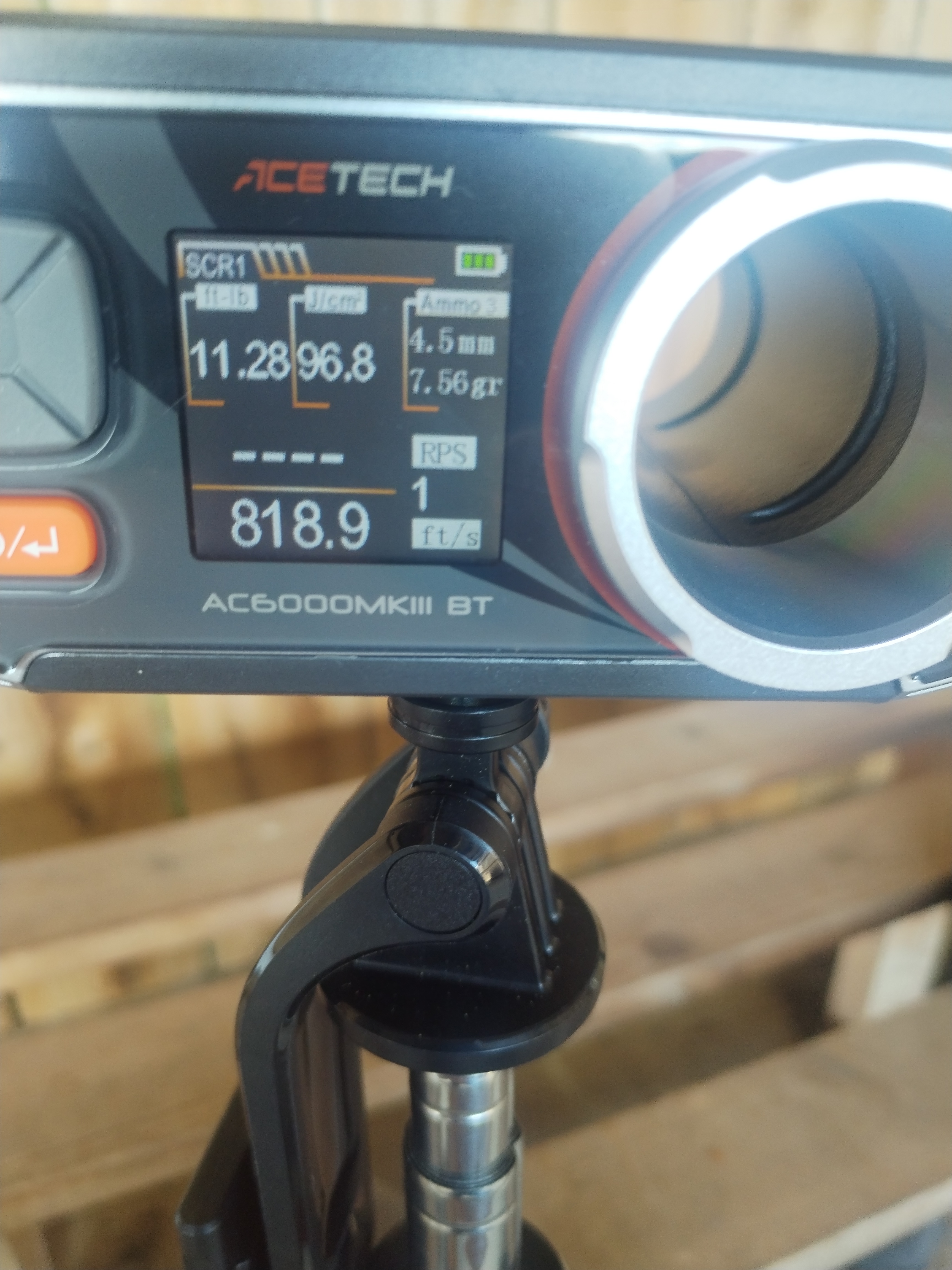

hi thank you for getting back to me, and yes it came with a factory regulator new, the only problem is we asked huma-air to set it for me at 12 lb which they never, we still don't know if it need's to be sorted out before it goes into the air cylinder, because you're meant to screw it at the top then underneathDid your rifle have a reg factory new? If so, yes you just install it with no machining.
thank you for your help and advise how many turns does the huma regulator need we've been told 2 then 3 we aren't sure tbh if you could give me some advice there please I'd appreciate itRemember, the hammer spring tension needs to be strong enough to open the poppet valve. The higher the reg setting the more tension is needed. It's a balance.
no what happened is I got into the hobby after having an illness I went to the local gun club, after being there a while I asked if I could buy the artemis p15 from him, we've recently found out the spring had been swapped to an even smaller one, i had to give him the rifle at that point because I didn't know how to change the o ring's for it, long story short the rifle was given to him to replace the o ring's all of them had to be done apparentlyhi thank you for getting back to me, and yes it came with a factory regulator new, the only problem is we asked huma-air to set it for me at 12 lb which they never, we still don't know if it need's to be sorted out before it goes into the air cylinder, because you're meant to screw it at the top then underneaththank you
