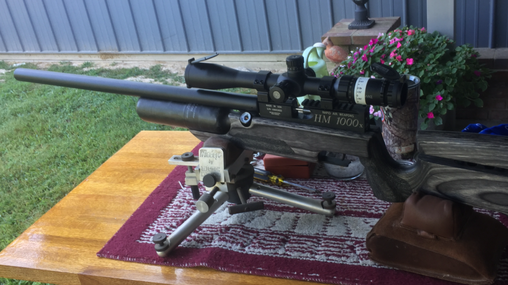

I just purchased an HM 1000x and it came with the big moderator (not offset). I want to remove it completely. I can get the end piece (actual sound dampener) and the tube off but I can remove the piece with the 2 set screws. Any suggestions? Bob
Remove set-screws ... if needed, heat the piece where it's contacting the barrel with propane torch - I didn't use MAP gas.
I was able to pound off with a wood stick and dead blow hammer. Heat softens the loctite used to secure.
