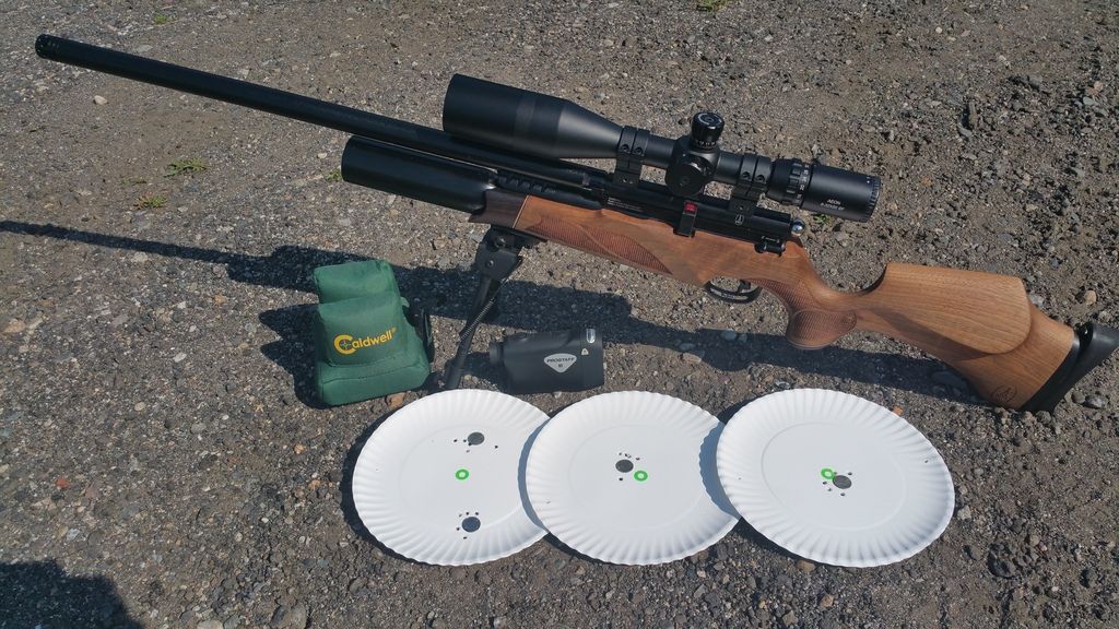

Yes sir, this past summer I did a similar post about shooting at 100 yards.
100 yards is a whole different animal in my opinion. Based on half inch groups at 50 yards, you'd think I'd be shooting 1 inch at 100. It just isn't so. Additionally, the groups I shot here in the link provided below, at 100 yards were 10 shot groups, not 5 so I'm sure that increased the group size a bit. The best I've done with this gun in the past at 100 yards was 5 shot groups that averaged about 1.5 inches. Taking all the guns I've tried over the past few years, I haven't been able to achieve better, honest results with any stock, non tuned rifle shooting pellets straight from the tin.
http://www.airgunnation.com/topic/10-shot-groups-at-100-yards-jsb-kings-jsb-heavies-jsb-heavies-mkii/
The .22 BSA R-10 is the only gun I've ever owned (and still own) that will hang with the Royale at 100 yards.
