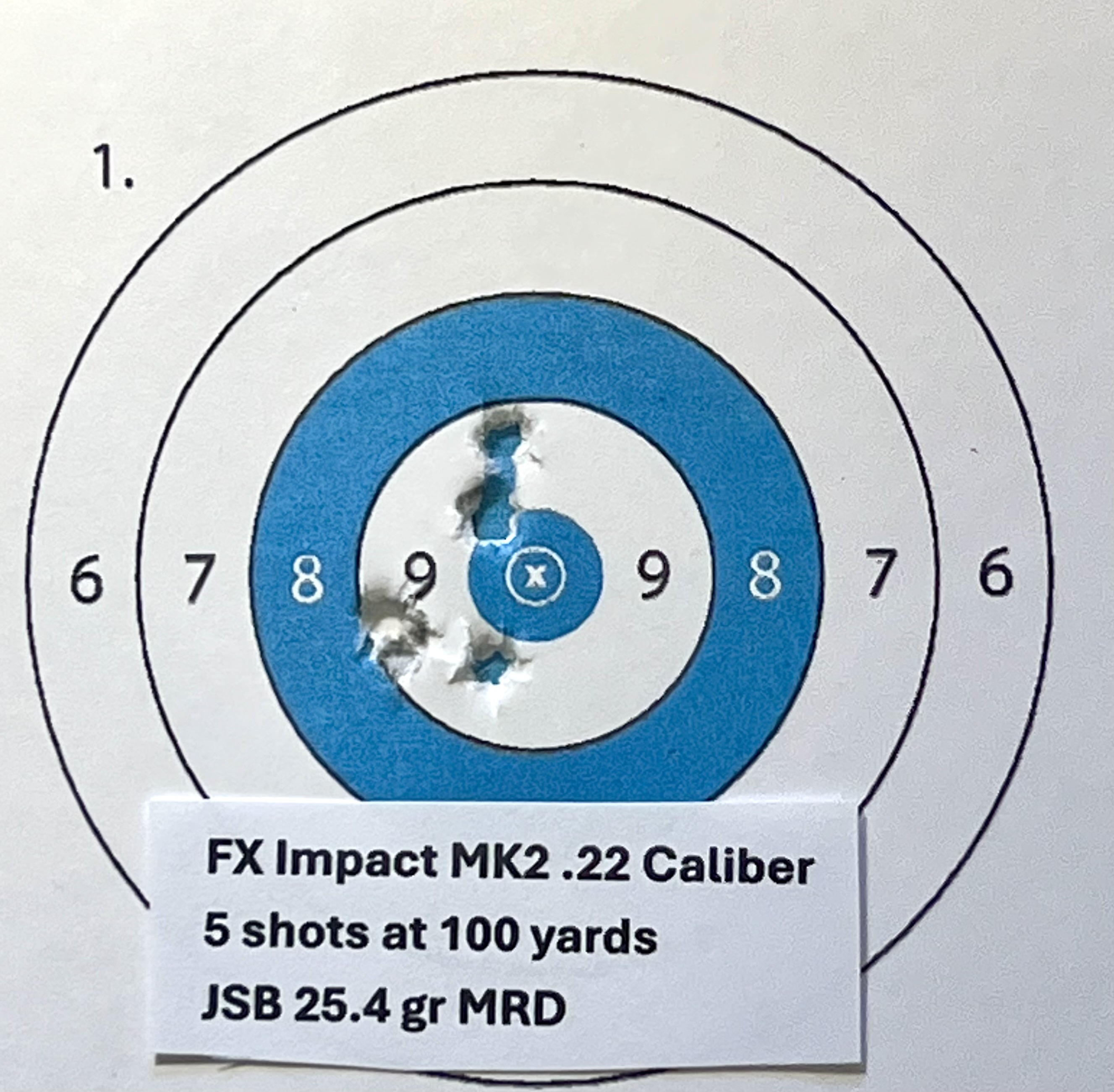

Pardon me. I wrote an imprecise question. I'm looking for 25 shot, .22 pellet groups outdoors at 100 yards. I'm thinking that 1 1/2" would be respectable.

“Repeatable” 1.5 MOA is VERY respectable, outdoors.

There is a lot of discussion here about one MOA accuracy at 100 yards. I wonder, how many of those respondents consistently shoot 1" groups at 100 yards? I'm not a high level air rifle shooter, but I've been shooting firearms and air rifles a long time and I think I've learned a bit about it. One of those bits, there are very few standard power air rifles that will meet that test, and even fewer shooters who can meet varying conditions well enough to plunk 5 shots consistently into a one inch hole at 100 yards. As Mr. Monk said, I might be wrong, but I doubt it. So, to the OP I say, don't be discouraged if you find the one MOA test at 100 yards very daunting, and be amazed if you meet it.

Here is my take… and I’ve shot in 100 yard competitions - so I’ve seen the cards of many shooters….
Outdoors in the wind with .22 caliber pellets - if you can pretty consistently put 5 of 5 shots onto a 2 inch splatter target you are doing very well. To do so will likely require using 21 to 25 grain pellets - and even those heavier 22 caliber pellets will still move a lot in the wind.
I’ve watched many of the top airgun shooters compete at 100 yards. Almost none are using .22 caliber. After 75-80 yards, .22 caliber pellets move a lot in the wind.

IMO, it doesn't matter which caliber you shoot at 100 yards. I generally compete with 30 caliber, but have also used 22 AND .177. All of those rifles are capable of winning, but reading and compensating for wind is different for each one. Admittedly, the smaller calibers are harder. Let's face it, the winning shooters are better marksmen regardless of what they are shooting.
