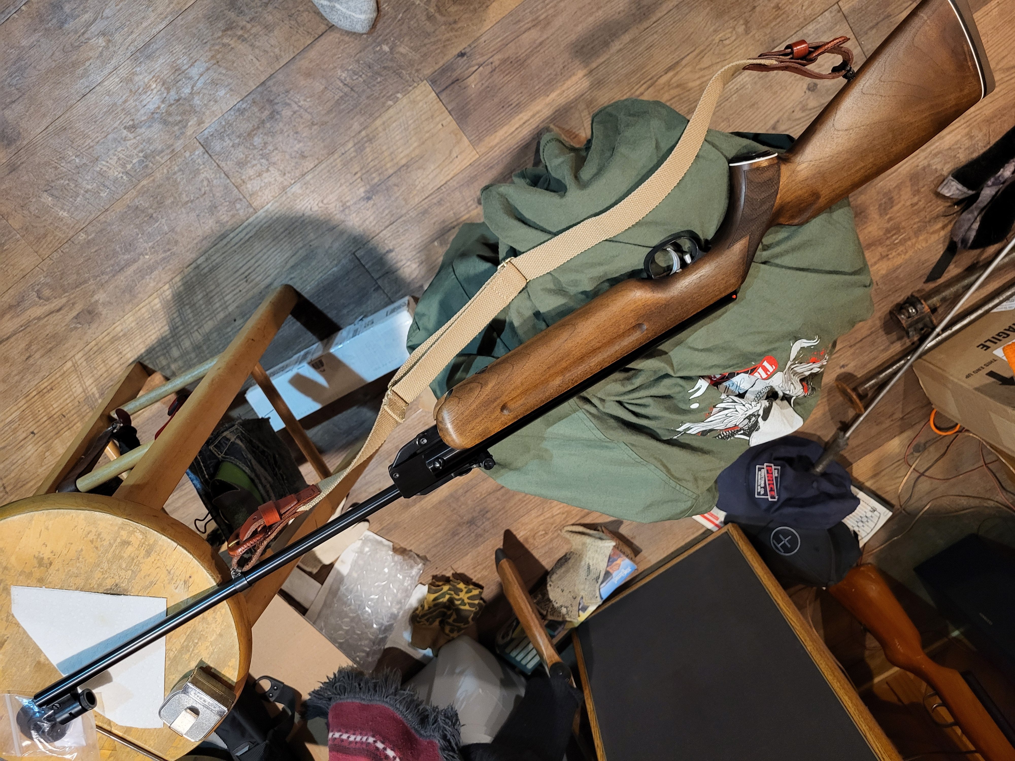

I have one... oh maybe 8-9 hundred pellets down the pipe. No let up in temper, still a bitch. Might have to dig it out and put some more down. This is my only HW I don't particular care for. Bought it for it's looks.
This ain't the only up side down thing lately...
