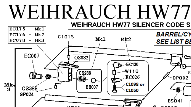

Shot my early HW77 the other day. Cocking lever fell out after a shot. Expected to see the detent ball rolling around on the ground. Nope, still staked. Was thinking maybe tired spring until I realized the entire front assembly had moved forward. Slid back into place. Holds for a shot or two then moves again. Looking at schematics for the current version it appears there’s a grub screw that holds the front assembly in place on the barrel. Correct me if I’m wrong. Does anyone know if the first version had a grub screw? There’s something that looks a bit like a grub screw, but if that’s what it is I think I’m going to have to drill out because the head doesn’t look right. Hoping someone knows for sure. If it’s friction fit then only thing I can think of is to tap back in place with a wooden block, maybe heat a little first?
