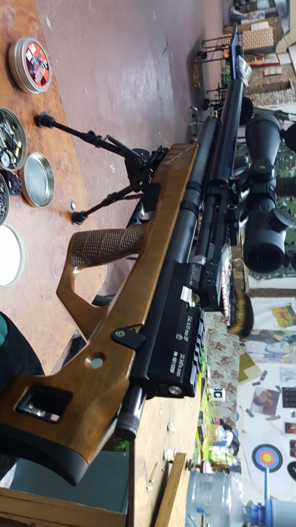

Texag, You might be a candidate for a Barnes handmade rifle and bullets.Gary Barnes has been making bullet guns for 20 years or so. Barrels and all parts and matching bullets are made by Gary.
If you Google  Barnes .25 Magnum airgun video  you should get an example. His airguns are all super accurate and cover all the larger calibres, but are of course very expensive.
Regards, Harry.

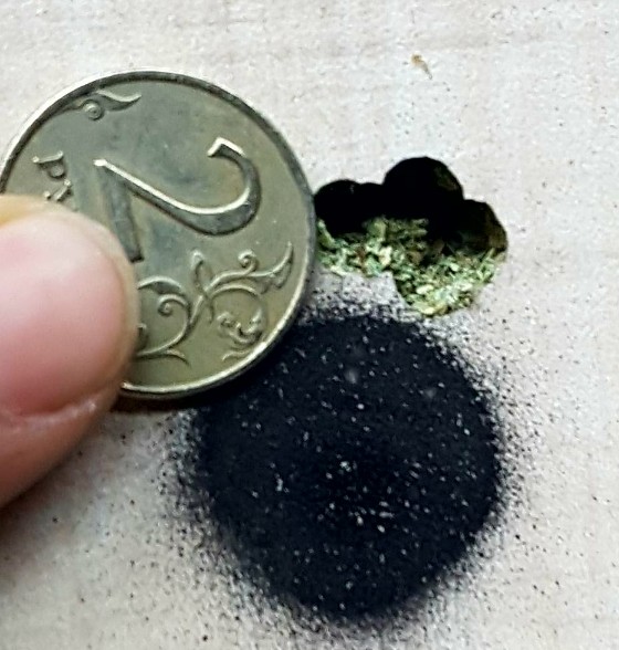

Horhe-Jager SP Bullet 46.29 gr
speed 950 ft/s
distance 50 m
