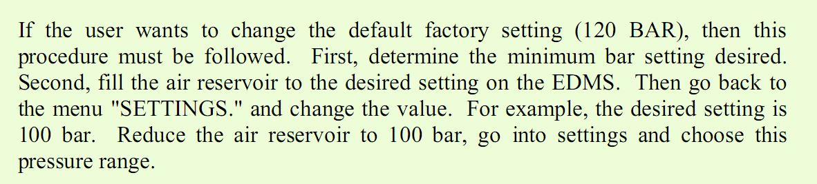

The digital gauge do not read you reg setting
As far as I know, the default 120 bar setting is used only to calculate remaining shots and you can change this setting
Both my classics reg. are set at 120 bar and adjusted to the 5% below the knee so holds poi down to 100 bar so if I wanted to use the calculation option I would change that setting to 100 bar, but I find it easier just to look at the bar reading

EDMU user manual attached
View attachment Handleiding_-_Digitale_Manometer_Edgun_EDMU_EN_.pdf
Yes manually lower the minimum setting for the last useful shot, the EDMU do not know you regulator setting but keeps track of the tank pressure, so all you have to do is lower the tank pressure to the desired minimum and affirm this in the setting menu
So finally got a leshiy classic bought and it has the digital gauge. My question is does it automatically read the regulator setting? It says 120 bar now. if i go in and try and turn this down to 110 will it automatically pick up that reading
