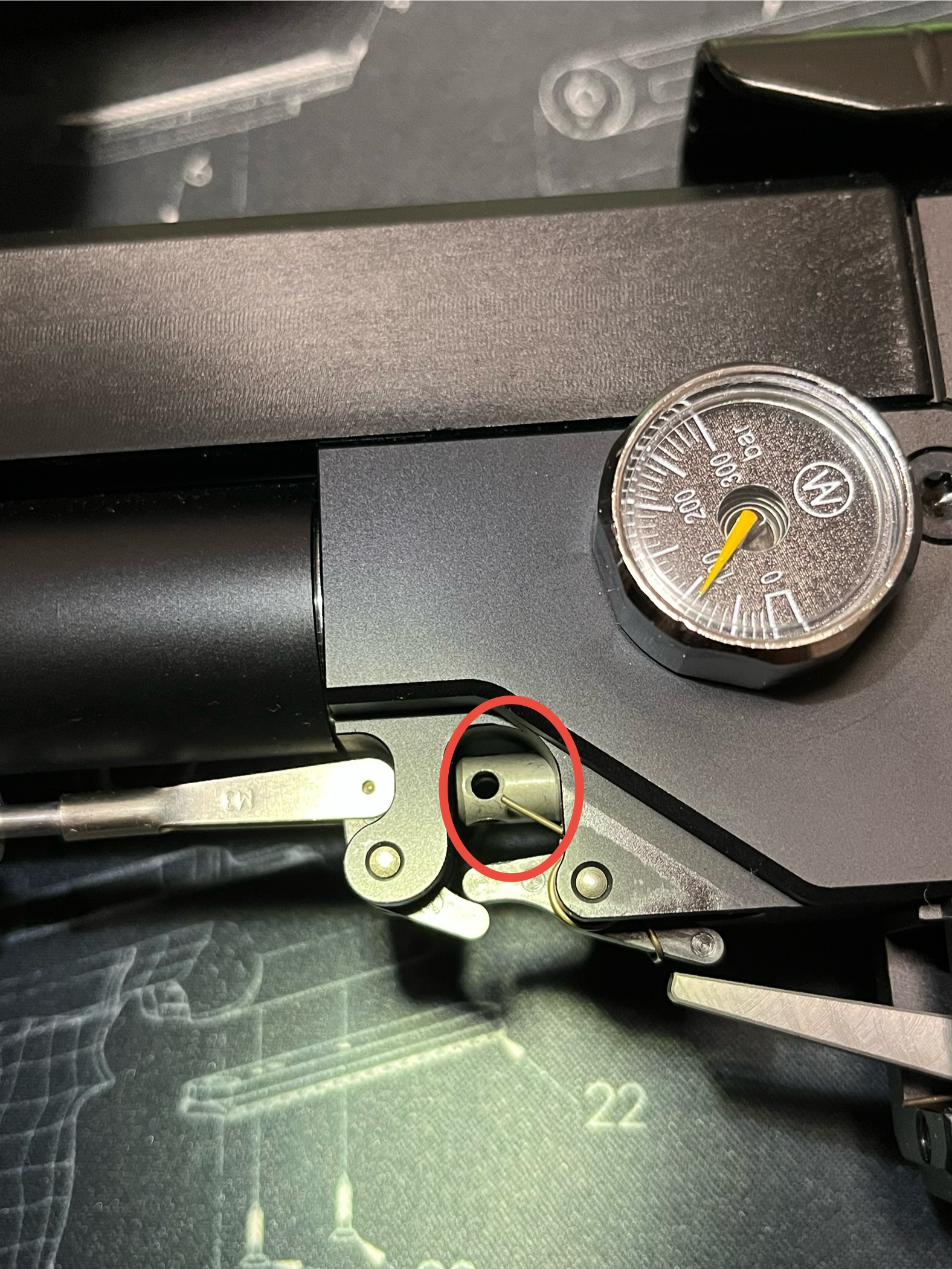

Hello krait X users.
I have a question and a request for all those who shoot snails/slugs weighing (27-30gr)
Can you take a measurement and show you a picture of how deep your valve is screwed in? And what pressure of the regulator do you have set and how many shots does this setting give you?
My valve is strongly twisted, so the labour jump is long. It works great with bullets up to 23gr, but unfortunately not heavier ones. I would like to do an overview of how it looks with you.

Sorry, not really answering your question, but is this only available on the Krait X? I have a Krait standard and you got me thinking if the Standard has a valve adjustment knob.
Each version of the Krait has the same built valve as in my photo above. I contacted the manufacturer and it can be adjusted as needed but they recommend degassing the gun to keep the o-rings in good condition

Thanks for that. That’s not air efficient at all but I guess it’s either that or nothing at all. Lol
Also to confirm, this controls how fast the valve closes or stays open correct?

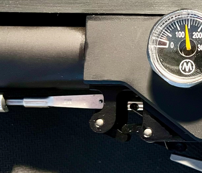

At the moment I don’t have better pic than this, but it’s good enough to see that my valve is screwed in significantly more than yours.
I’m using H&N HPII .217 25gr slugs and with reg @135b they fly 931fps.
ZAN .218 20gr with the same reg pressure - 994fps
Hammer is really close to its lock position.
Hope this helps.
Hope this helps.
