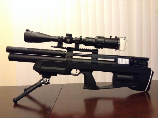

I just received a new Kalibrgun Cricket Standard .22

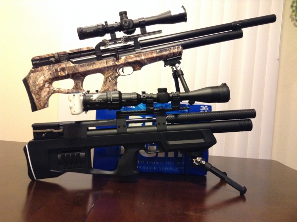

I have owned a couple of PCP rifle including Fx & Daystate before I just bought Fx Wildcat .25 last year and I realize Bullpup PCP is better for me due to hunting (I’m a small guy ^^). I was looking for a Bullpup PCP in 22 cal due to backyard shooting. After a year saving, I decided to get a Kalibrgun Cricket Standard .22 and it was in front of my door yesterday. Before going to work, I filled my Cricket to 220 bars and took a couple of shots (2 mags) through a chronograph to see what happens. I will do deeply testing this weekend.

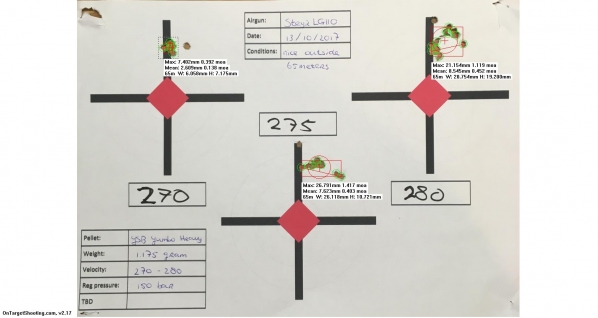

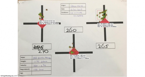

890 fps for the 18 grains Heavys is indeed right on the spot. That exact velocity came out best in my test with my CZ barrel :) If I discard the most extreme outlier the following is my result (in meters/second (890fps = 270 m/s)).
This was done with unsorted ammo so the groups can be cleaned up a little with that.
