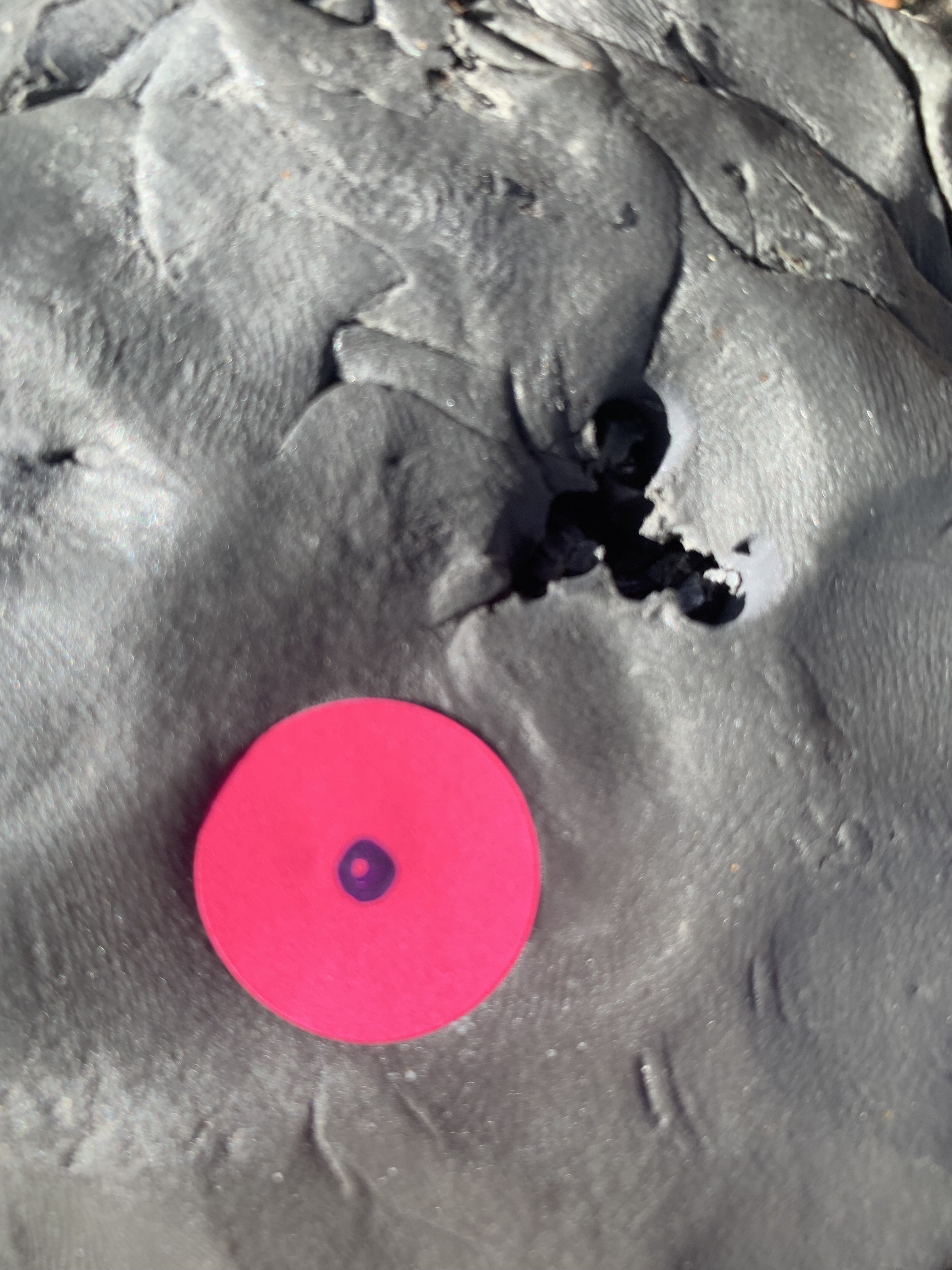

Here are the 6 shots with AVS 22grain in that sweet spot of the string. I was forced to go 8 yards further due to annoying December sun angle. Aside from that, the weather is great here in Utah and I’m going for a hike after this! I did replace my sticker this time 👍
The results are really good:
The circle is 0.75 so I estimate a CTC of 0.6. That’s within spitting distance of GTO performance so I’m glad that I focused on exploring the string dynamics. Of course, it’s one 6 shot group but I’ll now sight these in properly and use them for a while. If Dale@VK could post here, it would be good for him and us. Aside from that, I’ve had fun on this slug tear and I hope that this thread can become more like this, with real testing and posting of data, rather than fighting and conjecture. It is after all named as the ammo thread and I take that to indicate its utility in guiding choice of ammo. Have a good day gents (or night, considering Euro friends) and a special thanks to @wimpanzee for the productive interactions.

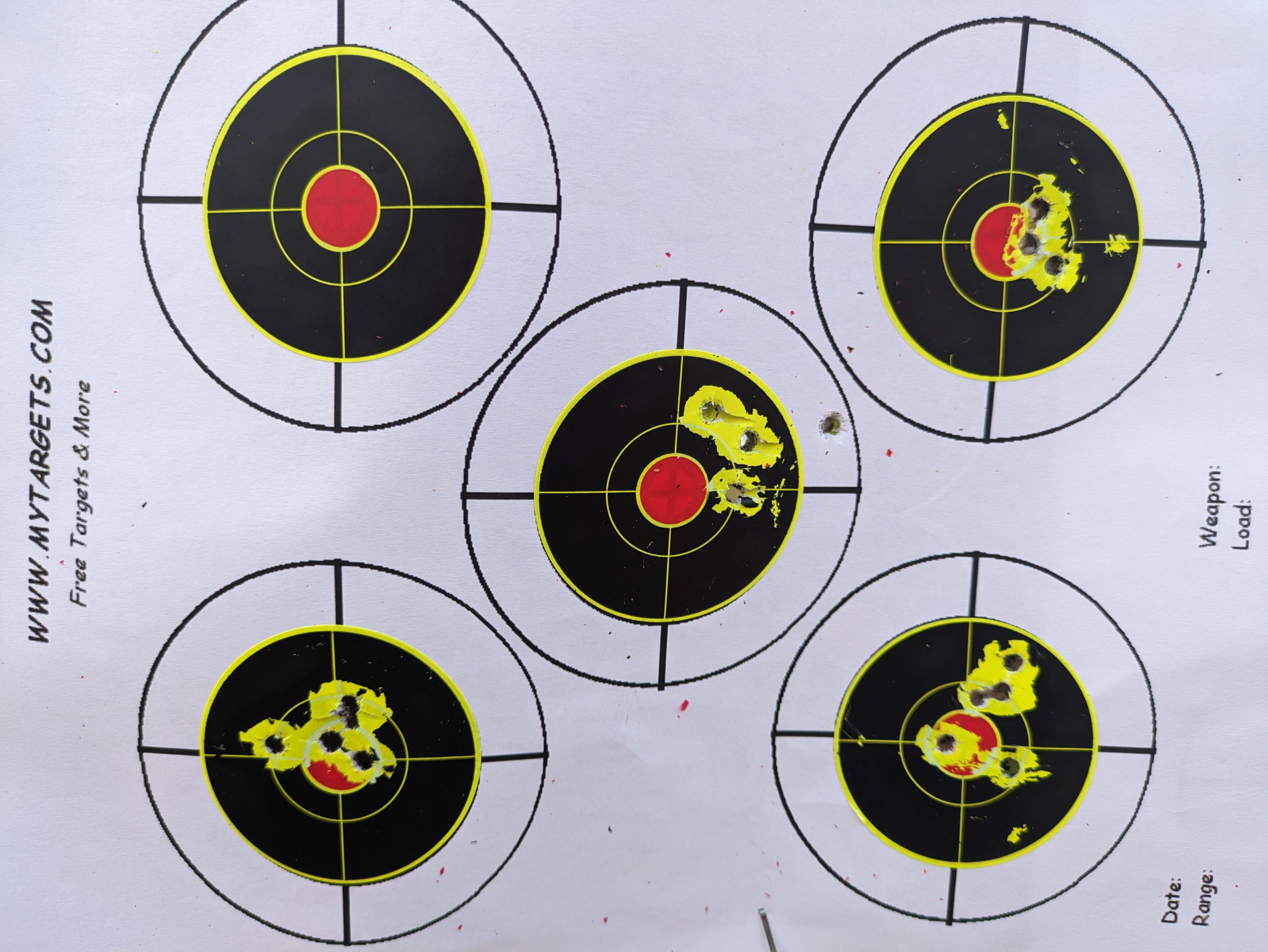

Shot these targets at 25 yards with a green dot - black circle is 2 inches...:

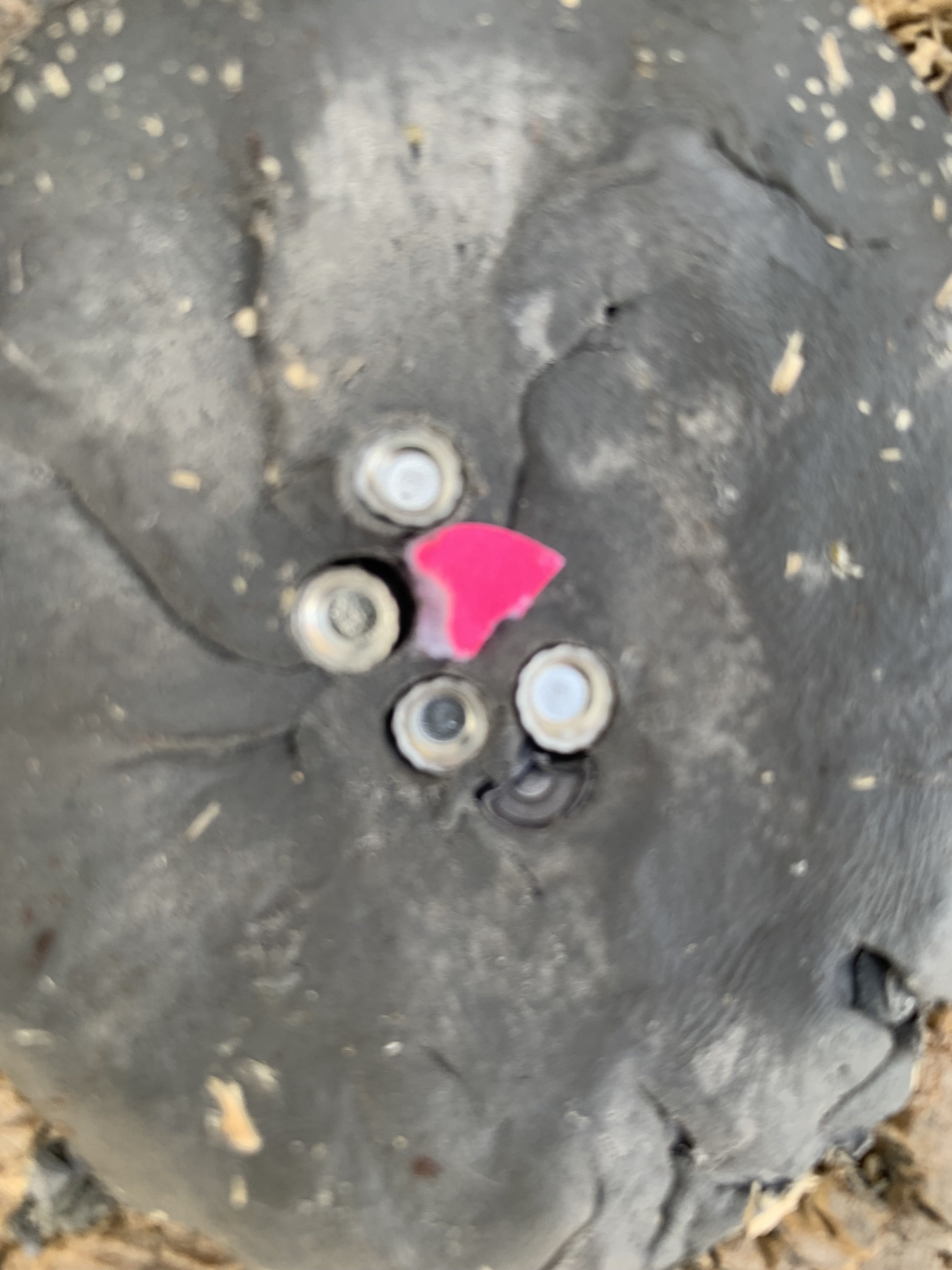

After having some fun with those AVS slugs, I decided to tune the GK1 back down to shoot GTOs at 900fps. I use the pistol for pesting in my yard mostly at 30y or less, so I prefer lower power and flat shooting out to 40. After using a scope, I couldn’t go back to a red dot, so it now has a Bugbuster, awaiting delivery of something nicer. Also, I opened up the holes in my air stripper mod that allows the shroud to be functional (to 1/8 inch holes) and it makes quite a difference. The GK1 is now very backyard friendly shooting the GTOs at 21fpe.
Now, after settling it in at 900fps, the grouping was not what I remembered, not even close, like 2-3moa! Cleaned the barrel and it came back on song, so it seems that they do not shoot well if you transition from shooting lead, or perhaps it was just that shooting slugs makes for a GTO-unfriendly barrel. Here’s what I got at 45yards. There’s a pretty calm shot cycle with these and I’m shooting from a rice bag, holding the airtube and pressing it back towards the grip. Yeah, I know, major cheating but this is what I’m finding to work for what I need to do.
5 shots. The squished lead pellet at the base was from my Katran and I missed plucking it out before starting. The missing GTO is a pellet on pellet - the leftmost one, which is why that hole is large.
Guys, this GK1 is a spectacular PCP, regardless of size. I have >20 PCPs and live near UA, so I’ve shot a lot more than that. Once you get a grip on it and work out where the flat regions of the shot string live, it will easily outshoot its bigger brother (the K1) and the Leshiy 2.
