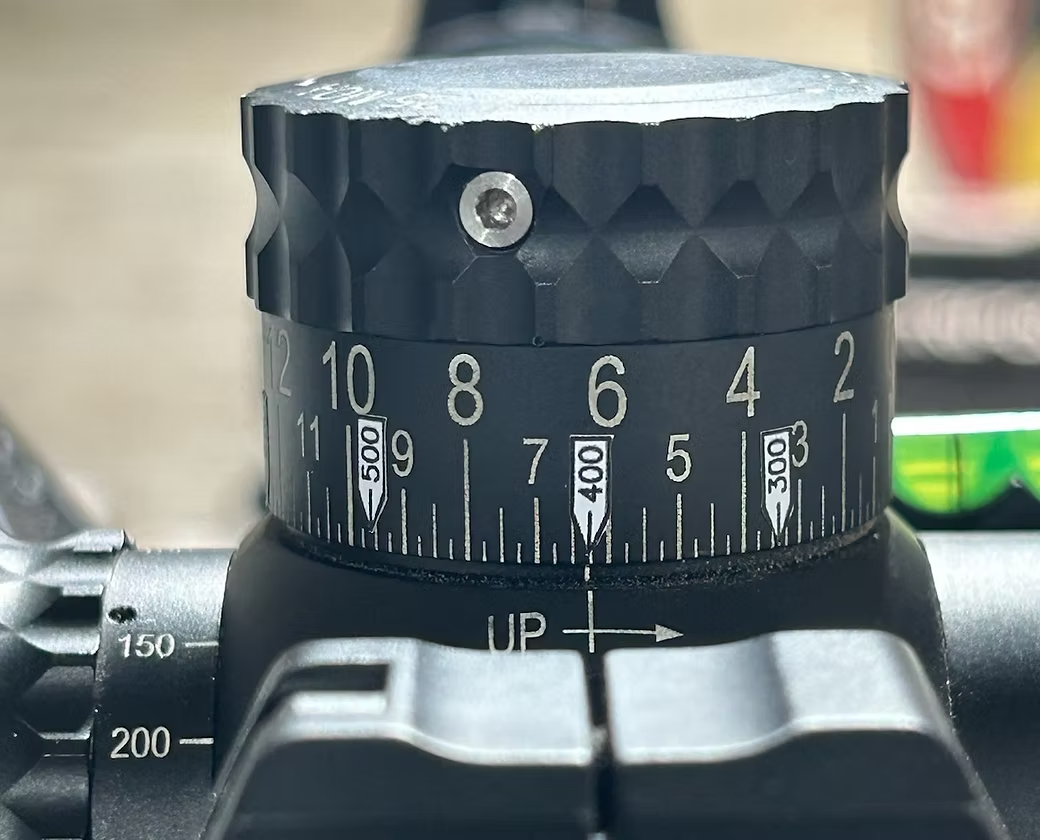

I just got a .30 Paradigm for pesting. Bought an Element Helix for it. All my pesting guns before this one are holdover. Last week I made a dope card and laminated it for the Paradigm from 10yds-50yds in 5 yard increments using turrets.
Rather than clicks I did it in minutes since counting clicks, in my opinion sucks. I have a very short attention span so I hope I remember to dial since I was using holdovers for years.
