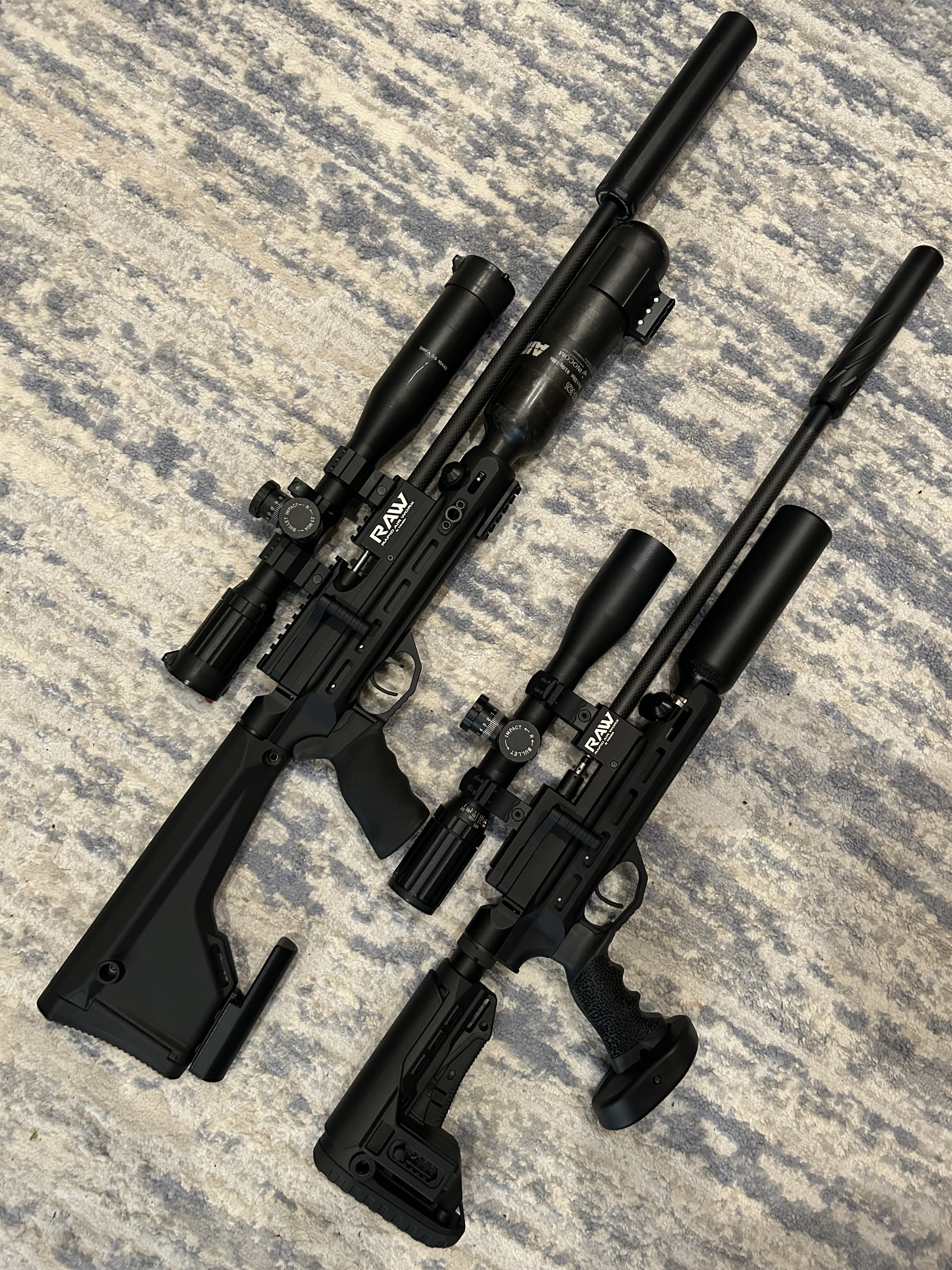

Do you have a link to the butt stock? Is it a direct fit or needs some modification? And can you change that ugly grip?Easy choice… neither. Get the raw pistol and put an AR15 butt stock on it. They come in .177 12ftlb or 20 ftlb versions. Here’s mine next to my Mini.
