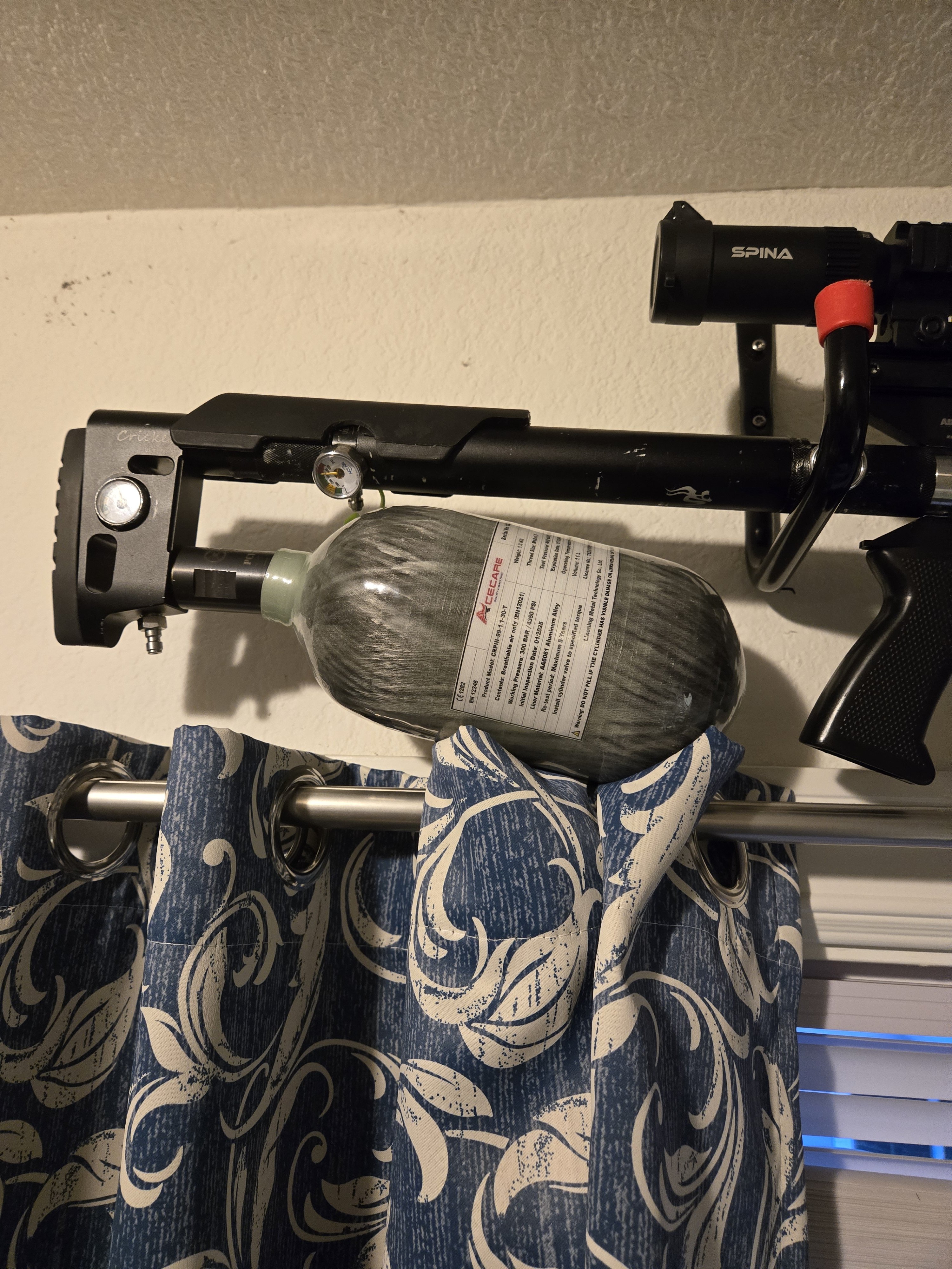

Thanks. Rebuilding the old 22 condor is what I've always wanted to do the only thing I've ever disliked about it was it's a single shot. Difficult to reload in low light conditions or wearing gloves. It was loud but I built a moderator from PVC and coke bottle tops. It helped noticeably with heavy pellets. I want to upgrade with a .25 barrel, New tank valve, stock etc. I was considering buying a new .25 condor but I could build a better one for less. Do you think you could give make up a good recipe for a nice build ?. For hunting. I'd like to get a good store bought suppressor to. I've got plenty of time before the hunting season. I sure appreciate yours and all others support. It sure makes a difference. Especially in getting a better PCP for the money. I'll spend as much as $700 for the project. Thanks Deafelf
I sent you a PM the other day.
OPTION 1:
May need a New bottle if the stock bottle cannot be used
Extreme Flow Kit: $232.20 (shipping $17)
Huben Power Cricket Max-ATH: $179 (shipping $30)
The regulator is optional but makes a big difference
.25 24" barrel: $211 plus shipping
$250
$210
$211
$670

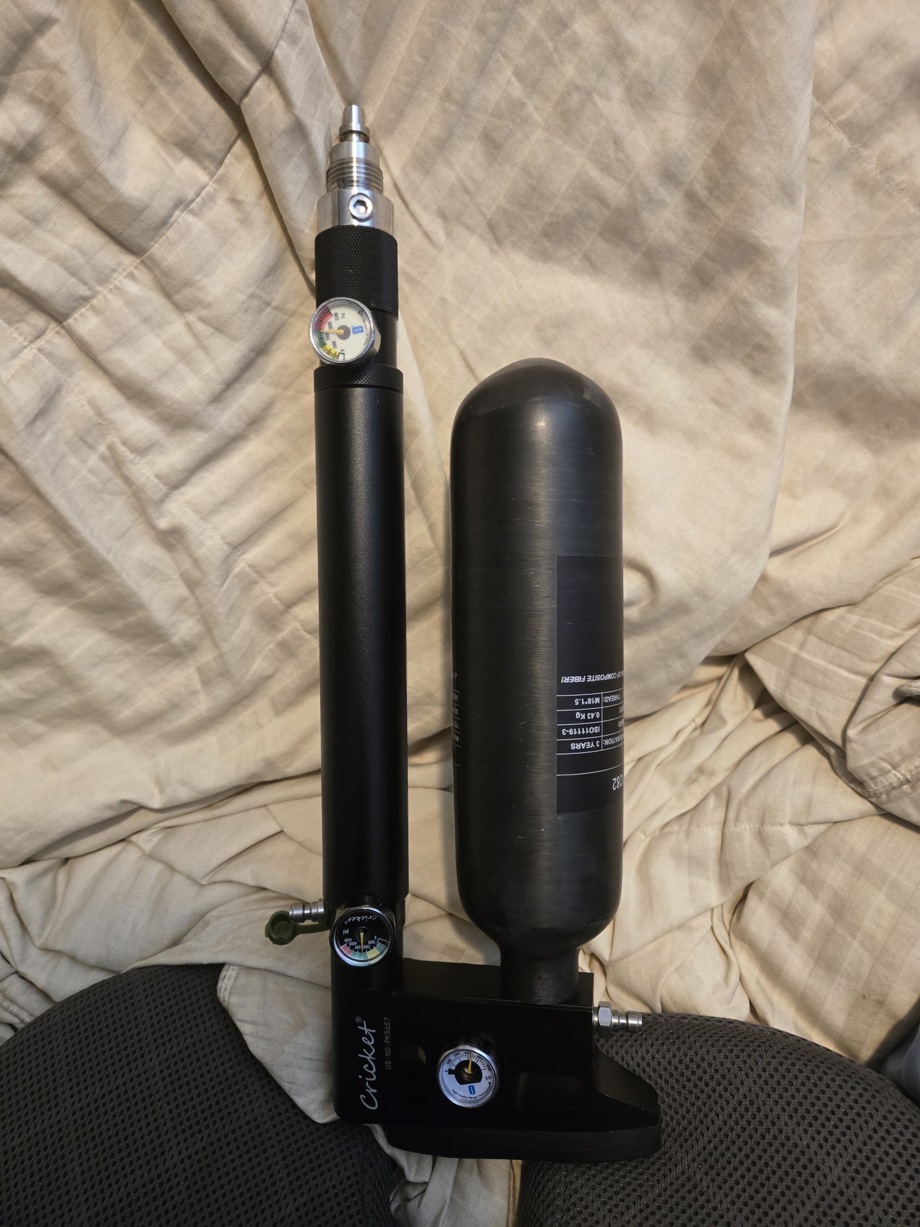

OPTION 2:
$211 for barrel
My spares: $300-$350 depends on bottle
High flow valve
U adapter
Cricket regulator
M18 extension
120cc 3000psi 20CM Tube (Plenum)
CF bottle (.48L to 1.1L)
With a 0.8L bottle
