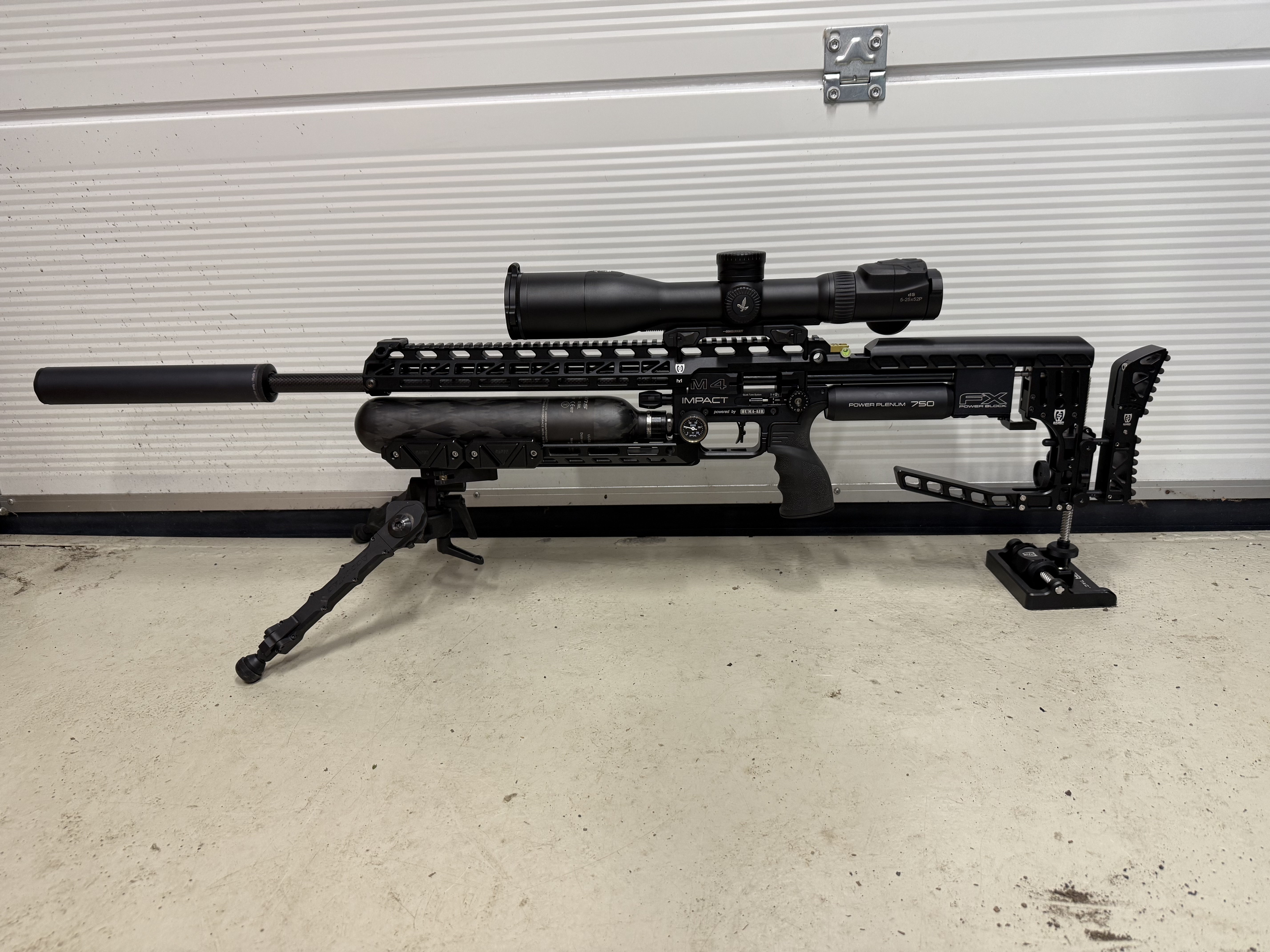

I use .217 40 grain in my m4 at a speed of 984 feet per second with sub moa results at 150 meter or 165 yards

I have tried .218 and .217 at different speeds but this is what the worked best for me, i have a 800mm tensioned barrel and tried more than 10 heavy liners in 1:16 and 1:18 twistrate.
The best for me was a 1:16 twistrate.
And yes 1-4 on micro settings makes a lot but turnig on hammer valve return spring makes also a lot.
