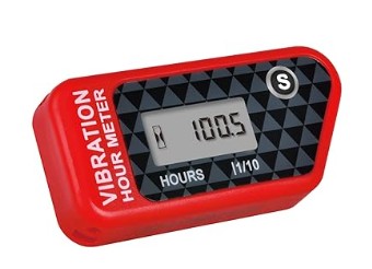

FYI for those of you that have purchased the Yooreal vibration sensing hour meter (pictured below) to track the runtime on your compressor.

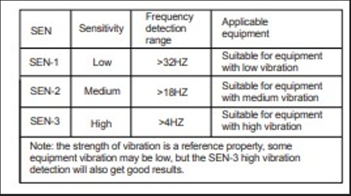

The operation instructions (also pictured below) are wrong and misleading at best. They have the sensitivity settings backwards... at least on mine it is wrong.
It states that level #1 setting is for low vibration output of the unit and #3 is for high vibration output. At least that's how I deciphered it. I ran my CS4E compressor to fill 4 or 5 guns and the hour meter didn't even resister .1 on the lcd screen. I set it #3 and it counted just fine.
So here's the deal...
If your compressor is running and the "H" on the hour meter is not blinking the unit is not counting the minutes/hours.
