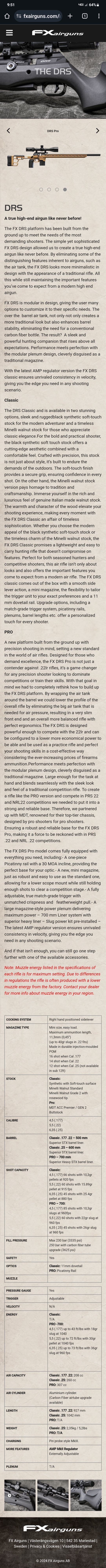

PS: FX site INFO, it is funny they can tell how many shots with ?? weight ammo, but they can not tell muzzle energy for the Classic.
you would assume they had a chrono on the rifle to tell how many good shots before fall of REG, so why not write in Muzzle energy in too.
Going with shot capacity specs listed in .177 specs 10.3 gr and 920 FPS that is just shy of 20 FP, that's not very much FAC if you ask me, but of course also just 10.3 gr pellet, and 920 FPS is in the range you would want to shoot 10 gr pellets i recon, so not complete BS.
Assuming it can push 13.4 gr pellet / slug and 960 FPS it is more in the range of my Maverick so 30 FP, and that is about where i would like to be, though i would still expect a headroom to be able to handle 16 and 20 grain too without going into glorified blowpipe speeds ( sub 800 FPS )
PPS: I would not like to have to install that big PRO plenum on a classic to be able to have a full blown FAC rifle,,,,,, by full blown i mean able to handle all weights in a given caliber, so in my case .177 20 grain as the heaviest ( well almost )

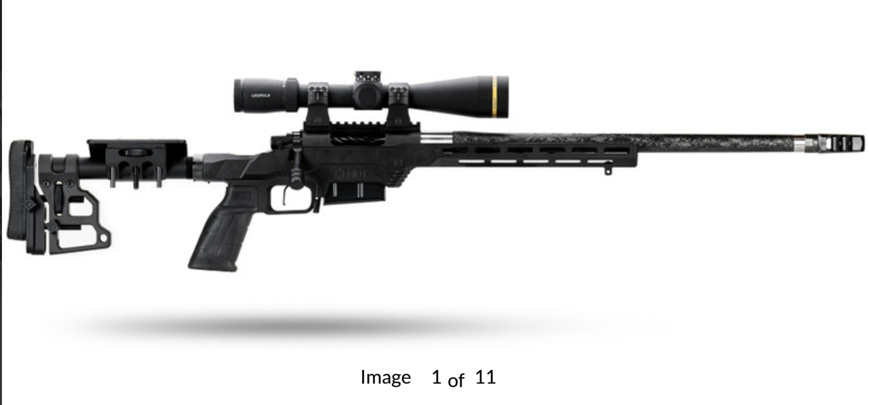

"Meaning will it be easy for other chassis builders to make their own versions of the MDT DRS chassis."
soooo willing to be wrong and way off base, but here goes:
the FX DRS Pro propaganda says the pro chassis is a MDT ACC Premier. that seems to indicate the chassis is "off the shelf." Heading over the the MDT site shows the ACC Premeier to be available for 9 different actions. MDT site also shows 9 colors for the chassis, including red! (y)
So yea, Id guess that FX is using either a modified action to fit the chassis, or an adapter. Either way seems to me that once we know what action the FX is emulating, then the other MDT chassis models (or maybe even a different chassis vendor) for that same action type "should" accept the FX mechanism......
