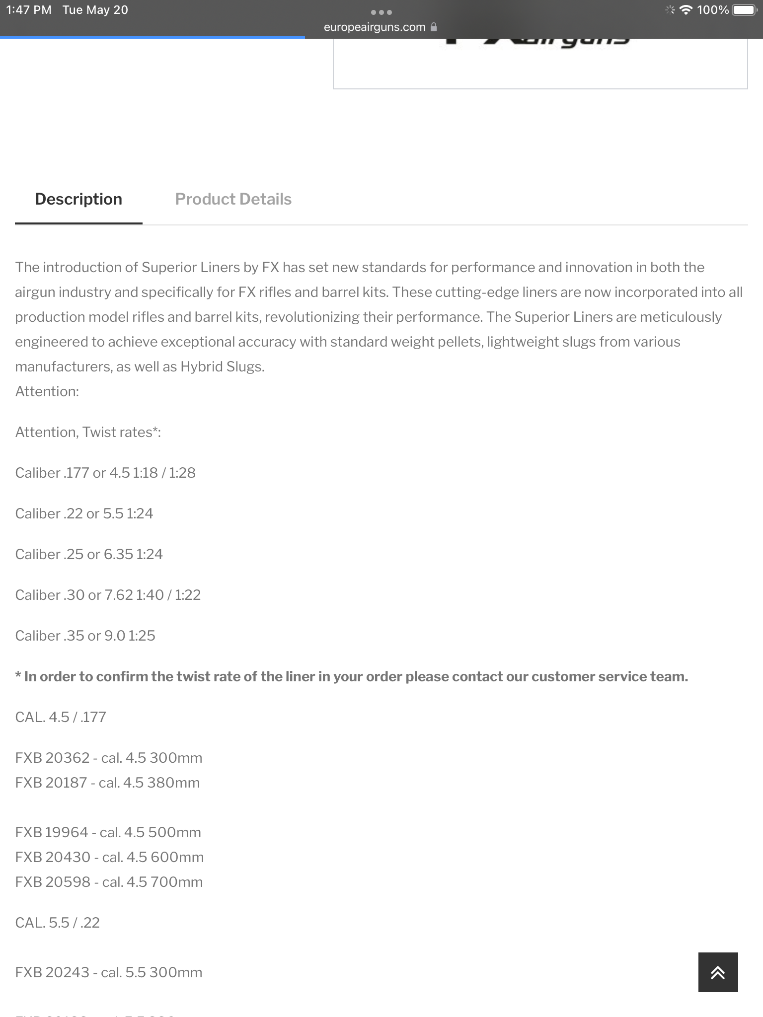

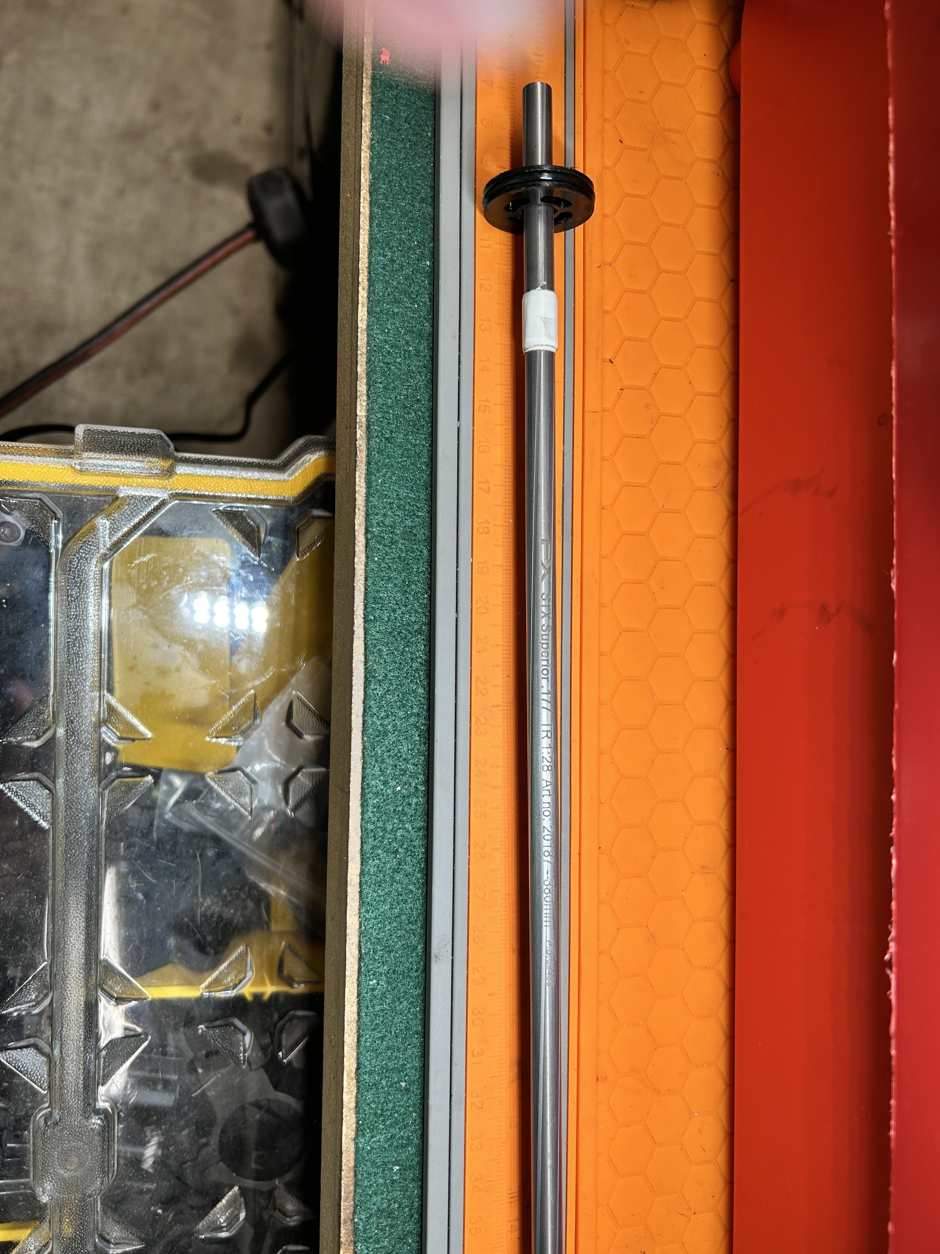

Just bought a new barrel kit for my Crown, a 380mm 177 pellet barrel, and the liner is marked 1:28 Superior?? I didn't know there was any 177 liner that is more than 1:18 twist??
FX seems to be making all kinds of liners and you never know what you're going to get. I'm not griping, as I do think long twist liners are the future of pellet shooting, and most manufacturers have not caught on yet. Almost every 177 barrel made is 1"17.7" or close to it, and while they shoot fine, it's when you stretch out the distance that you can see the long twist barrels take the lead. If you're only shooting 25-40 yards, anything will do.
