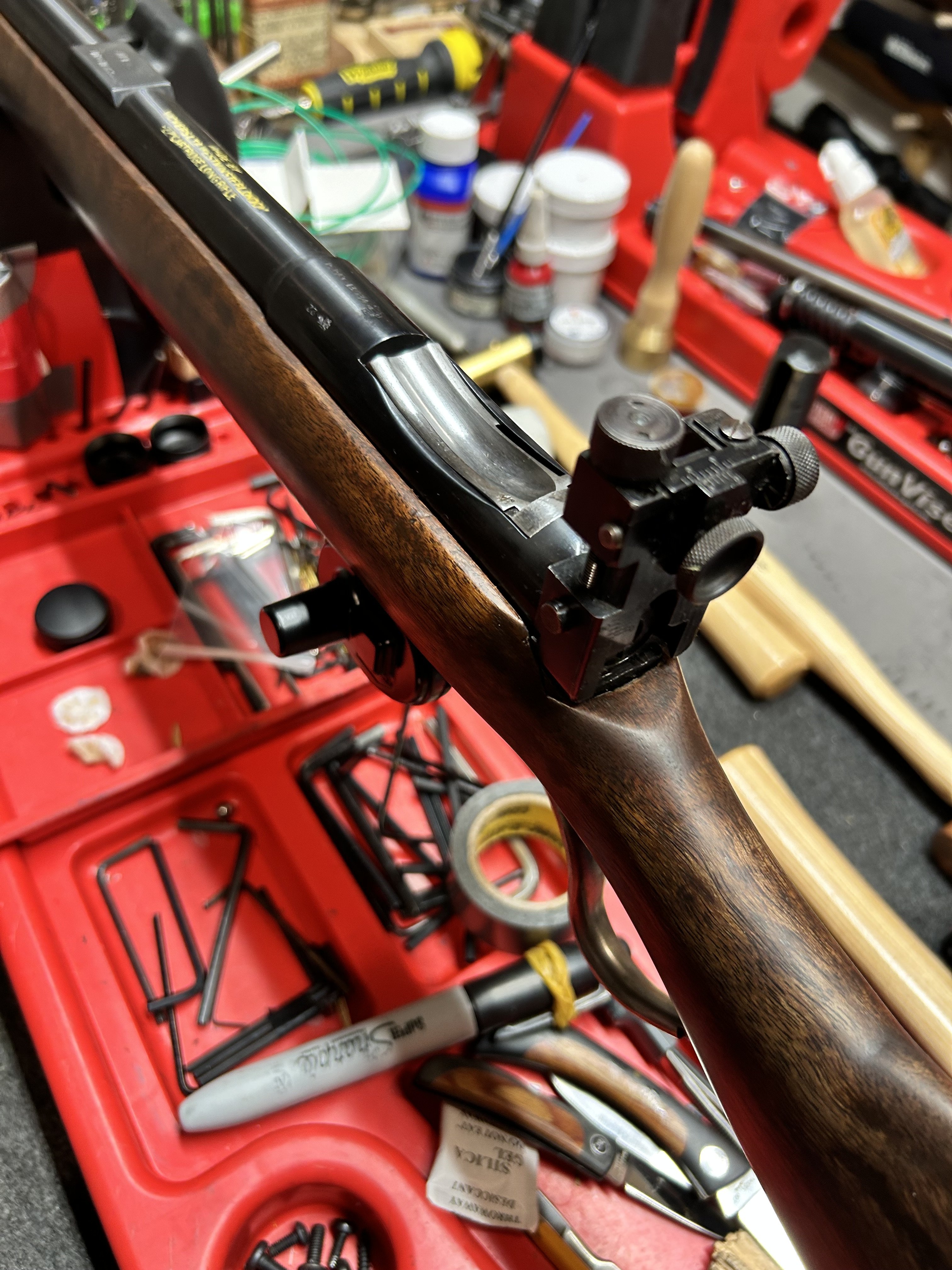

FWB Found a gem.

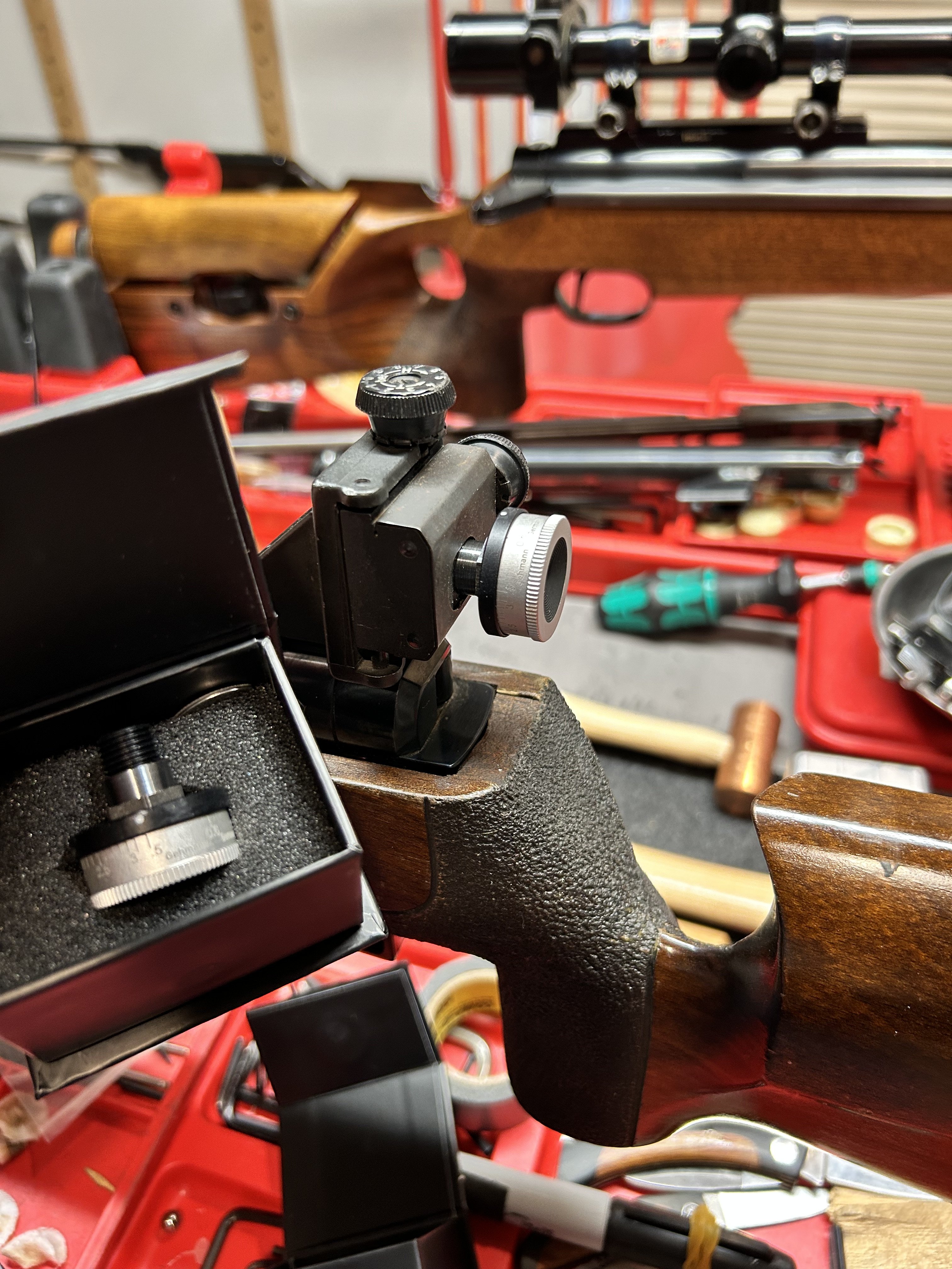

I may be misunderstanding, but the sight you're holding in the pic is a Weihrauch. It won't fit correctly on an FWB.
That’s correct I just switched the iris.
I bought last summer from someone in California. I remember when I got it and held it up and looked through it, it was blurry?
My 300s vision is perfect. I think Jeff suggested to switch the 2. If it rains today I will. Crow

One aperture is probably larger than the other.
You can open up the smaller of the 2 with an appropriate drill bit.

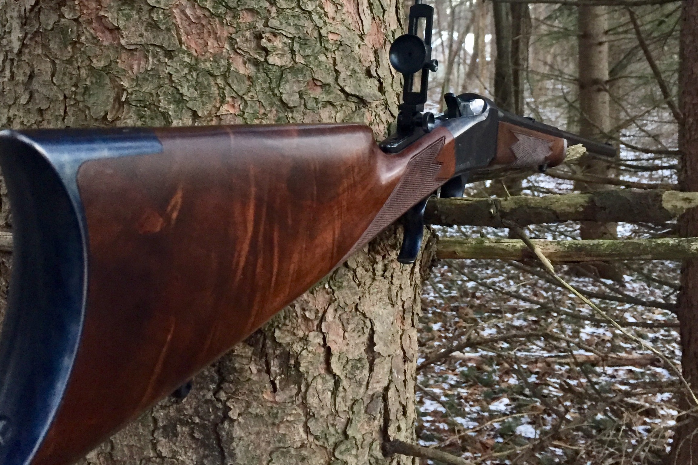

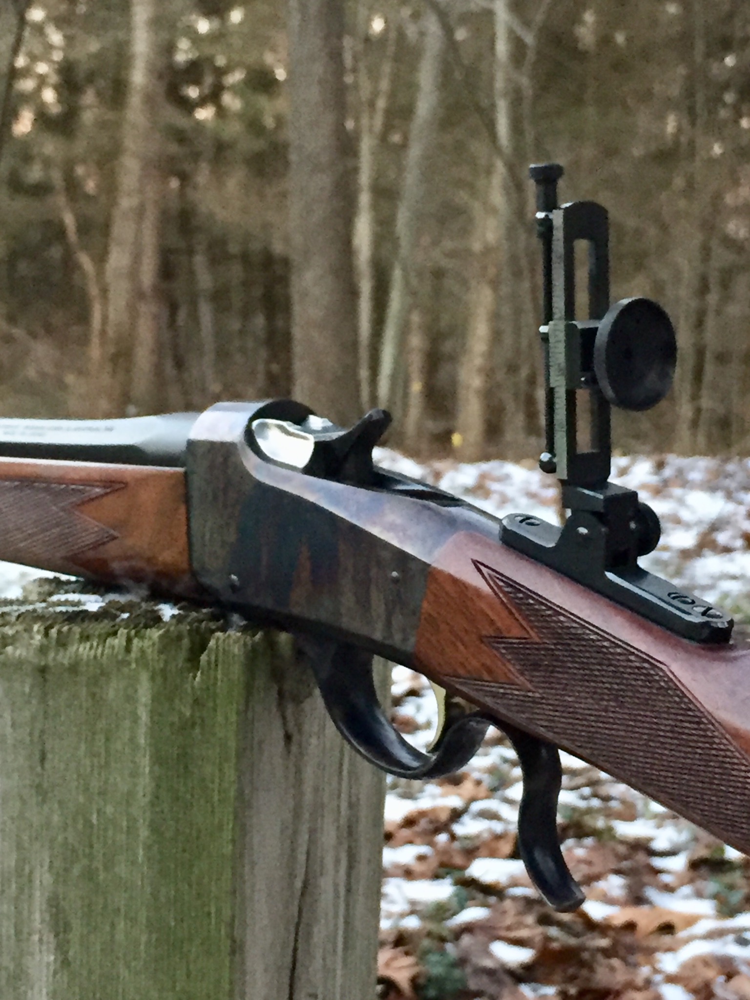

I use a lighter quite often to blacken a sight. Just hold it near the tip of the flame for a second or two. That soot lasts well in an iris. A blade front sight will have to be touched up now and then. I soot the irises on my vernier sights quite often. View attachment 559724
What's that rifle? My guess is a Browning/Winchester lo wall. I have one of the big Browning BPCR (black powder cartridge rifle) in 45-70. Big heavy gun 30 inch half octagon half round barrel, globe front sight and a Solue type rear tang sight basically a copy of the 1885 Winchester Hi Wall.
Reactions: Steve Milbocker
Good eye 😁 You have a dandy rifle as well! Sorry for sidetracking your thread Crow!
