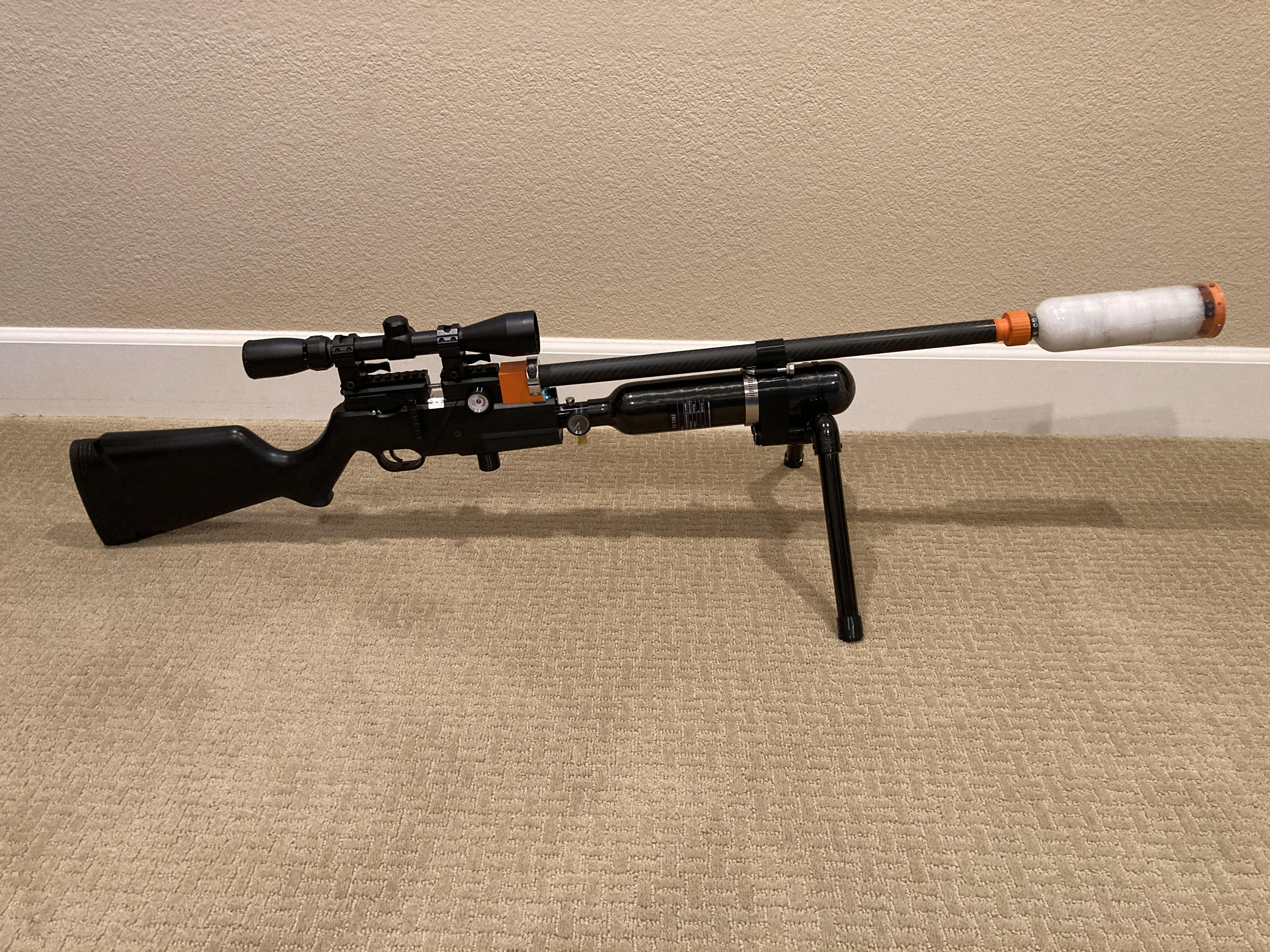

@whatsapcp One of the cool things about the Prod illustrated here is that it has awesome aftermarket support. You can modify the Prod over time to become what you want it to be, or leave it stock. @scopecreep... has gone with making the Prod a super short, lightweight gun. Here are my two Prods and I went a different direction.
Edit: The option for embedding a picture is greyed out at the moment, so here's a link to where I posted it elsewhere.
Thanks for sharing pics! I have been browsing all the different Prod build threads on AGN. Love the versatility.
