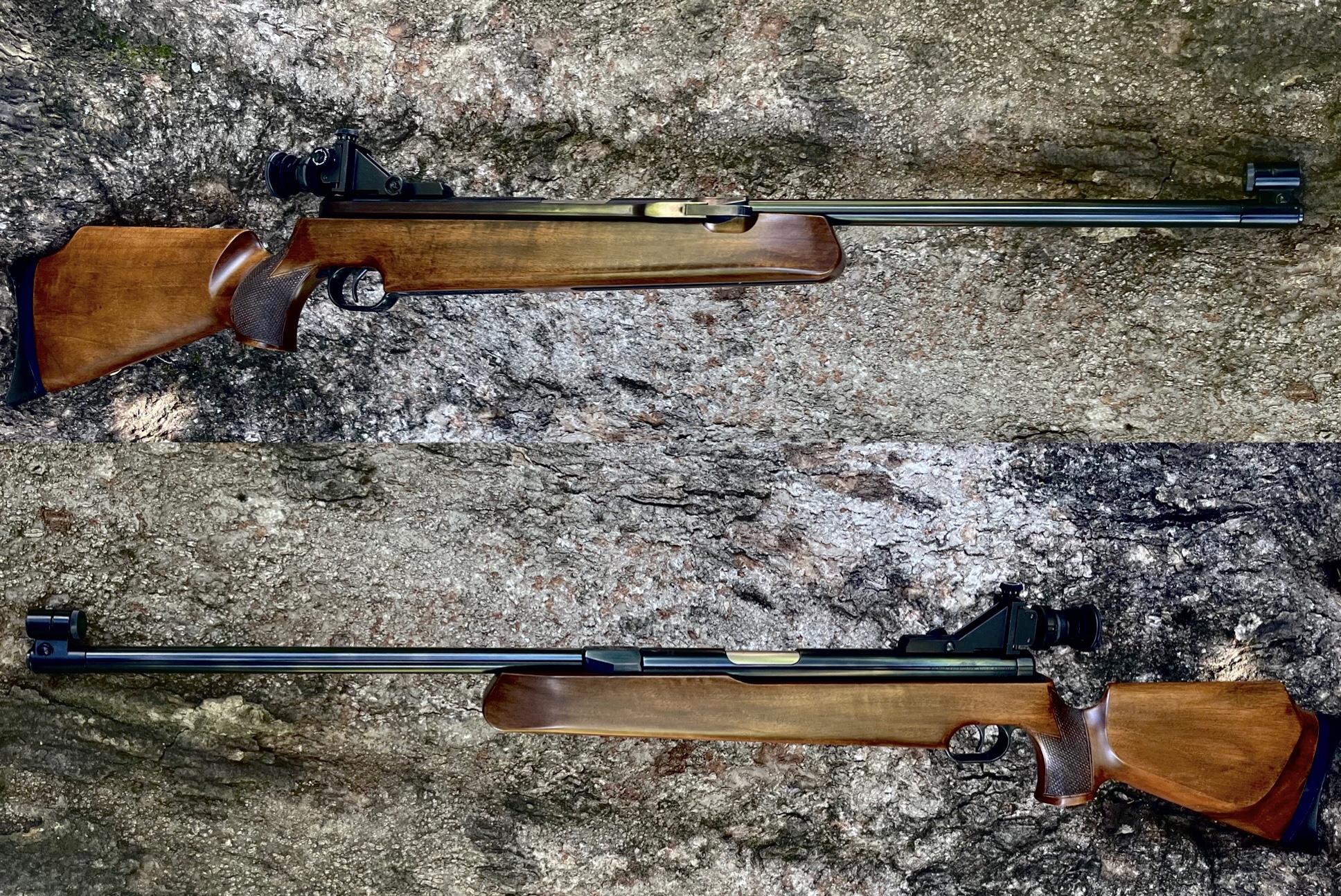

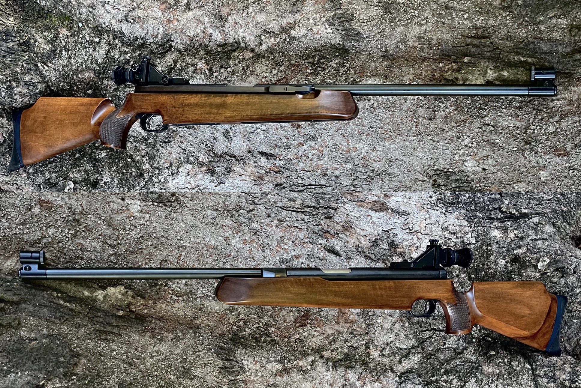

Just acquired this FWB 150. Looks nearly new. Serial number 35059 indicates it’s a 1968 model I believe. Having a traditional stock design makes it suited for either side shooters. And I shoot from the right side. I feel very blessed to have found this rifle in this condition. It Chrony’s in at 634fps using RWS Hobby 7.0 grain. Beautiful Walnut stock. Came with a bipod and adjustable Iris. The only thing it needs is a new breech seal. Does anyone here know where I can get one? Thank you.
Just acquired this FWB 150. Looks nearly new. Serial number 35059 indicates it’s a 1968 model I believe. Having a traditional stock design makes it suited for either side shooters. And I shoot from the right side. I feel very blessed to have found this rifle in this condition. It Chrony’s in at 634fps using RWS Hobby 7.0 grain. Beautiful Walnut stock. Came with a bipod and adjustable Iris. The only thing it needs is a new breech seal. Does anyone here know where I can get one? Thank you.View attachment 576421

??? Arh it seems there all variations
Funny it seems its a set ..lol
Reactions: Bear-of-Grayling

I think the old fwb seals materials/ formula to make them used back then were easy to degrade . So that kinda adds up to get a set .. maybe .. i guess ..lol
Example

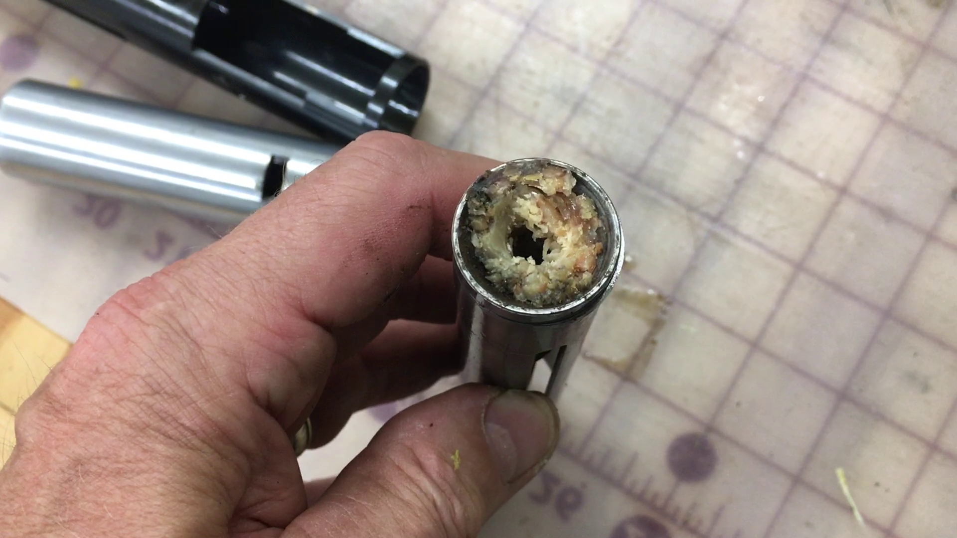

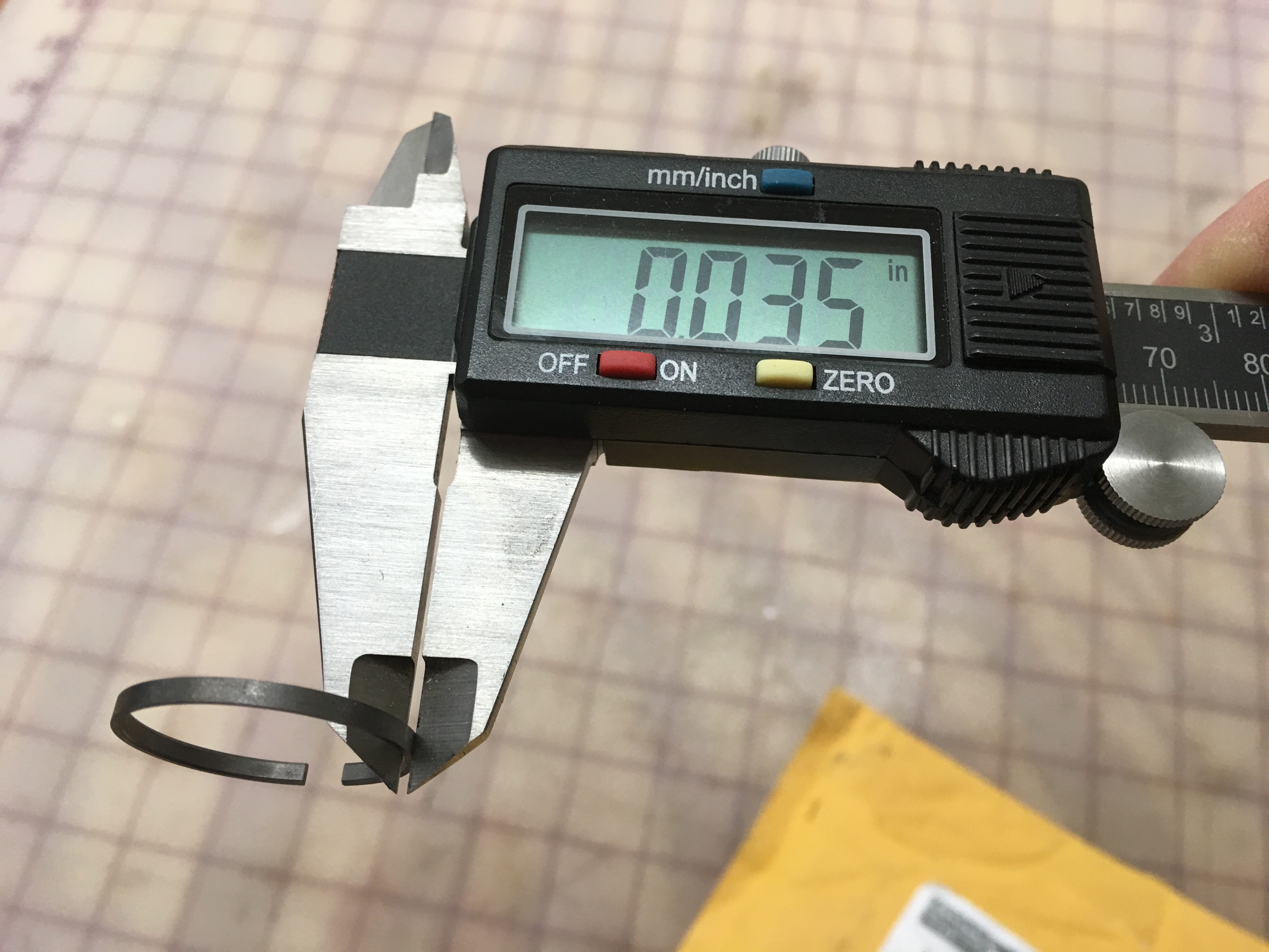

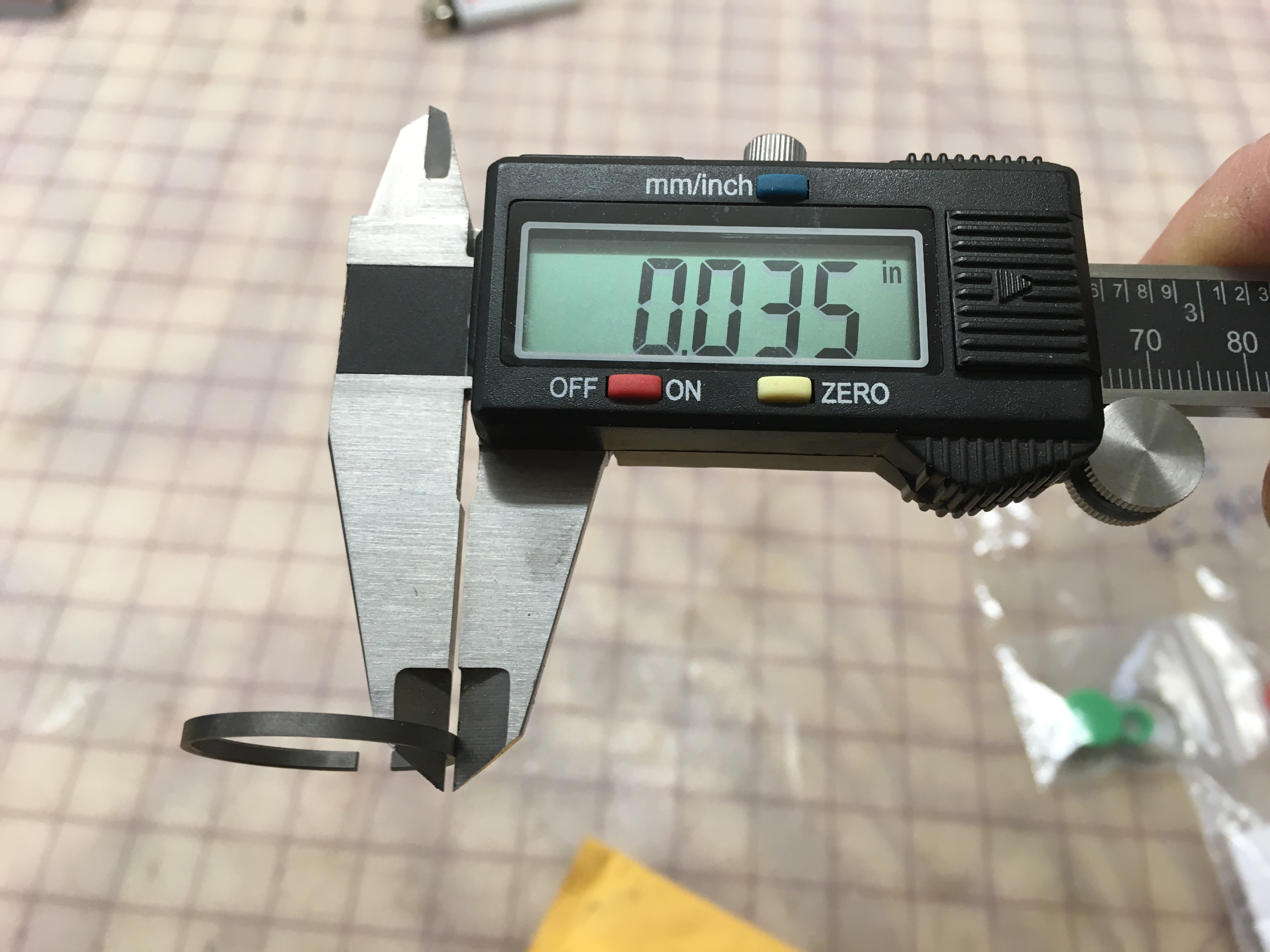

Nice looking example! They are great guns and built to last. The buffer is definitely a weak point, but you shouldn't have to replace the piston ring. Here's comparison pics of a new one and one out of an old work horse club gun FWB300s. No visible or measurable wear. The buffer had crumbled on the same gun.
View attachment 576501View attachment 576502

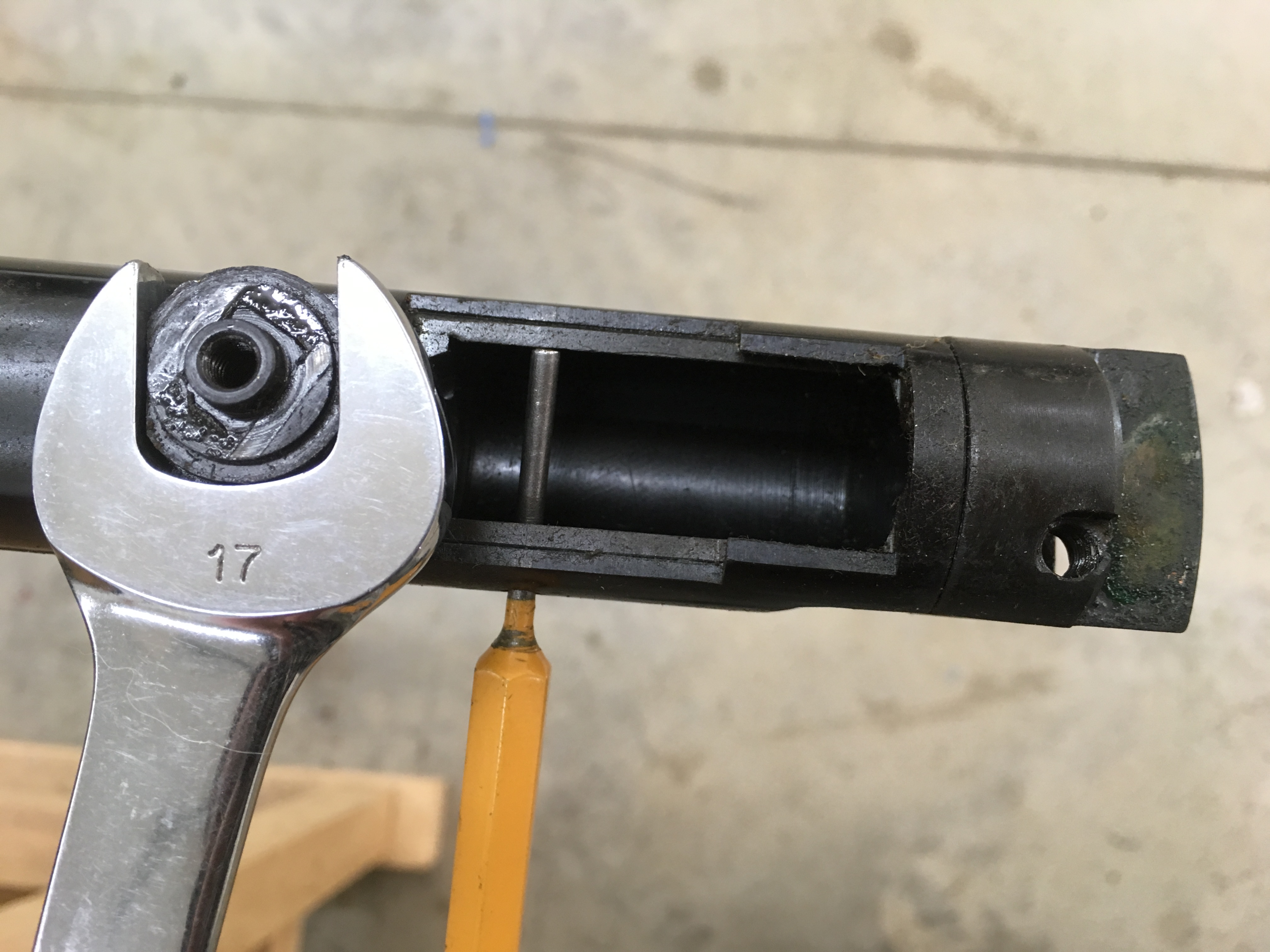

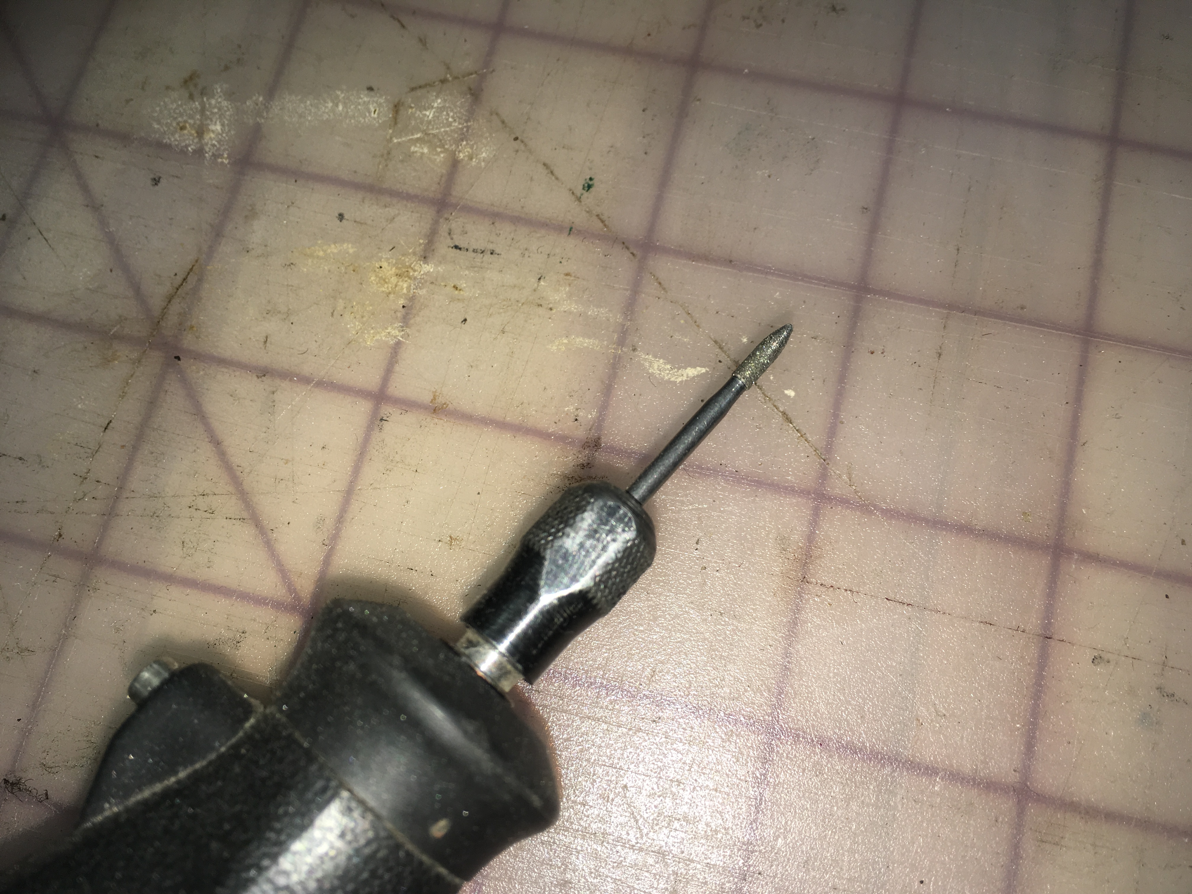

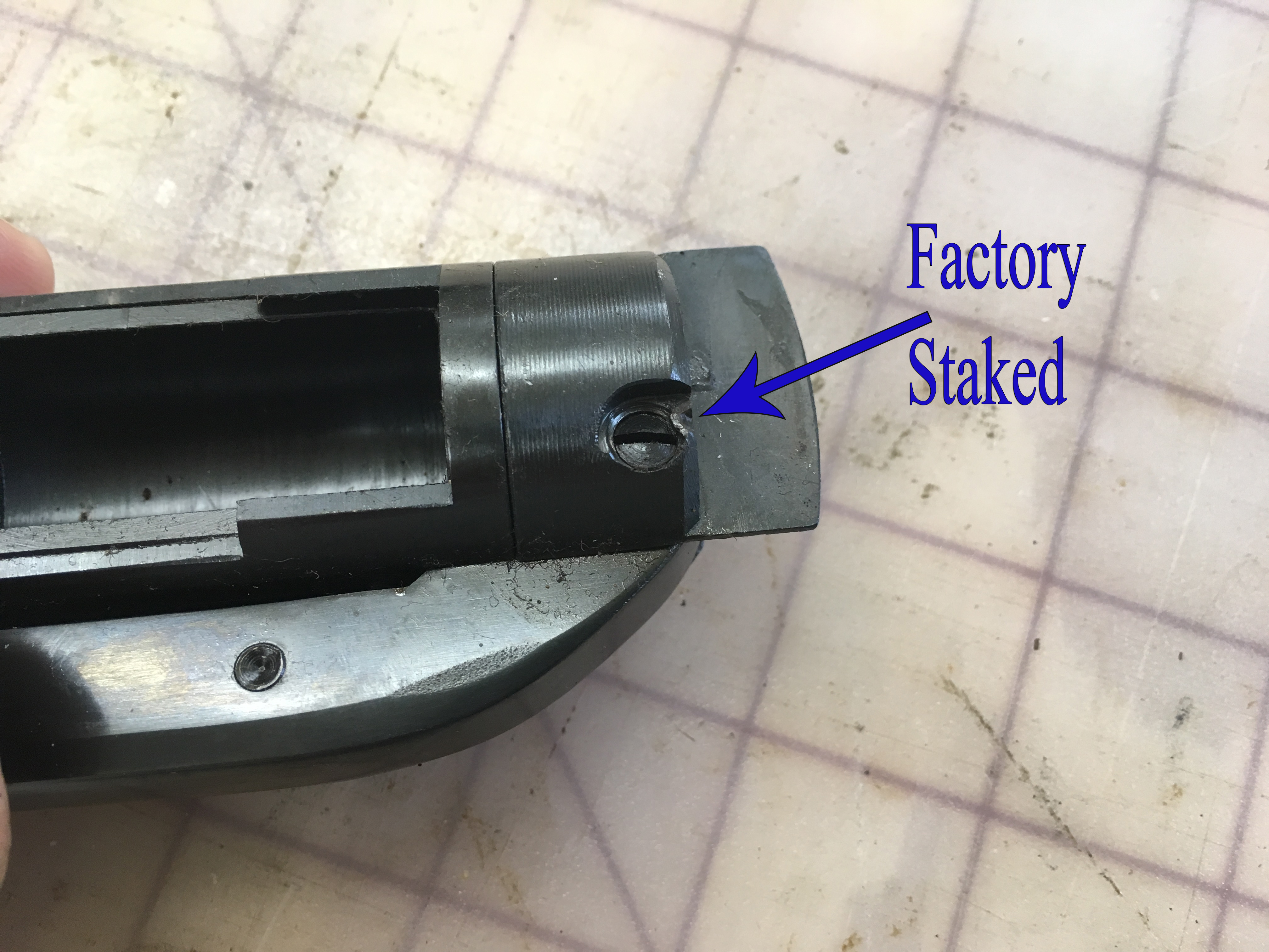

One tip, is to use a punch or screw driver to hold the end cap while removing the stud (see pic below). Makes things easier, if you're not using a spring compressor, especially during reassembly. Also, to watch for, is that I had at least one with a staked cocking lever bolt, which was kind of a pain. Had to get a sharp Dremel bit in there to remove a little metal before it would unscrew. I believe it was done at the factory, so hopefully yours isn't staked.
