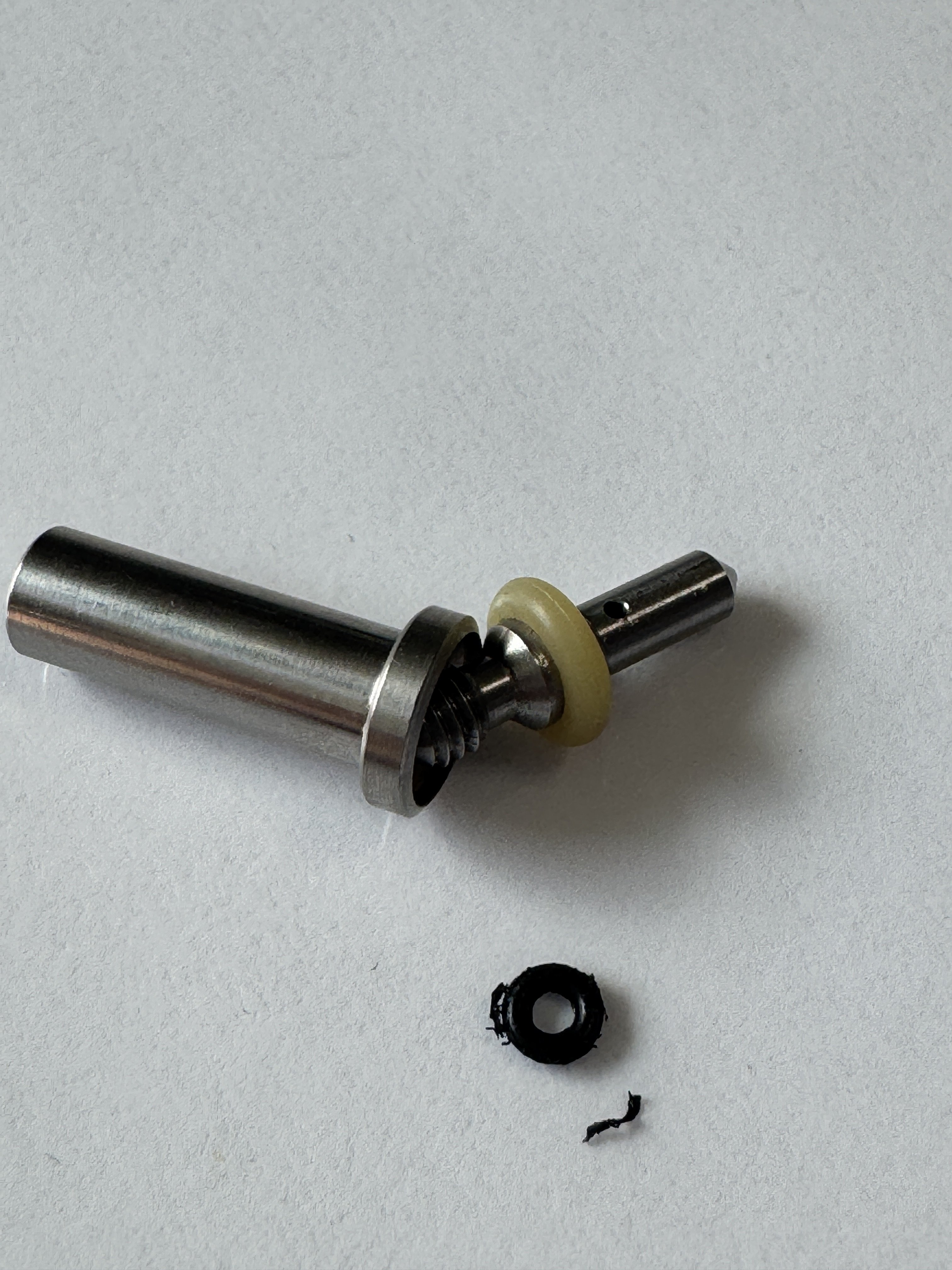

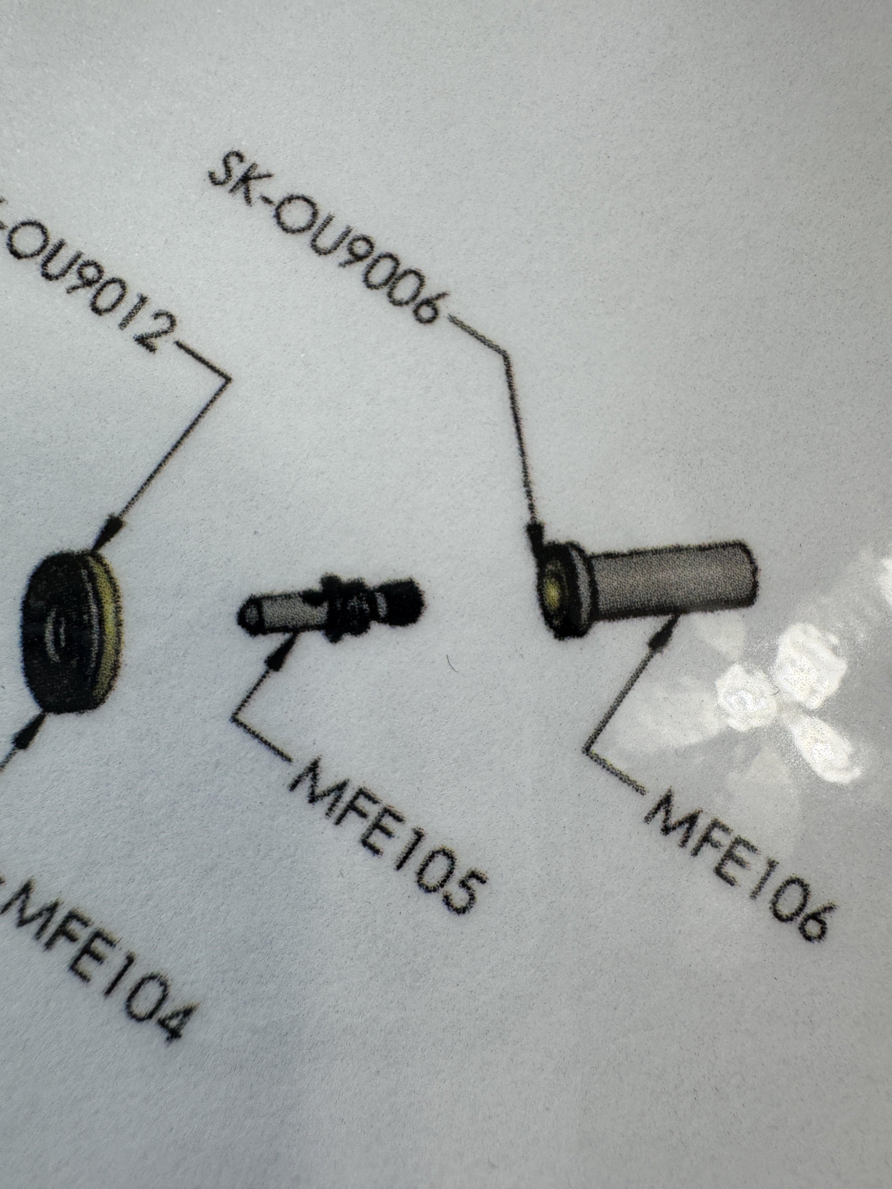

so my next thing is, I discovered a problem but it does have a fix, and it should be an easy fix as well. So I don’t know if any of you have had problems with airing up your gun in the air bleeding out spontaneously sometimes.
I’ve had that problem on both of my guns.
On my Evo, I replaced some of the O-rings in it mostly fixed the problem, but the Epoch I just got does it really bad ( my evo did it to at first )

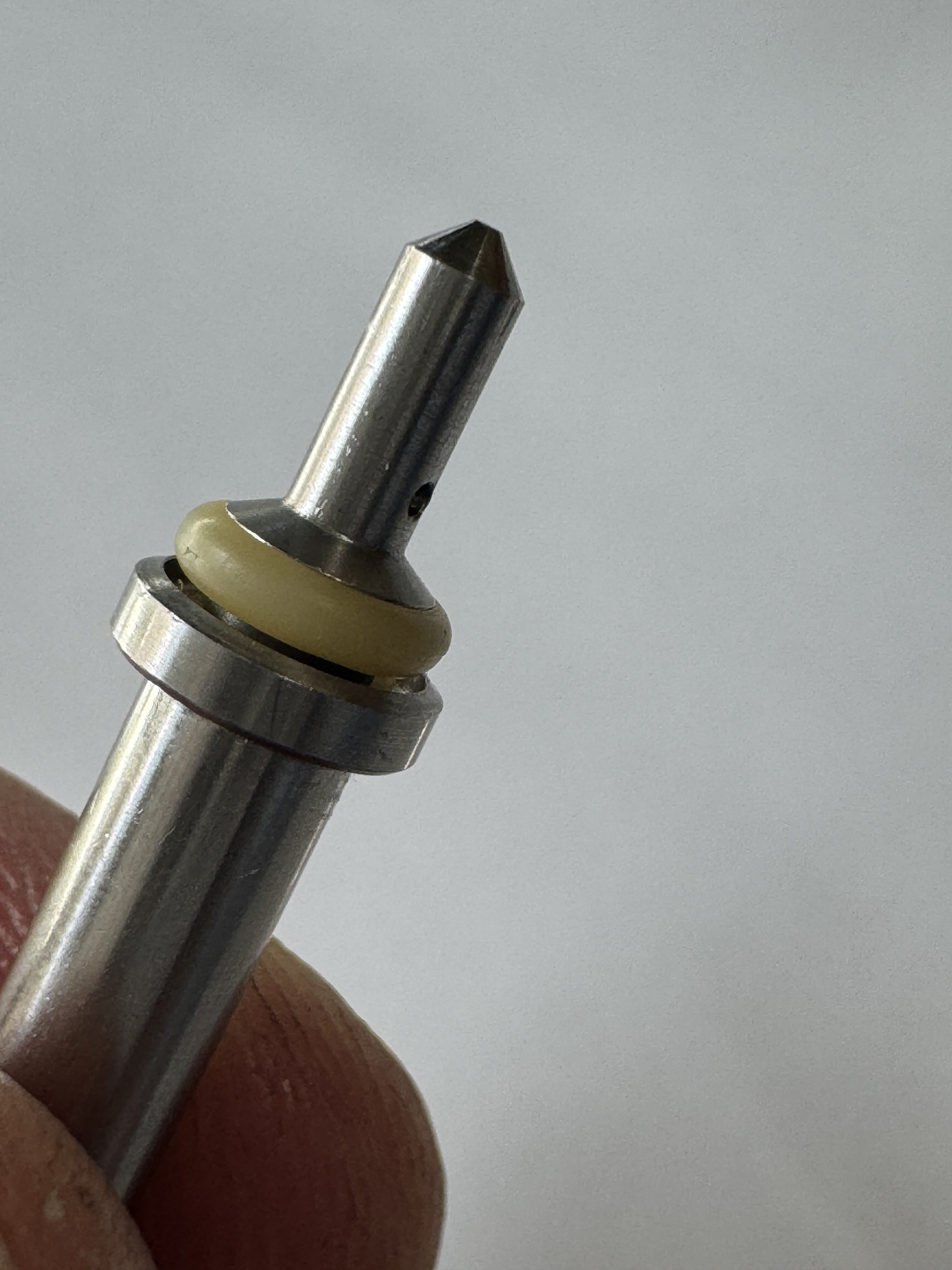

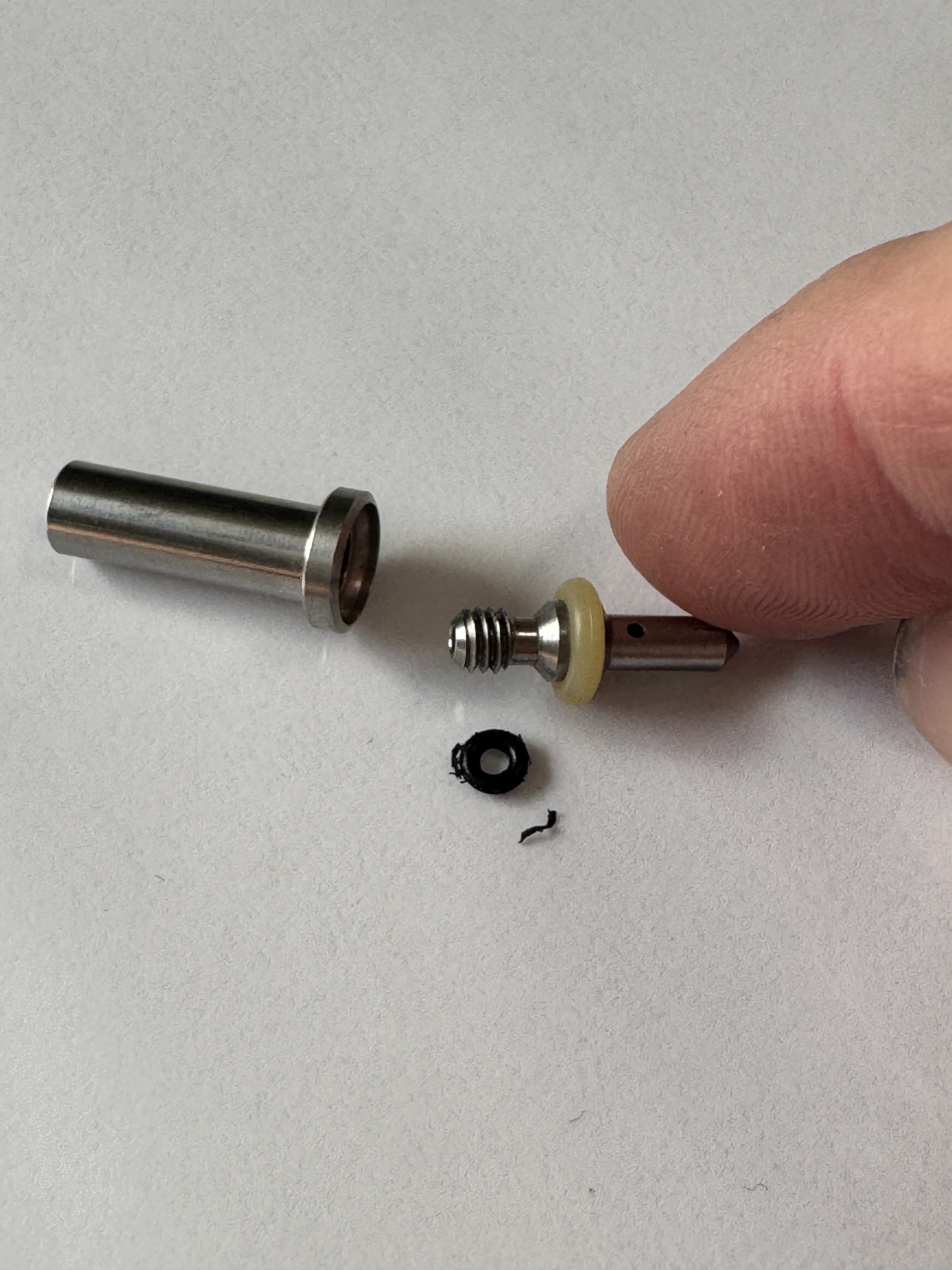

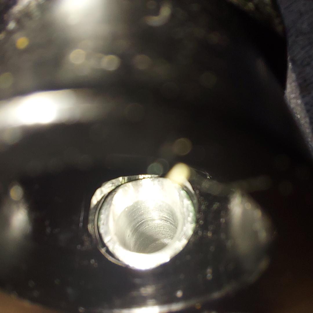

So here’s what I found happens the regulator needle on the high-pressure valve has a small O-ring that seats when it’s closed. Unbeknownst to me, there is a hidden O-ring that’s not listed on the list of O-rings. That hidden O-ring is actually for sealing the two sections of the needle valve.
Will this extremely small O-ring is a soft rubber and it leaks and when it leaks, it pushes the clear O-ring up on the needle valve, causing that O-ring to deform and not seat.
I’m going to call Scout and see if they know what size O-ring it is.
It’s extremely extremely small but that O-ring definitely needs to be a harder material.
Your kit of spare parts comes with a replacement needle valve, and I took that one apart just to look at that O-ring and even the new one it’s showing signs of damage because it’s a soft rubber.
Here’s the pictures
Hope this makes sense to everybody, but once I find the exact size of this O-ring, I’ll report back and probably find an Amazon link to order it in at least a 70 hardness. A 90 would be too hard because it has to fit over the threads.
I found this out after my gun wouldn’t take a fill beyond 1000 psi and the clear O-ring was halfway pushed out causing the gun to not seal.
Here’s the pictures
how did you separate the 2 pieces?

So, just to be certain of the part that the "extremely small" O-Ring is seated....
It appears that it would fit at the area between the threads and the conical section of part #MFE105. Correct?
Thanks for the heads up!
mike
Yes !
because that little ring isn’t doing his job, it leaks, causing air to push the large clear one off its seat and deforms it so it can’t seat properly. The reason the leaking stops when you take a shot is because it lowers that chamber pressure just enough that Air can’t push past that O ring
Reactions: kwaping
This seems like a pretty major discovery.
I think so! This could also be the cause of small leaks that people can’t find. And this is probably the cause of leaks when the gun is left pressured up to.
yes the old softer O rings were also a cause but in the newer regulators they have all been swapped out to a 90 durometer which fixed most of them.
