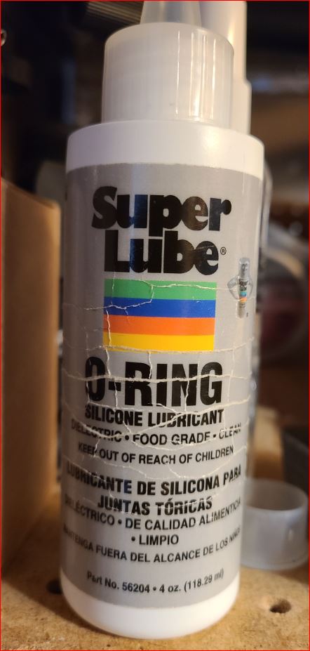

I am using this gel for years to lube my orings, over summer hot day it works flawless. But in winter cold = Canadian subzero in Celsius, I think it is thickening. And as we know the Valve (white teflon bell thingy) is moving on an oring, also the REPR Reg (gold anodized) piston.
Any oil worth to try that is thinner and feels more like running?

Molykote 55g?

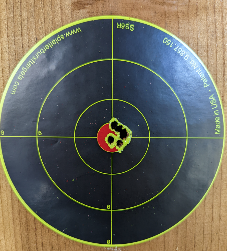

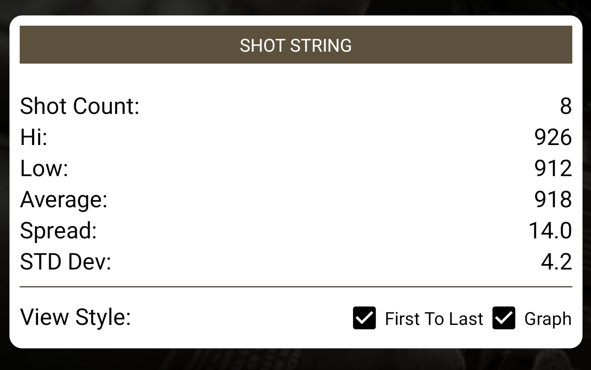

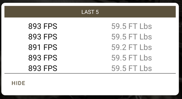

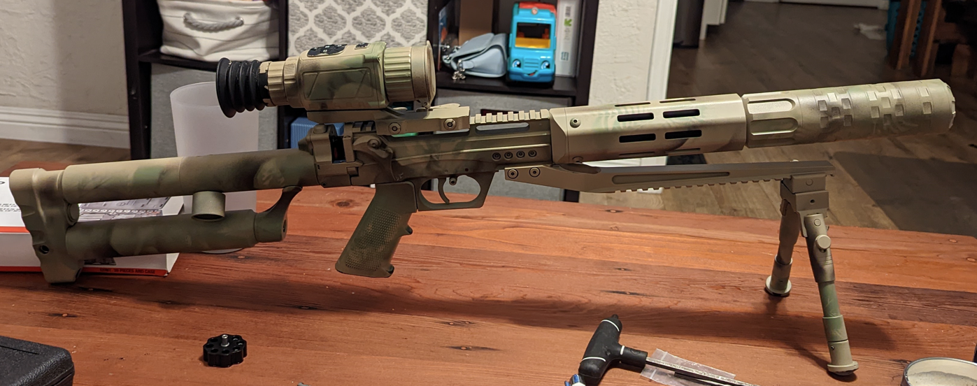

My version of the Leshiy 2 is .25 350mm running the Huma-Air Raptor, 0.3 x 2 jets, alpha barrel and reflex behemoth. It is set at 200Bar and measuring ~890fps using NSA 33.6 slugs. Sighted in at 25yds and grouping are within 1in. JSB 25.39 are not as stable.
Before I switched to the raptor I had the LW barrel, OEM jets (0.4x2) and OEM regulator set to 220. I was measuring about 920fps but regulator was not as consistent as Huma-Air Raptor. Groupings where still pretty good about 1.5in but not tight enough.
Current set up gets me 8 rounds before refilling. I dont plink everyday only time I use this setup is when a critter bothers my chickens at night. So 8 shots is more than enough for me. with the OEM 0.4 jets I was getting 10 shots.
With OEM Silencer it was really loud with a sharp piecing sound. It is still loud but more like a loud thump. Framing nailer??
Current Set up

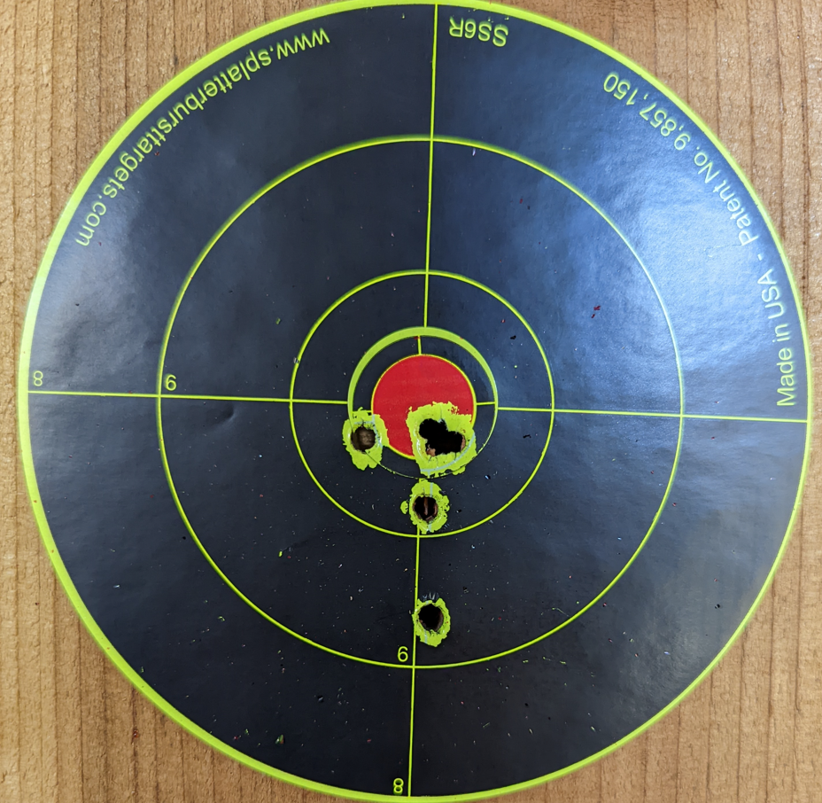

Current setup Huma-Air Raptor NSA .25 33.6g at 25yds
Current setup Huma-Air Raptor Chrono
Current setup JSB 25.39g at 25yds with Huma-Air Raptor
OEM Regulator at 220Bar NSA 0.25 33.6g
