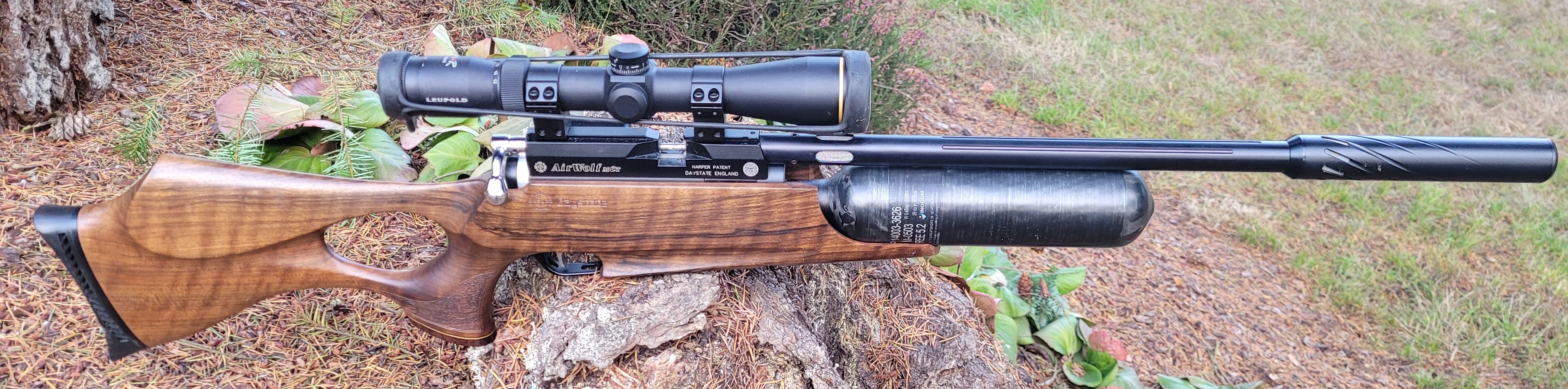

Just a current long term note on my 2011 Air Wolf, for anyone considering buying a pre-owned rifle . . . get it. Everything that has been written about this gun's accuracy, trigger, Hugget Snipe/shroud, quietness, dependability and quality/beauty (except for the single anomaly post that discussed poor accuracy) is true! I am the third owner of this rifle, with the original sales slip from AoA and plan to pass it down to my children/grandchildren. It is a classic/legacy quality rifle and a pleasure to shoot. I was so impressed with it, I added a pre-owned Huntsman Regal .20 from a similar vintage. Purchased it from a member here on the forum. It is a stunning rifle in its own right, and takes no back seat to the Air Wolf. I fill to 230 BAR on the bottle and 210 on the Regal.
