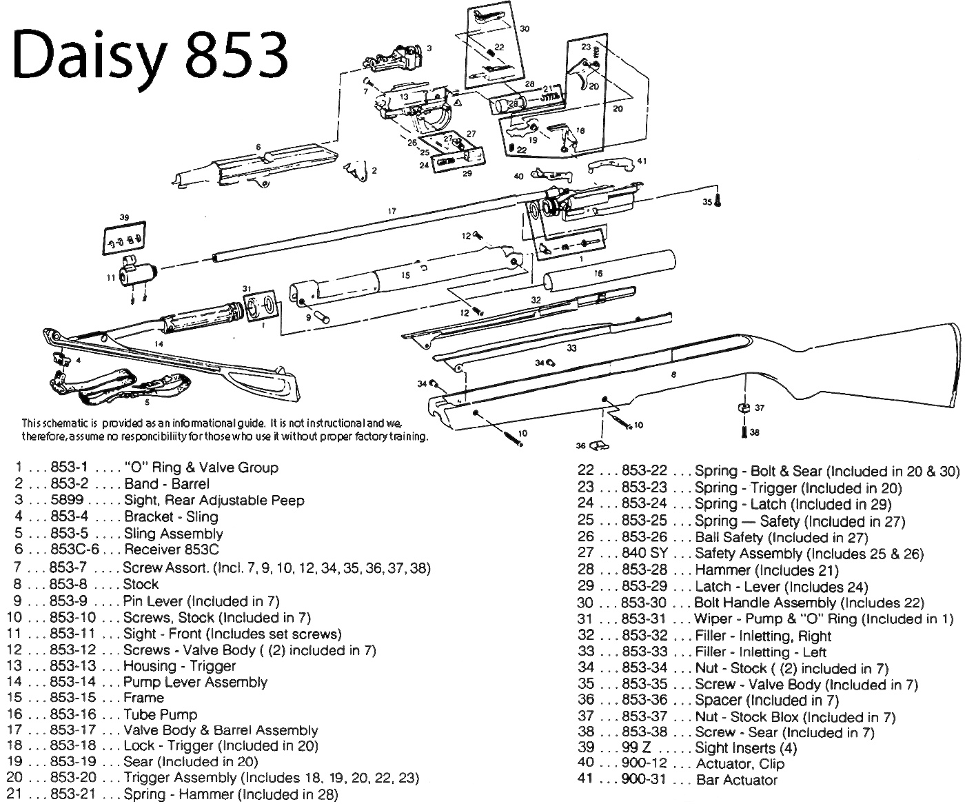

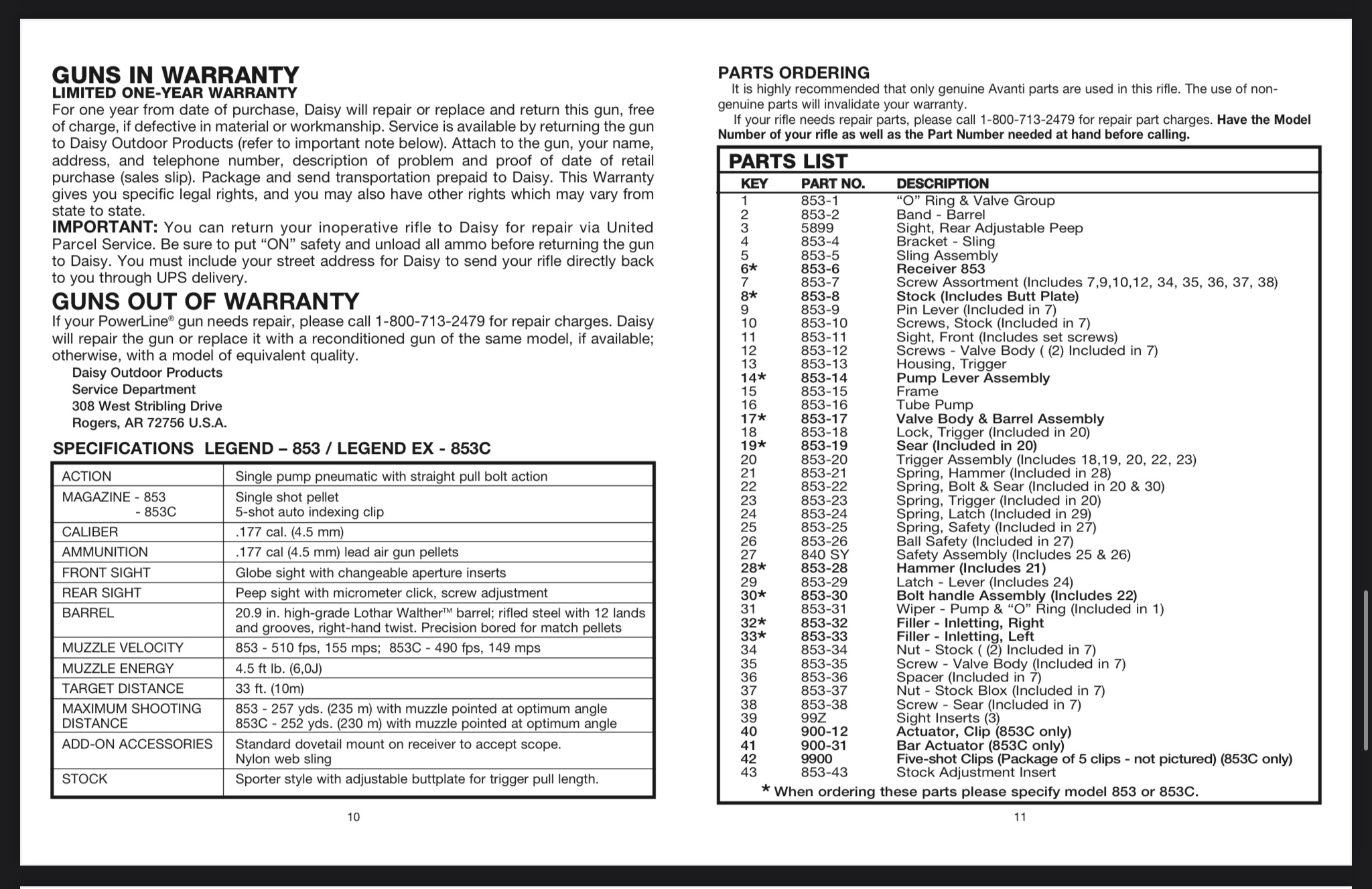

i did get a trigger assembly kit 853-20 but not a sear by itself
i know you stated the sear makes i difference, but those parts sit on top of the clam shells and not near the sear and i have assumed the cocking handle is doing the work
now the model 900 has the mag advancer and the sear for that is a 900-29 and on the parts diagram, it shows the spring and that spring is the same as the sear spring on that model and the bolt 900-10
i will try to get it to work without opening up the shells but at this point i have no idea if the parts will work at all
why the hell they were not used in the first place is a head scratcher
the parts diagram numbers are worthless to a point
now, in this video at the 1:40 mark he just reaches down and lifts the 2 parts off the top and pulls the spring off
we will see
When the cocking handle is released after cocking it falls forward until the hammer engages the sear. When it does it moves the actuator back to align the clip (pellet) to the barrel chamber. The 853/753 sear allows the actuator to go to far back and misaligns the clip.

do you have the real part number for the C sear and the non C sear
i do see the asterisk on the sear well as i said mine is a C model and i now see that the C model have less FPS and that could be the sear doing that
I do not have the part number for the 853c sear. My 853c fires stronger than both my 753 models. The tiny extra strike on the valve could boost velocity. Also, the faster fps on my 853c could be the bolt going through the rubber clip that are up against the breech. Less blow back loss. The 753/853/953 bolts do not have a seal. But that’s only a hunch. Maybe I just have an unusual one. Good luck with the upgrade.

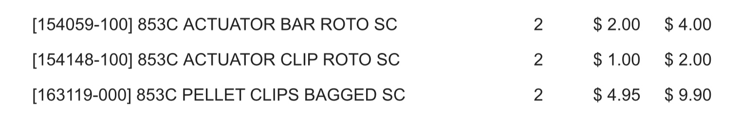

so, after getting all the parts now the mag is moved as any C model would
you need
169746-K00 C bolt kit
154059-100 actuator bar 853c
154148-100acuator clip 853c
136525-000 853 spring

so why the hell did Daisy make my model and leave out 3 parts so it was a manual feed mag that is very hard to believe 2 bucks worth of parts
i guess it will be back to Daisy for more parts
parts cheap shipping not cheap

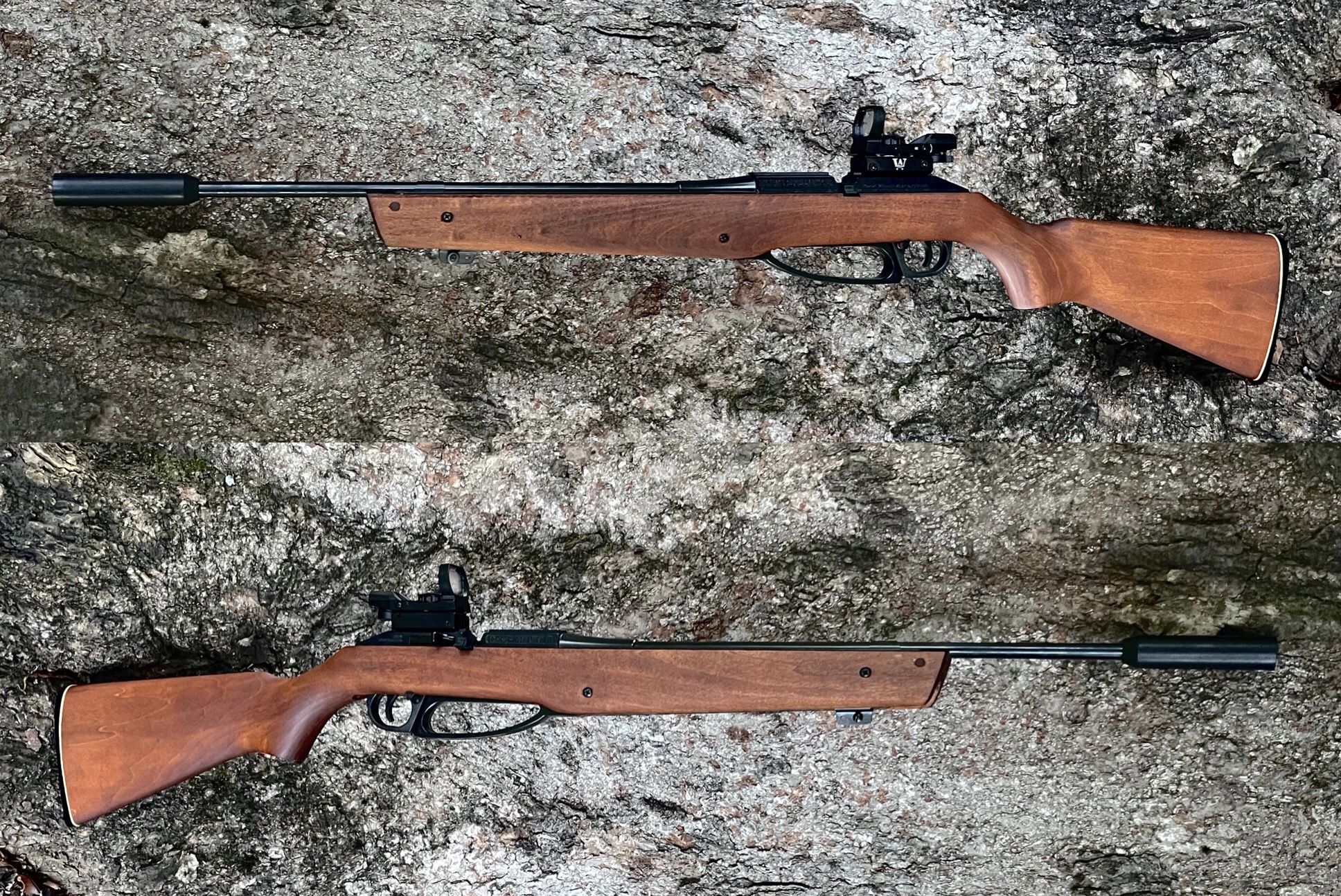

I found this one at my local gun shop in unusable shape. (853C)
I'm about 40 miles South of the Canadian Border.
Got the parts to reseal, refinished the stock, (that sticker came on the stock and I managed to save it!)
cleaned the rust off the front sight and repainted it.
Bought a new rear sight as it did not have one. Did try a scope on it for a bit.
This one auto feeds the magazine. I bought the 5mags off ebay and they came with a SST.
Took a lot of studying to bring it back.
LW barrels are amazing!
turned out well i find these easy to work on, oh they have their moments
