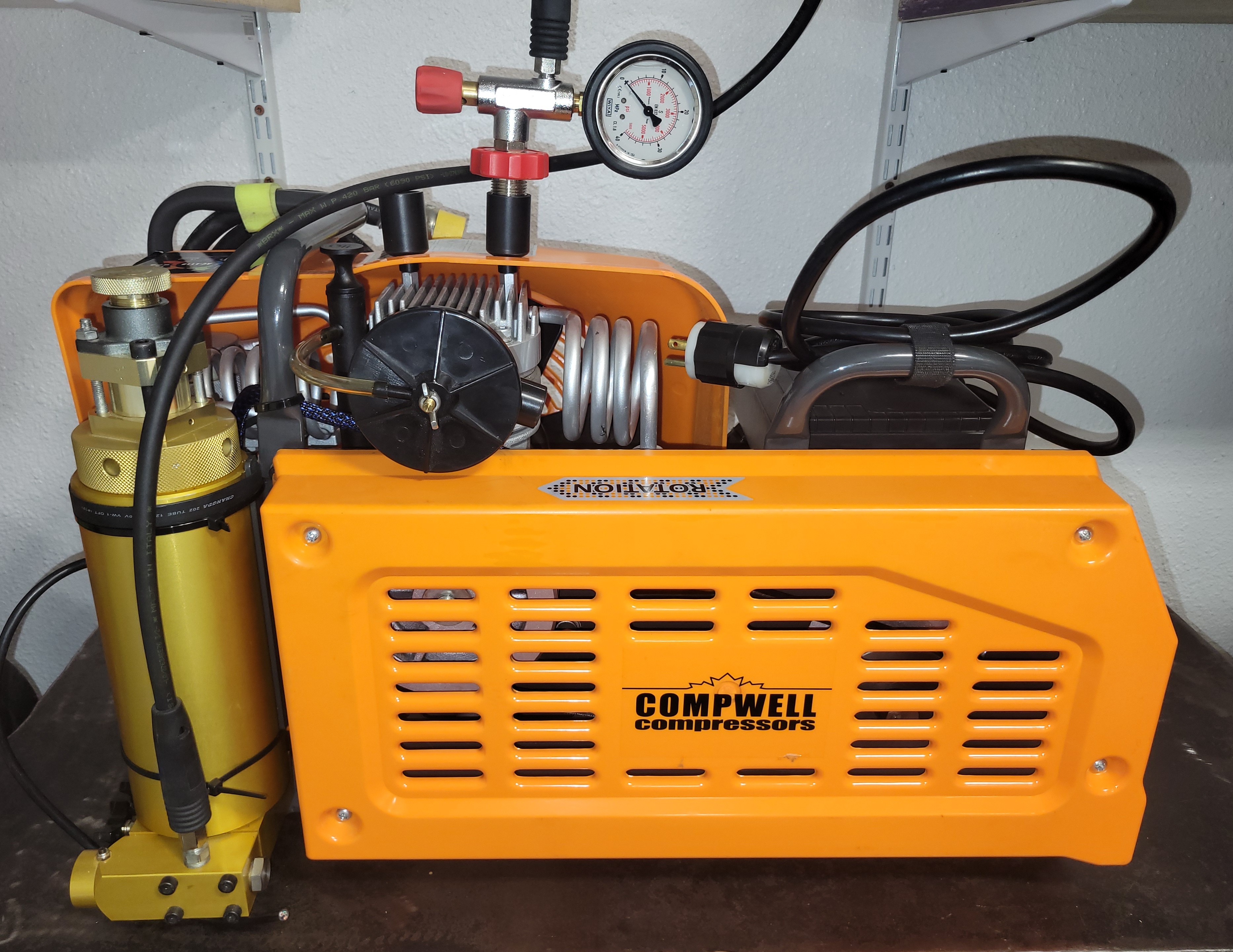

Will post some pics soon of my compressor.

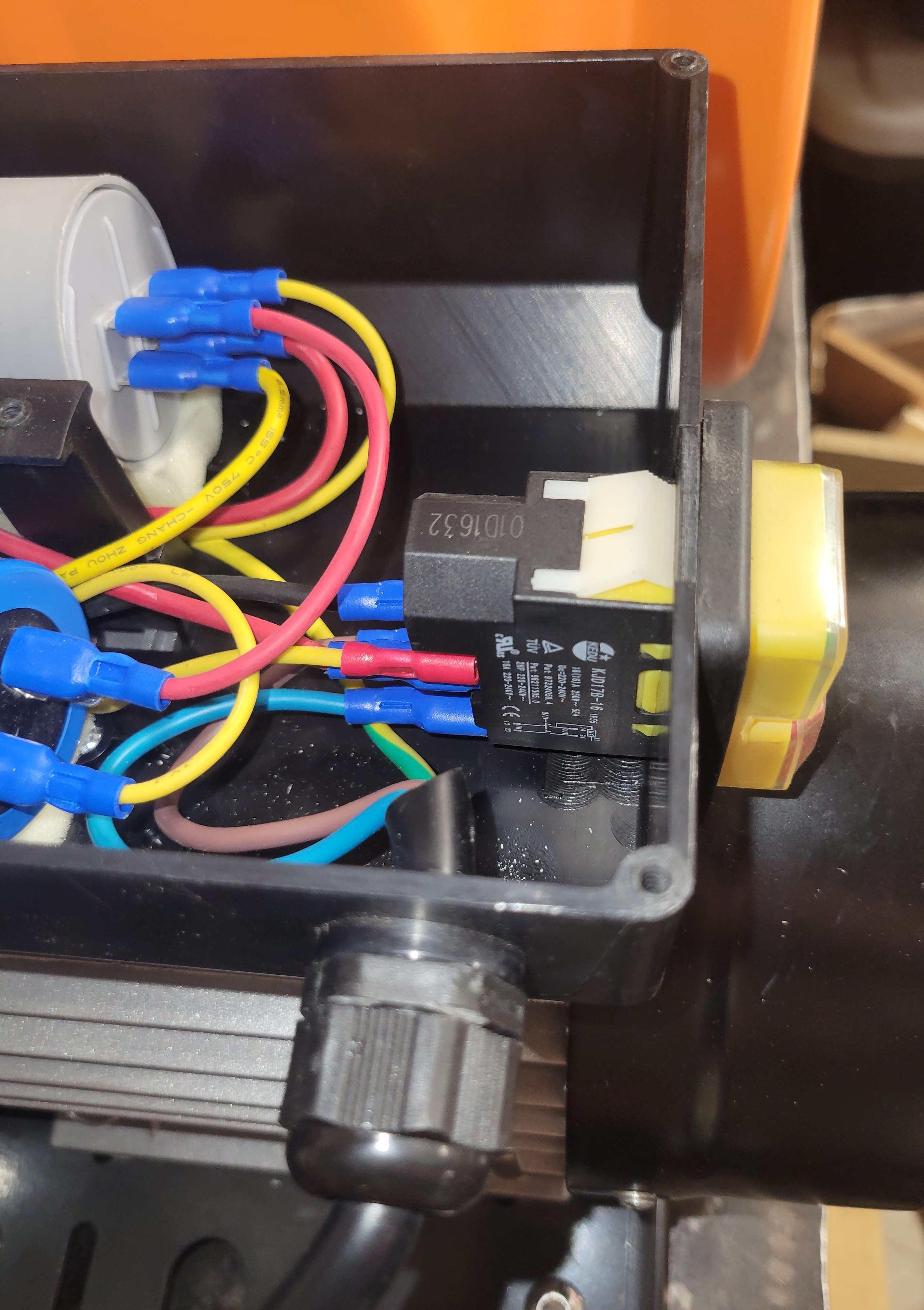

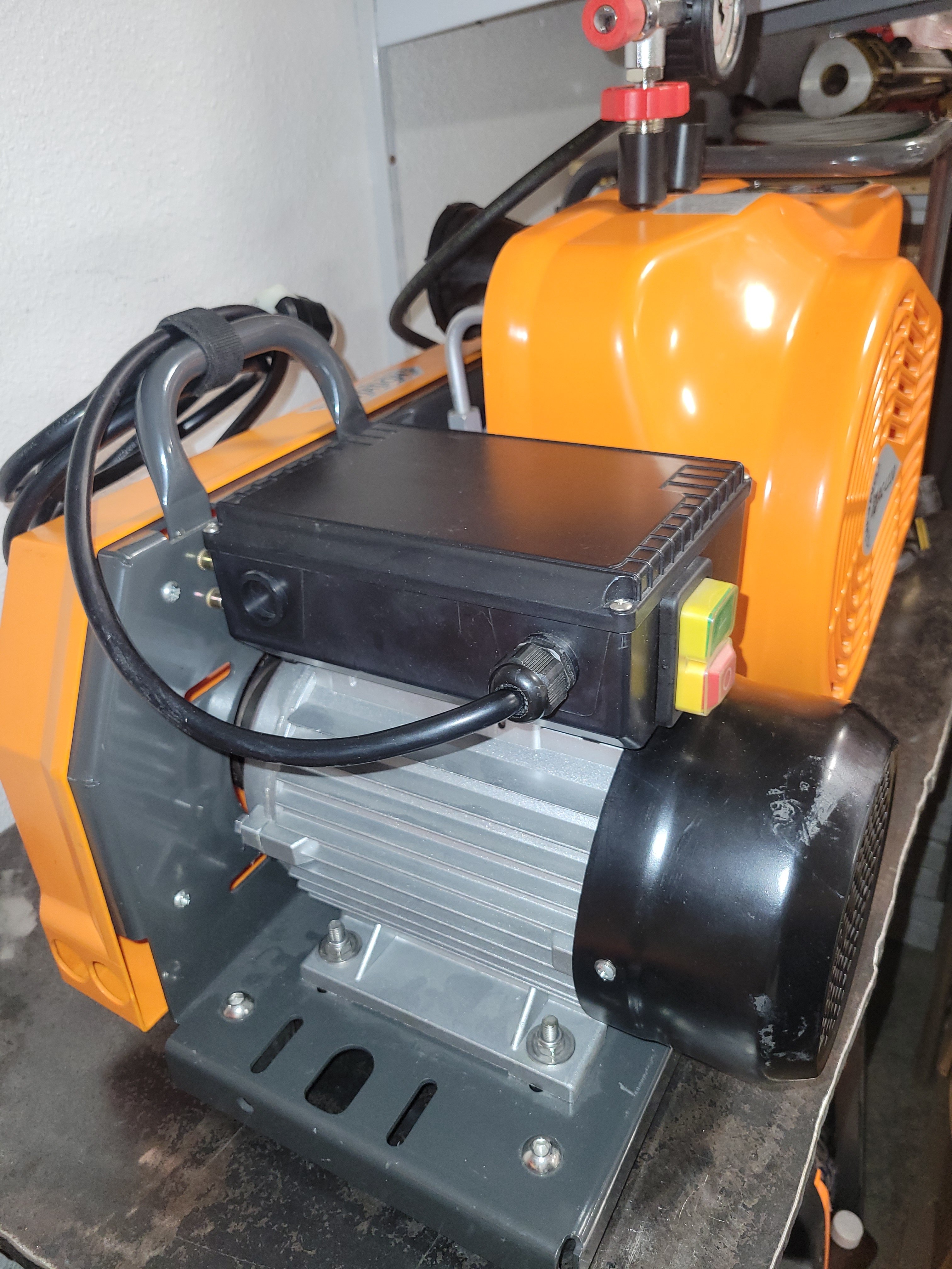

Pics of the controls show the start up and run caps plus the power switch, which is a power-maintaining style electromagnetic switch. This style of switch is what you see on newer power equipment and will not allow the machine to restart on it's own.

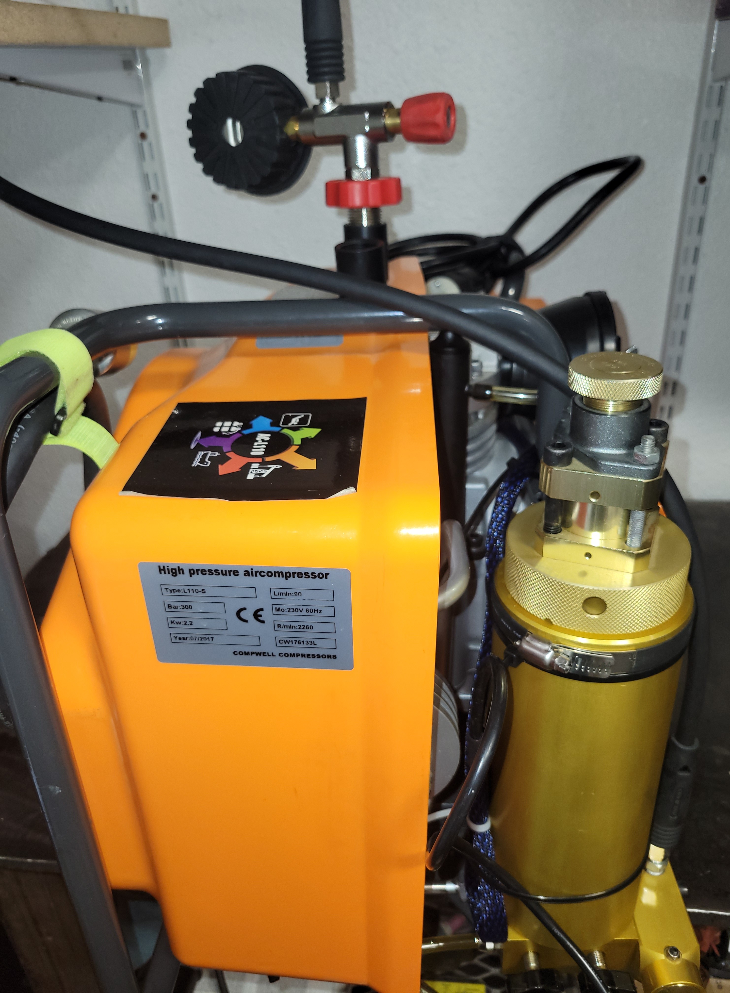

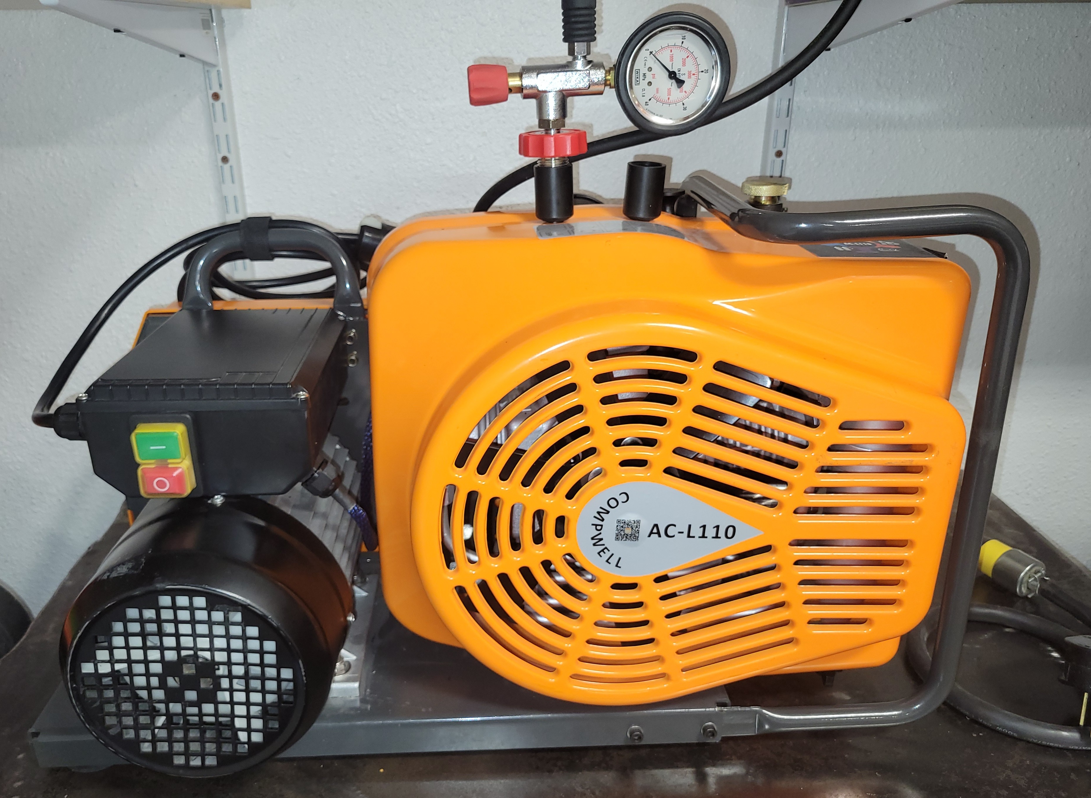

looks just like this Air Tex same model number
Yes, the AireTex mini magnum is the same Compwell compressor, which is an exact clone of a Bauer Junior 2. I bought mine in May 2020, and it’s been flawless. I have about 45 hours run time in it. Doesn’t seem like that much but it only takes 6-7 minutes to fill a 45 minute (66 cu ft) SCBA tank from 200-310 bar. So that’s over 400 fills.

CT - Does your Airetex motor have a rating plate and schematic?
