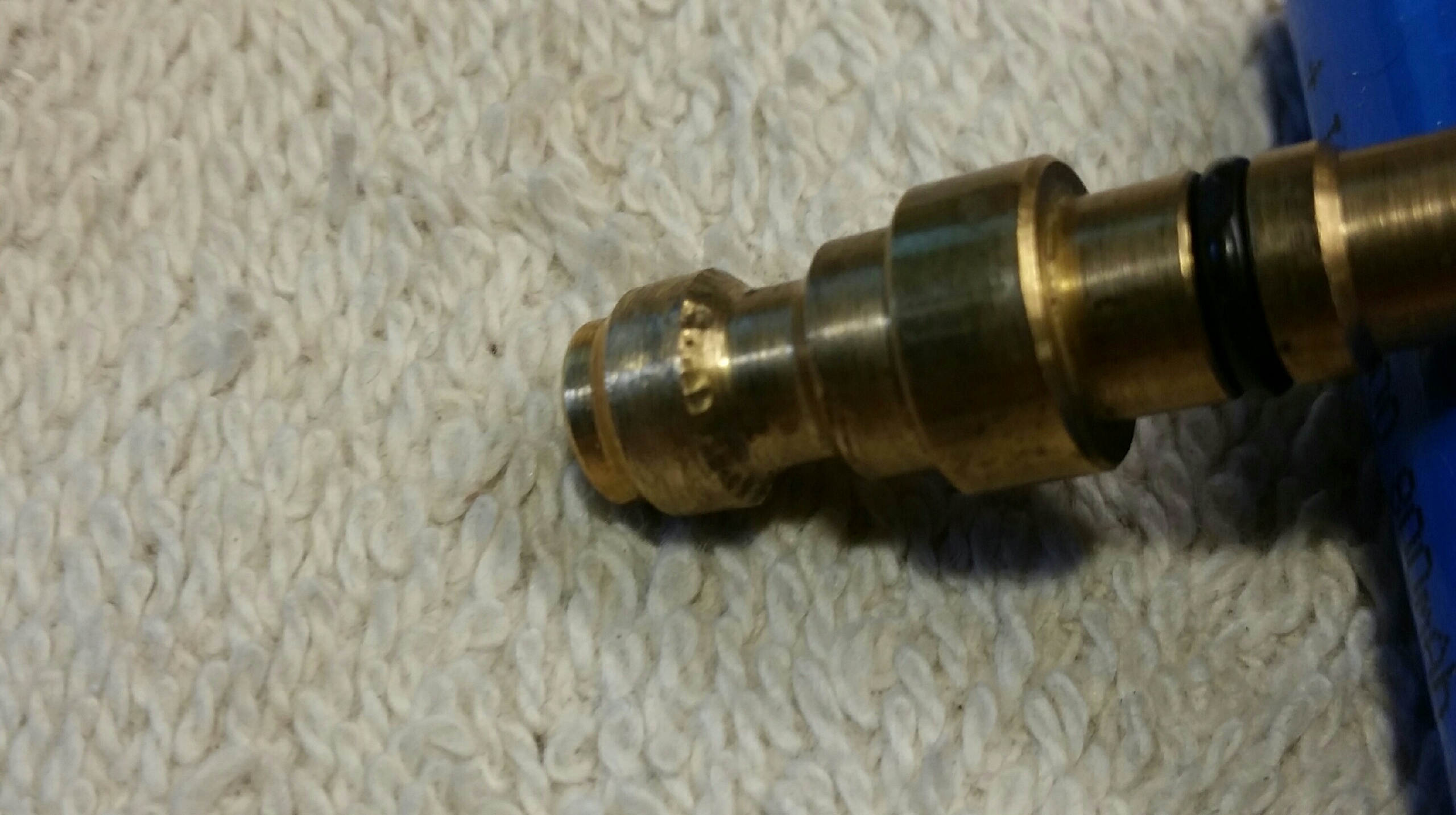

That is likely not pressure-pulse related damage - that is plastic deformation from the load applied through the retaining ball bearings in the foster fitting. It is common on brass fittings like that one, even if they are only used in tank fill situations.the only place I have seen pressure-pulse damage is on foster fitting on fill line fittings, here is a example on my SPA brass fill probe
All of my fittings are steel, so I only really can show it on the one fitting that has seen almost every fill I've ever done - the ones on the guns don't show much of anything, at least that would show up in a picture.show me the deformation on a tank to gun filling,,, where it has never seen the pulse from a compressor
common you say,, then seeing it should be easy
