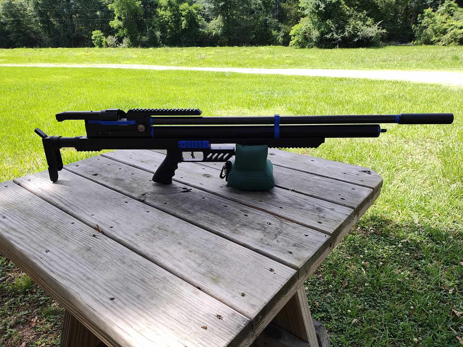

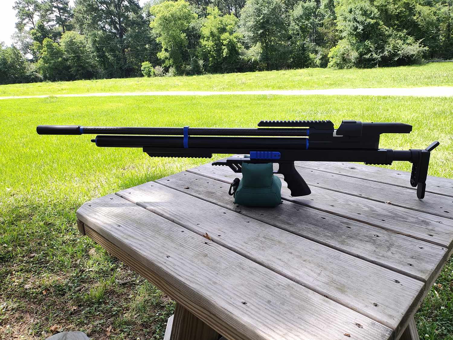

Setup this Bulldog Taurus BR build for an AGN member, this was a 357. Machined lower with custom trigger assembly, 28 inch 257 1:10 RH twist hammer forged barrel harmonic balancers between barrel and HM CF shroud, tensioned barrel sytem. New valve assembly machined for the 257. cal. Fore stock and rear pictinney rails, 20moa scope rail. Kstyle butt stock, AR grip assembly. 2 tone Duracoat finish in black oxide and dark blue. Weighs in at 11.3lbs She makes 187FPE with 110g Mr hollowpoint slug at 3300psi. She will make 201fpe with a 117g Mr hollowpoint@3500psi. She loves the 110g. Initial test accuracy is very good same hole at 50yds, nickel size group at 100yds. The space in front of trigger gaurd is for custom fit blocks to allow shooter to add weight if desired while fitting within the Taurus size frame. I made 2lb., 5lb. so far. And she is quiet as a cat on a rug imho. Simple, effective shooter.
