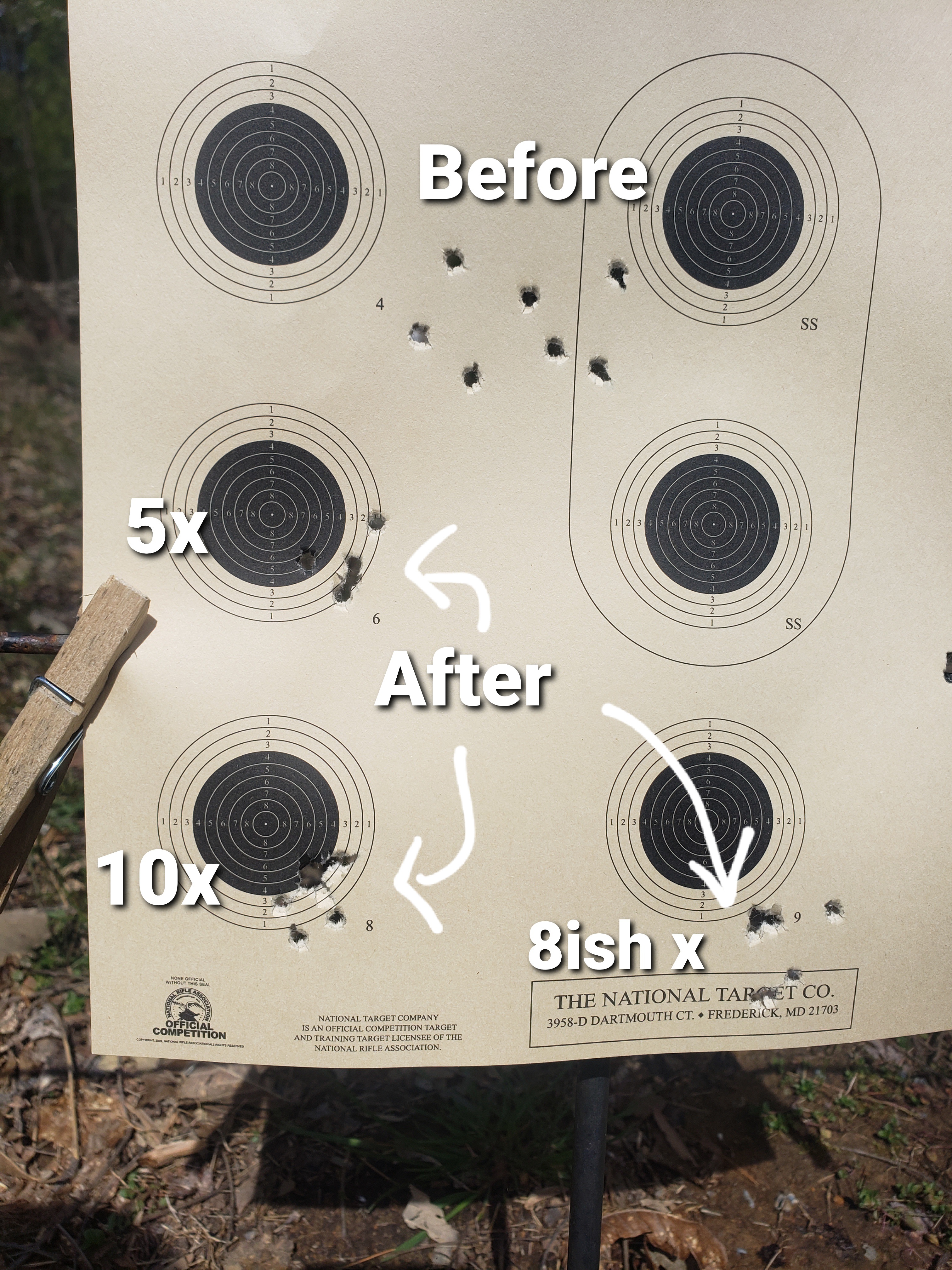

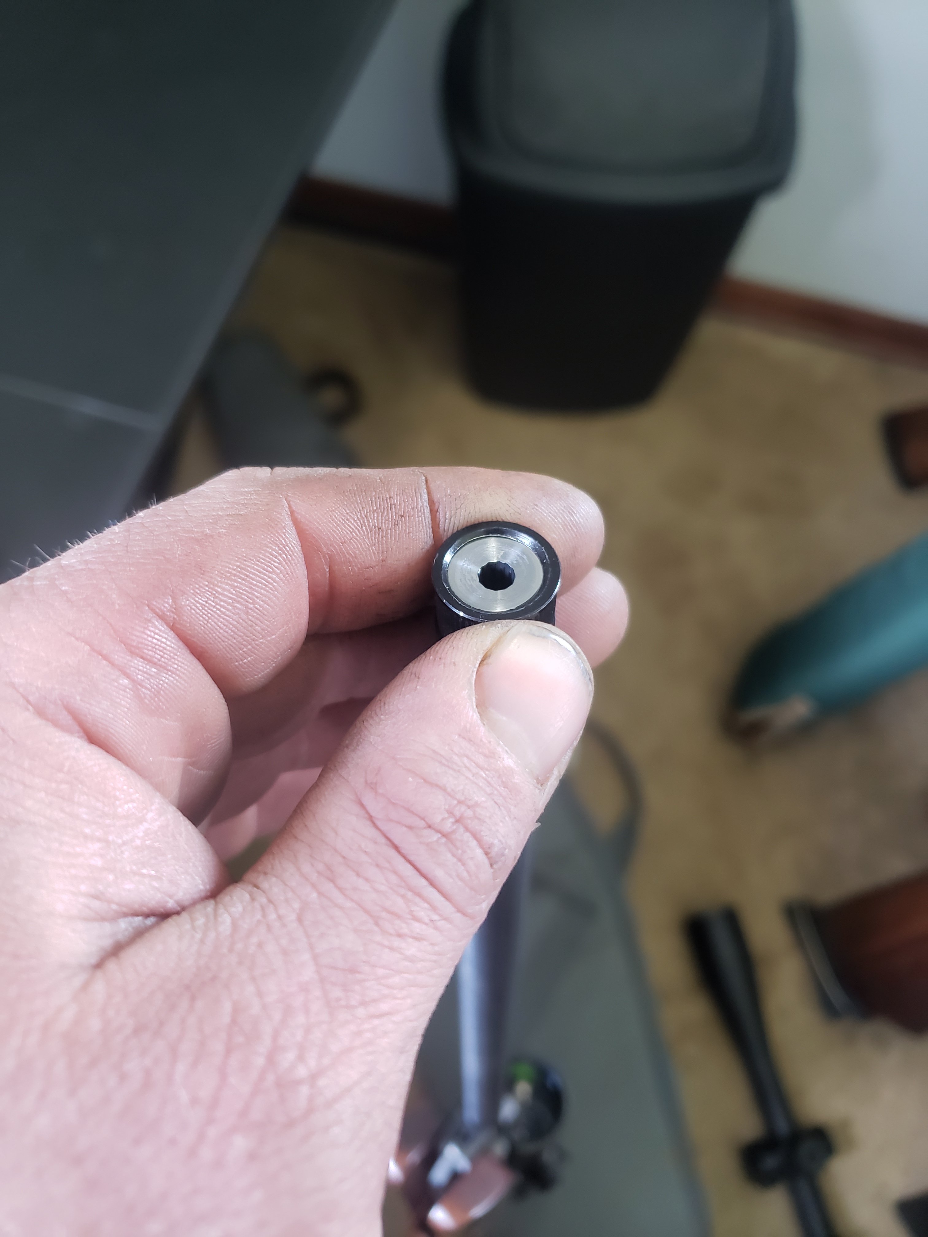

I've struggled to get decent groups with this gun from the getgo and after talking to @Keene a bit about his I decided redo the crown. I had noticed since day one that the crown was crooked and only half the muzzle had a slight crown to begin with. I kept putting off re-crowning the gun because I had never tried before.l and some days it would seem to group well and other days it wouldn't. I thought I was the problem.
After it finally dawned on me that I probably wouldn't make anything worse, I went for it. Just a heads up so ya'll don't fight the gun like I had to. The pivot bolt is reverse threaded. Why? No friggin idea but it is.
Basically all I did was turn the muzzle end in my lathe a bit past the factory "crown" and then added a slight taper. It was actually pretty easy to do. I know the finish isn't great but I'll be touching it up later. I just wanted to get something done quickly to see what sort of difference it made.
It made a big difference and the gun can actually group somewhat respectfully now.

After seeing a post on another thread, and PMing Sqwirl57 about concerns I had that the crown of my gun was faulty he confirmed the same problem with his Meteor. The results of his ministrations pictured above were pretty damned good!

Those 2 and 3 inch scattergun patterns are now reduced to about a half inch at 18 yds with fliers here and there. A tremendous improvement! I'm not sure if I need to revisit my muzzle finishing to determine if I left any burrs behind, or whether to leave well enough alone until another tin or two of pellets have been dispensed with.
Any advice at this point would be very well received.
