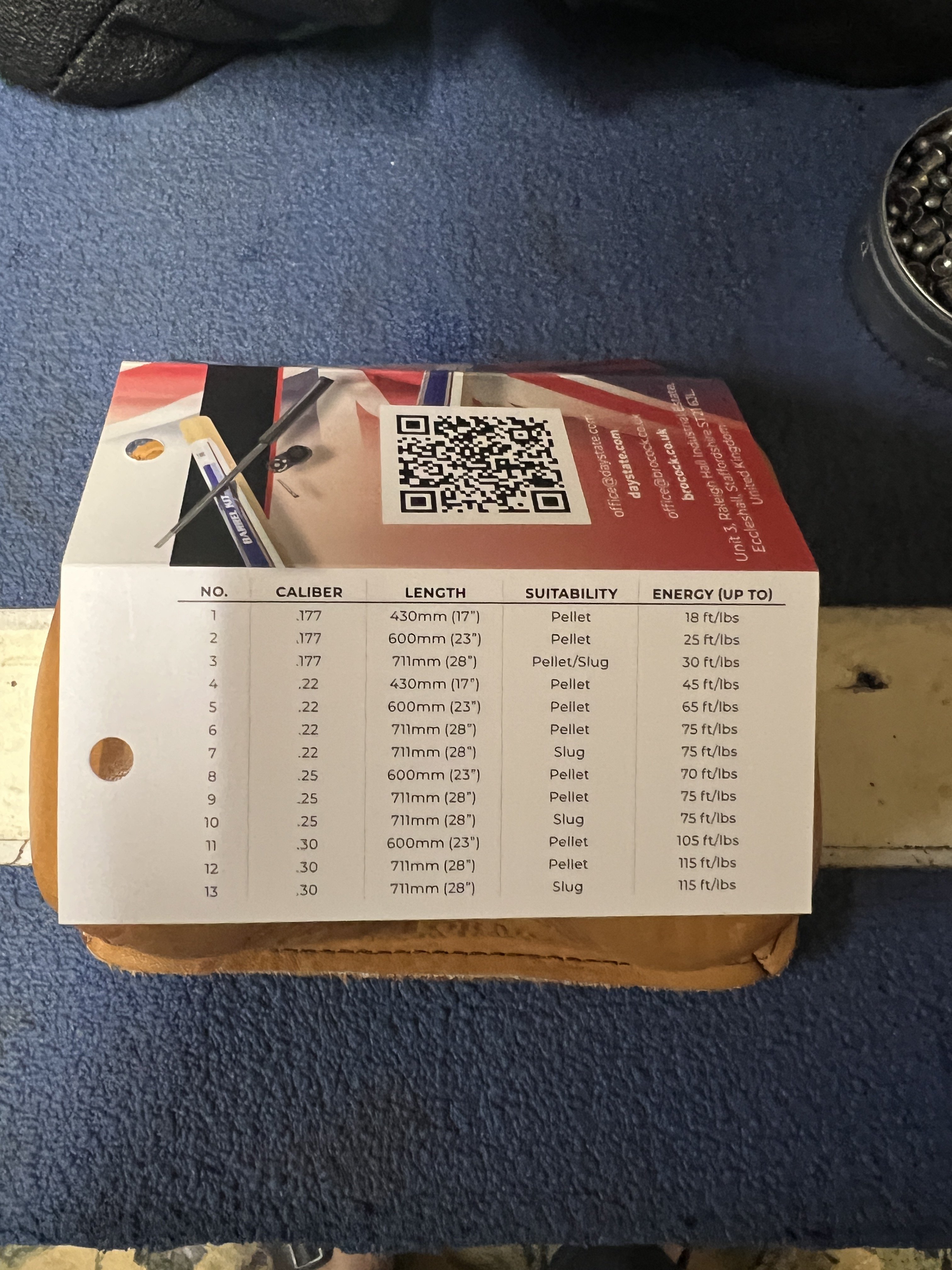

I have posted these pics before in other places / threads but they are good references. the springs are in order of power with white being the least for like .177 <20 fpe and and green being the max for like a .30 > crazy FPE

Check with AoA, but I'm pretty sure all the 28" barrels currently available have a slug twist rate.

I`ve been beating around the bushes for a HP .177cal for some years. Which one...which one?.. The RW with Heliboard was my choice but I was reluctant in regards to electronics. But That I was willing to overlook. Then came the Blackwolf and then came the FX Leopard too. I wanted the BW with just 17" if it could shoot slugs. Some say they can. I could be tempted to buy an extra 28" slugbarrel and shorted it to 17" from chamber end. 28" barrel is long and I might get used to it and leave it with that.

With the power that this gun can make, having to buy a 28" long barrel to shoot slugs (making the gun a pool cue) is ridiculous. There should be at least a 23" slug barrel, and maybe even a 17 - 20" slug barrel.

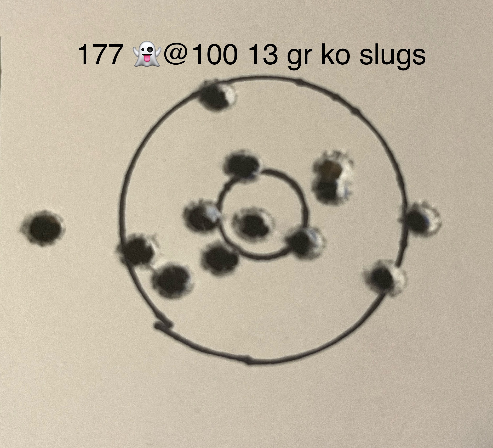

Get a ghost with a 28” 177 barrel shoots great
