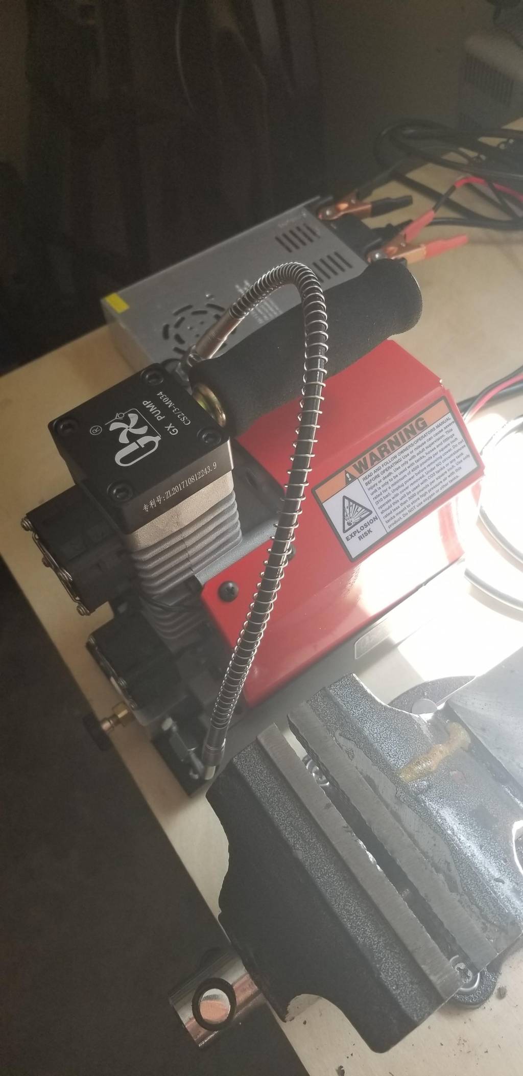

GX CS2 under $400, Amazon.
It's a very simple air cooled design with water separator. I use mine every day to top off guns.
Looks like the Hardcase model to me. You can tell the difference between it and the simple version easily as the Simple version has only two stainless lines and is missing the water separator block on one side. The Hardcover has three stainless lines and blocks on both sides of the first stage cylinder.
You will have to look at the specs to see if you are getting the Hardcase or the Auto Shutoff model. It will explain the auto shut off feature. Just don't get it confusled with the Set pressure model as it sort of sounds the same.
