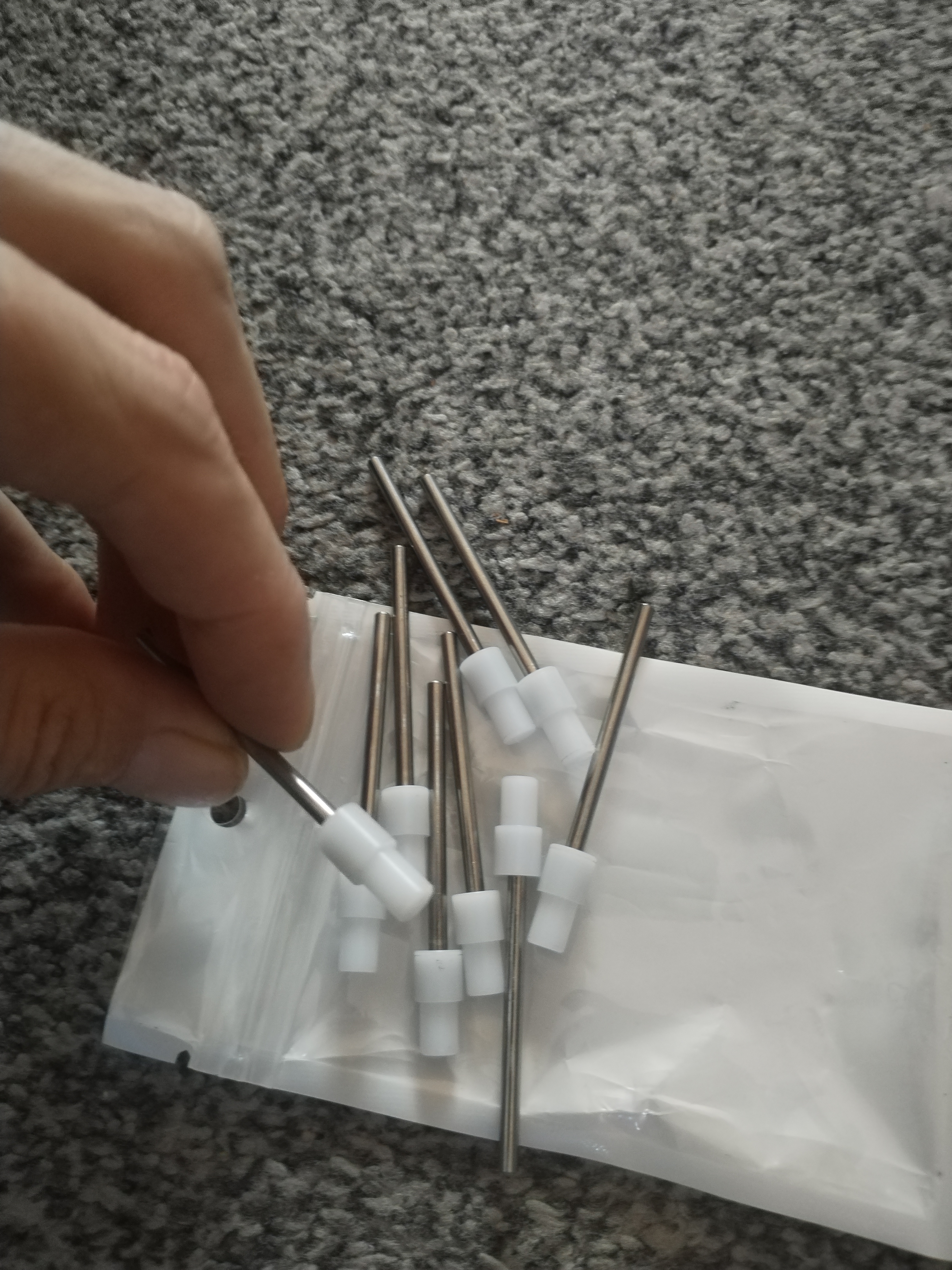

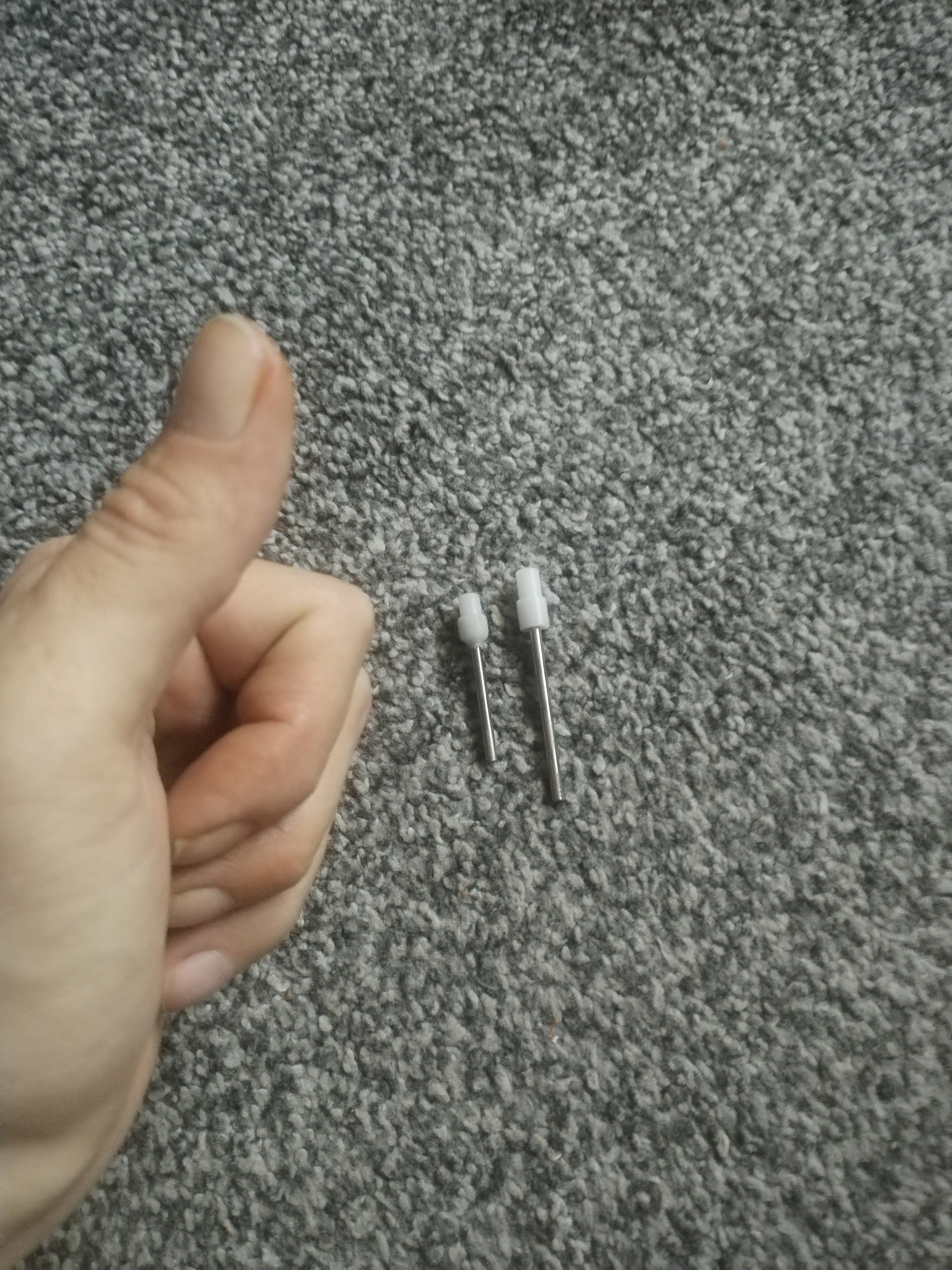

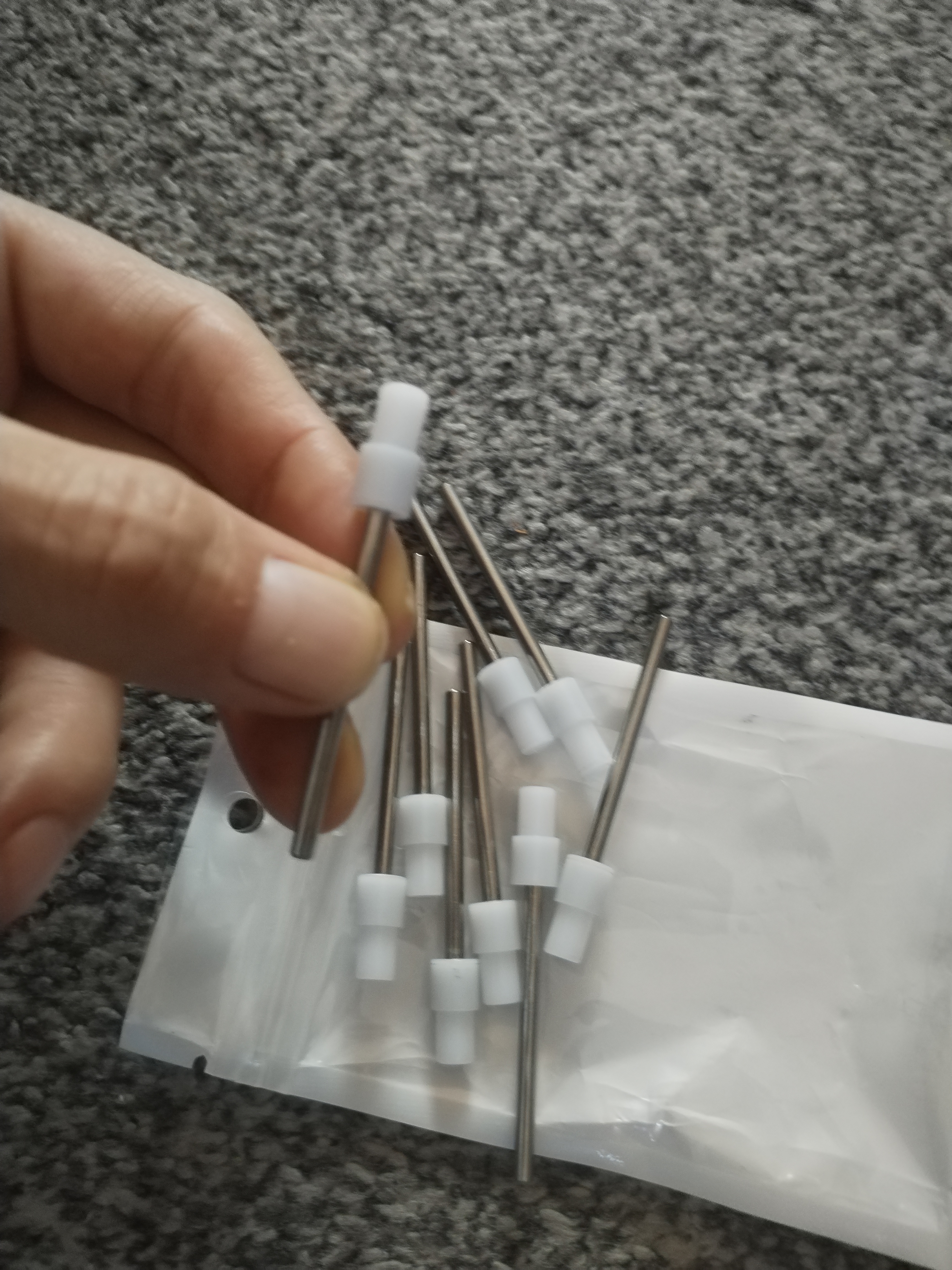

hi.. I'm quite new to this and I love it, but recently had a problem with my artemis p15, I brought myself a new one a few month's ago now and the bloody poppet snapped off at the end 🙄 so I ordered some poppet's from Ali express but unfortunately they are too long and a little bit thicker than the original poppet (tipical) 😂 I don't suppose anyone with some professional knowledge would know how to get them to there correct size, what would I have to buy in order to get them to my desired length?? I'd really appreciate any help and or advice

If the shafts of the ones you have is the right diameter, the shaft can be cut to shorten it with a cutting wheel in a dremel tool. A grinder can fine tune it. If the plastic part does not seal to the valve you can use a little valve grinding compound to grind the plastic part into the valve with the valve part that goes onto the spring in the jaws of a drill. I use high speed and a minute or two of grinding plus about the same amount of time with JSB bore cleaning paste has worked several times for me now. If the head or the part that goes into the spring is too big you can reduce the size with a sanding block turning the plastic part with a drill.

🤣🤣 no problem buddy well it look's like the mrs has found a way to make them I'll let you know if there any good. they wasn't even able to fit in the valve but can now and the white plastic has been sanded down just for the spring to sit on then all that need's doing is them shortened.

Just have someone with a lathe turn them down to match your stocker. Then trim the pin to the proper length. Looks like you have enough to last a lifetime. What I find interesting is I’ve had a P15 since 2017. And it’s modded for power and efficiency. I’ve never broke a poppet. I turned mine down a little but it’s still holding up fine. Now that I said that, it will probably break the next time I shoot the gun.

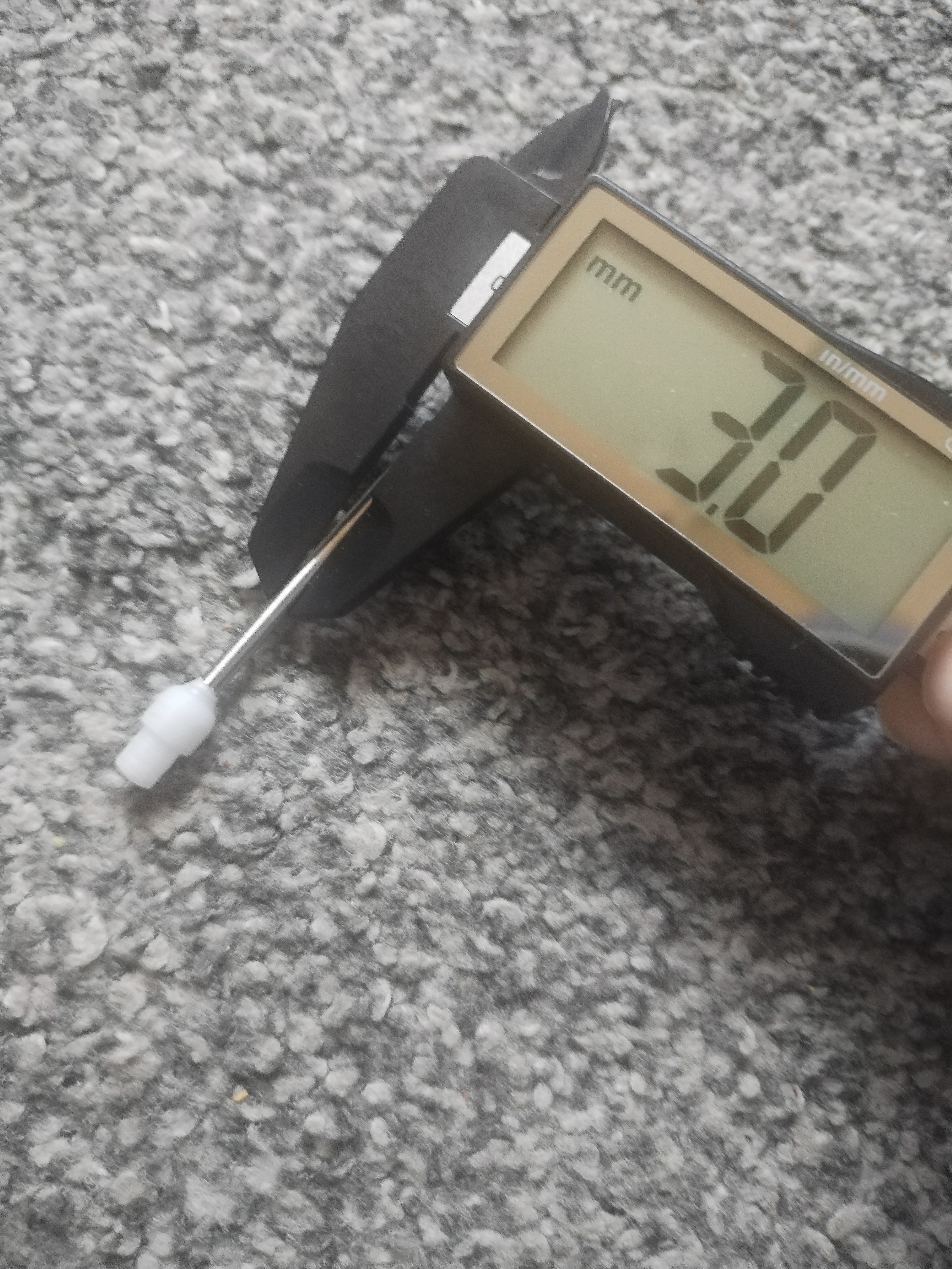

Thanks for the link. I measured the spare Maple poppet I have. It is 41.26 overall, plastic and attached stainless pin. The plastic head is 8.6mm long spread about equally between the smaller part that goes in the spring and the bigger part that seals. The diameter of the small part is 5.55mm, the big part is 7.82mm in diameter. The shaft is just under 3mm. You can fix other things but if the shaft is not 3mm it won't work.

thank you very much Jim for those measurements for the poppet valve that's a great help 😁👌, and no problem for the link buddy 🤝
