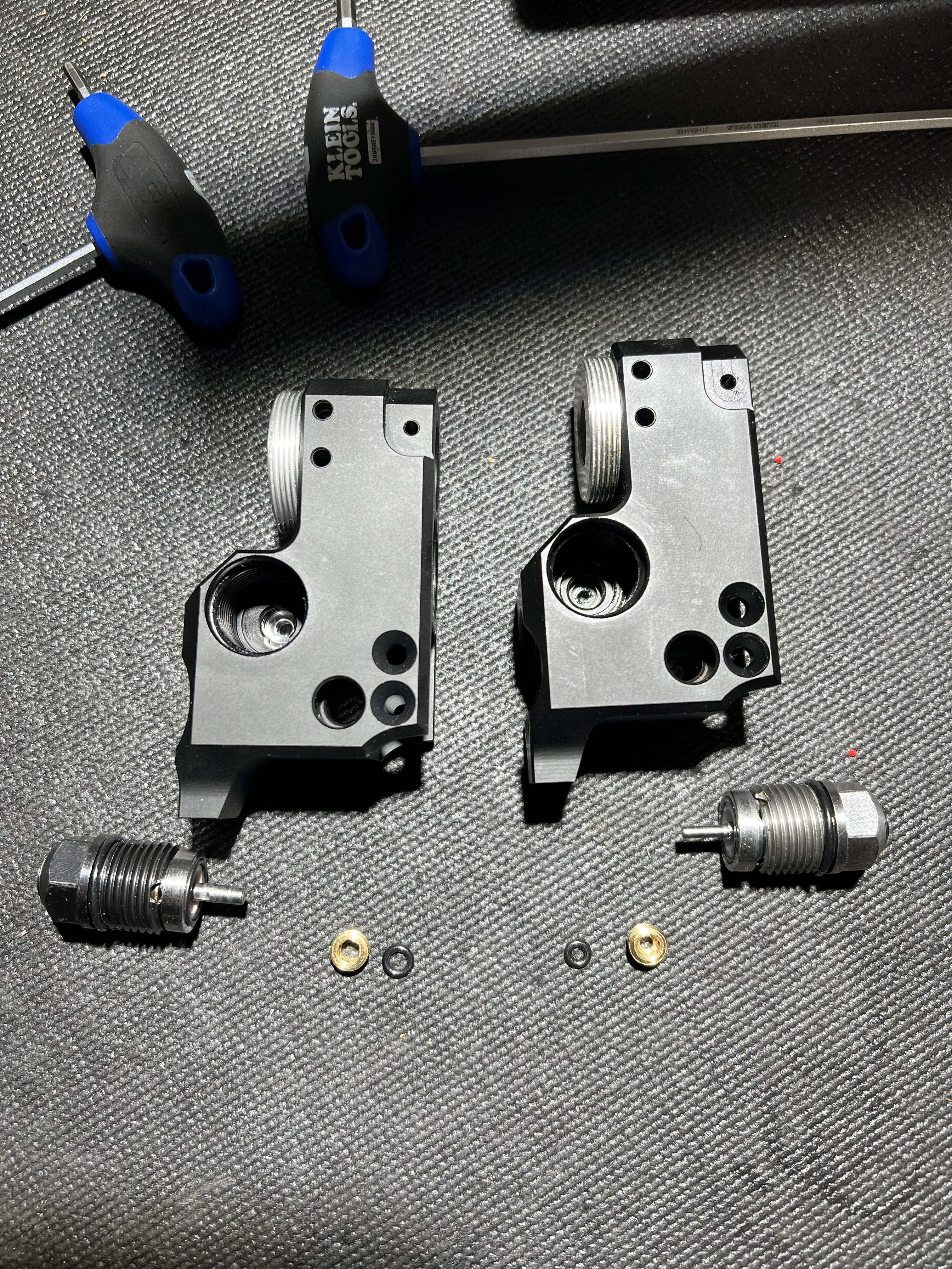

Huma reg won’t work. Just got an email from Marc yesterday. Here‘s a pic of the old block on the right, new block on the left. They made a small brass pin for their reg. They haven’t even seen a new block yet at Huma. The new block needs a bigger pin.

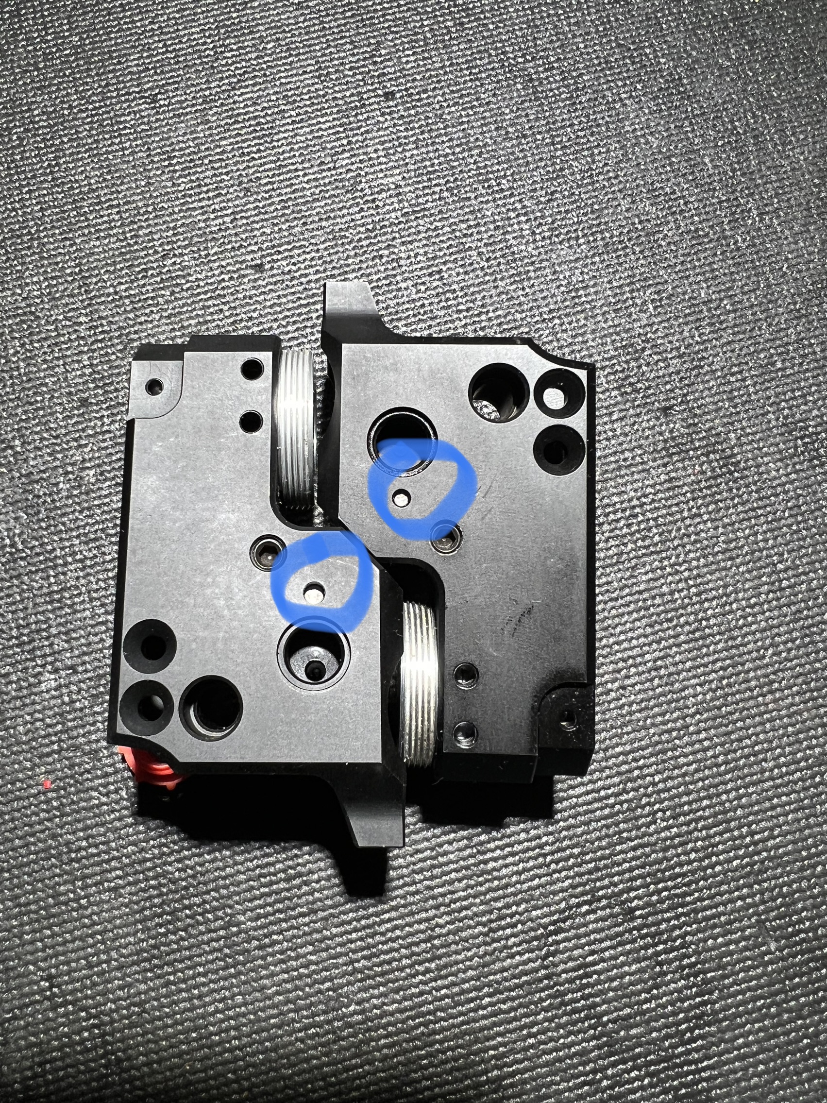

Vet - I am a bit confused. On both of these we are looking at the non-reg side. Can you post a pic of the drivers side of these blocks? I was more curious to see the hole where the reg goes. Maybe post them side to side in the same orientation rather than 69ing like you have them here - muh brain don't work so guud lookin' at it like that. :ROFLMAO:
Reactions: Mike_Lenardon

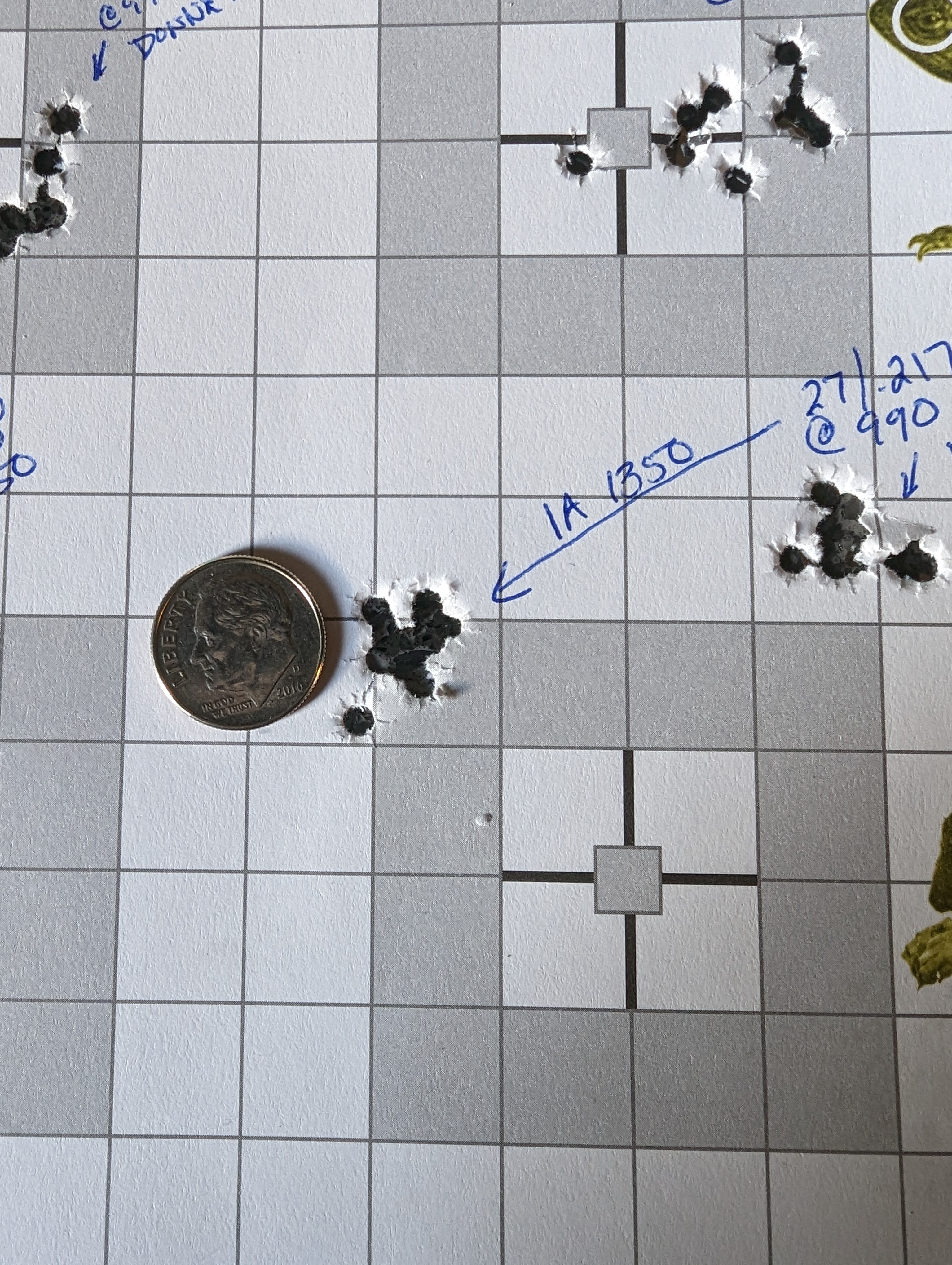

I should have access to the old block so that may be ok. Here is that 35yard 8 shot group. I know it's got it, just need to get it to stay put.
