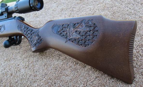

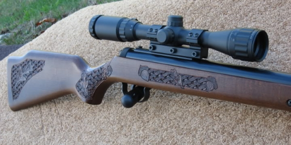

Here's my 34 oldie. I did some "basketweave" on it just to dress it up. Never did shoot it a lot because I was working but still had it sent to John in PA for a tune about a year ago.
Now that I have an FWB 300 collection it just sits in the rack .
