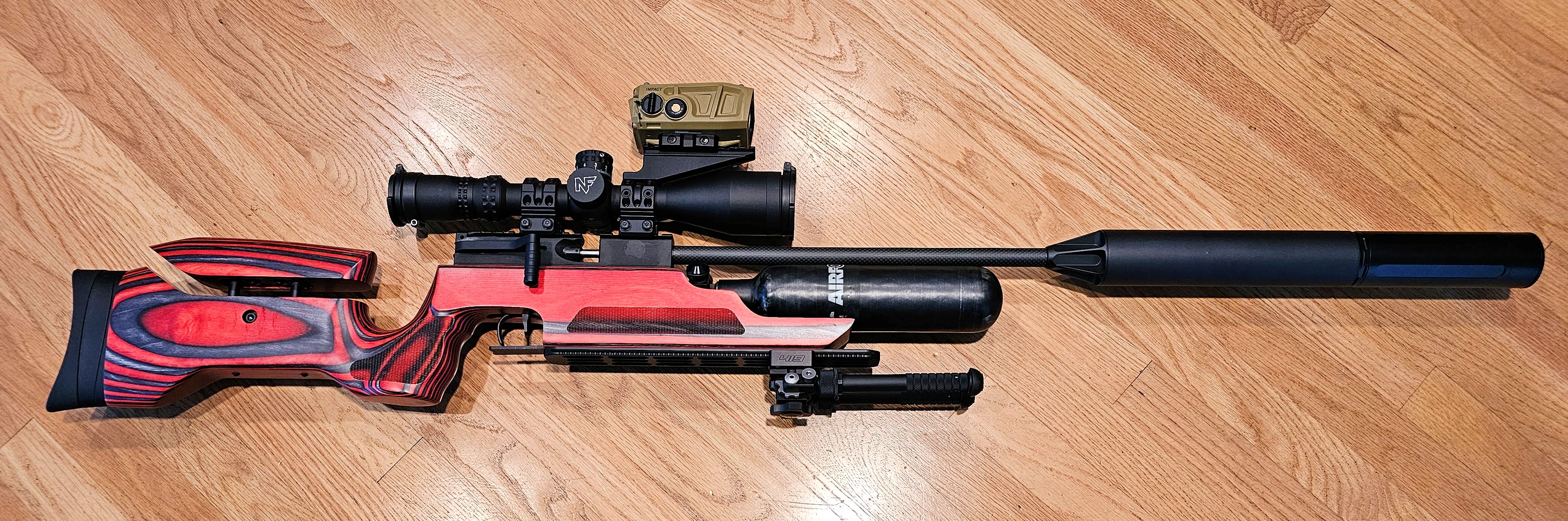

I would not like the weight to a rifle, scope, mount, bi-pod and laser rangefinder being supported by the air bottle regulator connection. By way of example, my RAW HM1000.x
