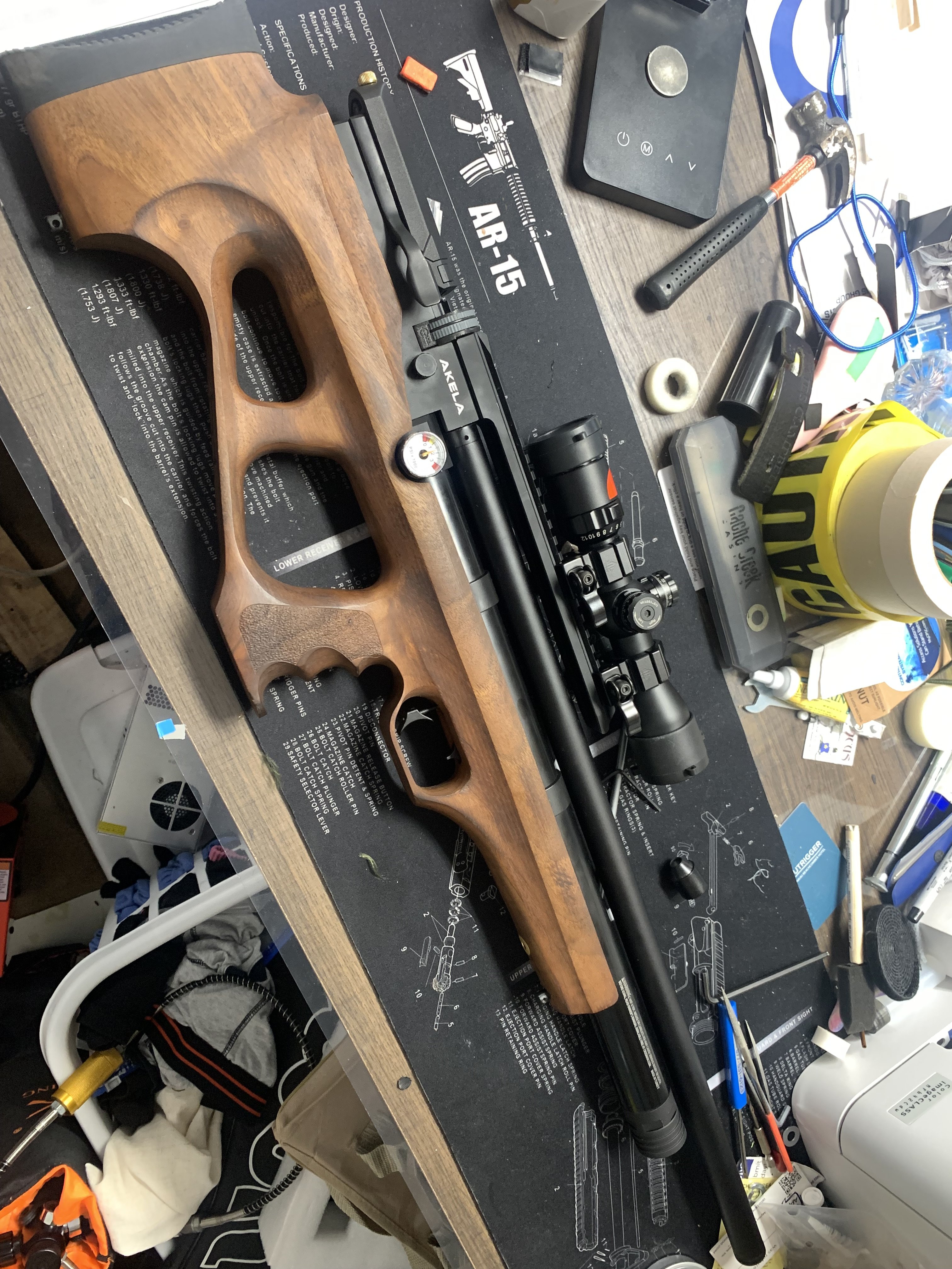

this arrived on monday from AR! i think i got pretty lucky with the stock raffle 😁i haven’t zeroed yet due to work but im excited to be shooting .177 again. last time i shot the caliber was over 20 years ago!

this arrived on monday from AR! i think i got pretty lucky with the stock raffle 😁i haven’t zeroed yet due to work but im excited to be shooting .177 again. last time i shot the caliber was over 20 years ago!View attachment 559020
