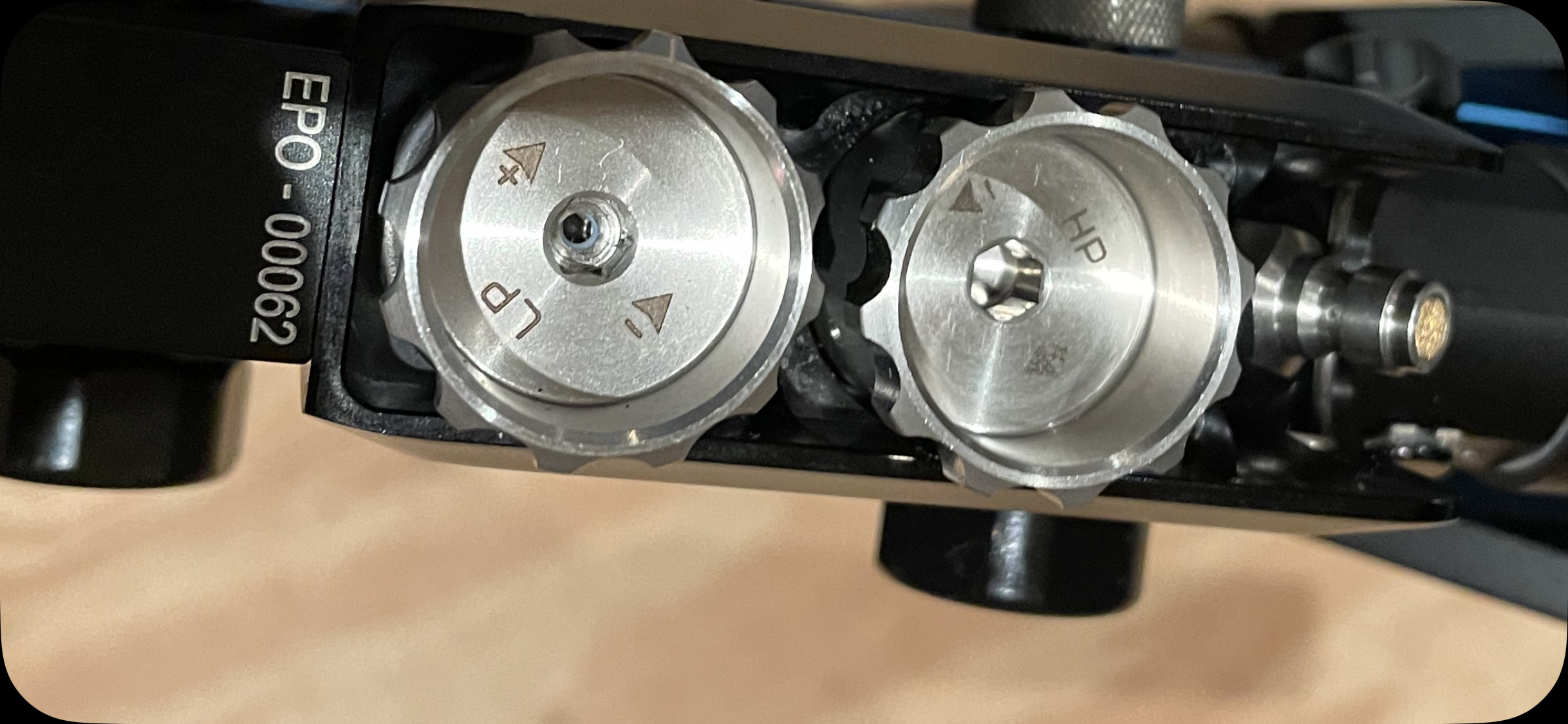

what happened when the LPR failed?
Edit: I see it now. It wouldn’t pass any pressure to the spool.
Exactly. 0 pressure. I tried turning counter clockwise to increase pressure. When it got most of the way in the pressure went up to over 300 psi. But then it wouldn’t adjust back down to required pressure and seems to have failed high.
... Is this the REGULATOR video we're speaking of ?
Watched it & while it gives rebuild / service "How Too", did not see any trouble shooting or specific How to fix a similar issue such as Mikes and a few other guns have experienced.
Skout made a short video and sent to me. Not that video.
Nope. LP reg is counterclockwise. HP reg is clockwise.
Both high and low pressure regulators on the Epoch are controlled in the same manner. Clockwise to increase pressure, counter-clockwise to decrease pressure. The LPR uses left-handed threads so that both regulators can operate in the same direction to avoid confusion. On the faces of the knobs there are arrows with + and - signs designating directions. Note to adjust the LPR down a shot must be fired to see the change. It does not self-vent like the HPR.
Reactions: Centercut
Good to know. I probably missed that in the instructions about the reg not self venting and needing to fire the gun to see a change. 😞
